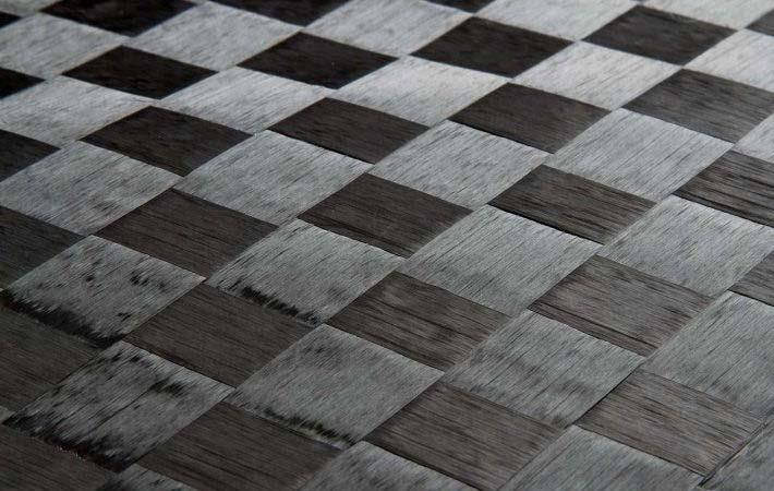

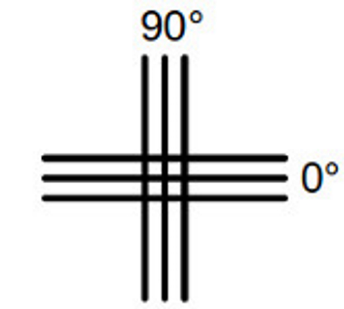

Wrt diaphragm materials, an "acoustical figure of merit" would ideally be based on basically 3 acoustic properties: stiffness, (low) density, and internal damping.

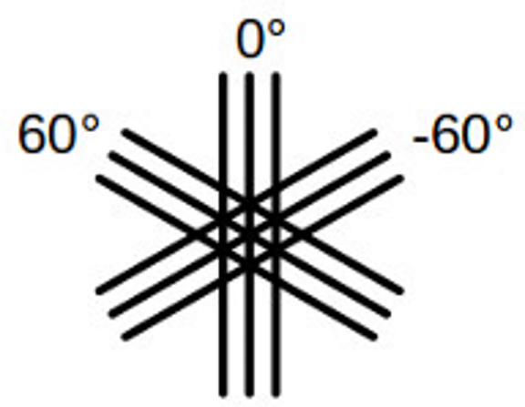

The TexTreme biaxial weave has low density, but a triaxial weave - composed of three sets of yarns, which intersect and interlace with each other at 60 degree angles - has superior tensile properties compared to bi-plain and biaxial woven yarns. In addition, triaxial woven fabric has the ability to maintain structural integrity.

Similar to Hoffman's Iron Law (bass extension vs. efficiency vs. enclosure size), in general - as regards to traditional materials, you can only have 2 of the 3 properties (stiffness, (low) density, and internal damping) for a specific application.
For high frequency reproduction you'd want the stiffness of the triaxial weave (reduced breakup), but the higher density is prohibitive.

Ro808 - I don't know if the textreme diaphragm is a single layer, it may be, but I tend to doubt it... if it is multi layers, they could use a combination of 0/90 and +45/-45 layers exclusively. it is not necessary to use 0/60/120 triaxial to achieve a good laminate. In aerospace applications, we almost always use 0/90 and +45/-45 layers. So without more knowledge of what Oxeon is doing, I am hesitant to lay blame on the 0/90 layup.
