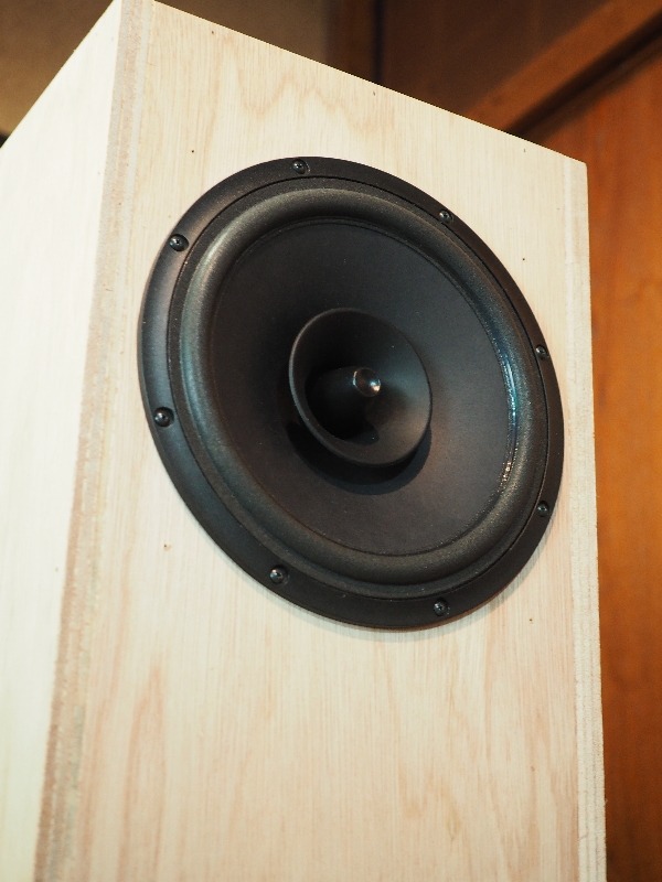

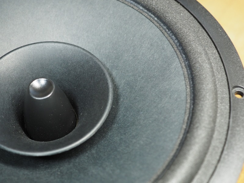

I installed SB Acoustics 8" Fullrange(SB20FRPC30-8) in TQWT.
Well-extended bass.
Natural mid and high range with little grating.
High quality throughout the all range, and the performance is above the price.

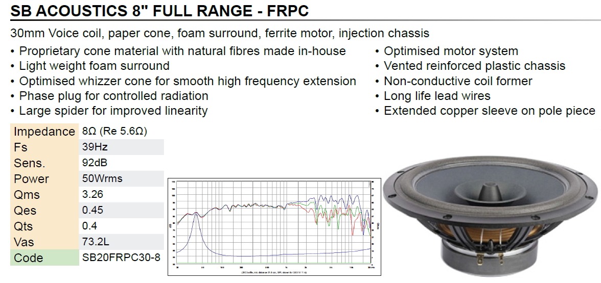

BG20 has a soft sound, an average texture, and a weak treble. Adding a magnet will increase the sharpness and texture.
SB20FRPC30-8 is sharp enough not to be offensive to the ears, and has a wide range with a lot of information.
It doesn't change much even if a magnet is added.
It is strange that magnets of the same size are used.

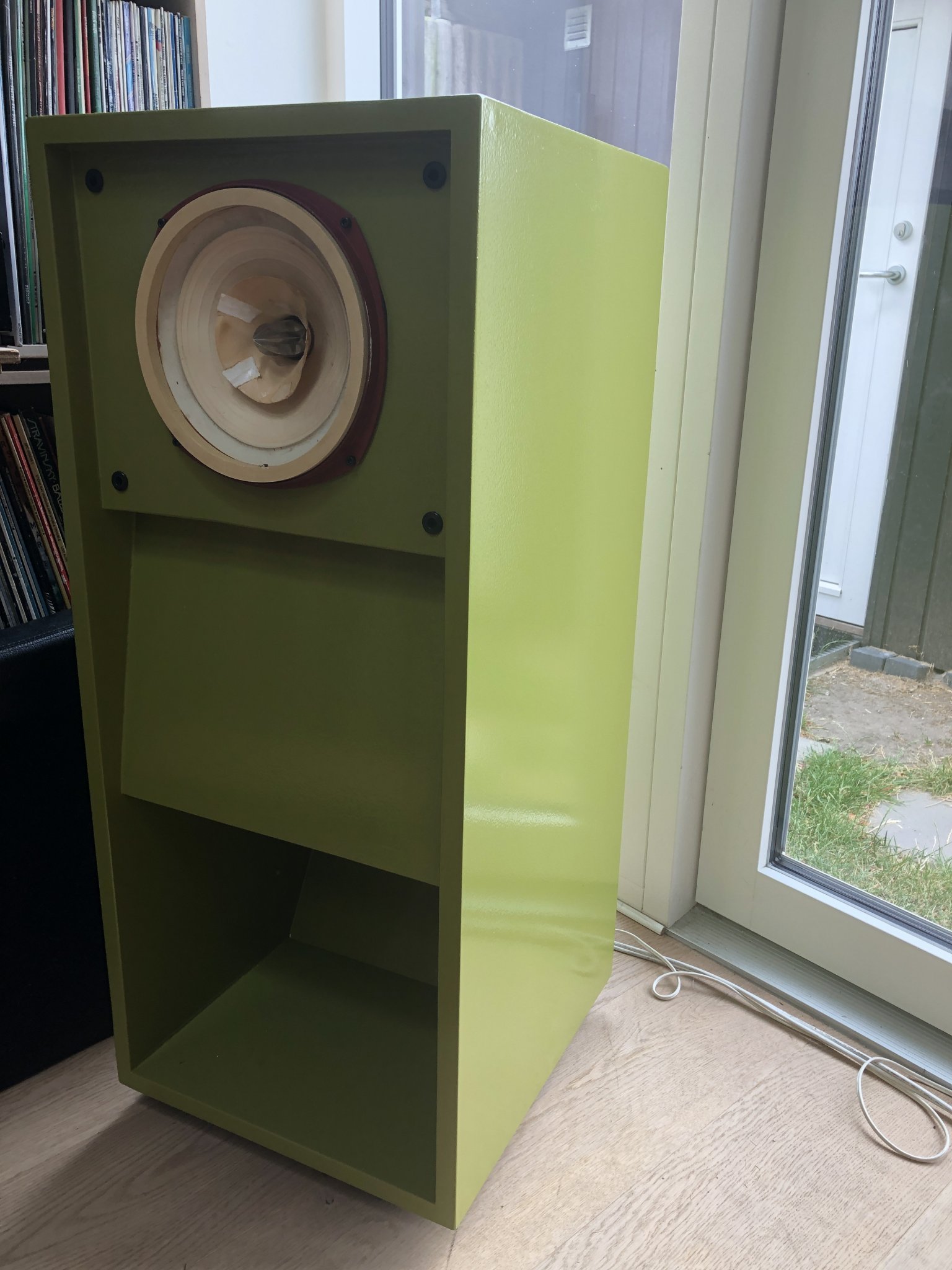

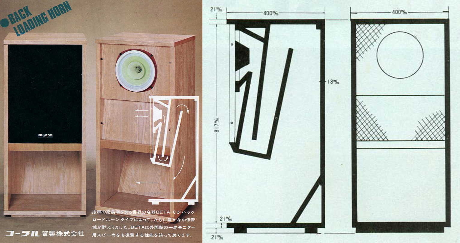

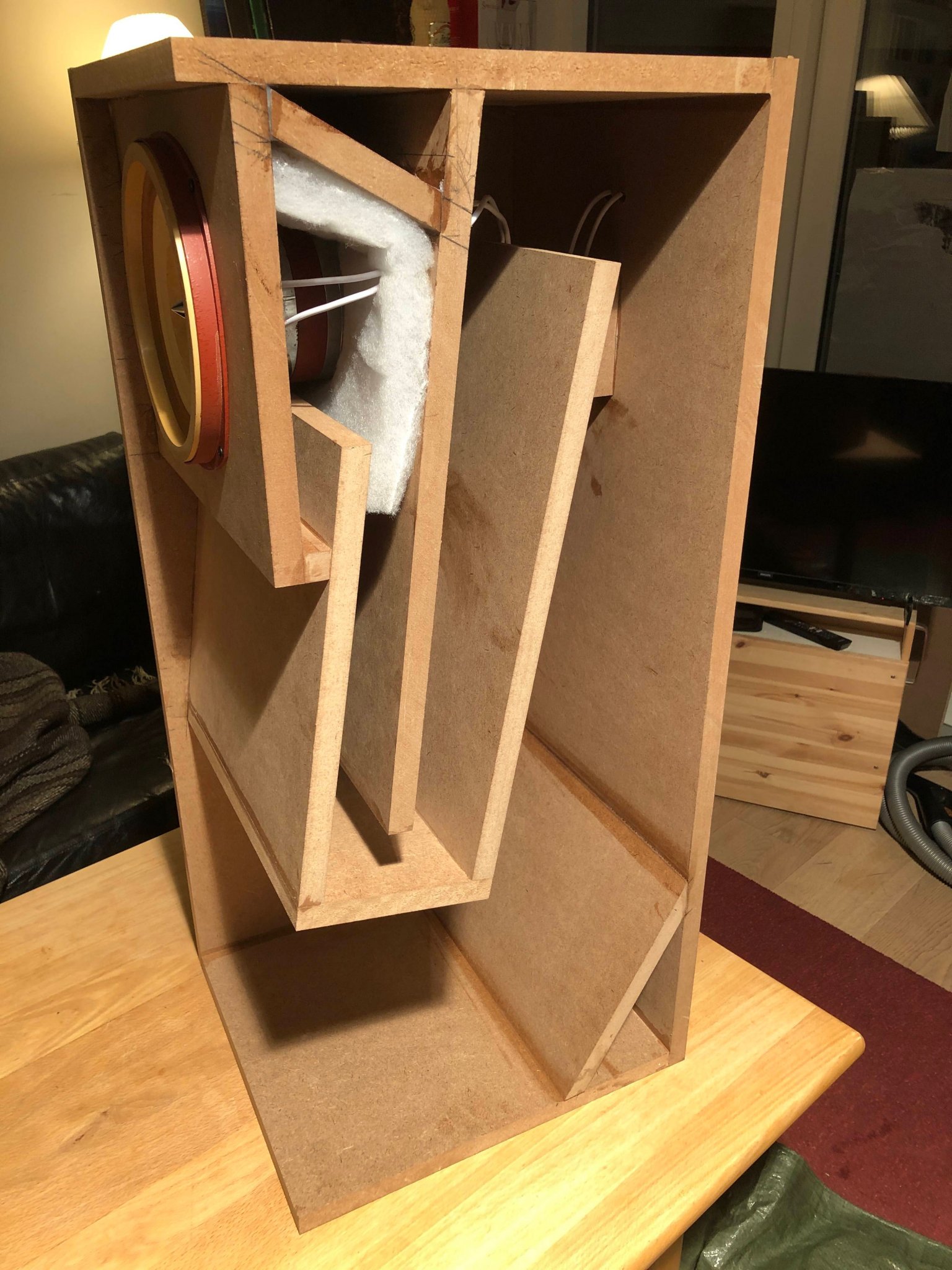

After completing original Coral specified horncabinets for Coral-Beta-8 drivers, I had to realize, that these great old drivers had expired their lifetime. Sound was great for the most part, especially a very open high frequency, and the cabinets does a fine job for the bass. But at certain frequencies clear distortion was experienced, due to the drivers old age.

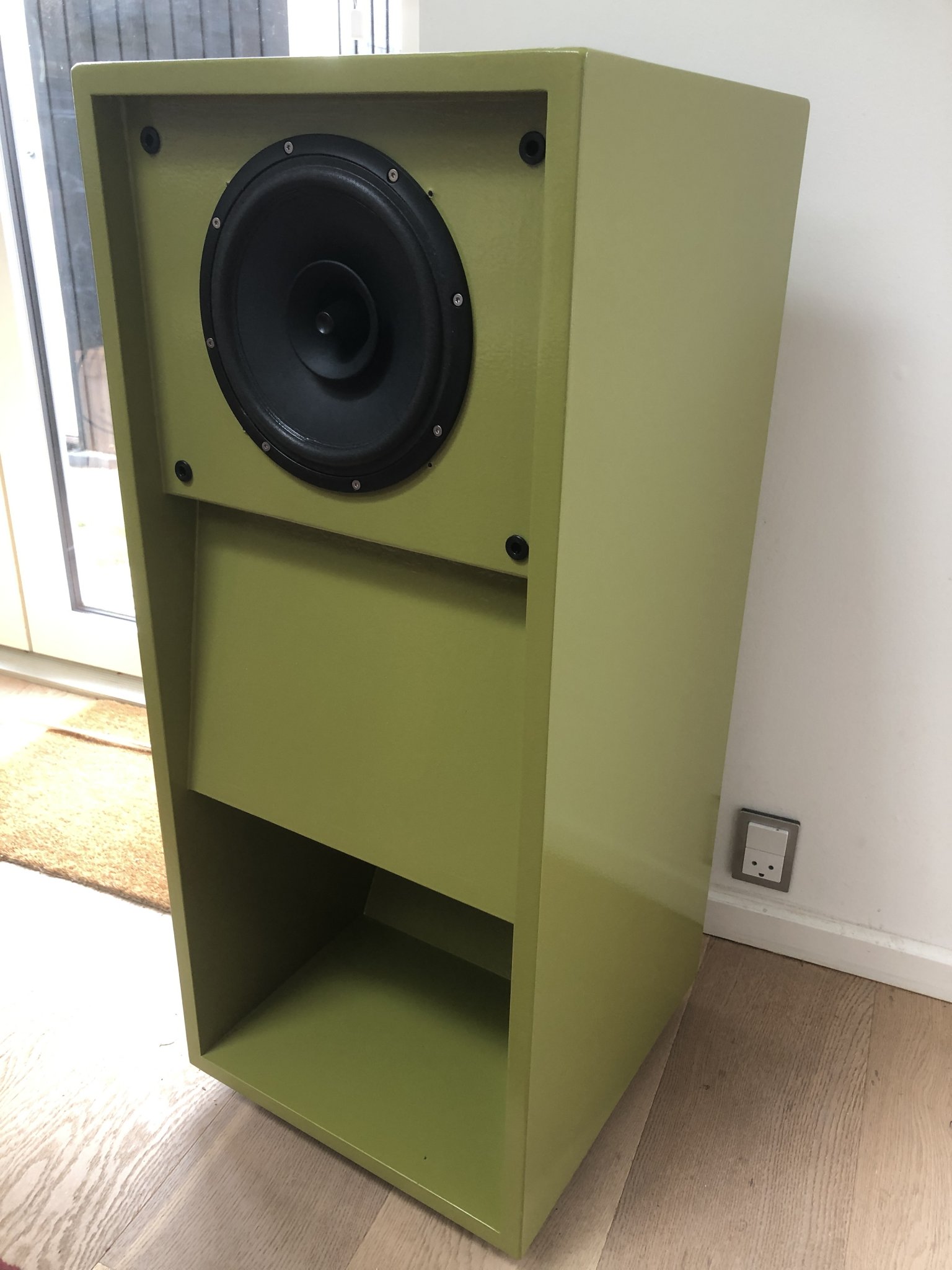

So looking for a new fullrange driver, I came upon the DIY project above, and decided to give the SB Acoustics SB20FRPC30-8 a try.
I am do happy with this new driver. Side by side the Beta-8 it does a pretty good job. Again the bass range is well served by the horn cabinet.
Can only recommend this new SB Acoustics driver - not expensive at all.

Dear nandappe.
Thank you for your kind reply. As you inspired me to try the SB20FRPC30-8, I just wanted to share my experience.
Yes, you are probably fully correct in regards to the 40+ year old Beta8 drivers. I listened to them for some time, as I got the cabinets completed.
And the sound was very crisp nuanced throughout most of the spectrum. The driver is sensitive to off-axis listening; especially for the high frequency. The bass range was clearly improved by the cabinet; and it has been capable of playing quit loudly continuously for several hours.
But as described; distortion have now been identified at specific midtone ranges.
As I was looking for a new driver; I was recommended the drivers from Tang; Tang Band W8-2145 (150€) and the W8-1808 (300€) - but both drivers are to deep for the cabinet. And far too expensive for my current budget,
Then I checked Dayton Audio PS220-8 (200€) - which seems perfect for the job; also with a very nice finish.
And finally I checked Markaudio Alpair-12P (140€) - without finding any projects or reviews.
As I have had very good experiences with drivers from SB Acoustics, I decided to give the SB20FRPC30-8 driver a try, after reading about your project above.
The SB20FRPC30-8 driver is far cheaper than the above ones. But therefore also tempting to purchase; just for experimenting.
And I must say I'm quite surprised how well it performs. Above price as you stated; I completely agree.
It can perform at very loud levels too; with out any distortion at all. The bass range is still acceptable; and the of-axis listening is much better than the Beta8.
So no complaints until now.
I should like to try with the more narrower cabinet that you have posted here. It looks very nice and quite elegant, due to the narrow front.
I very much appreciate good sound and good loudspeakers - but I don't have a professional ear - nor am I comfortable with the engineering terms to describe the sound and listening experience. Just an amateur.
