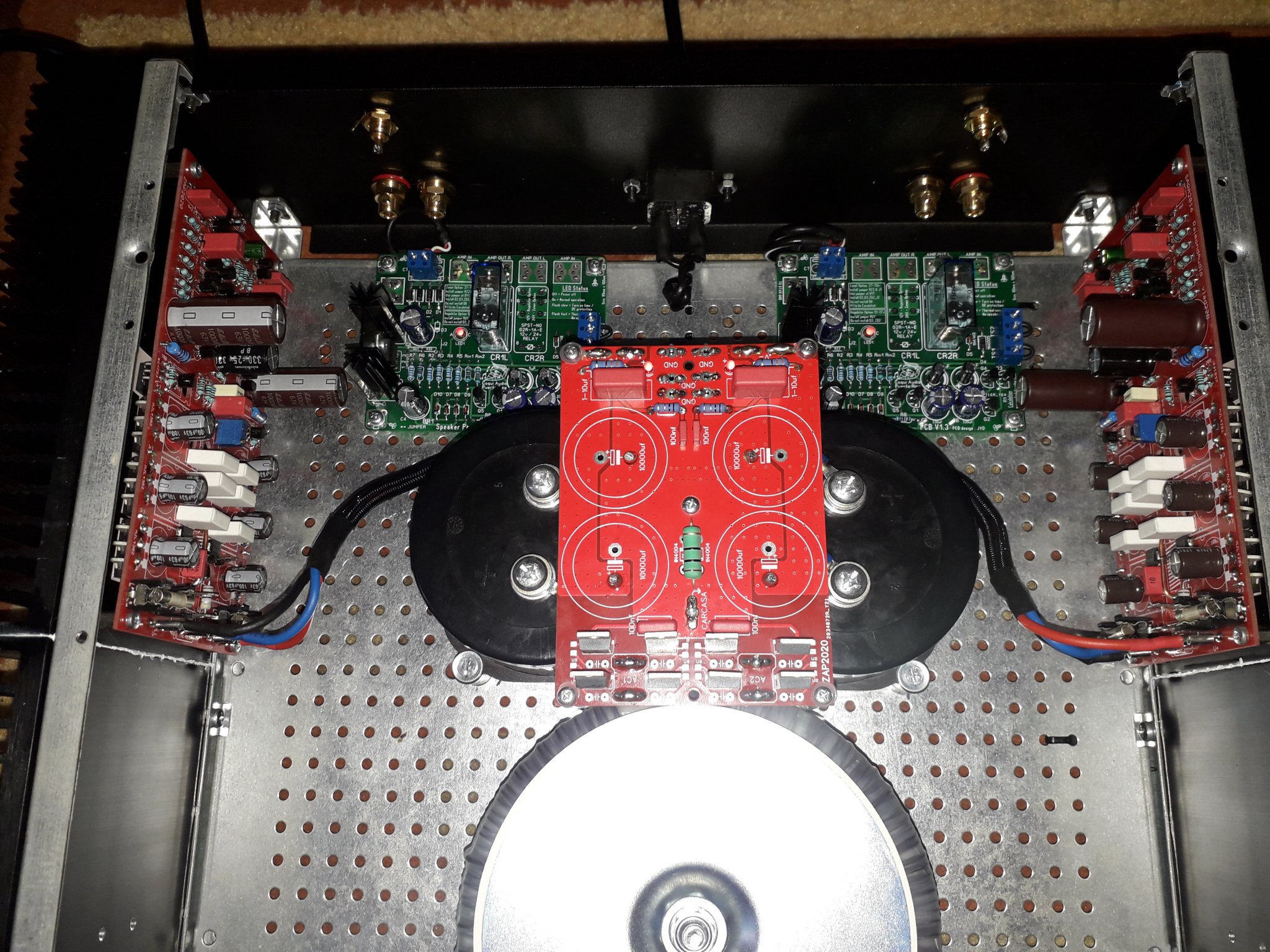

SARA-2016

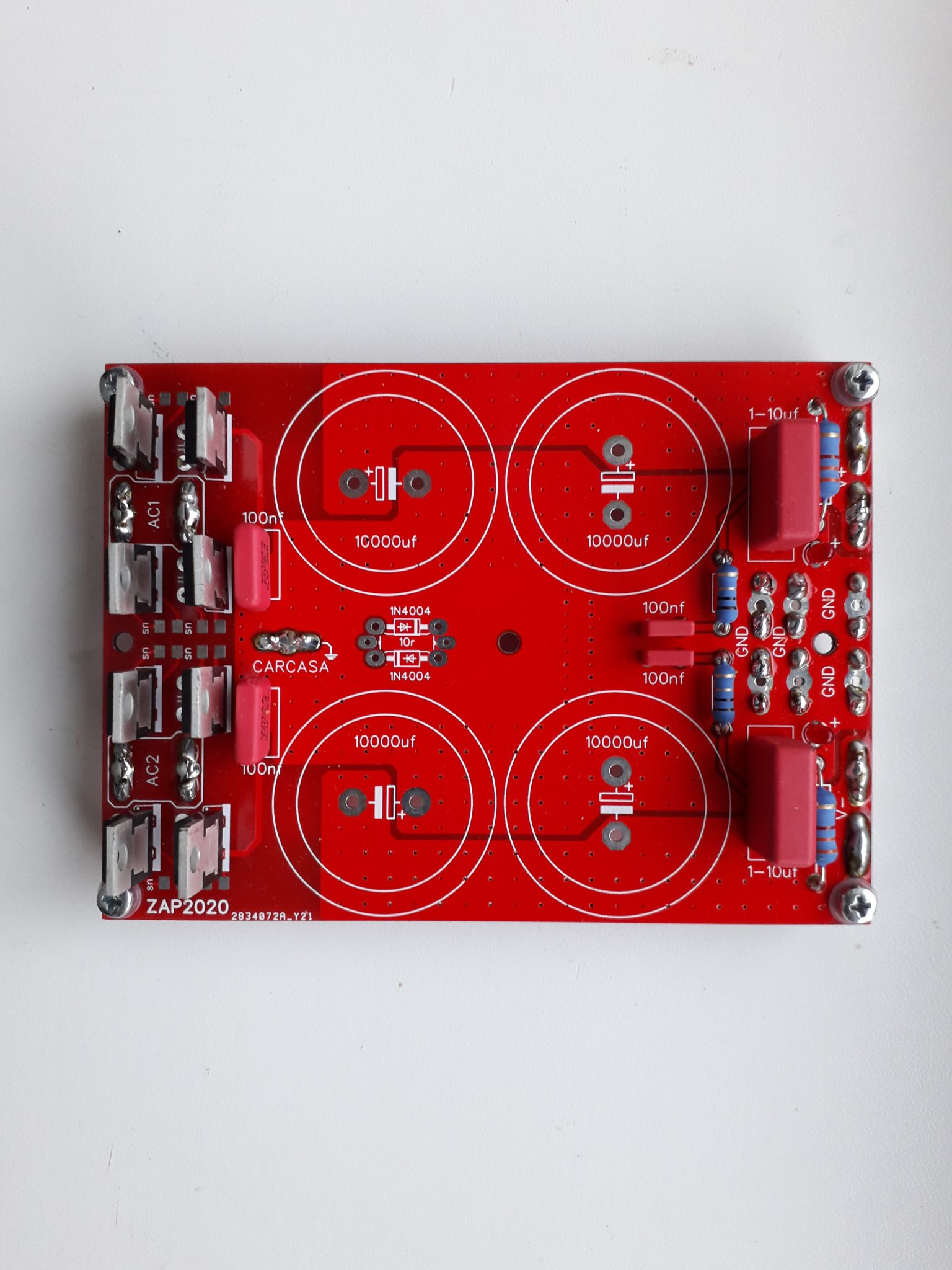

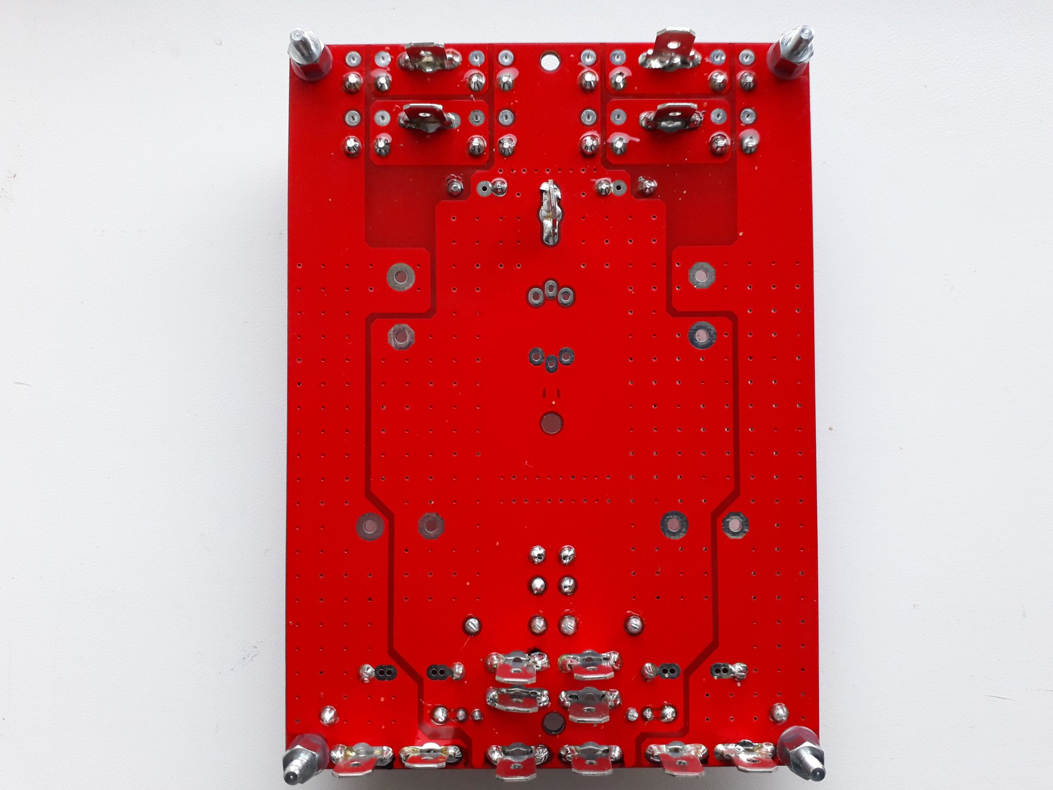

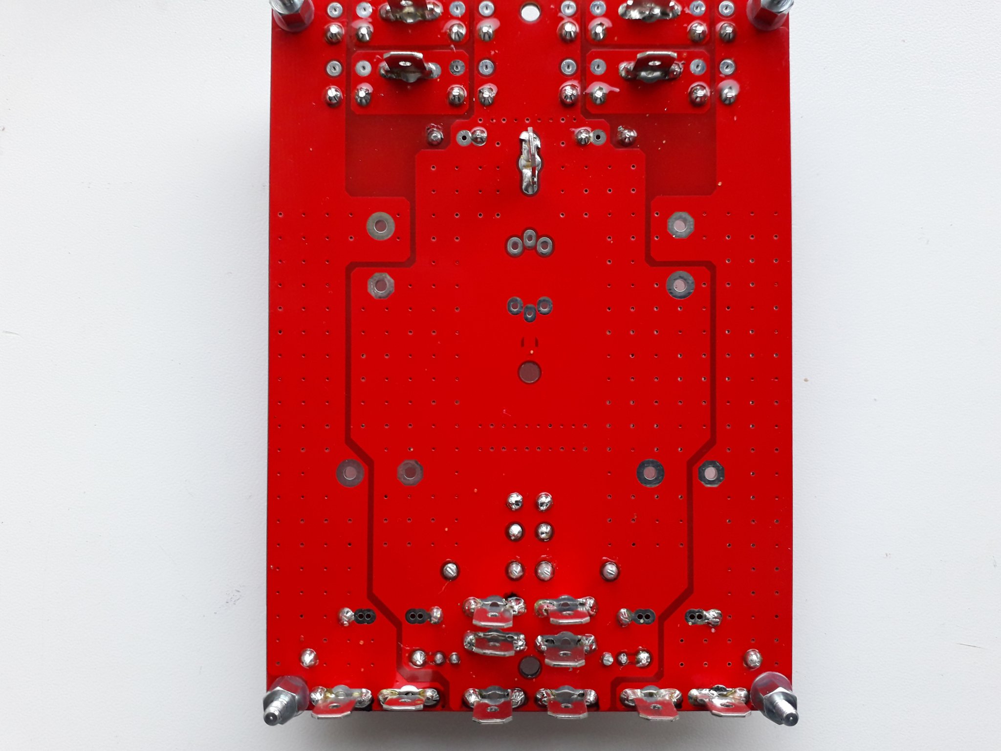

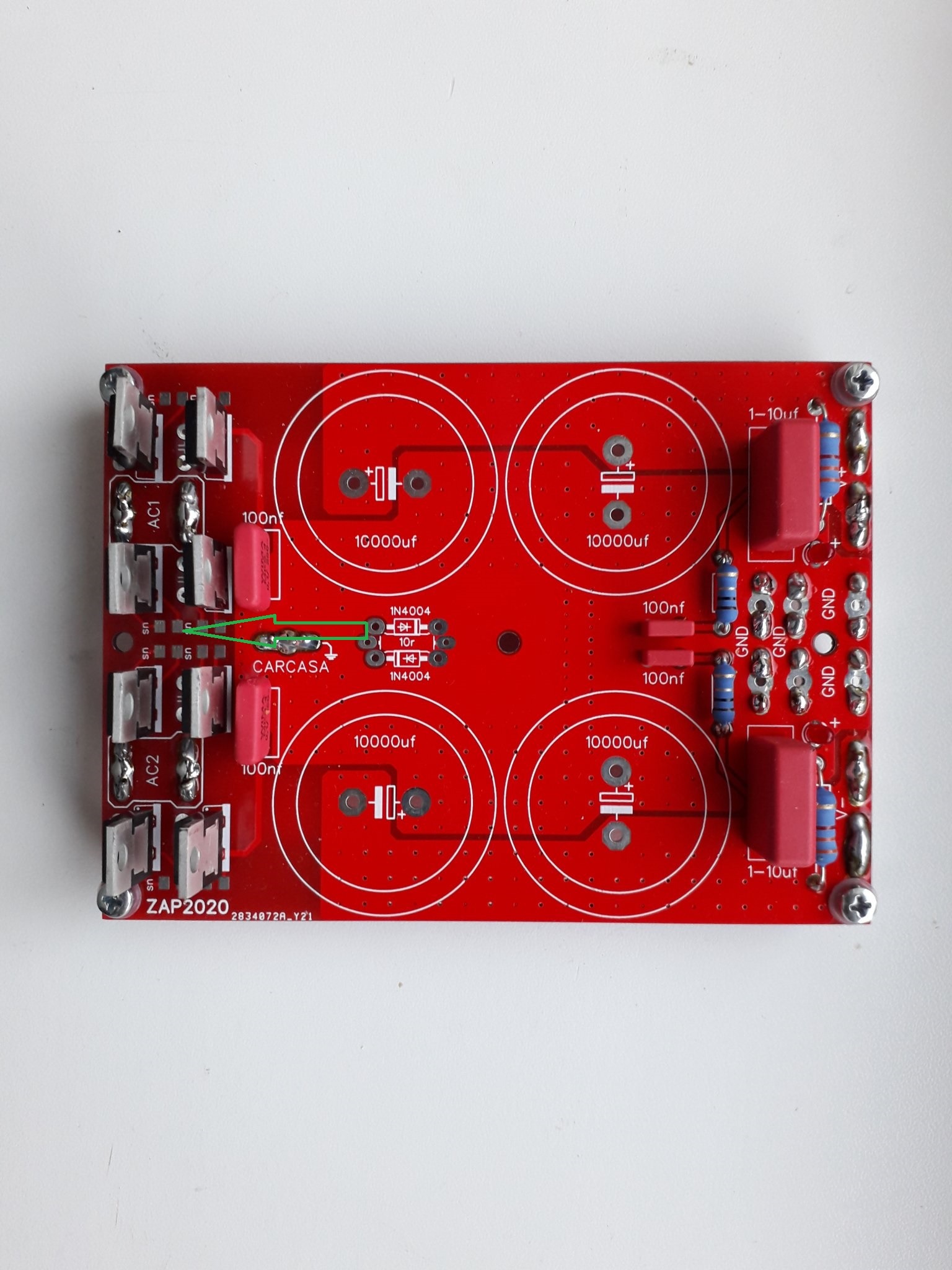

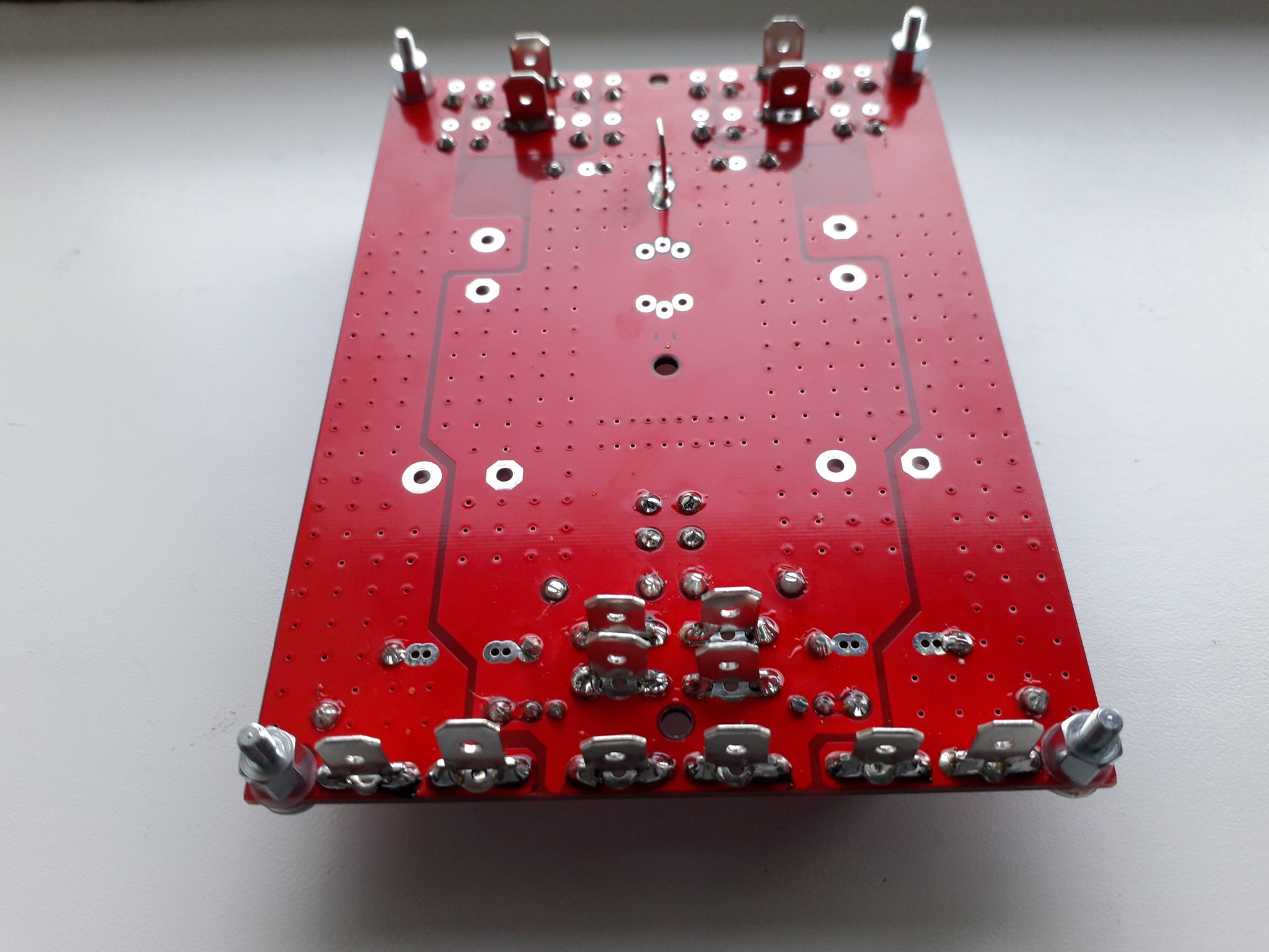

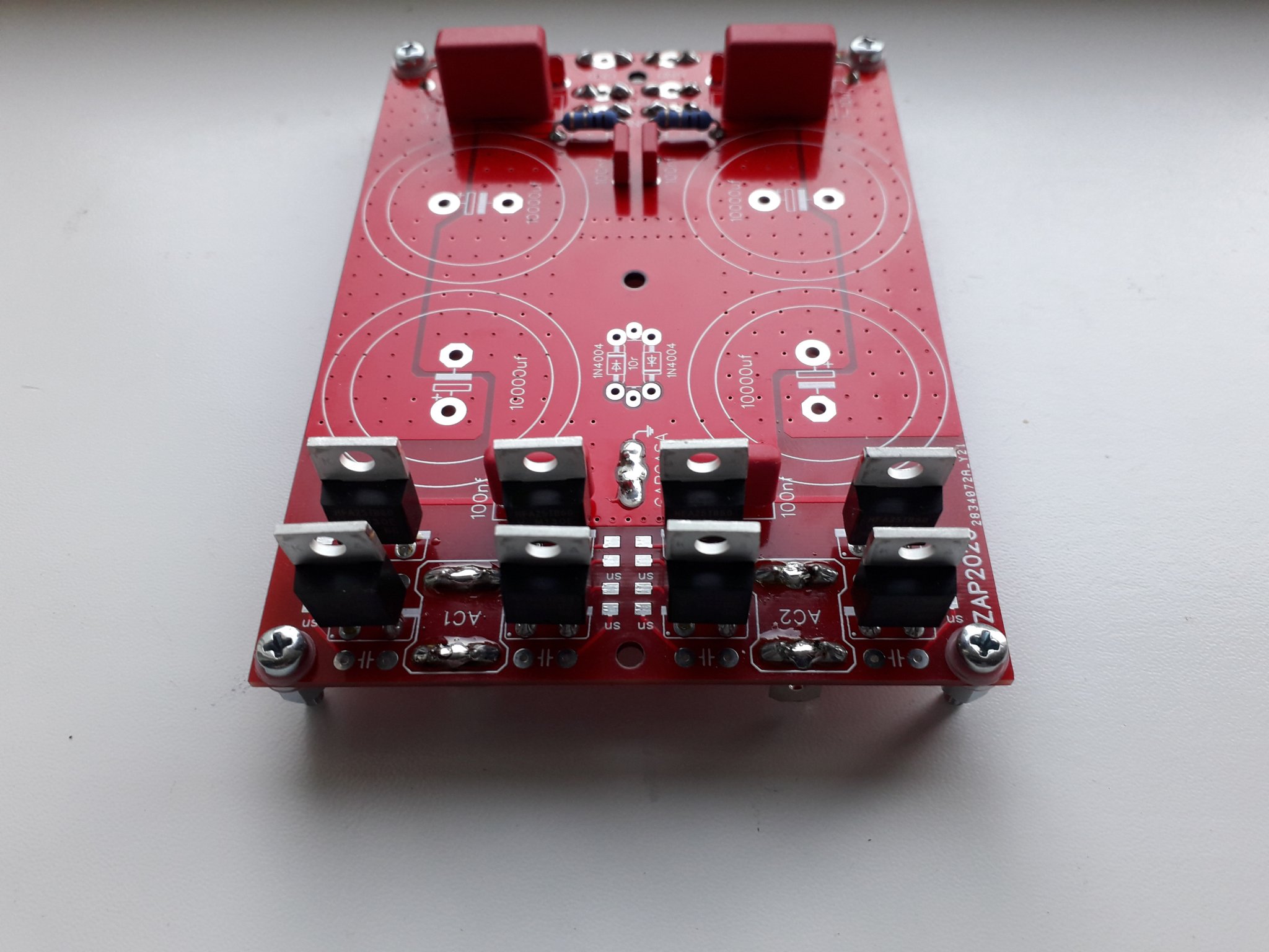

and PSU wiring for amplifier power supply (attention I made the plug for my needs)

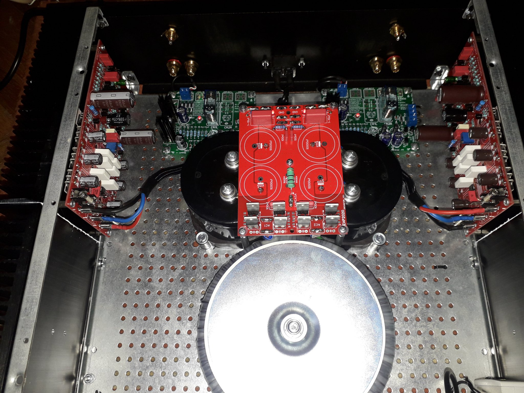

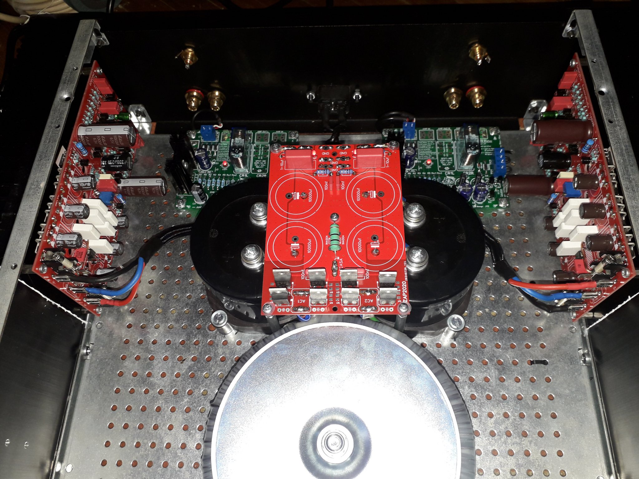

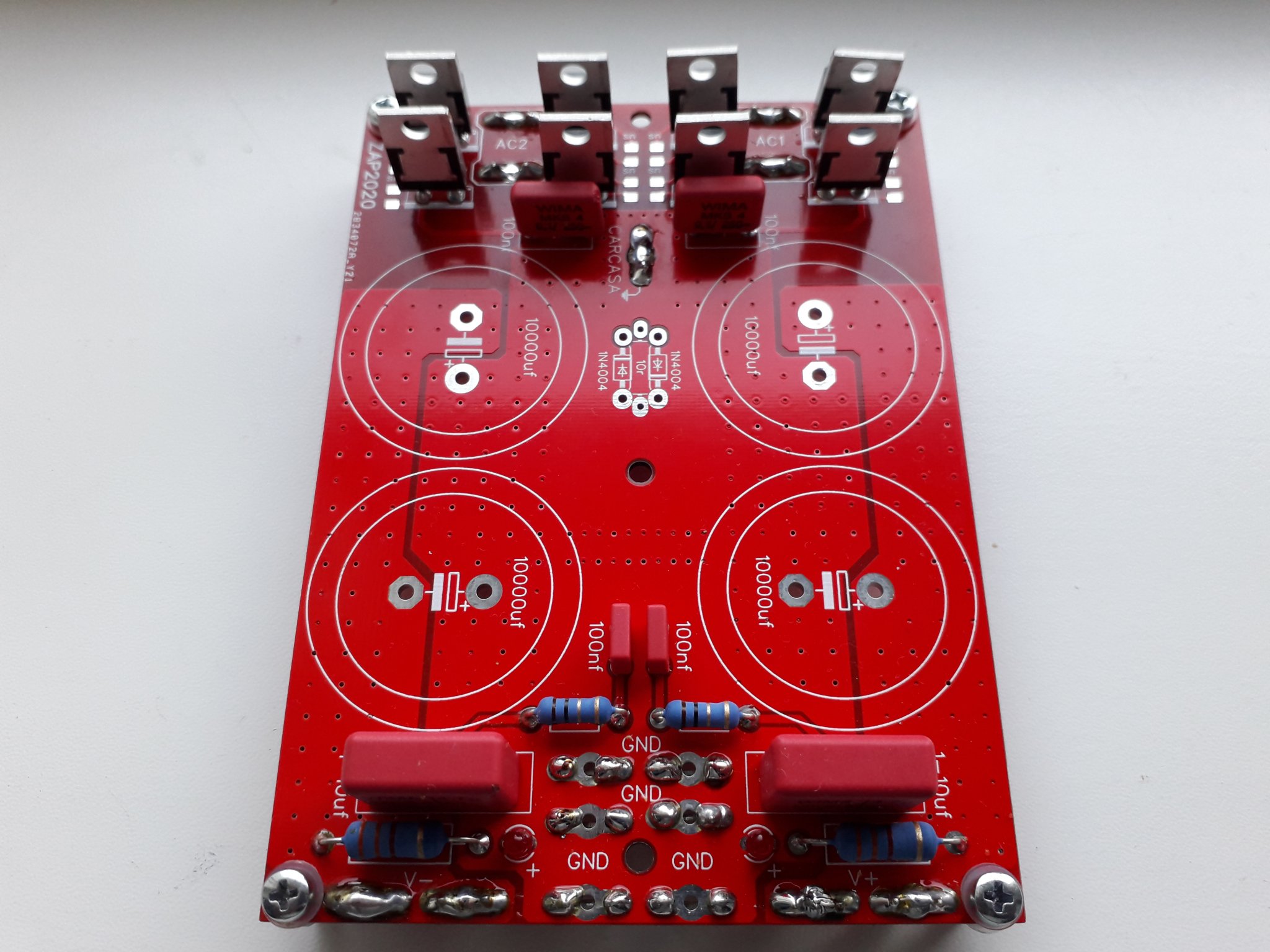

As you can see we have two diodes D1, D2 and a resistor R4 in which they must be connected to the amplifier housing, how is it better all 3 connected to the housing or only two diodes D1, D2, or only the resistor R4?

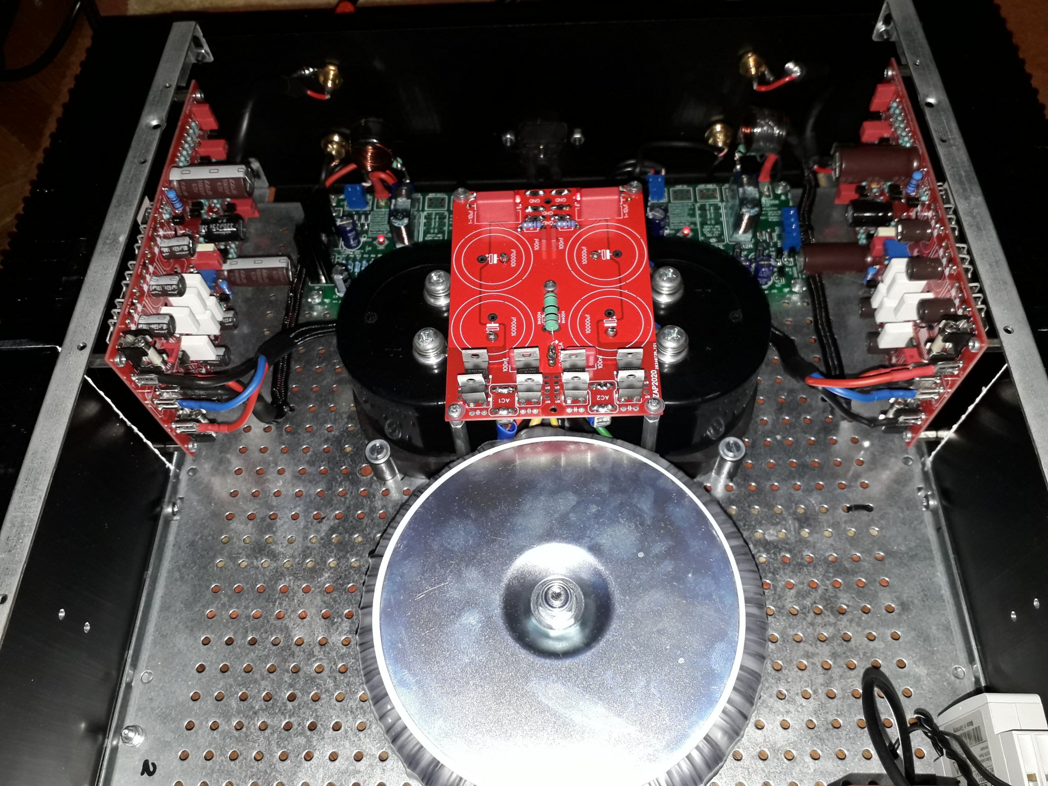

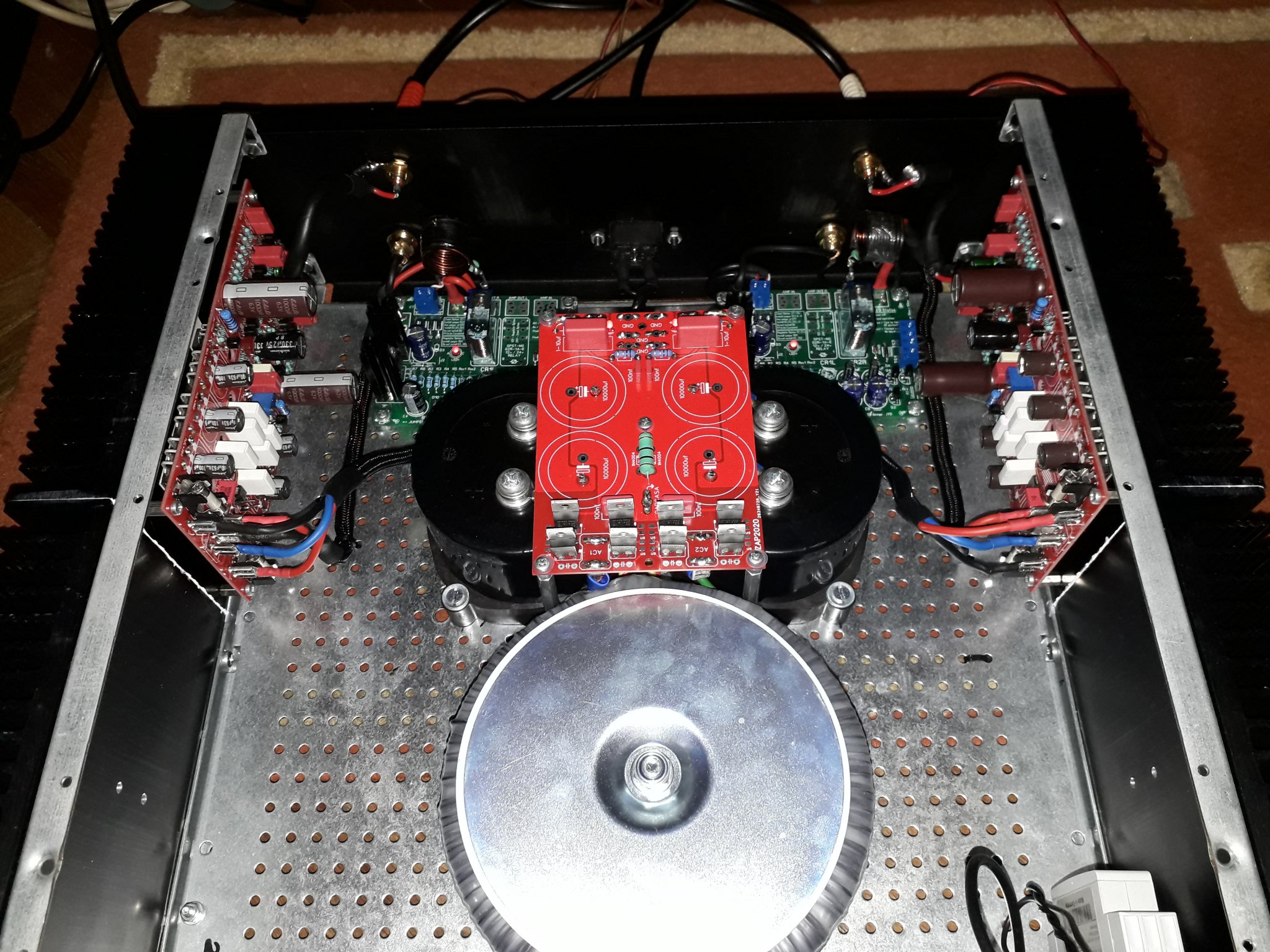

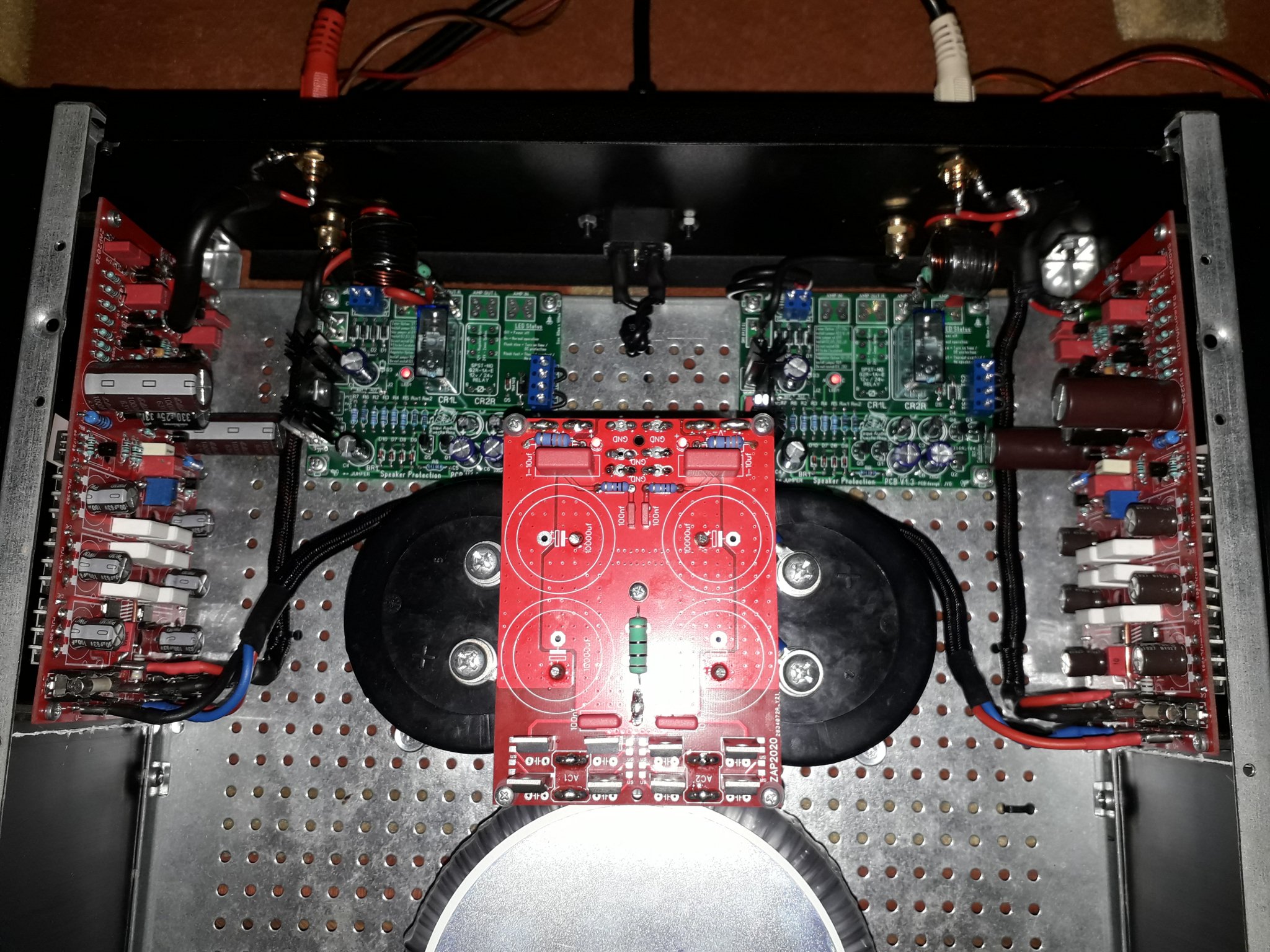

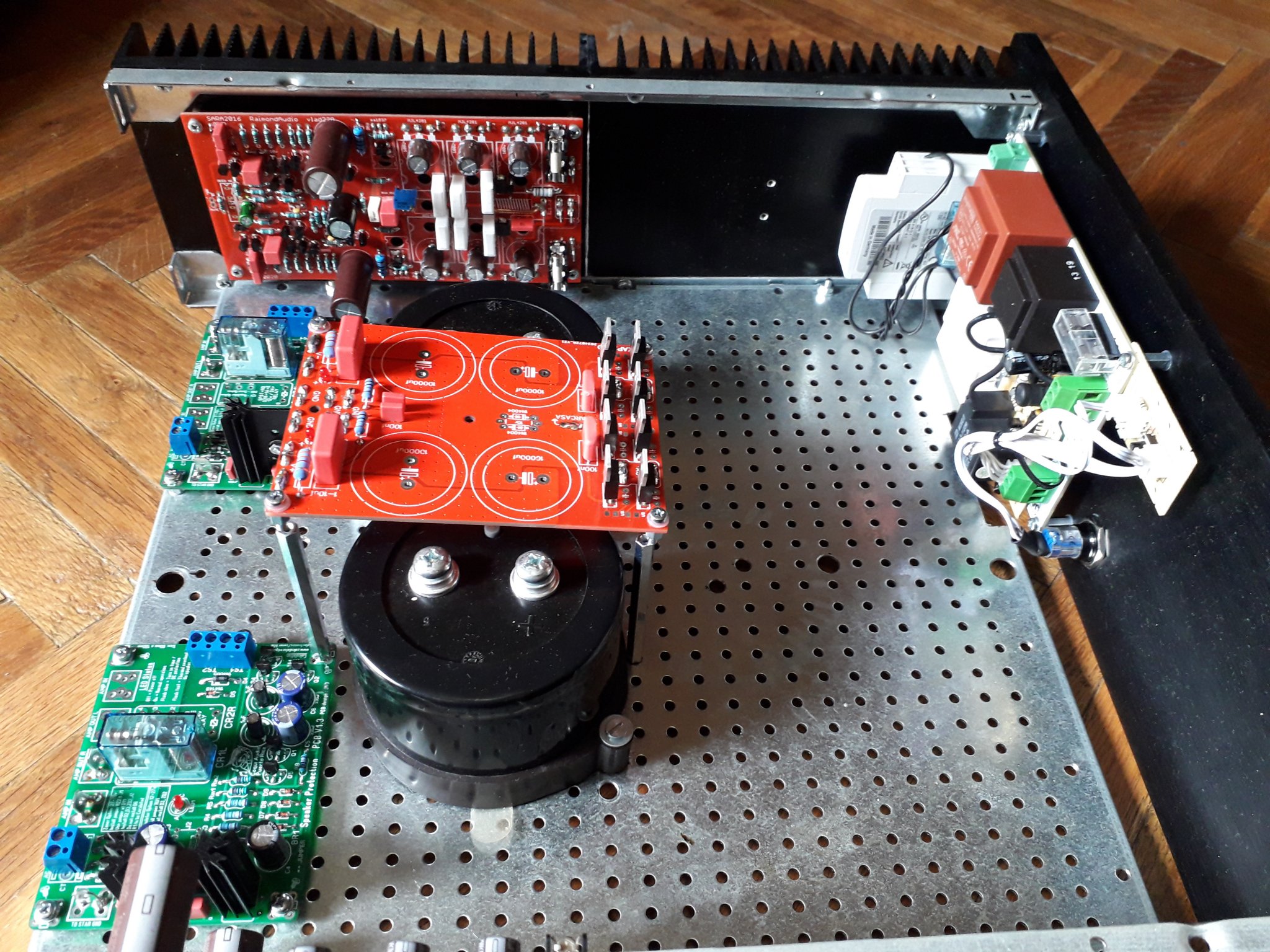

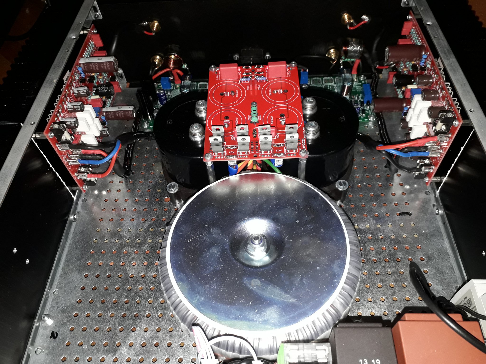

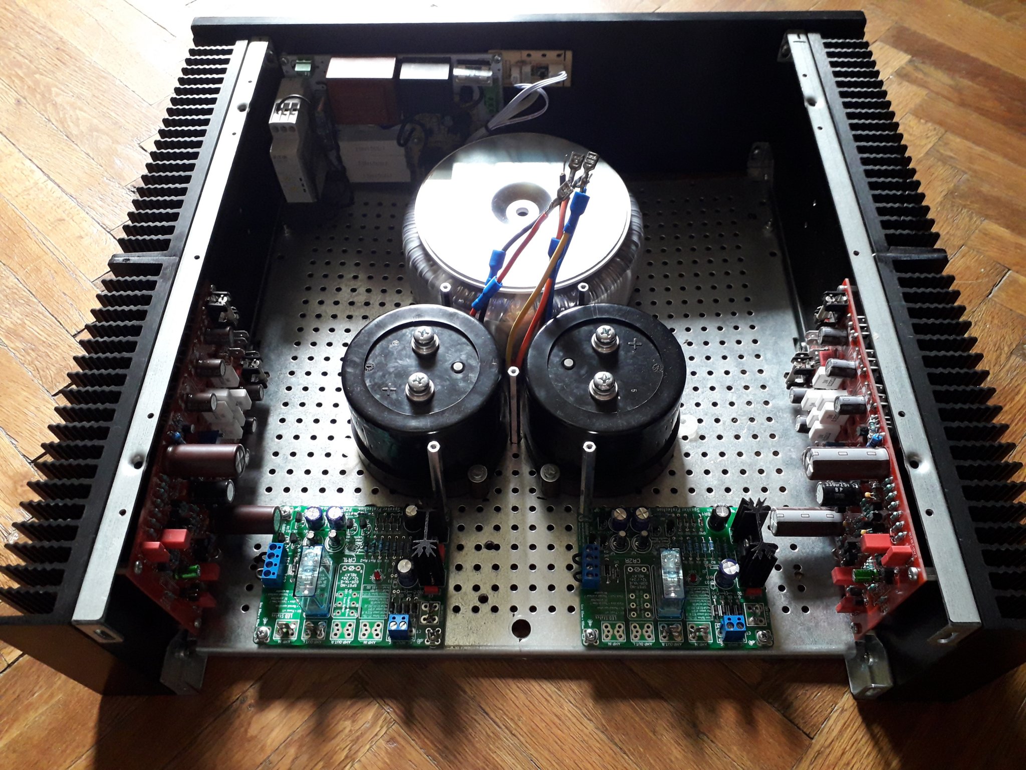

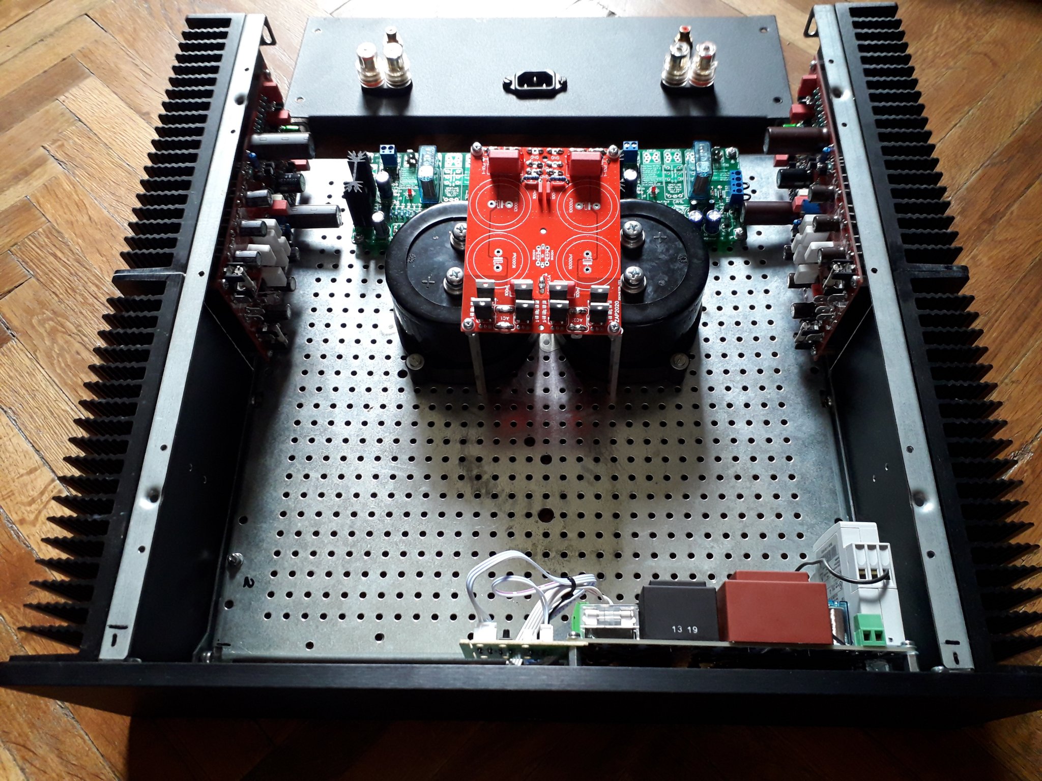

A little more work on the high-performance SARA 2016 amplifier, connections and more ,,,

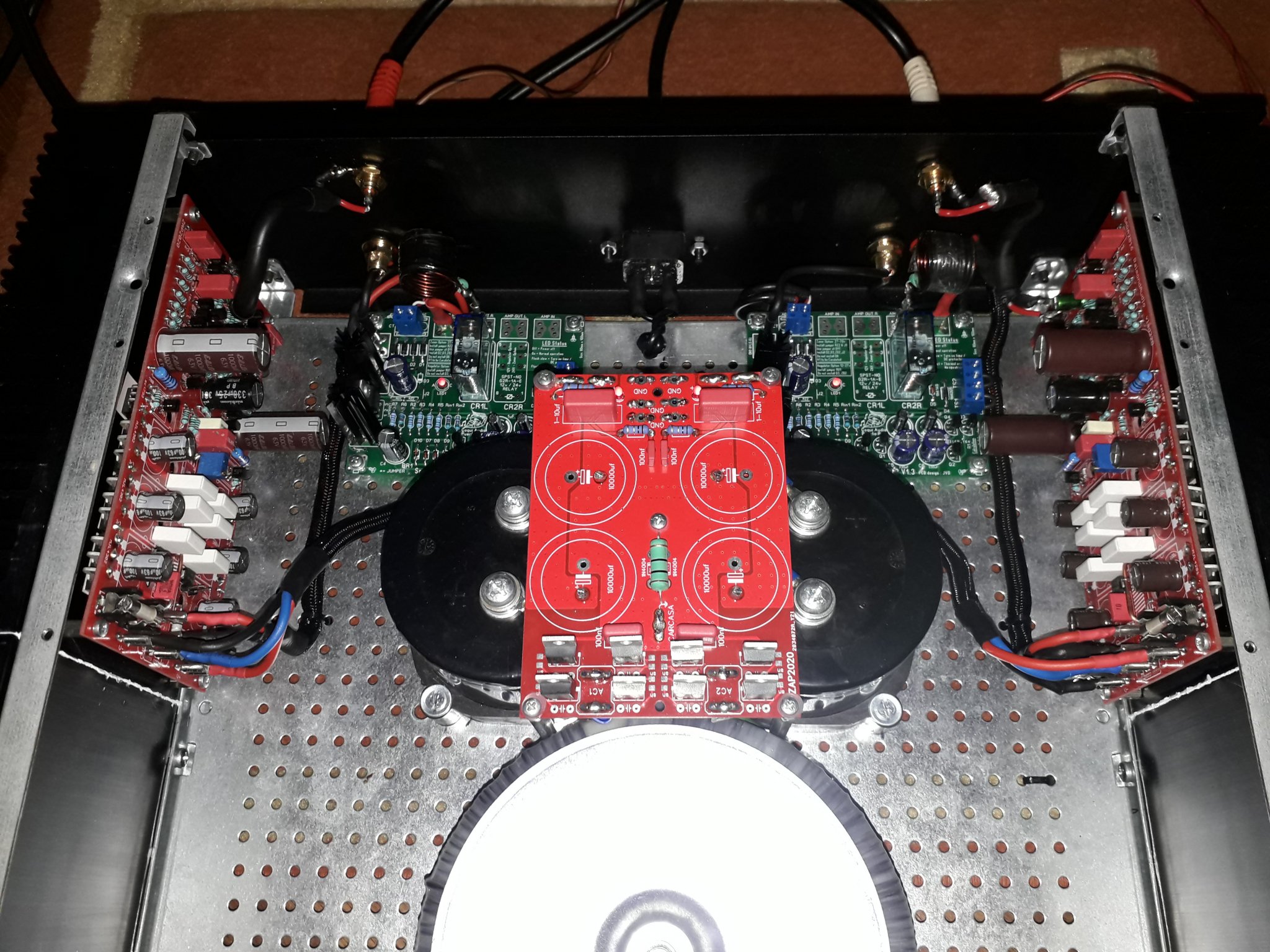

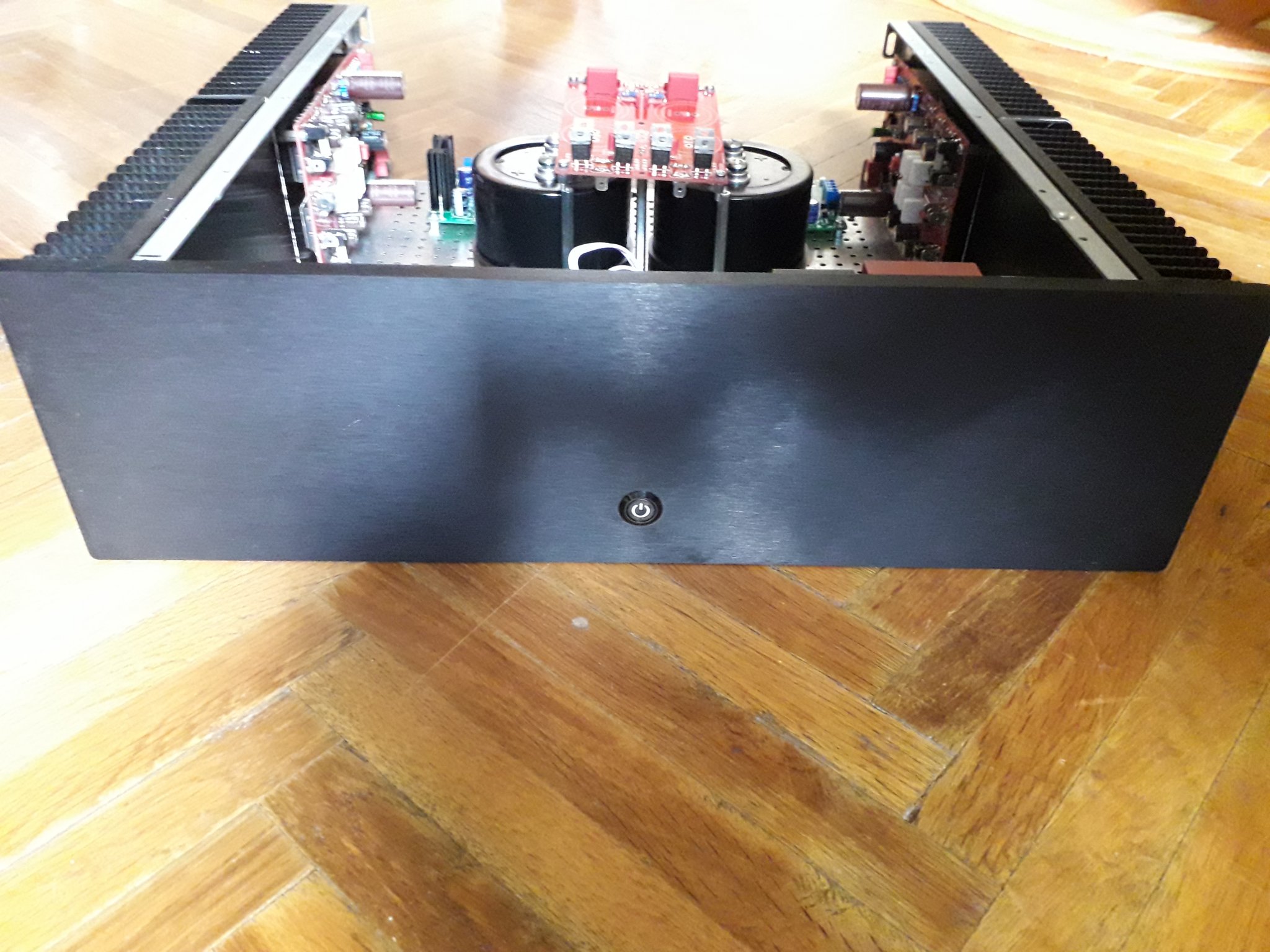

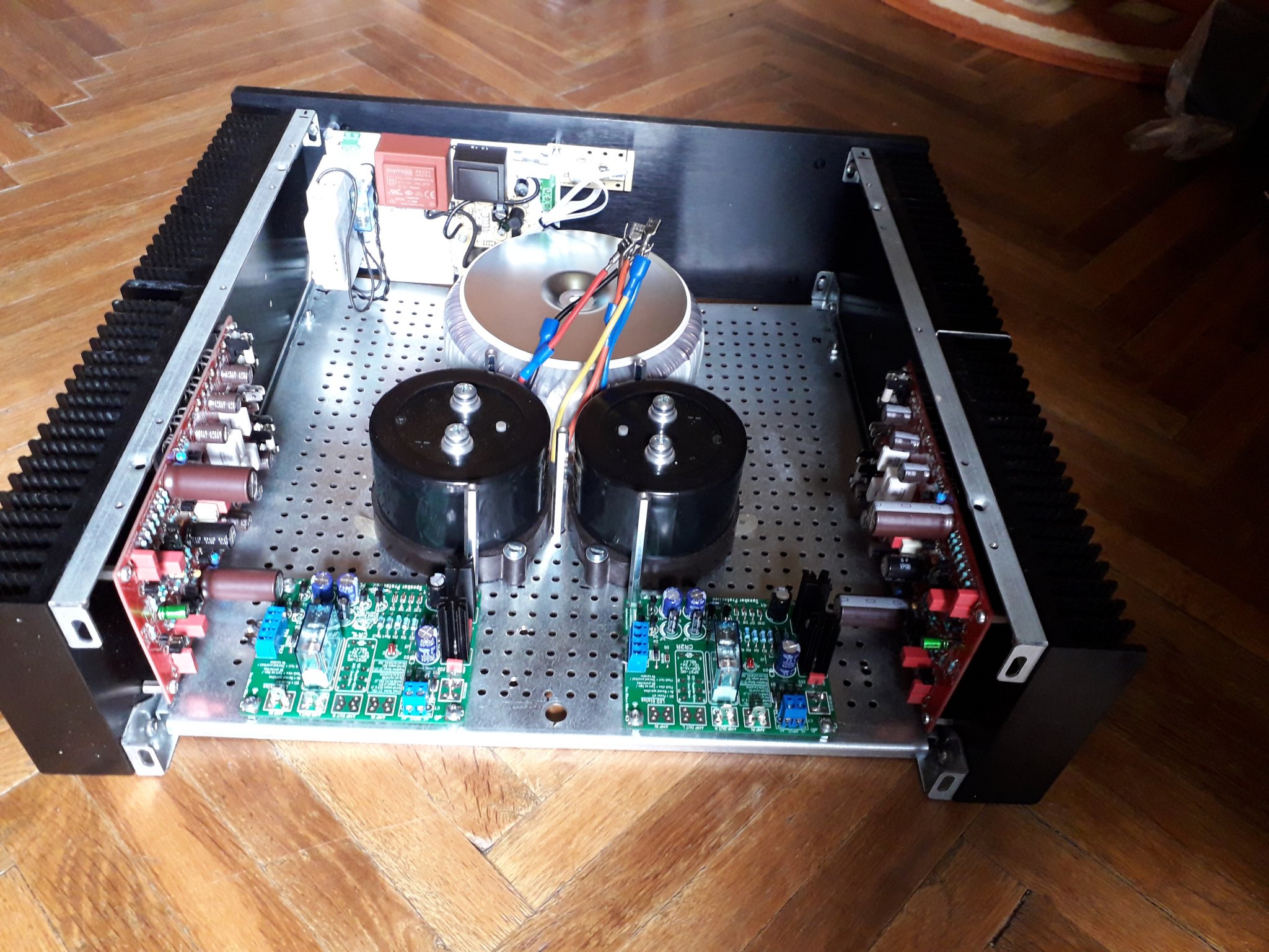

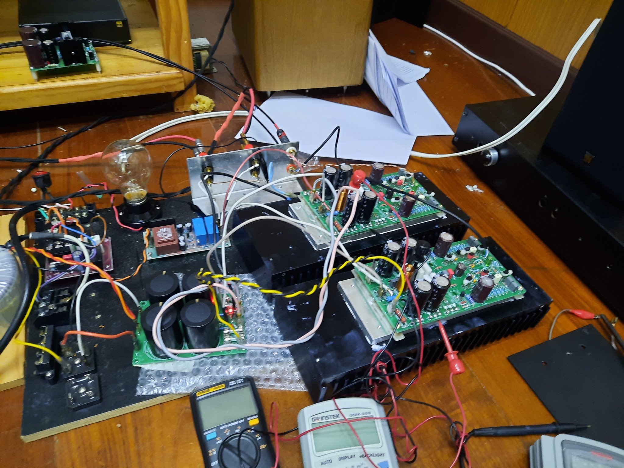

Last checks on the amplifier before being completed, voltage 56.5 ± DC on both branches, bias adjusted to 15mV, offset 3.9mV, of course I will mount the L=1.5mH coil with 10R resistance in parallel

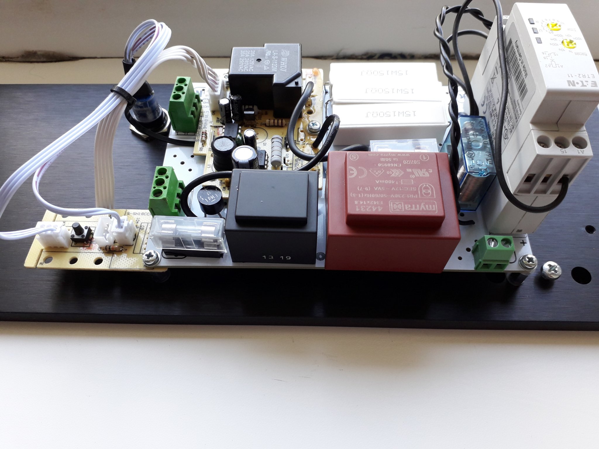

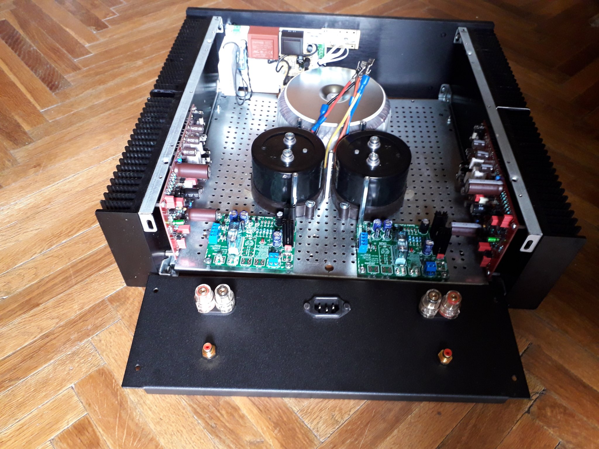

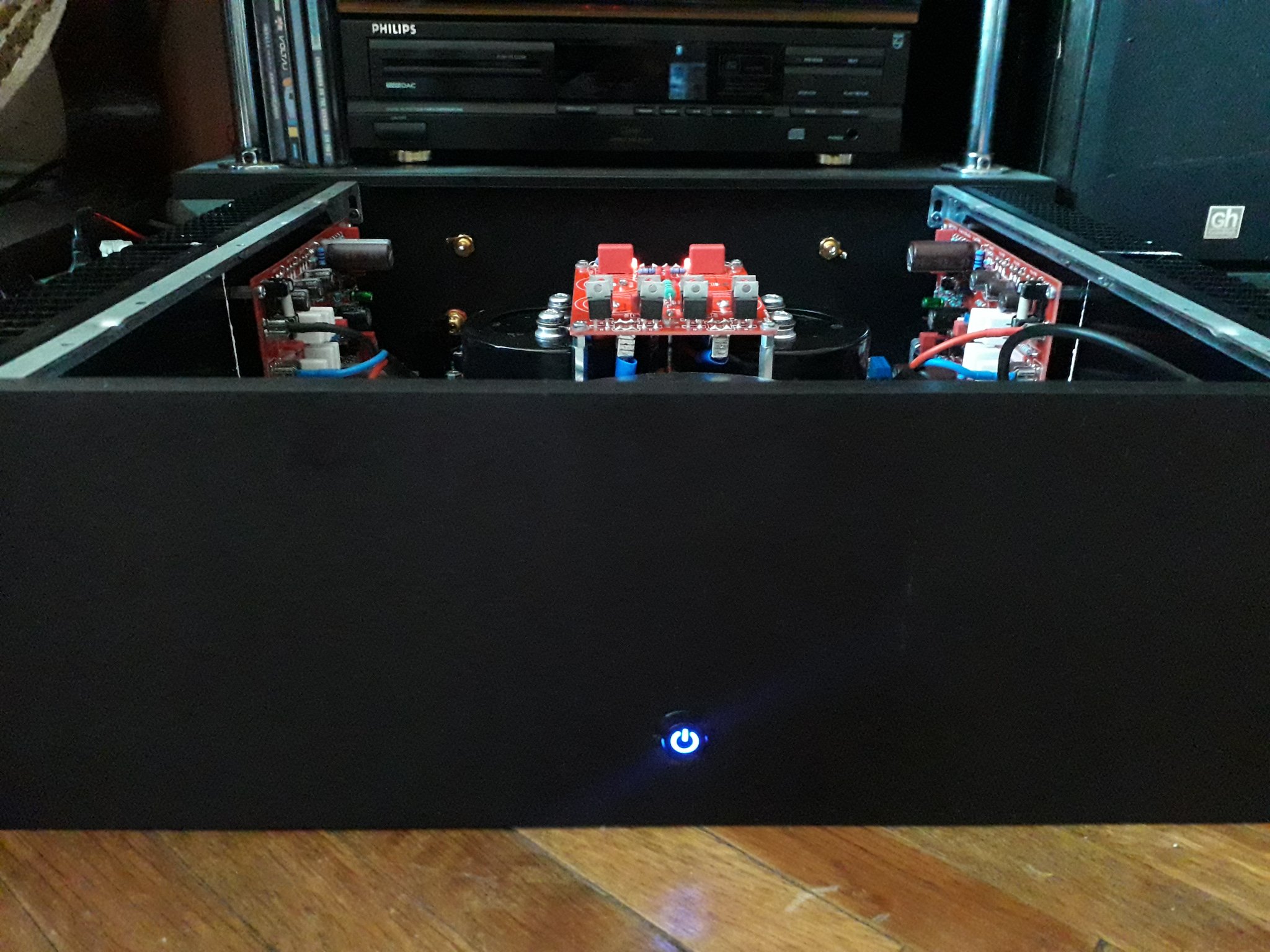

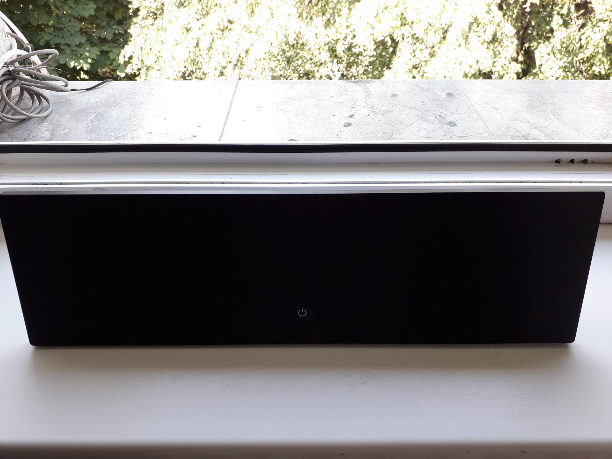

The finished amplifier put to the test, I am amazed by the fact that there is no background noise (with the volume at maximum, the first time I thought there were some problems with the speakers, I went to listen to nothing but honestly no background noise, maybe from the large capacitors in the filter) the amplifier works, what can I say, respect for whoever created the "
greierasul
" scheme, thanks

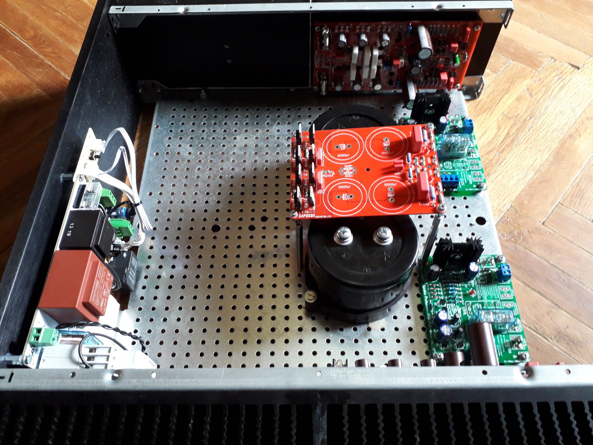

Hi guys,
I am about to finish a simple project 75W/4 ohm (class B), mirror pcb, dual mono.
Since the new year I want to put on Sara 2016 amplifier. I want to ask, what kind of boards did you have made? 1oz or 2oz...
Thank You!
PS: Does anyone have the original ONSEMI bc560c for sale? These are no longer in production. 🤣
Reactions: alexya

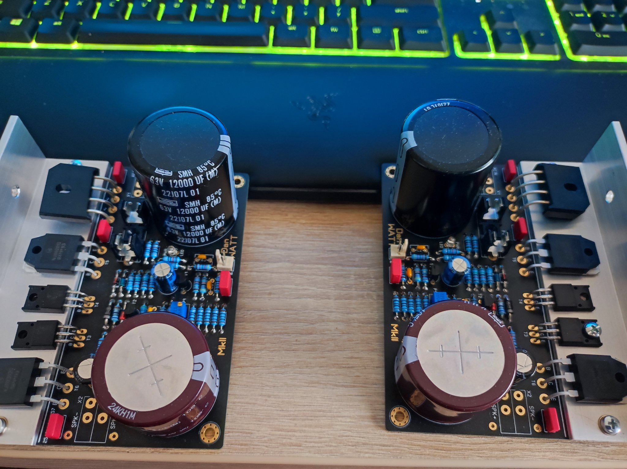

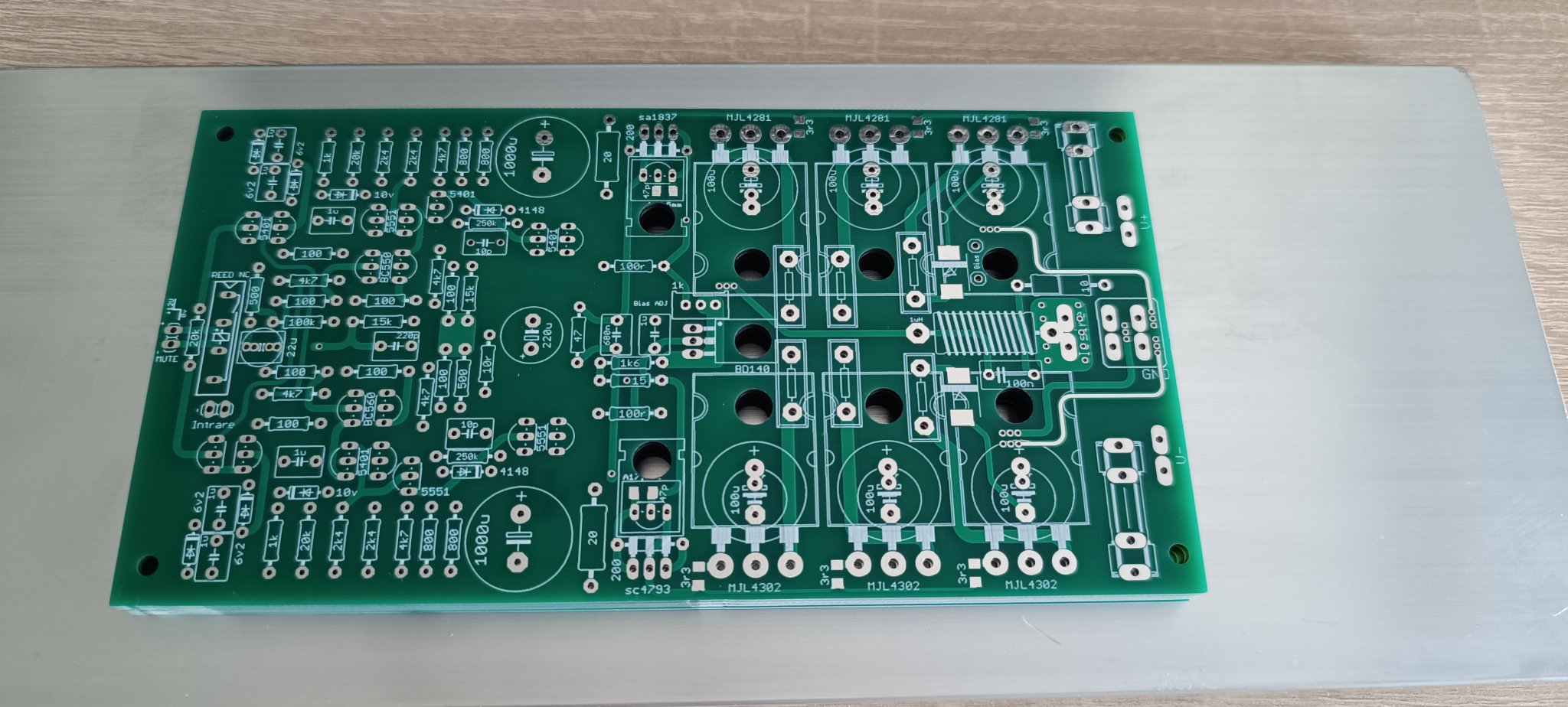

PCBs for SARA 2016 amplifier are already at home, ...I have all transistors for it in my home-box. I just need to order resistors and capacitors. Now I have the FH9HVX project running, so SARA2016 has to wait for some time. 😂
