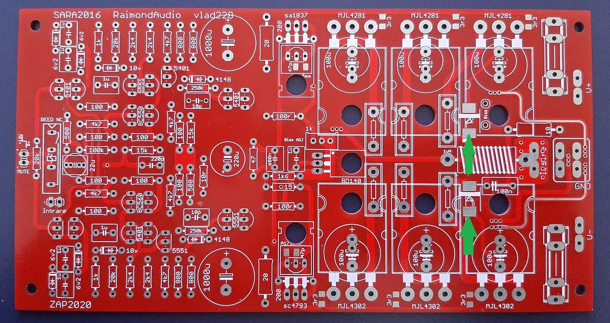

I do not know how good is the sound of Apex A40, A33, A23 or any Apex amplifier. They probably sound really good. All I can say is that S.A.R.A.-2016 has a great sound. S.A.R.A means : SymmetricAmplifier by RaimondAudio and 2016 is the year of birth.

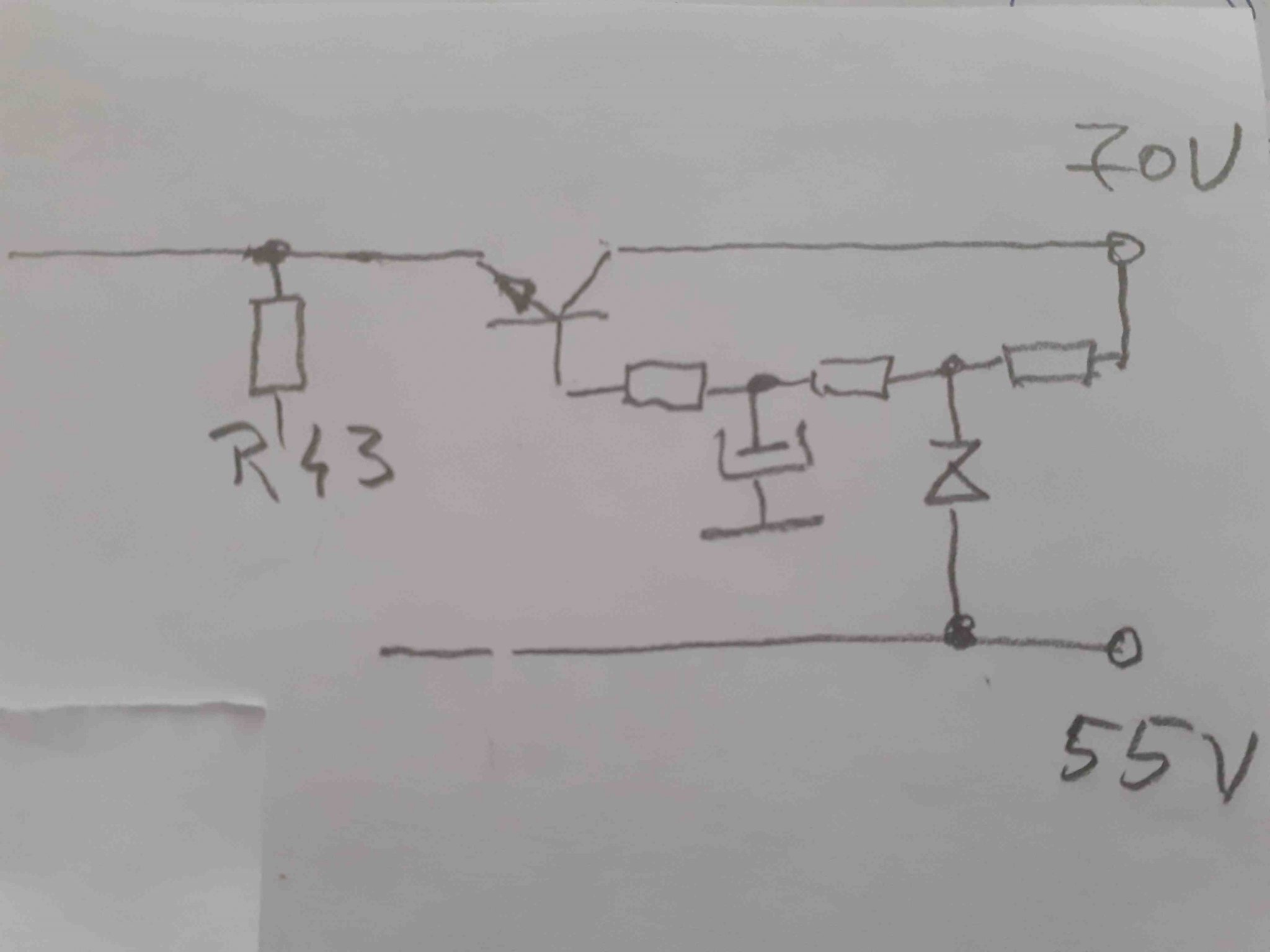

for GREIERASU . when I made my PCB instead of R61 (R46) I put an electronic filter that I can later modify in the stabilizer. I want to supply the finals and pre-finals with 55v and the input part with 60-65v. something like the next drawing. advice or help if possible. I use Google translate . anyway thanks in advance
I do not like where is the anode of the zener diode. I would like to be on GND instead of 55v rail. On that rail you have ripple and voltage sag, is not a fixed potential as GND is. Ok, maybe you don't have 60v-65v zener diode but you can stacking 4×15v zener diode + 5.1v

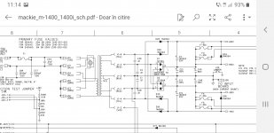

He's using also an rc(electrolitic) r(c BE) filter after the zenner... That should reduce that sag effects.His idea is actually ok even without any rc filter because you don't really want the drivers 30v higher than the final transistors when that sag takes place and the zenner could actually be paralleled with a capacitor to make an efficient bootstrap increasing linearity.Some do it right by design.

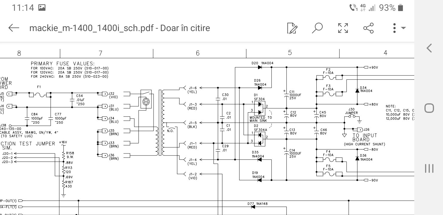

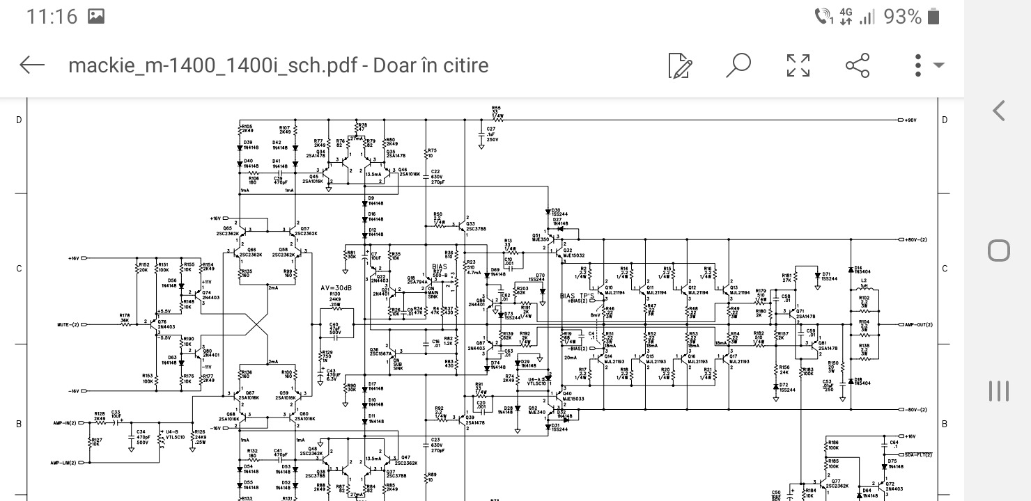

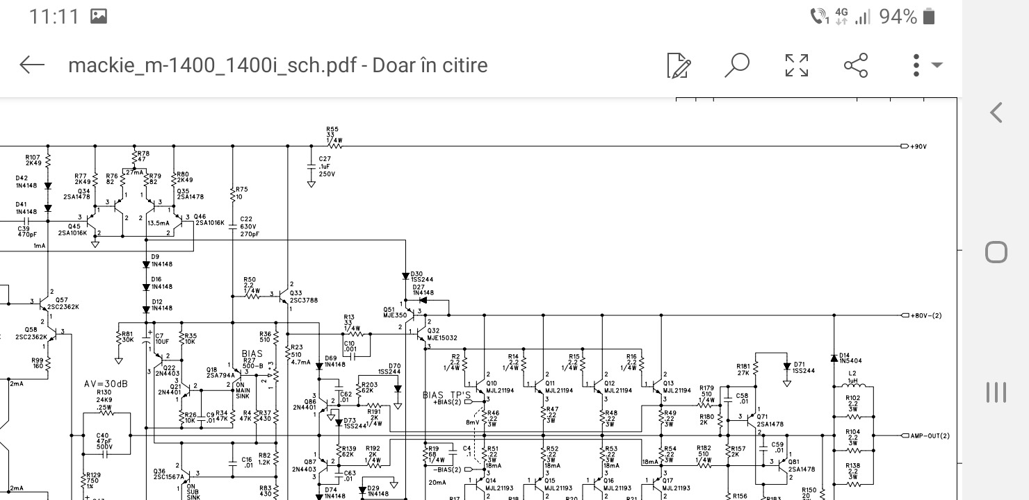

You know there's a beast outhere called Mackie, don't you?
