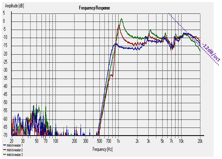

it looks like the newer version plays from 900hz and up compared to the small one that played from 1400hz crossover point. so i dropped it 500hz, but i encounter some more problems in the membrame stability area.

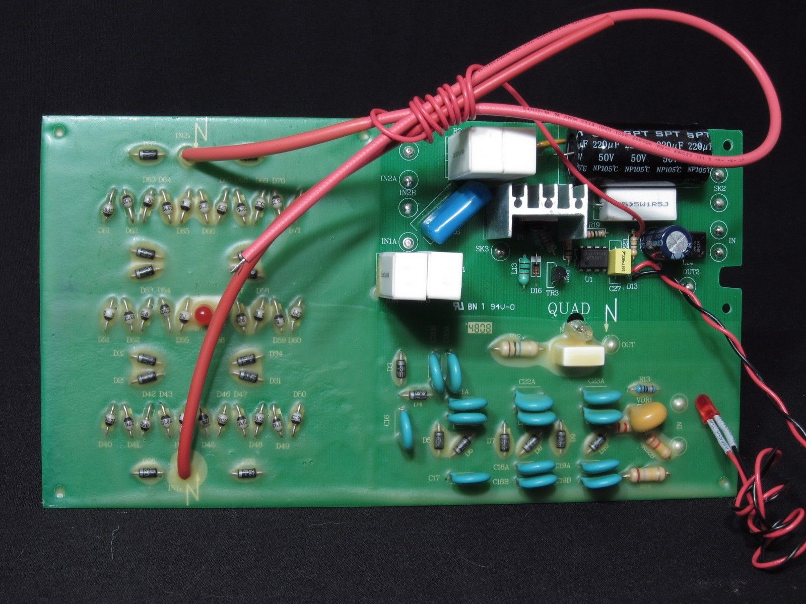

The later Quad limiters are attached on the secondary side of the step up transformer.
They are built from a string of zener diodes inside of a diode bridges.

AH thanks Bolsert, was looking on google and could not find anyhting 🙁 and you scoop up a nice post about it 🙂
ai that still looks rather complicated, maybe for most this is simple as it gets but for me... what if i use the amp i use now, it has a maximum output voltage i presume. what if i adjusted the turns ratio for that to get a (nearly)max output before arcing? so people would hit the limits of the amp before anything tot he esl goes wrong >?

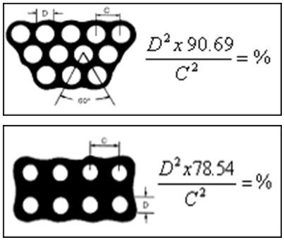

1.9mm center to center? just looking at the pic I guessed more like 1.6mm - 1.7mm....well about the holes i cant seem to find the file of the first 2 stators i made... but the 1 mm version has 1.9 mm from center to center.
In any case, this is < 30% open area, so not quite as open as your original panels.
Formulas for calculating open area percentage shown in pic #1.
If you don’t like to do the math, there are several online calculators you can use 😉

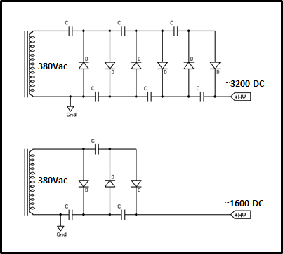

When you say 3 stage, do you mean 3 diodes and 3 capacitors? or 6 (ie often a stage is considered 2 diodes and 2 capacitors).…i lowered the bias. i measured 380 volt on the input and its a 3 stage multiplier. so 380 *2 760 *2 1520 * 2 is 3040 volt, thats maybe i bit to much
See pic #2 for estimated, no-load, voltage multiplier outputs for both.

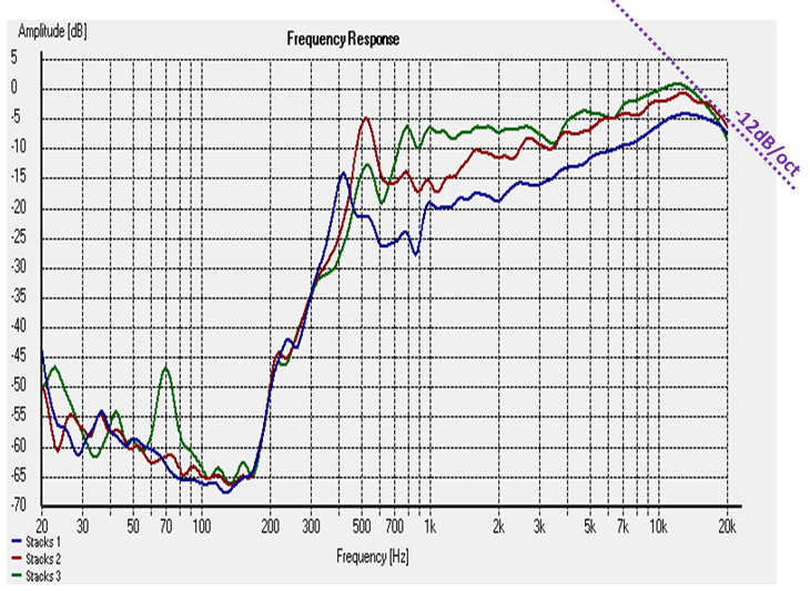

I noticed that all your measurements show a -12dB/oct roll-off at the top of the audio band. This 2nd order roll-off is usually associated with bandwidth limit of transformer or microphone(you had mentioned it was not calibrated). As an example, you can see the -12dB/oct roll-off in most of the Panasonic microphone capsules I posted. Most economy measurement microphones use the Panasonic capsules or something extremely similar.
http://www.diyaudio.com/forums/plan...request-amt-heil-diaphragm-4.html#post2586319
However, in attached pic#3 and #4, it appears that the roll-off point may be moving lower in frequency with increased panel capacitance from adding sections so that makes me think that it is related to the transformer. But, it could be a combination of both.
Although unlikely, it could also be your sound card, or soundcard driver.

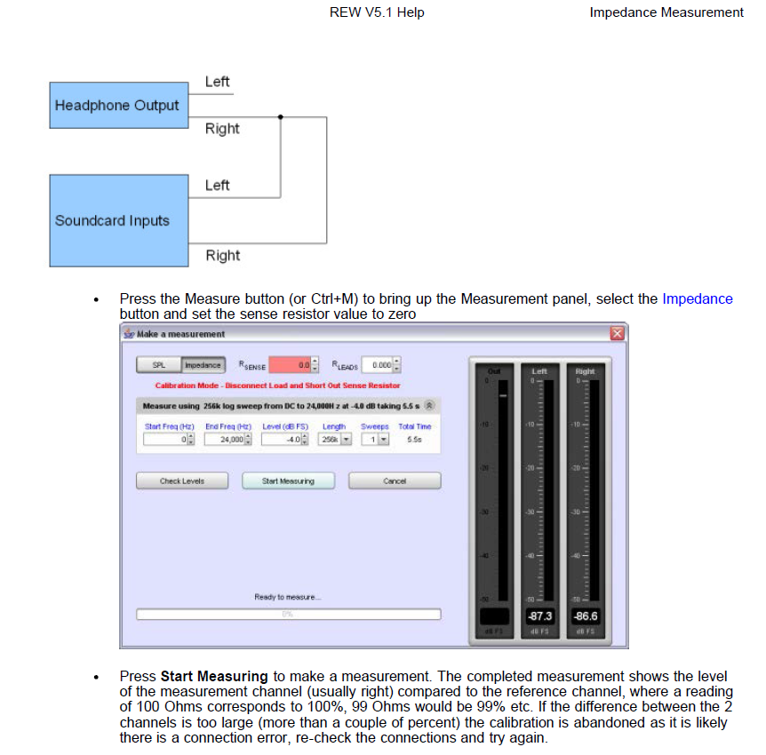

If you haven’t yet, you might try performing the REW loop-back test to confirm that it isn’t sound card related.

Ho Bolsert, i rechecked the spacing from the holes and it is indeed 1.9 center to center. i calcultates openeniss a few times 🙂 but usually with a square pannel, that makes it easy to count te holes, since the programm i used does not let me see how many points i selected, i have to count them 🙁 with square panel ofcourse only 2 rows🙂.
About the Bias i used 2 caps and 2 diodes as one stage, as in you picture
same as here but used 3 instead of 5
yes the roll off. the thing here is i do have a calibrated Umik microphone, but ofcourse not my laptop. problem here is i can check that only with a loopback but then im not sure what i am checking my line/mic in or my output. 🙂 because my calibrated mic is an usb device so it wont use the mic or line in.
but ofcourse when there is such rolloff then changes are verry high its the laptop at fault. (wich i dont think)
i could also measure it without dsp in between see what happens, ill do it now fast before i have to go 🙂

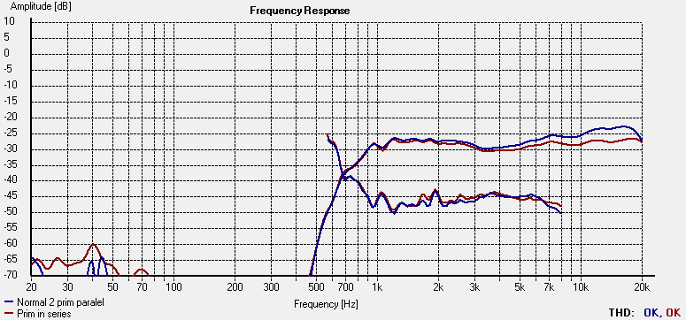

Ok measured with and without DSP , well there is nothing wrong there, as one would expect. then i measured the panel with primaries in parallel and once with prim in series. does this tell anything? ofc i got lower output, but it looks like the 12db point shifted to, or is it just flatened?
the loopback i can maybe measure tomorow, since im not sure if i got such cable around might need to make one.

Oh god i feel like a tard 🙂 i always calculated the area of one hole , times the holes then the total amount of surface area they are sitting on and calculated it back to percent 🙂 hahaha i found the calculators THis is exactly what i need 🙂 !!!! i even read ur post and still did not get it.... dumb
this makes everything so much easier
Yes, an impedance .vs. frequency measurement made with REW would tell whether it is the transformer causing the HF roll off. If it is, you will see a minimum right before the roll off starts, and phase will pass thru zero. But, you would still probably need to perform the loopback calibration shown in the manual to ensure validity of impedance measurement.BTW can it also be seen in an impedance response measurement? i could make one more easy then getting 2 mini jacks at the store 🙂
Did you shift the series measurement up in level by 6dB to match the parallel measurement so the HF difference was easier to see?.. i measured the panel with primaries in parallel and once with prim in series. does this tell anything? ofc i got lower output, but it looks like the 12db point shifted to, or is it just flatened?
I agree, it does look like the roll off point shifted.
Well i indeed upped the volume to match the other Measurement. I indeed use rew wich I calibrate with the test resistor, but I dont have a voltage devider yet to use a power amP, so I am limited to the soundcard output.
