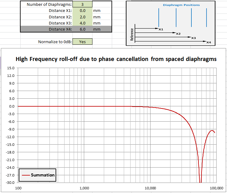

Concerning Phase Cancellation due to Diaphragm Spacing:
If I understand your construction correctly, the diaphragms are spaced 2mm apart. Is Pic#1 correct?
If so, this would result in very little phase cancellation just as you measured.

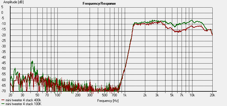

I will measure them with a 100k resistor right now to see how the plot looks.
Quick measurement 400k and 100k serie resistor on outer ring for the same 4 stacked.
i should remove one stack tomorow 3 is the max with 2mm membrame spacing. as you can see the high falls of at 16 khz with or without 400k or 100k
i added a support dot to have the membrane not colapse into the stator, and it *** up a part of the high frequency response, and its hard to compare to the measurements from yesterday. might need to make some new ones and start all over (and change the resistors when adding stacks, in theory we know 3 is the max for this version.) 🙁 i do have the feeling that i might use somethign like this. i like to make bigger size tweeter that plays from 600hz and up, would be awesome
with the 100 k serie resistor i got more output, but it also affect dispersion a bit, although when i move my head it is still no comparison with a normal small panel i can freelly move

Always need to be aware of series resistance when plotting trends for added panel area or sections because of the increased capacitance.
Most of the plots I post are made in Excel.By the way Bolsert what programs you used to make all those nice graphs?
I find it really convenient to be able to quickly plot comparisons for any equations I might be interested in rather than searching for a piece of software that probably won't do things exactly like I want anyways. For example, the amplitude and phase for 1-D wave propagation for any distance from the source is a very simple formula(Eq 1.5). Using Excel, you can place diaphragms at different distances from each other and sum the resulting output.
Attached is the Excel spreadsheet I used to make the plot.
(You will need to have the Excel Analysis Tool Pak loaded/activated)
https://www.add-ins.com/Analysis_ToolPak.htm
I had been considering similar point-source mid-tweeter multi-diaphragm arrays, so already had a spreadsheet created for 1 to 4 diaphragm.
As a test case, select 2 diaphragms and space them 8.5mm apart and you should get a null at 20kHz(as Calvin mentioned).
NOTE: this calculator only show contribution to response from phase cancellation of spaced diaphragms.
It does not consider anything else, like diaphragm mass, stator transparency, etc...

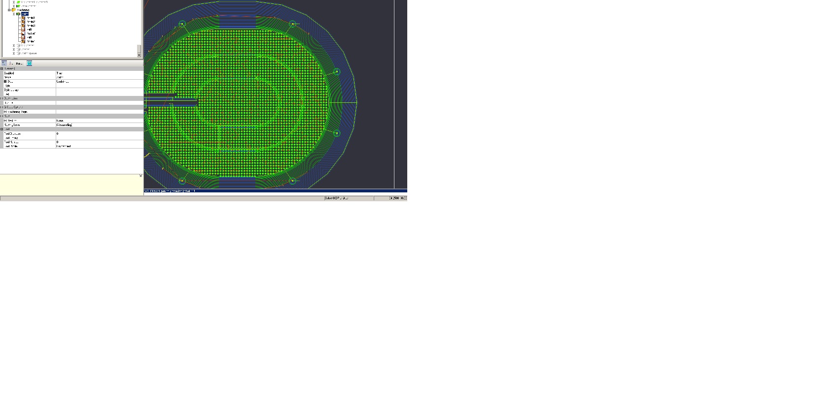

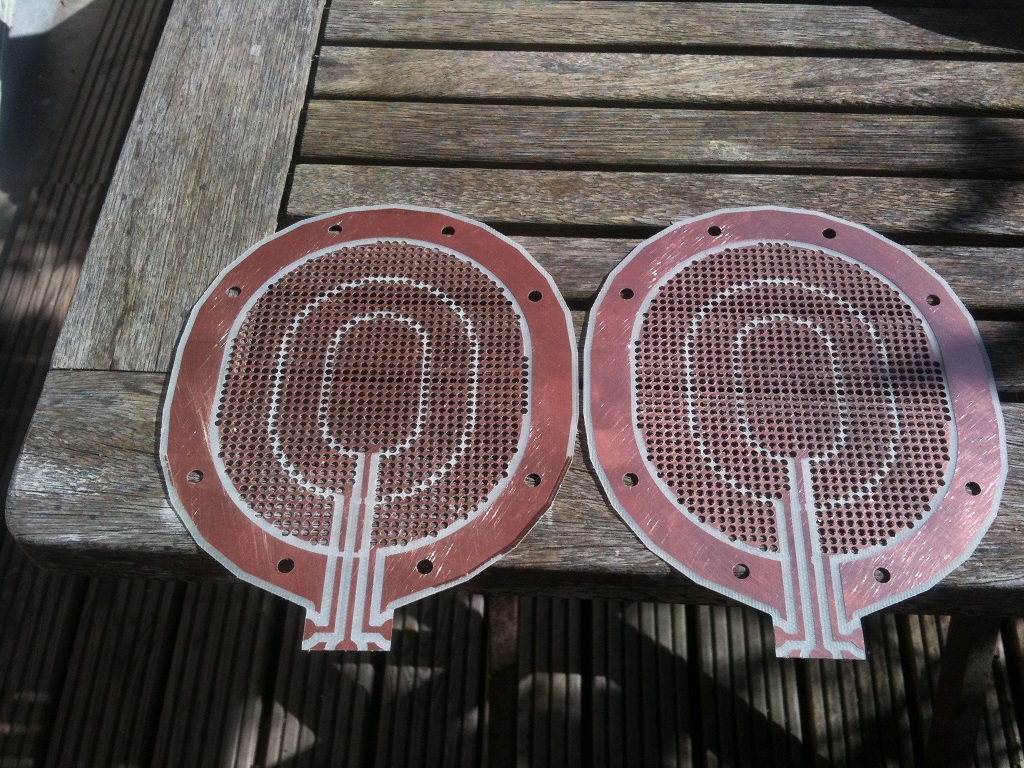

i increased open area, and stuck with the 2mm tool.
i started today with things i could do before the pcb arrives, making some wires pre soldered to use later on, and finish the cad/cam drawings, leveled my board on the cnc to make a fresh start. I then tested the toolpath in thin air, since i had some problems lately with g code acting weird. well it sure did again. in between cutting and drilling the CNC machine moves the cutter to the desired place to go cut 🙂 these moves called rapids. i had one rapid that for some weird reason stalled one of my axis. and that is screwing everything up orfcourse since the machine does not know where it is actually(it does not keep track). so he keeps cutting, but in the wrong place. and in this instance it was even worse since it was my Y axis. the axis that moves the gantry around. it has 2 motors left and right because its the most heavy part that moves on the machine. when i actually move the axis at the same speed with the shuttle it is all fine i can even achieve 2 the speed the rapids where. but somehow when i run the code it stalls. so i was pretty sure it was a software related thing. well 5 hours later, it is not software. i ended up unscrewing one of the motors, the one ive seen stalling first (after a while) when one motor stalls the other one will to since it cant bend the whole bridge (thank god). well it appears that one of my motors is not turning freely, and when fast movements or high speeds are required it stalls (this is what steppers do if the rottor stays behind the coils switching positions) it just halts and make a loud winning noise.
i took the motor appart, did not find anything and put it back together , and it was running even worse. i slightly unscrewed the housing and tapped everywhere untill it turned as smooth as i could get it. all back installed now and i can work with it at lower speeds(and acceleration), but i need a new one thats for sure 🙁 damned!!!! well at least i now know its not software related, before when i had this problem i just changed the cutting order wich resulted in less rapids or rapids not the opposite way he was turning before, and the problem was solved (hence why i thought it was software related)
soooo long story short, i did not cut one pcb(actually one that i screwed up instantly) 🙁 also the postman came by in the end of the day 🙁
Soooooo tomorow another day ! 🙂 (yes i am free for a few weeks) and i will order a new motor right now and cut tomorow with slower rapids. (not that big of a deal since the rapids are 4 times faster then the speed i need to cut with such small cutter)
the drilling operation will take a bit longer since between every drill hole there is a rapid move.
well keep you up to date hopefully tomorow 🙂

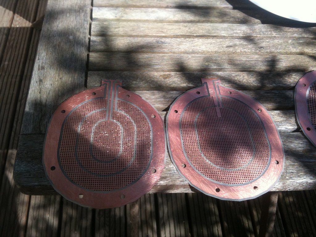

Well what a day, i did a dry run and manage to break my 2 mm cutter... well thats great. i thought i did a dry run to not break stuff and waste material. but apparantly after changing software versions yesterday , my z axis found it hard to work at the speed he always did under the other software and missed some stepps ending up lower and lower and breaking my bit (because the spindle was not turned on since it was a dry run). Ofcourse i should have known....... or not?
Best thing always is before it happens i asked myself hmm isn't he low compared to 2 minutes ago i though i said zero was more then 1 cm above the work area.
you doubt urself some more and before you know it its already broken.
lesson learned dont doubt urself !!! handle! second do a dry run with running spindle.
well i ordered 2 new cutters. again netting 30 euro , damn this gets expensive fast 🙂. and for today i changed all my code to use a 1 mm cutter but replicate the same result wich i should ahve with the 2 mm cutter, be it twice as slow. here are 2 pictures of 2 stators, in one there is a mistake where he carfeully cut the paths to the stators center rings and then with the last one cut them trough...... yep i did programme that... verry nice. maybe i can fix that one. the other one came out nice. fixed the mistake and now hes cutting number 3 and 4. open area is way way way bigger then before so im curious of what happens.
at least they look prety impressive 🙂
as you can see i did not got rid of all that copper on the outer ring, because of the 1 mm cutter its gone take forever, i just cutted an isolation path so it wont summ up witth the capacity of the whole thing.

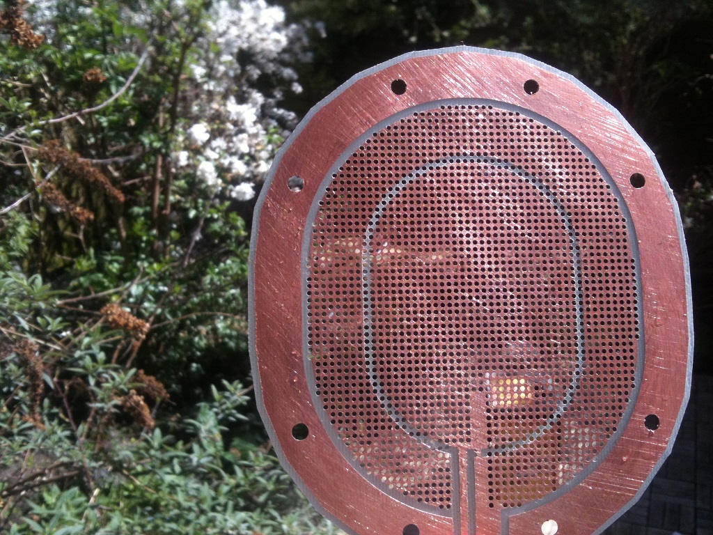

So few hours later, i deciced to use the 1mm to dril the holes and decrease hole size, since Bolsert mentioned, smaller holls and more open area are both good for SPL at these small DC spacing. second reason is i used the 1 mm cutter to drill holes 2mm in diameter so when i get my new cutters i can use those, but! to cut a hole 2 mm in diameter the 1mm cutter has to make a circle, usually thats ok, but i noticed that it left some burs in the copper clad wich goes down the hole. that is an instant spot for arcing!, when i normal drill it does not have these burs, so i need to plunge straight down. So 1 mm holes it is.
it does take a verry long time to drill all these tiny holes. i broke only one 1mm cutter so far 🙂 well they where chinese crap that i bought 10 at the time.

This is the stator as it is now
richt picture displays a fault that is already corrected 🙂
total time for 2 stators is approx 50 minutes! thats pretty long
