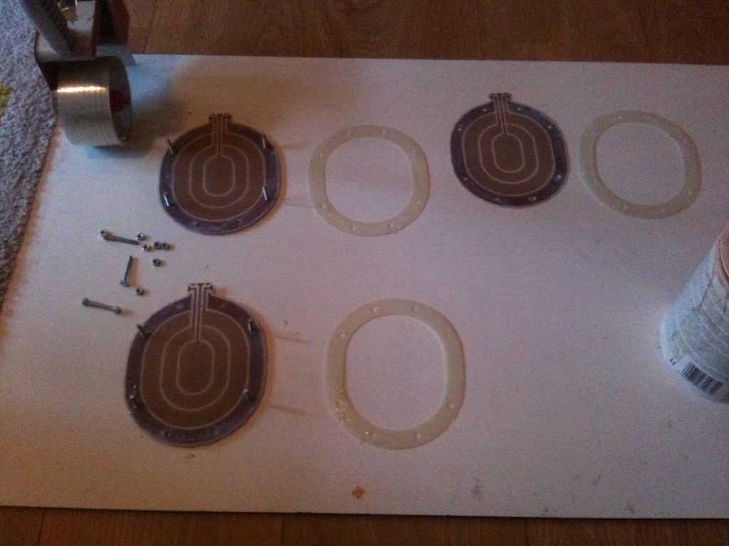

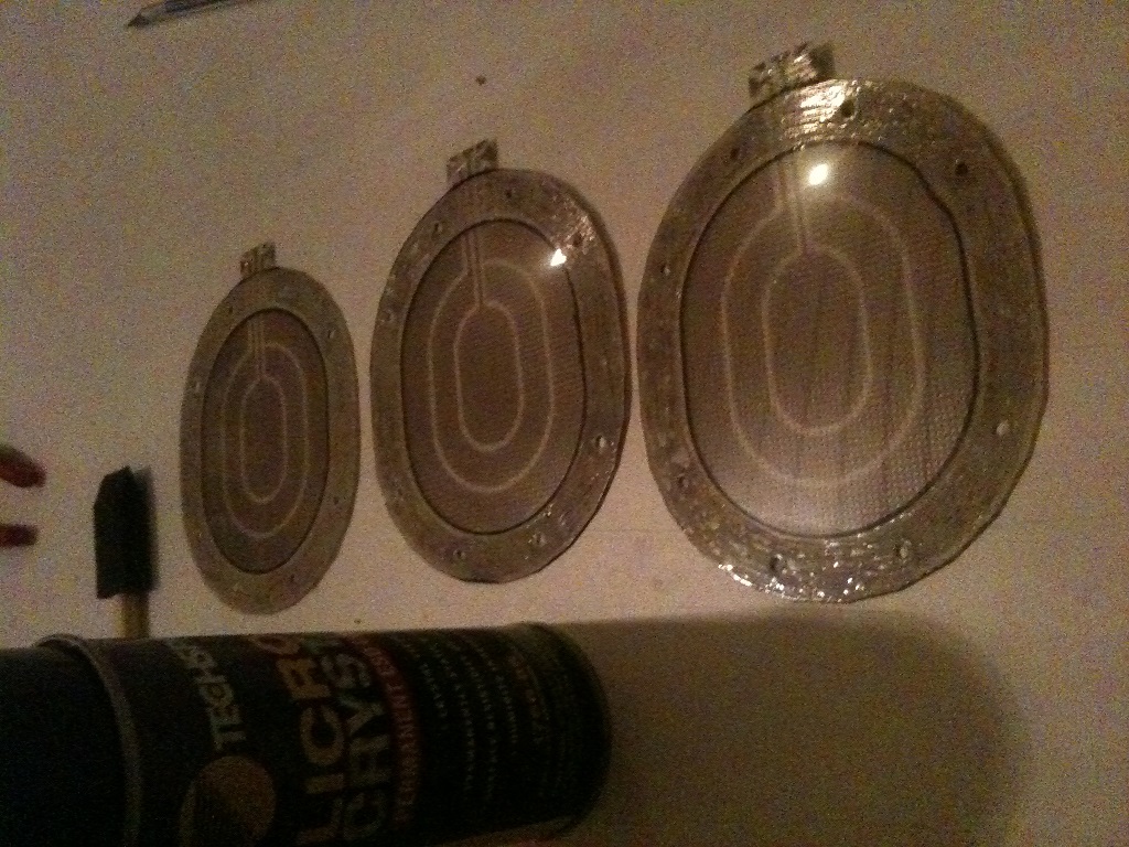

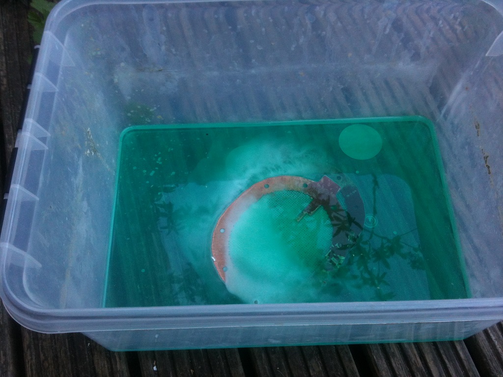

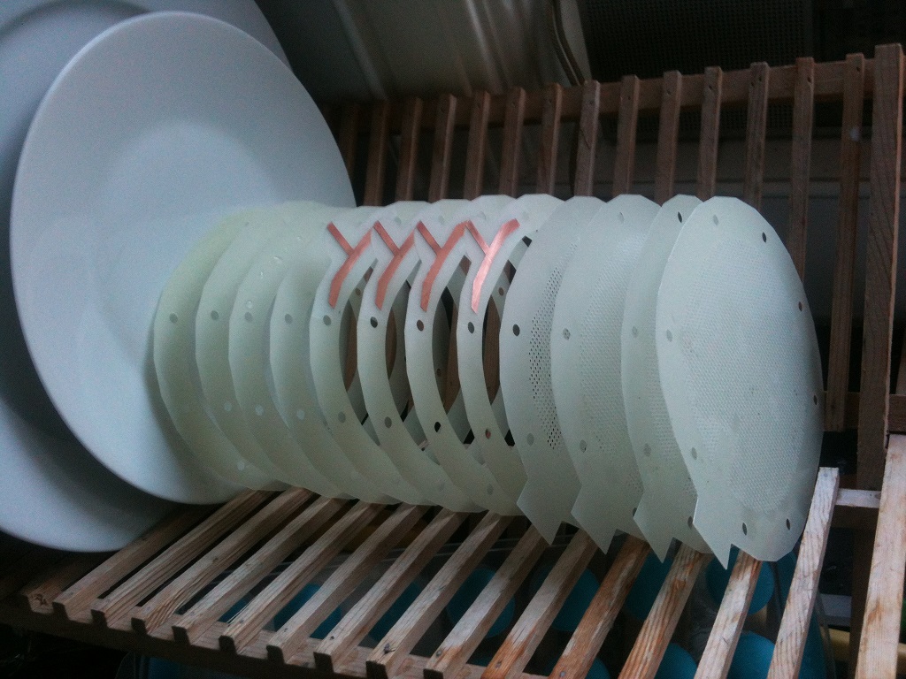

Some last photo's on the contruction 🙂 for tonight
the acid bath i used to etch the spacers, instead of milling it all. my dishwash rack with all components washed and rinsed.
glueing the spacers, with 3m 30 nF (magnepan glue)
and the glued membrames on the stators. i used a classic tape method to stretch this time, since am not sure yet what tension they should have, i just gave it as much as i dared to. on the 3um foil

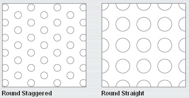

1) Was there a reason you switched from the staggered hole alignment used in your original round stators shown back in post#10? Perhaps the straight alignment is easier to program in the CNC software. In any case, for the same open area percentage, the staggered hole alignment will provide a stiffer stator…if that becomes an issue.
2) Can you tell me what the center-to-center distances were for the 2mm and 1mm stator holes shown in post# 35 and #36?

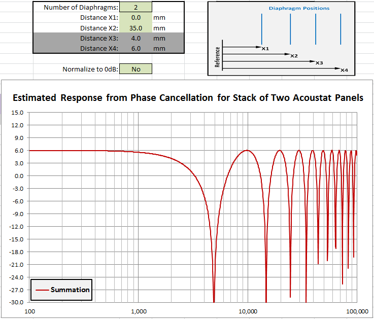

Since single Acoustat panels can already be driven to the point of diaphragm slapping stators there is no increased output capability at low frequencies with stacked panels. You will just be able to reach the slapping threshold with roughly half the voltage input to the panels required for overdriving a single panel.So this is interesting - I have a large number of Acoustat Panels - any benefit of stacking them? I posted about this a long while ago (stacking Acoustat panels) and really can't remember what the verdict was - don't think I ever tried it.
More information on the low-frequency aspect of stacking two Acoustat Panels was posted in the other thread:
http://www.diyaudio.com/forums/planars-exotics/226890-my-acoustat-panel-experiment.html#post3309417
The high frequency aspect had not been mentioned, but it is not good news either. With two panels stacked back to back, the two diaphragms will be roughly 35mm apart. Using the spreadsheet from post # 25, you can see that the phase difference between the two diaphragms will put a huge notch in the upper midrange.

well about the holes i cant seem to find the file of the first 2 stators i made... but the 1 mm version has 1.9 mm from center to center.
Yes you are right about the layout of the holes, i did change it to straight, this was because it mirrored better when i rotated one stator 180 degree, in the end i did not rotate them at all so i could use the staggered manner the next time to have some more stability.

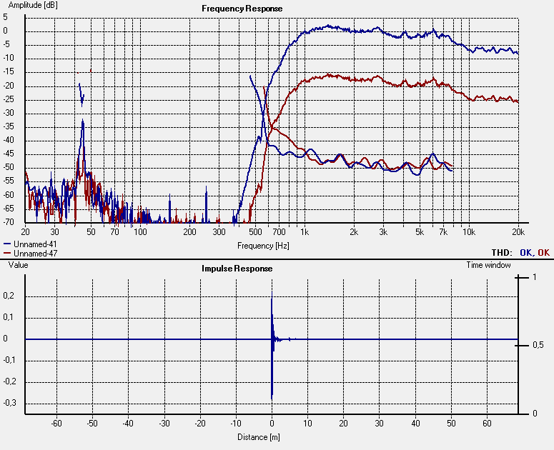

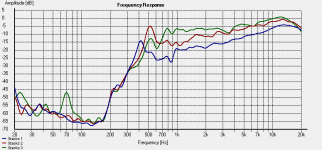

First measurements.
1 panel 2 stacked 3 stacked. fullrange instead of sigmented, i sigement after the test, im not sure why i wanted that in the test. its not needed at all.
You can see clearly see that up till 15-18khz it still adds considerable SPL. 1 to 3 stacked diference of 12dB ~!! thats pretty much. it also becomes a bit more ragged. im wondering if this is the effect of all the smal holes stacked behind each other. and maybe some resonances of the combined membrames and support dots. **** i now realize i should have spaced dots on every panels slightly different, so i can smooth out the resonances instead of amplifieng them with each stack. 🙁
next i want to emmbed some verry fine mesh in between the stacks to see if i get rid of some peaks and dips.
ans also want to look what happens when i remove the stator spacer with alle the holes for an open spacer (that mean the copper is facing one of the menbrames) but might reduce the effects of the holes. i could always revert to painting one side of the stator if needed (i doubt it)
another thing that worries me slightly is the resonace of stack 1 and 2 are like one would expect, with 3 it looks split into 2 resonances.
the resonace of the 2 stack is still visible in the 3 stack and a new one from the 3 stack a little higher

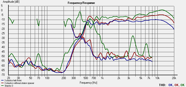

Well i removed the perforated layer between the first back stator and the second membrame, this is the result.
Green where the 3 stators just stacked with the perforated plate in place (2 in total)
Red is without these plates, much better you can see ONE resonance just like we had with the 2 and one stack. around 560hz then when you look at the THD this improved allot.
Blue Same, but now felt is added at the front and the rings are sigemented. no Eq used yet in the crossover. again looks better less distortion and overal ok response, at 1.8 khz the drop could be corrected by an low shelf, or by adding a baffle because my guess is this is where the whole contruction does not function as a baffle anymore. maybe ill check.
glad i got rid of some humps tobad we cant lose the other holes 😉
so in short, the machining of 4 of those perforated plates wich took around 3 hours in total, gave me some extra distortion 🙂 at least i can scratch 3 hours from the next build 🙂

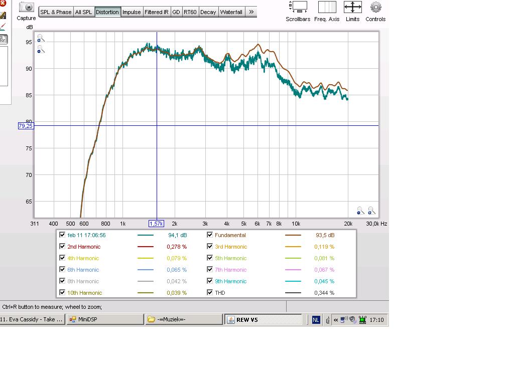

All of your work is quite interesting. However in my opinion such small panels would suite ESL headphones better. Doubling linear dimension would give a lot more than 6dB, perhaps in the order like 12 dB, so this could be considered as an option.
For me THD figures look quite mistrusting. 35 dB below the level is not what is expected from an ESL, especially at high frequencies. If you have another source(like other ESL panel, or good quality dynamic speaker) I would suggest you cross test your measurement equipment first. Secondly it's quite weird that stacked panel shows so much higher distortion levels. Are you sure nothing is overloaded, measurements are performed at exactly same position, etc. ? It's quite possible that the reason actually something different than stacking itself.

the THD measurements needed to be taking with a huge grain of salt. since when i look at the noise level they are almost as high as the THD. my laptop makes noise and also it is measured in room half a meter away. i measured allot of panels, and thd is always in this region. not mater what i use, even my open baffle woofer is in the same region. wich ofcourse hes is not. obvious resoances still show up, as show in previous post.
Here a measurement of the same panel at different volumes (close miced with sigmentation as you can see in the drop in freq),
So because i played my sweep at a lower level for the red curve the difference between the THD and the curve is now dropped by 20 db. so im not sure how to normally read these figures but it looks to me a bit weird.
its not because i play the sweep 20 db louder i have 20db less thd.
How on earth do you read these measurements ?,
Your statement of the 35 dB below measurement level now increased to 50 db, only by adding some volume.
am i missing something here ?
This is what Rew makes of it, although sometimes its higher sometimes its lower. my soundcard is not calibrated.
0.344 % total harmonic dist. got as low as 0.2 something, i dont know what my soundcard does, as well as my minidsp wich is connected in between as well. and the Umik 1, did use the calbritaion file ofcourse. but it does not acount for distortion

It is likely that the sound card+miniDSP+transformer contribute only small amount to distortion. The latter should be measured as some appear considerably better than others. Typical for mains toroids is between 0.1% to 0.05% THD at low frequencies and this drops at mid range and above. This is assuming that series impedance is low between transformer and amp + DC offset is no more than few millivolts. Therefore IMO passive crossovers should be avoided while using transformers.
Usually I have measured very low levels of combined distortion, less than 0.1% from few hundred hertz and up. Of course speakers are much bigger. You may also find that distortion levels somewhat depend on signal level.
