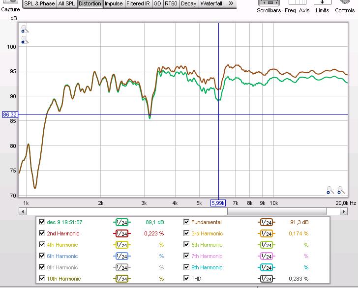

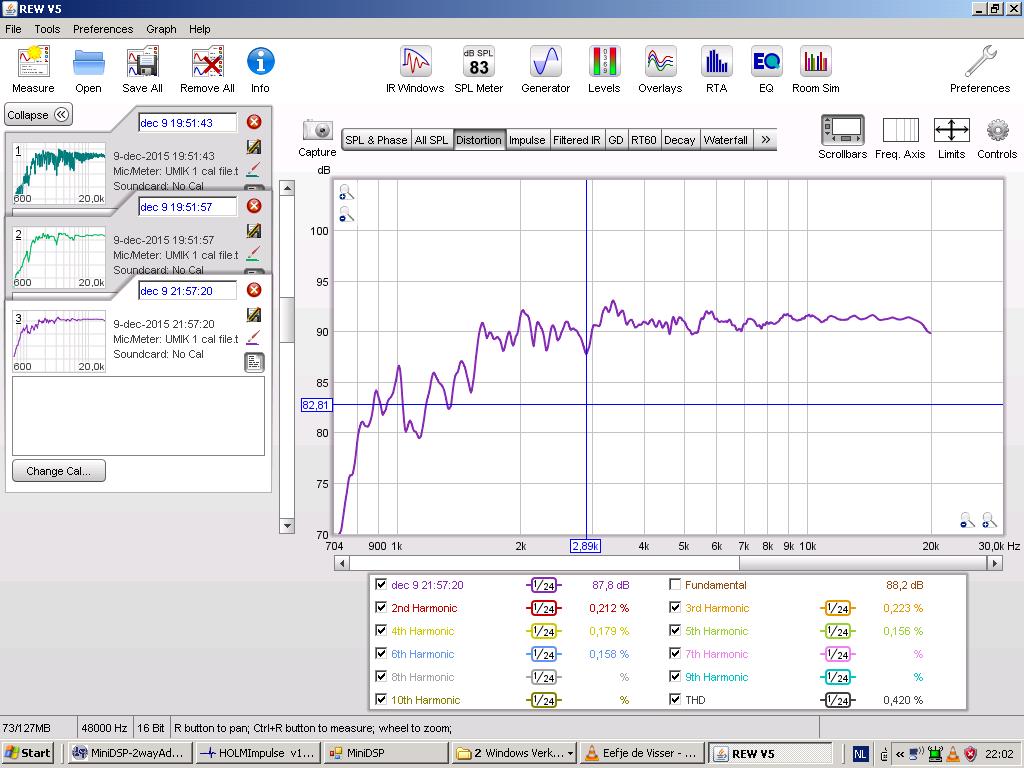

This thread continues from my second tread i started... sorry http://www.diyaudio.com/forums/planars-exotics/282787-stacked-esl-v4.html
Sooo back to my thread. sorry for the double thread, i beter should continue here. so people can read the whole story if someone wants to try the same or wants to contribute some knowledge.
I played with the mesh this weekend and , well i am not sure yet. i somehow find it a bit complicated. making spacers glueing mesh to it, making copper connections etc... maybe ill wrap it up and put it in a bag for later use. well hell it was only 140 euro's in total.......
ok enough bitching from my part. mesh works, and i am pretty sure it could be used for bigger stat panels (since i cant use a support structure inside the esl)with a proper backing like egg crate, sort of like Gerald did. except that this mesh (and i did not tell that yet) is based on a polyester fabric with a layer of copper and zinc against corrosion. so you can etch it!. i tried several pieces and it works in just normal acid used for copper etching. so if you want to make a stat with openen of 50% (minus the structure to support it) you can still segment it if you want. the fabric looks almost transparent witch is cool.
But for my project i did not get the things i wanted. going really small hole sizes did not do much in terms of efficiency.and the high roll off remained. but not all is wasted money. I did discover the roll off that changed frequency when stacks added is due membrane weight and not the amount of stacks nor the capacitance increase.
there is still A roll off starting at 15 khz, this might be my
amp
sound card
transformer
or mic
although the last should be calibrated but i doubt to what extend. the sound card i remember i measured once few years ago (lost calibration file of course) and was pretty straight line frequency wise. at least not this big hump.
maybe there is someone from the Netherlands where i can calibrate my mic against a good mic ? so i at least have a better feeling 🙂
The mesh still might be usable in a very tiny version for tweeter use. where it does not have to span much distance. low dc spacings and very thin stator makes it able to stack 6 of those before rollof starts at 18-20khz. but i need 1 micron mylar for that so it has to wait 🙂

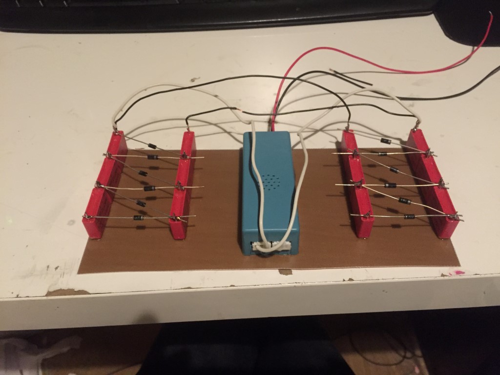

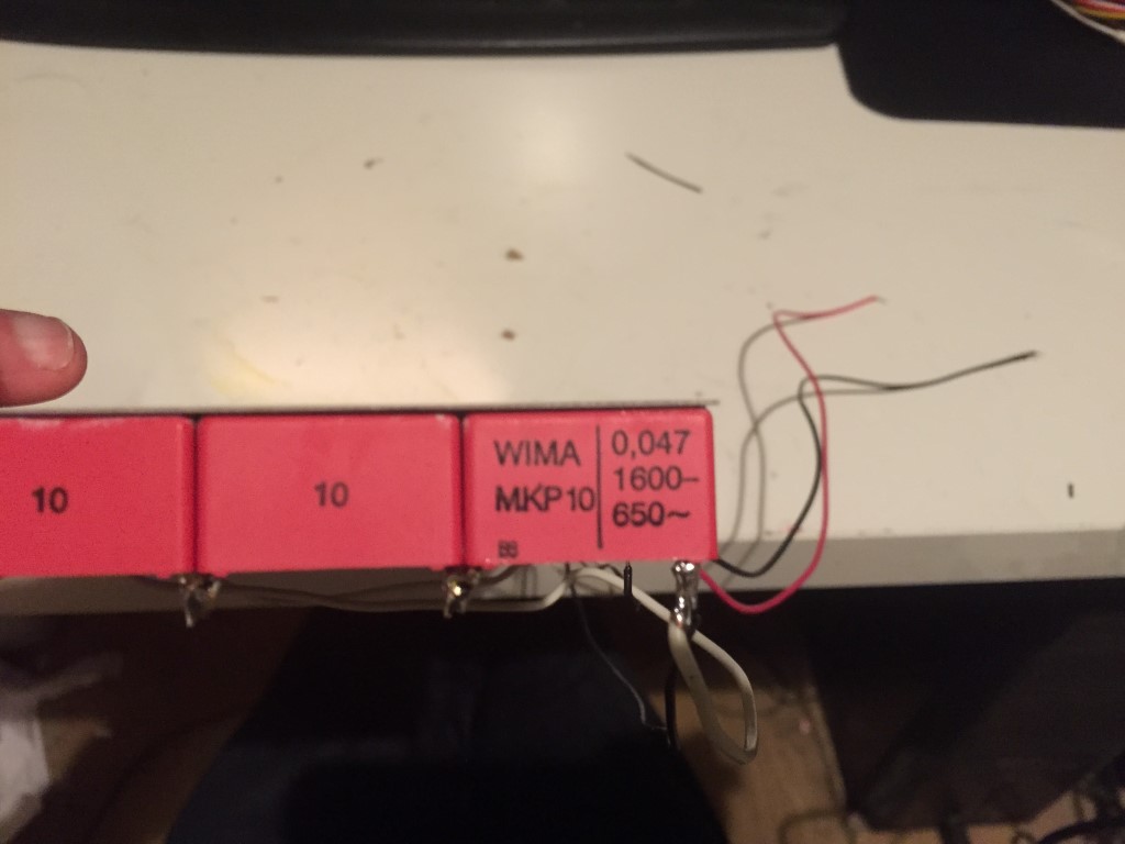

hmm noticed why they siszle . looks like my HV cascade of the - high voltage and the + high voltage are not equal. first of all since i had double caps in the + version for the use with the EAP speaker. my negative version cant handle the same voltage 🙁. another thing is that the caps are working near there voltage limit so going over it will end up in sparks inside my caps... do this enough and gone it is.. so i might need to make new ones with higher voltage caps, since they are fed by an inverter starting voltage can reach 800 volt before the multiplier. i feed them from one inverter. if i wanted a really balanced system i could go for 2 inverters.
i test the membranes one by one and i noticed that the + HV ones collapsed into the menbrame way sooner then the - membranes. so a difference in voltage there(i could not even collapse the - before the capacitors starts sparking). another thing i recon is stacking in powers of 2. to have all things equal loaded each HV lader the same load.

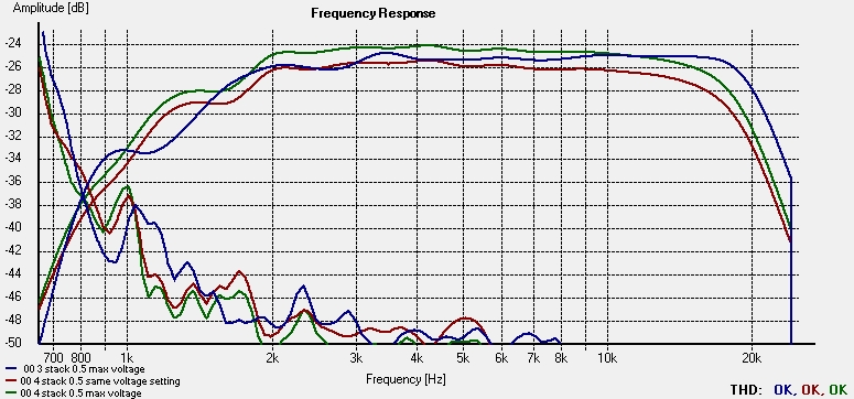

SO fixed my high voltage power suplly. 🙂 got caps rated to 1600 volt 🙂 overkill by 1000volt. but it was all they had above 400 🙂
no more collapsing membranes... well thats funny. i then wondered what a dc spacing of 0.5mm will do since the problem was sucking into one stator.
well it gained more then a healthy 6dB. the test version is mated with a 12 inch woofer that was rated 92 db, but its rather around the 89-90 db. the esl can keep (at 1khz where the woofer is most efficient) up so efficiency is around 89 db with 3 stacks.
the mesh may be useful after all. jees i keep getting swinged back and forth between materials and setbacks.
the test tweeter has a surface area of 48 square cm. that is not much
"no more collapsing membranes"
Thats Cool!! 😀
I was wondering at what bias voltage you were using.
It seems tp Corresponde to the experiences I have observed when running very high bias volatges. I never had any colapses using them but I did have a few when at lower levels and raising volatge it would recover.
This seems to go againist what others say about having have a high tension in order to maintain stability.
As you know I don't use high tensions and I never had a problem with diaphrgam stability when I use bias volatges above the point of 4.5Kv or so, Not even at 10KV.
At 10KV the force is so high in a .072" gap it has no choice but to stay in the center and even if you blow on the diaphragm it doesn't budge.
In cases were I had the frame loose enough to squeeze them to lower the tension (and resonance) I recall they didn't collapse at the higer voltage at all compared to the lower bias voltages.
I have also had however very strange effects at lower levels of bias before I would bring them all of the way up to a full charge, but once I did that I could lower the bias back down to the same level of the effects and the effects would be gone.
This may have been an issue due to the stator coating materials I use.
I Looked to see if it was a collapsing issue but I could not tell, but it could have been as it was very hard to see details past the mesh stator.
This is one of the main reasons my next build uses a more open design using TIG rod stators, That is to be able to have a better view of diaphragm movement
And yes every time you double the bias you will gain +6DB of efficiency.
At 8-10KV of bias I was getting +100-105db with just a small average signal and the amplifier really liked that!! 😀
I don't recall what my final efficiency rating at a 1 watt level perbias voltage was, but I started at the same level as you at about 89-91db and once I had got to that point I was amazed as it matched that of the woofer.
This was a big struggle when I had got them out of the closet and got them running again back in 2010!
I had barely got any sound out of them at all and it took all of the power I had to do so, and the woofer just a few watts!!
We have come a long way my friend to prove that little panels can actaully sound great!
The dip in your graph could very well be cuased from nearby refelctions in your test area, I have experimented with several setups and one in particular set up (actually two) I was able to eleminate the reflections getting into my test mic and the FR came out flat as a ruler.
jer 🙂
its not reflection 🙁 tried to move it or damp it but its non of those its really inside the panel so i recon membrane.
well with the lower resonance if i use the same bias it will flap like a machine gun, so have to lower it a bit until the fequency of flapping goes down and ends into silence. then upp it a tiny bit. i lost 3db due to menbrame stability. but! these are 3 stacks. when i remove one stator connection flapping stops. this could be the membrane near one of the Front(or rear) stators might be closer then to the rear(or front0 , or it is because its asymmetrical at the moment with membranes .
btw only eq used a low shelf of -4 db at 6khz
"this could be the membrane near one of the Front(or rear) stators might be closer then to the rear(or front0"
Yes, This most likely could be the issue, I had that problem on my large 7.5"x 21" panel where it didn't have ver y good support and was not perfactly flat, and on a few of my smaller panles wher the mesh had a few bumps in it as well.
This was hard to control unless the stator was perfectly flat.
Having a very small D/S also makes it harder to control as well as you said Asymmeterical.
Alot of the times I had found that that Flapping can be cuased from the HV fingers from the Bias connecting to the diaphragm through the air, this is what is cuasing the oscillations as it dischages a section of the diagphram.
I found that a good stator coating pretty much eleviates this problem but, would be very difficult with the material that you are using due to its fine mesh grade.

Sooo added one more stack.
Well first measurement is from the original 3 stacked at max bias, without flapping. second is with added stack at same voltage (at least my power suplly is) 3rd is with max voltage before flapping.
an increase of ~2 dB, you can also see high fequency roll of starting to take effect. but since i eqed it i can bring it back 🙂 also funny to see distortion go down a tiny bit. tomorow another day and i will try to add something to see if i can stop the flapping 🙂 and see if there is anyhting left in it spl wise.
One more thought on Post #109 what is the distance of your mic to the panel as this could Maybe cause some refelction from your very fine mesh (just a thought).
But in most cases I have found it to be some kind of reflection that cuases such steep dips in the response.
It took me many tries and adujstments to get that ruler flat line in my room.
I nearly covered everything in the room with blankets near the panel and mic. to finally get the results I was looking for.
I got similar dips on my last measurments with the thing steeing in front of my monitors as shown in the pictures I have posted.
Earlier tries back in 2010 when I had just one monitor I had found the cavity next to it that is supposed to hold a stack of CD's caused a dip around 200Hz to 300Hz or so and I stuffed that cavity and the dip went away.
Measuring the distance to the panel to the back of the cavity was in relation to a 1/4 wave of the frequency of the dips that showed up in the FR graphs.
The last graph you posted looks really nice!!!
THD measuremnts are tricky due to calibration of the levels but HOLMS seems to do a nice job of adjusting in approximating for this.
