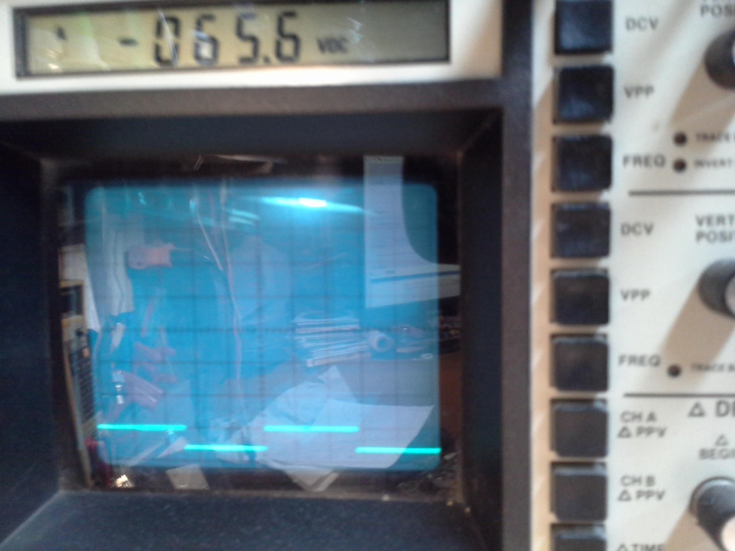

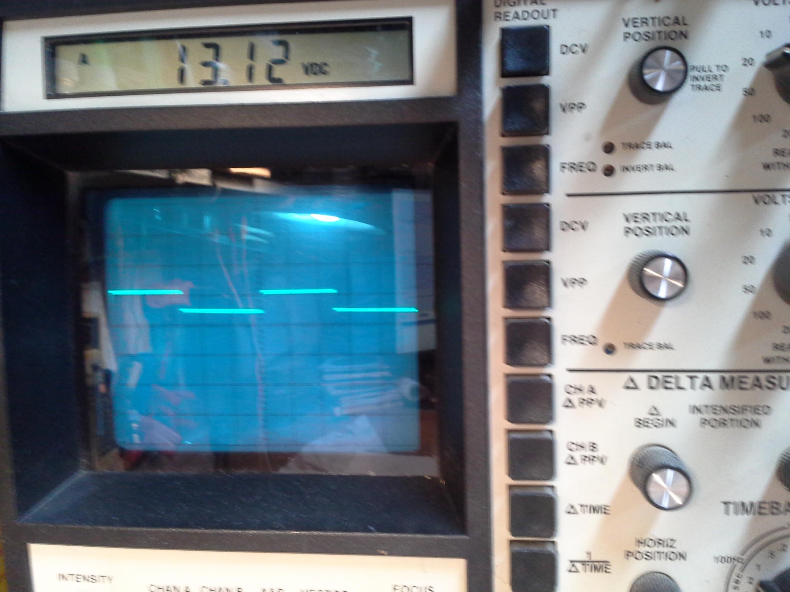

This is the other amp I repaired to test the driver boards. I still have the same problem on the original amp. And yes I wasn't using a load on the test amp.
And yes the low side is going down to the negative rail. on the test amp. So the driver boards should be good.
Do you read 0 ohms between the two grounds (PG and SG) on the driver board when it's in the defective main board?
If you are checking without the driver board in the amp, you need to place the meter probes on the side of the board with only a pad (not on the side with the trace leading to the pad).
"Do you read 0 ohms between the two grounds (PG and SG) on the driver board when it's in the defective main board?" - Yes. Double checked it.
Everything points to the driver board as the problem but the boards run correctly in the test amp. I'm scratching my head. I don't know what's going on or what to check next. I cut the low side drive trace to isolate it from all the gate resistors and diodes. Signal was the same off the driver board. Tis a mystery indeed.

If you have a scope, check your high and low drive off the driver board. You can see what the wave forms should look like in this post. I've posted pics.
