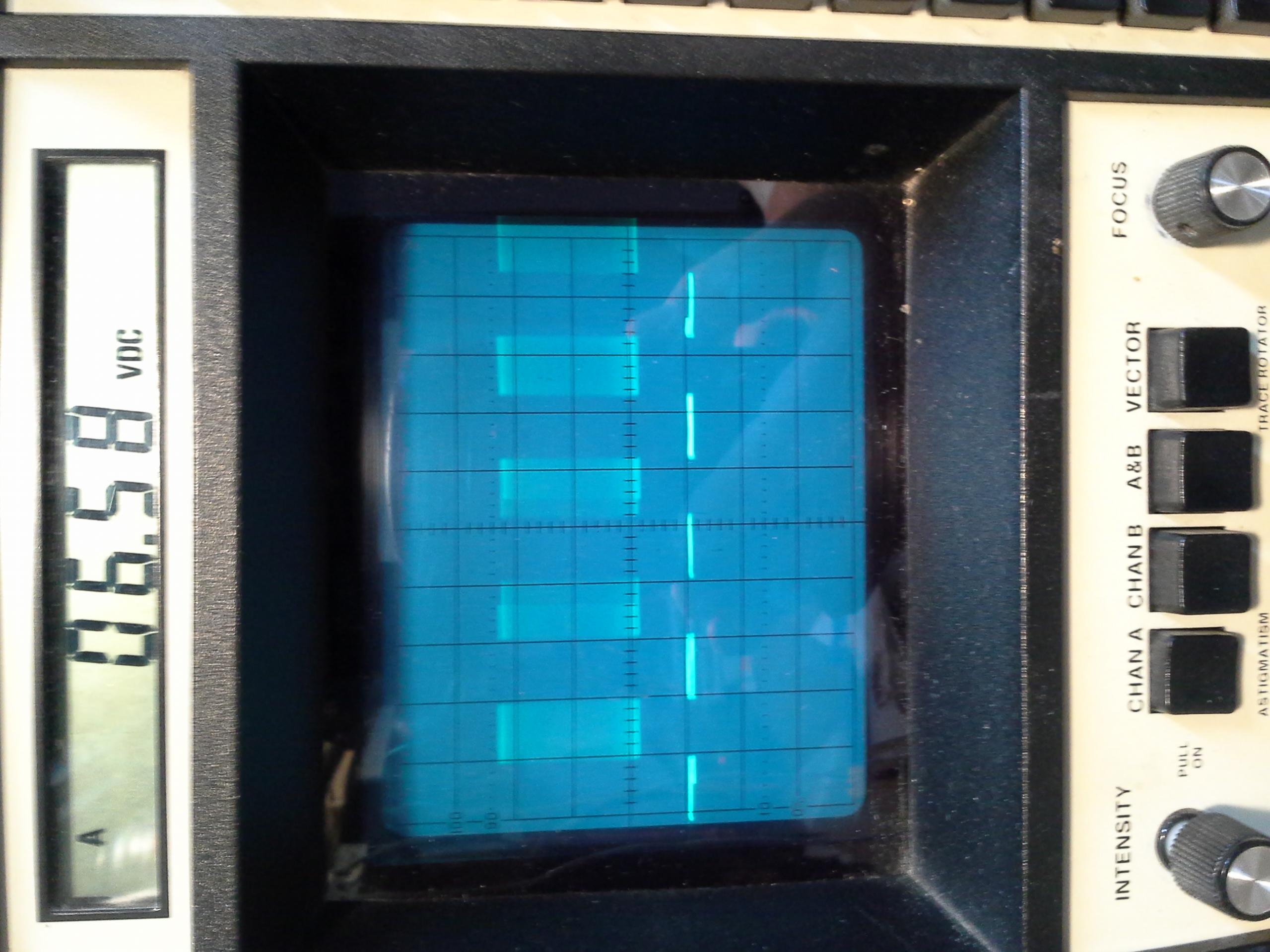

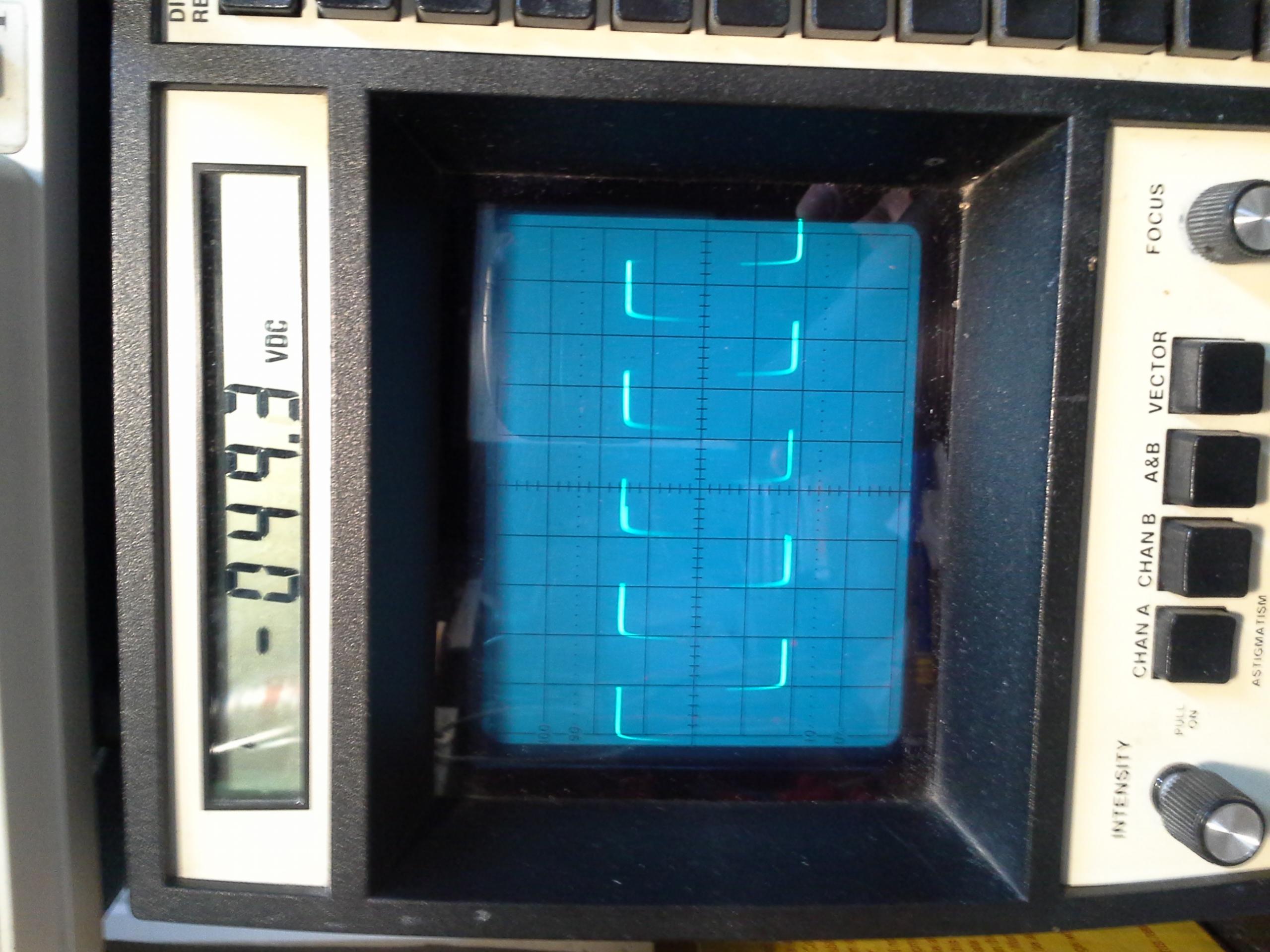

Just now getting back into this amp. Been battling equipment problems both test and shop AC. On a class D amp, this one, can the output filter choke and cap circuit be disconnected from the outputs without damaging the outputs? Just to see if it's causing the outputs to short.
Unless the FETs are failing immediately as the amp is powered up, you can look at the signal where the two inductors meet. It should be 1/2 of the rail-rail signal on the drains of the low-side FETs. While monitoring the signal, twist on both inductor to see if there is any significant change in the signal at the point where the inductors connect.

Outputs are getting hot immediately. Doesn't take long to short an output. I've been through the driver board all is good with it. Pulled it and checked everything.

Okay, I must be dealing with a driver board problem. I have all the outputs out of the amp. On the positive rail voltage side I have a rail voltage of +89 volts on the source. +6 volts on the gate. On the negative side I have a rail voltage -89Volts on the source but -50 volts on the gate.

+6 Volts across the gate and speaker out side on positive outputs. +38 Volts across the gate and Source on negative outputs.
Black on source red on gate of positive outputs, +6 Volts, black on source red on gate negative side, +38 Volts. Center pin is drain. Correct?
By the way, I have a 100HZ signal into the amp. I know it's a pain in the rear but I do appreciate your help.
Connecting a small capacitor (1000pf) across the high-side will clean up the waveform.
I need the low side with DC coupling at 20v/div.
