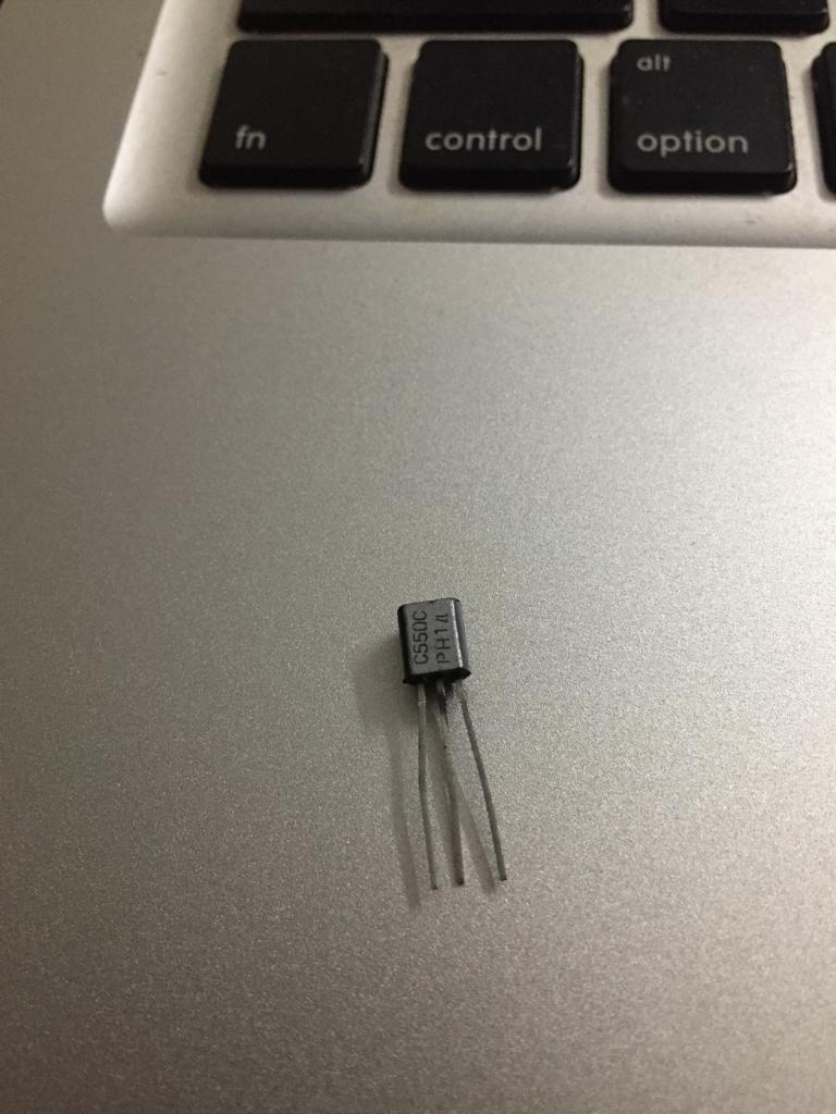

I just found some C550C PH14 series transistors but with silver facing unlike other which are complete black. Not sure whether they are genuine but I just tested and its hFE value is around 495. Can I use this if not I need to buy some BC337 or BC550?
Something like this in the picture.
Those silver faced are Philips NOS genuine. You can use one for verification until you will get 337-40.
