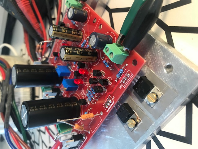

As a followup on my quistion regarding the use of "centertapped" transformer some pages back, just want to tell you that the shop "Audiophonics" is a very good trusted dealer, as they sent me a new dual secondary (torrid this time) for free; not even asking for money or return...
In meantime i recieved my board's... (aka' homemade)
I stuffed them with parts i allready had at home, and vupti... working and rock steady.

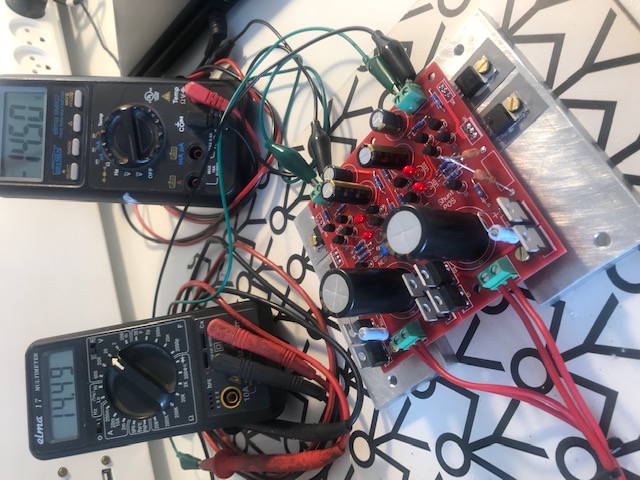

I had some resistors, giving me 200Ma & 160mA for testing (R1 + R1n), if i load with a testload around 130mA they are still giving the same voltage... perfect!
The C3 resistor is Panasonic 100uF / 50v, the C2 is (for me at least) unknown brand at 330uF / 50v... When i order some parts for my other project's i will ofcause order the right parts + 3ohm resistors for R1+R1n... but just had to see it working today 🙂
I also need ~15,5v out, but i had to solderin some 5k trimmers i had, they will also be swapped into 10k's i think. - The highest voltage i get with 5k trimmers is around 15,2vdc +/-
Rgds; Jesper.

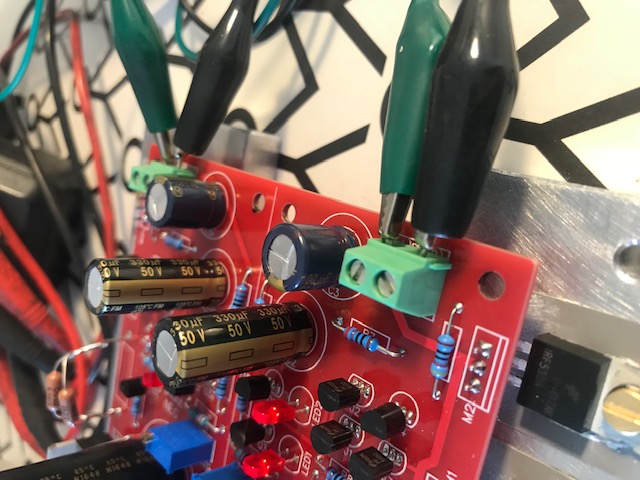

He, he, Jesper is back successful. You have Panasonic FM 330uF for C2 there I would say. C3 is rather far from M2 in your layout but you got lucky and the result looks to be stable. Check the rails with an oscilloscope also if you got one. How many uF is the tall and slim C1?
The C1 is 6800uF/35v Nichicon
My M2 is approx. 25mm. away from C3, i did check with a cheap oscilloscope i have, but i don't think this is good enough to tell the truth... the scopetrace is straight through 😛
I will try tomorrow to see if i can make some more accurate messurement's, forgot to meassure the "ac" on the output today.
Jesper.

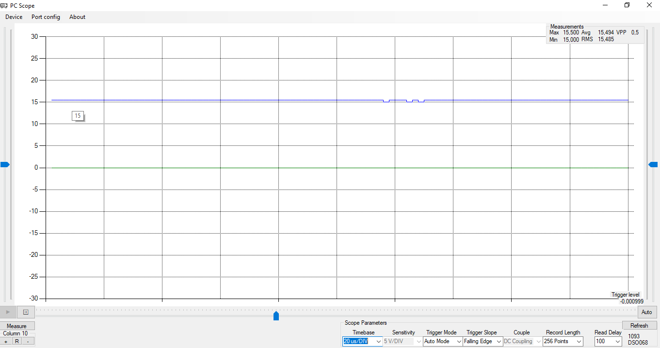

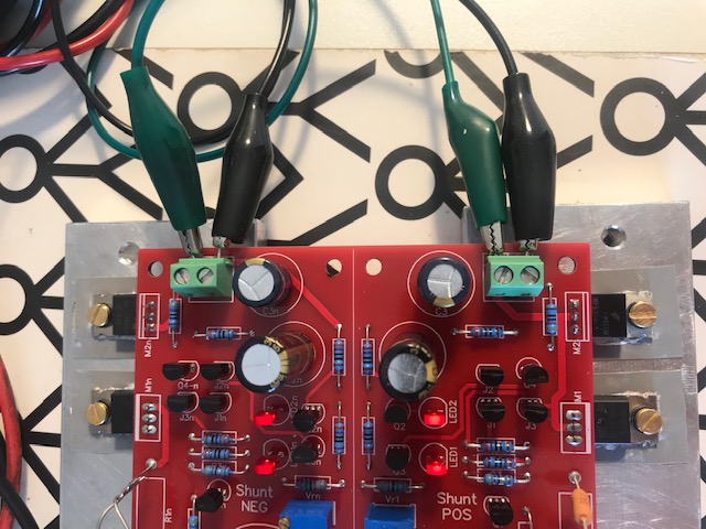

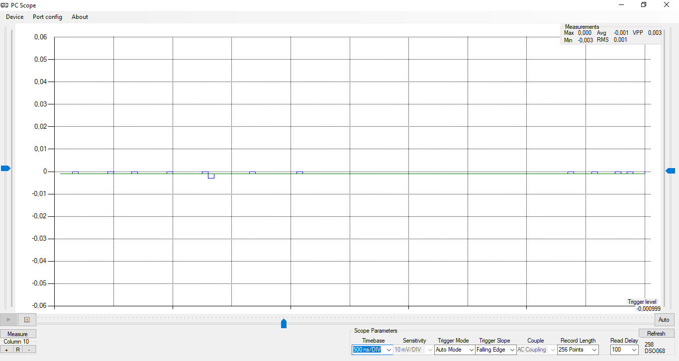

So finally i managed to do some meassurements.
1. picture is AC
2. picture is DC
I have this cheap DSO068 scope, which i bought in lack of a real one.
I must say, that using the pc-scope program they offer for it, it's a little usefull, but i still don't trust it through. Anyway the trace on the DC picture looks like DC ;-)
Also i tried with one of my DMM's meassuring ac, and there is next to nothing.

Its surely stable then. Congrats. Those tiny square artifacts must be sampling glitches in the software while the PC runs tasks. There are no real world squares in such measurements.

Yep, the square ones are computer"noise" 🙂...

If it was only the AC screenshot of 10mV resolution I would imagine that the root cause are tiny peaks in the random noise floor that it simply can't catch up with and it produces such shapes, but in the 5VDC resolution picture has some square dents which are super unlikely to be based on that noise given the 500 times less sensitivity.
