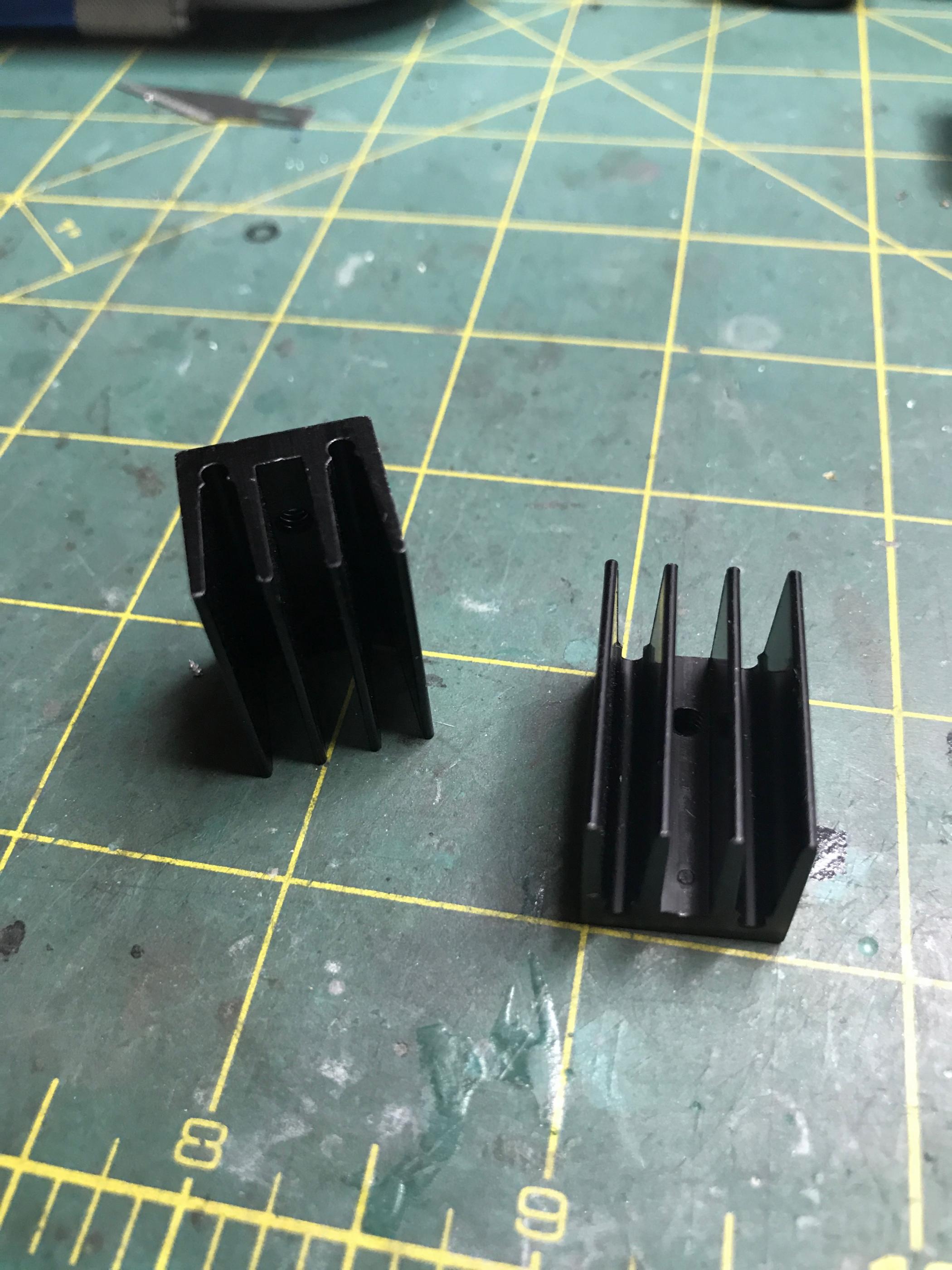

No, they are small. Better use the chassis for sinking. But insulate the Mosfet tabs.
Thanks, Salas
