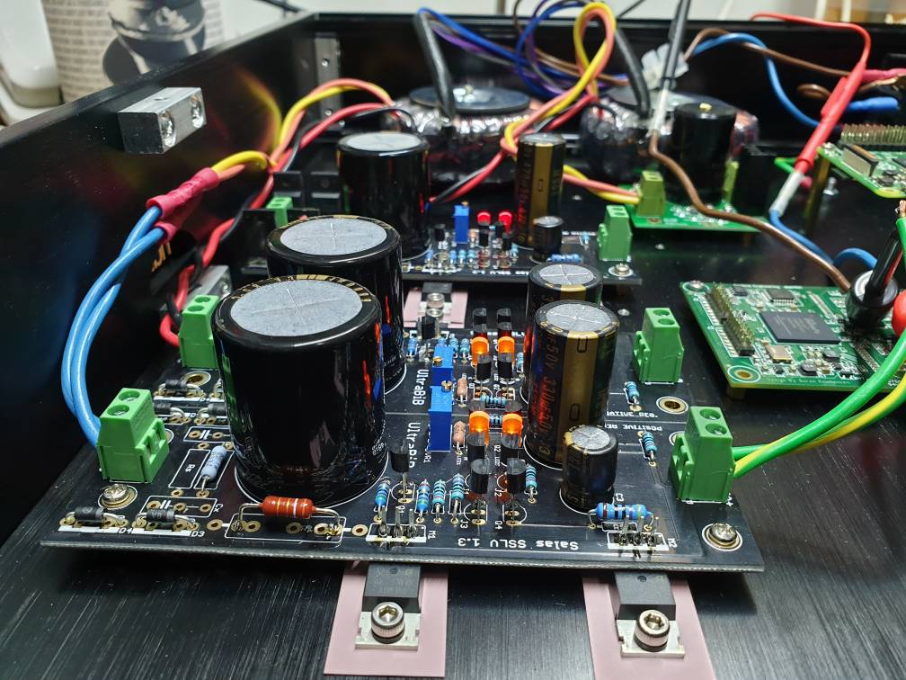

Need some help here, I had gone to tidy up UBiB my earlier DCG3 project.
All is good except one of the negative shunts which is outputting -22V7 no matter how I turn the trimmer. I tried to solder reflow to make sure there are no dry joints on the caps and M1/M2. The latter do not seem to be functioning given they are cold to touch.
Any advice?
Any advice?
Its getting later and my brain isn't functioning 🙂
Will probe the M1 and M2 Vgs (legs 1 and 3) for 4-5V and 3-4V if the transistors are still working normally.
M1 and M2 are pretty much dead measuring between their 1-3 legs at -21V and 06V. Have ordered replacement parts, including the BC and JFETs to be safe. Bummer.
BTW double check their print not to have installed wrong M1 M2 types in this negative section
I redrilled the holes to ensure that they are more reliable as the previous job wasnt satisfactory, strange thing is it just died. Of course I checked for non-continuity on the MOSFET tabs before powering anything up.What happened? Insulation problem?
No, they are populated components and was working till I decided to rework the chassis mounting.BTW double check their print not to have installed wrong M1 M2 types in this negative section
The only issue is Tea's quality boards are too conductive and makes it difficult to rework. :-/

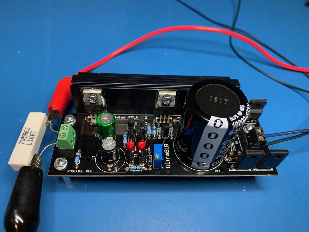

Has anyone successfully built a +5V 2.2A version suitable for an RPi?
I have put one together using R1 with 0R27 7W, M1 IRF9640, M2 IRF640 and R9 with 1K5. It seems to work but M1, M2 and the rectifier diodes get very hot very quickly, and I seem to have smoked Rf (0R33 1W part supplied in the mini kit).
Should I have uprated Rf?
Also, what is the acceptable heat range for M1, M2 and the diodes? The spec sheet seems to say 150C but this seems quite high.
Any thoughts?
Any thoughts?
M2 power at 5V should be low quite low, M1 depends on input voltage, let's say 12V: 7V drop *2.2=more than 15W! For a heatsink temp rise of 20°C above room temp you need something like that: SK58-100-SA | Heatsink, 1.3K/W, 100 x 150 x 27mm | RS Components. You want your UltraBiB reliable so you want good heatsink as other parts can't stand (think caps) the heat. Tiny heatsink on rectifiers' package are cheap.
I hope I'm right else I may fry next build!
