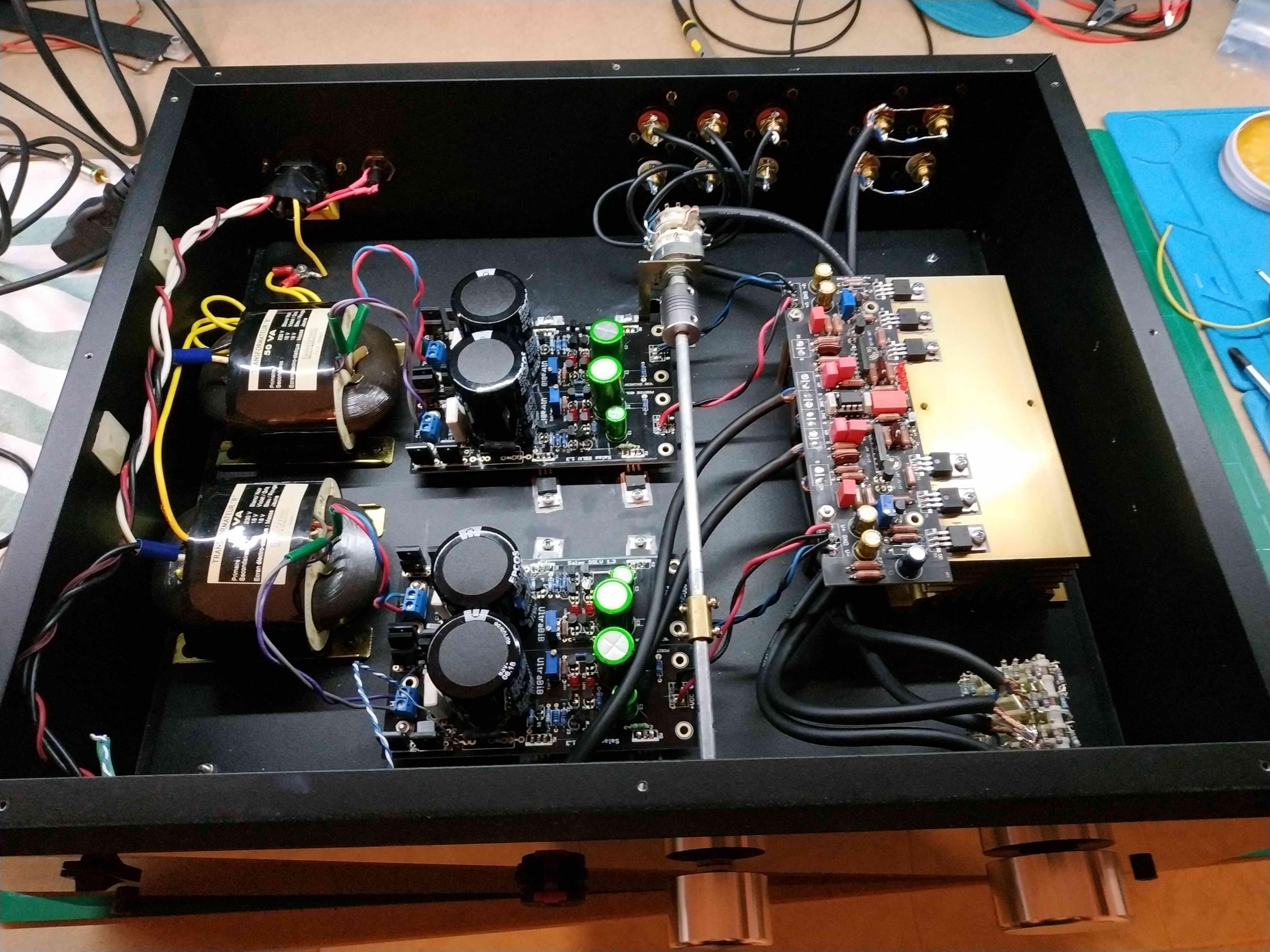

Have two 1.3 boards and minikits on the way (hopefully) from last GB. Would like to try one full board as a replacement PS for a dual-mono DAM1121 build. Salas, am I correct in the following:
DAM1121 positive 5V Digital rail is 250mA typical with a max of 350mA. So, powering two DAMs from a single positive rail of the 1.3 with plus 100mA headroom would be a 800mA target current. R1 would then be 0.75R 2W for that rail.
DAM1121 positive 5V Analog rail is 20mA typical with a max of 50mA. So, powering two DAMs from the other positive rail on a 1.3 board with plus 100mA headroom would be 200mA target current. R1 would be 3R 0.5W(?)for that rail.
The same calculation for the DAM1121's -5V rail, i.e, 3R 0.5W (?) for the R1 on the negative rail.
Does the 1K value for R9 still stand in this configuration? At least on the 800mA rail? But not necessary on other two rails. Total 'Spare' current is 300mA.
Do capacitor values in the build guide still pertain for this configuration? Any tips on which brand and values for this application welcome 🙂
Re transformer, using an R-core at 9VAC, the current draw is around 10.8VA so could I get away with a 30VA trafo? Or is 40VA a safer choice here?
Or are my sums off?!

- It stands (for the 800mA case)
- They do pertain. Currently on Mouser C1 Nichicon LKS 6800uF/25V C2 Nichicon UKZ 470uF/25V C3 Nichicon UES 47uF/50V
- Can get away with 30VA
- Sum and R1 values are correctly calculated
- Not bad to separate in theory but you must ask Dam experts if it practically pays off in this case or not
