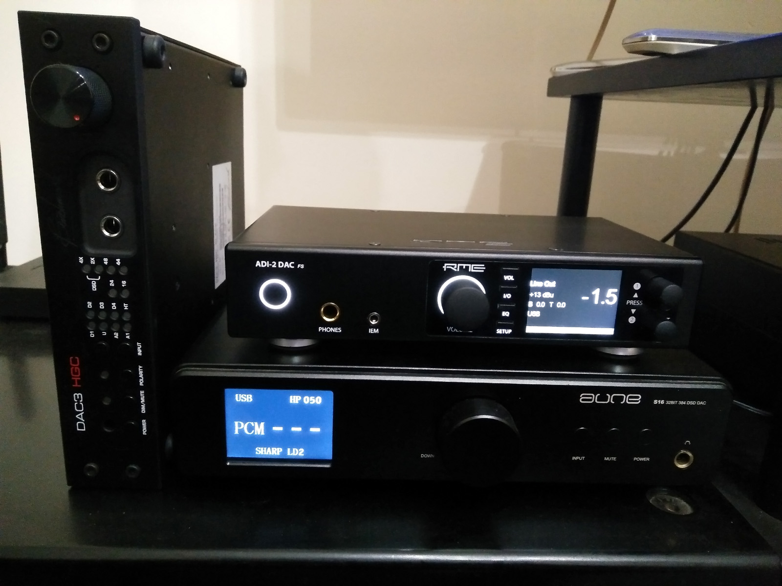

Nice to know you got nice results. I do try various dacs from time to time to follow where the technology is going. The dam belongs in the nice category. More delicate sound for natural timbre by the ladder, maybe not as present as ΔΣ. Here are few with AKM or ESS I was comparing during the weekend

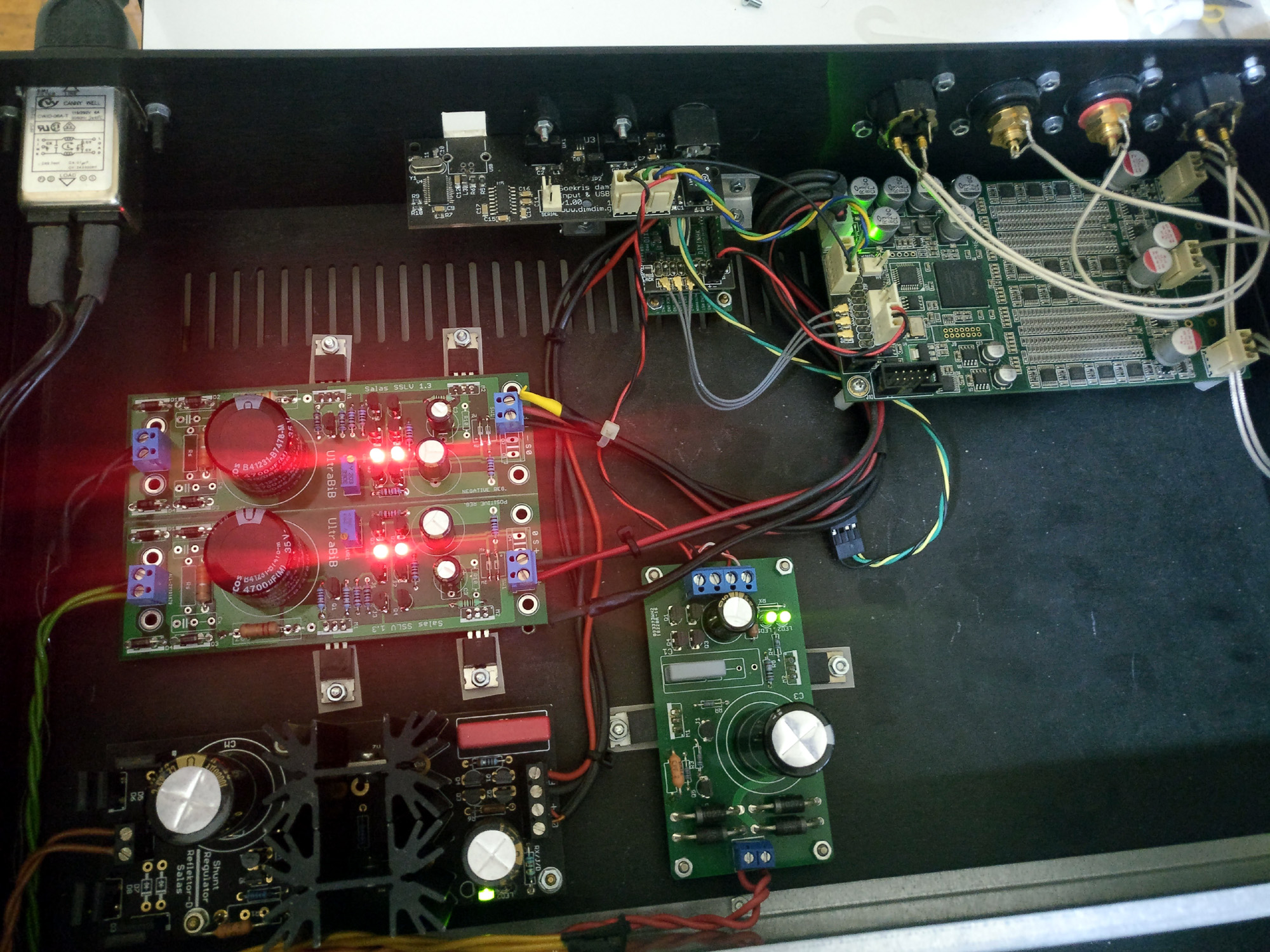

If it's not significantly inferior in theory then it's more or less fine by me for now. It's kind of difficult and perhaps a bit risky for me to A/B between the caps especially when the boards are stacked with almost inseparable pin/pin headers... Good to get confirmation from someone experienced that I'm doing something terribly wrong. 🙂

Btw what do you think of the 4V vref circuit in Soekris?... Is it plausible that vref capacitance was lacking? (3*100uF + 47uF MLCC) I heard a huge difference after I added 3*1500uF polymer caps per rail - much fuller low end and more naturalness/dynamics all-round. Even my noisy laptop soundcard is now more "analytical" than dam1021, though of course lacking in real low-level details.

It was Dimdim's build, I did not ask him. Is this picture from post #14 of any help?
A good test for presence would be something like this: McCoy Tyner Quartet - Ask Me Now
Looks like rev2 with 470uF polymer cap added to each rail. I think rev2 comes with 47uF each rail out of the box. Spikestabber recently added caps to his rev2 (or maybe rev1) and had great subjective results. Maybe Dimdim would be interested in trying the mod 😀
The filter caps I was worried about are the 4 at the top left corner. I think the 2 to the right are for 5V LDO and another RC filter so probably has their place on the board... Anyways, will probably leave them there as is since they don't interfere with UltraBiB 🙂
