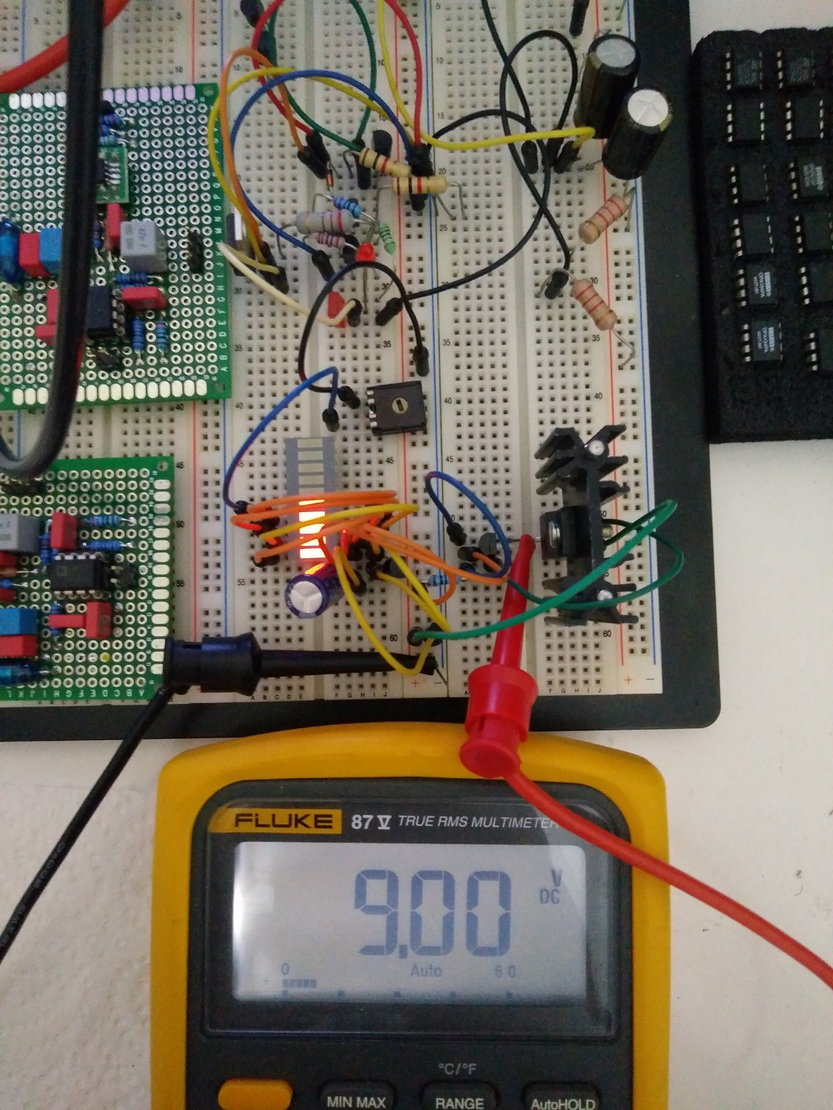

By the way, these days I was bread-boarding a possible linear solution for replacing SMPS bricks to such devices but without the high idling shunt heat. Based on the DCSTB series PSU of DCG3 fame but with a row of pins to can short and select how many Leds are lit for different voltage levels. Will 5V and 9V be enough or someone would need more levels up to near 18V? I don't know, for DACs with external bricks or Class D small amps maybe?
A TO-220 series transistor on a 50mm tall 25.4mm pitch board level sink would handle up to 5A peaks but the sink will be receiving low heat on average say 1.5W at 500-600mA Rpi consumption levels.

Thanks for opinion. If I used a ten Leds bar, only five of those are enough for 9V. So another five remain to reach up to 18V. A 2.54mm (0.1inch) pitch dual pins row next to the bar could be accepting a shorting plug to stop the lit Leds count at several voltage levels. Up to 15V eight energized reds are needed. Key for minimal sink saturation is to select a transformer that will not create much in-out DC drop for a given output level goal (2.5V drop is enough for this because BJT series type).

What lowish and near steady pulling dual polarity rail circuits you have in mind better serve with UBiB(s) for max subjective quality return. Series pass element linear substitution for external SMPS bricks I think is practical to be kept unipolar and simple.
