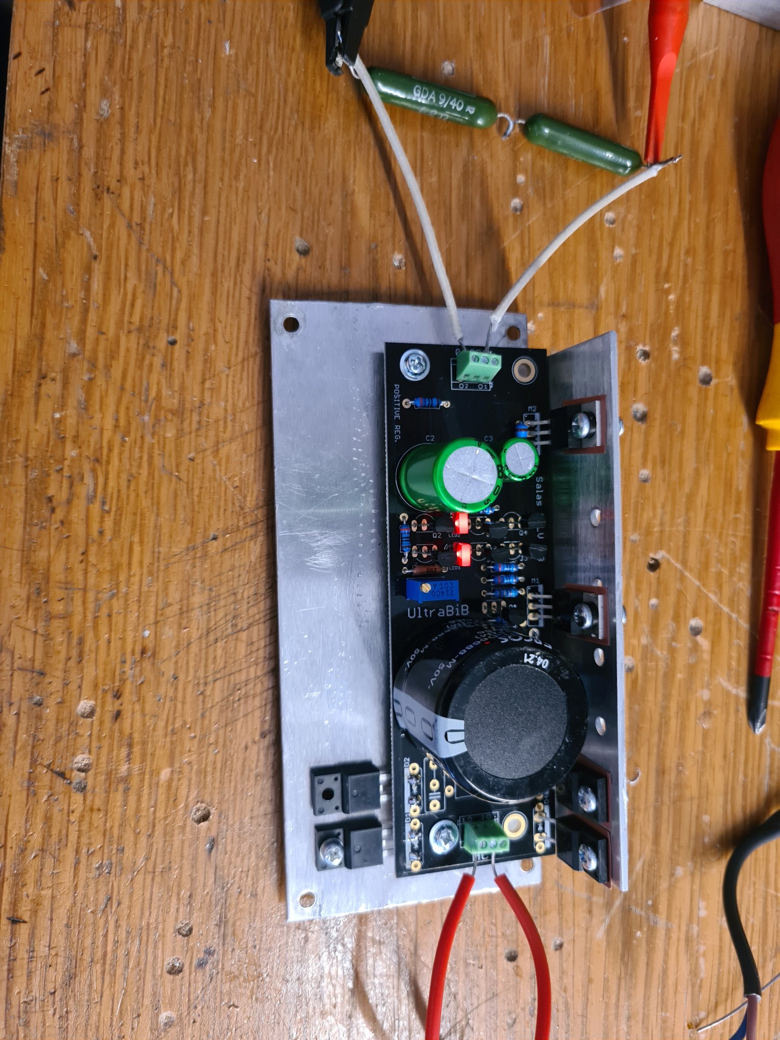

Thank you Sir. So it Turned out one of Led was cooked . Replaced it and it seems that trimmer was faulty too. I have replaced those . Run it however i missed reinserting R9 so was getting 4.7v unable to adjust. Installed R9 and now i can set voltage all ok without dummy load. When dummy load connected i get 4.7v and unable to adjust voltage . When i set trimmer then red Led are brither or dimmer. Any ideas what is buggered this time. I dont want to give up. I cannot actually . I must make this run regardless. Thank you. And iam about to start building power amp wish me luck.
Check if R1's Ohmic value is still OK. Then if there's still about 0.6V between its legs. Meaning the CCS system is still properly working. Determine mA by V0.6/R1. Make sure mA are enough for the dummy load value you check with. Vout/Rdum must be less than CCS mA not to limit.
You are right . At first for test i installed 1 ohm resistor on the board and i connected 10ohm load but now ia decided to test what it was built for So for low value 100ma plus 100ma i selected 3 ohm resistor for current limit . I connected 25 ohm load and set voltage nicely . Can I Set it to 4.9V ? Would it work ok in a long run ? Just to be Save that during start up it does not go too high .
Shortly i will test second board for 400ma so 600ma Total - therefore 1 ohm resistor and 12.5 ohm load i hope it would set well . And maybe today I will finally listen to I2S over usb who knows.
You can set it at 4.9V. Most built examples normally reach that low. See how Vout value behaves on the representative test load first. Should stay near target.

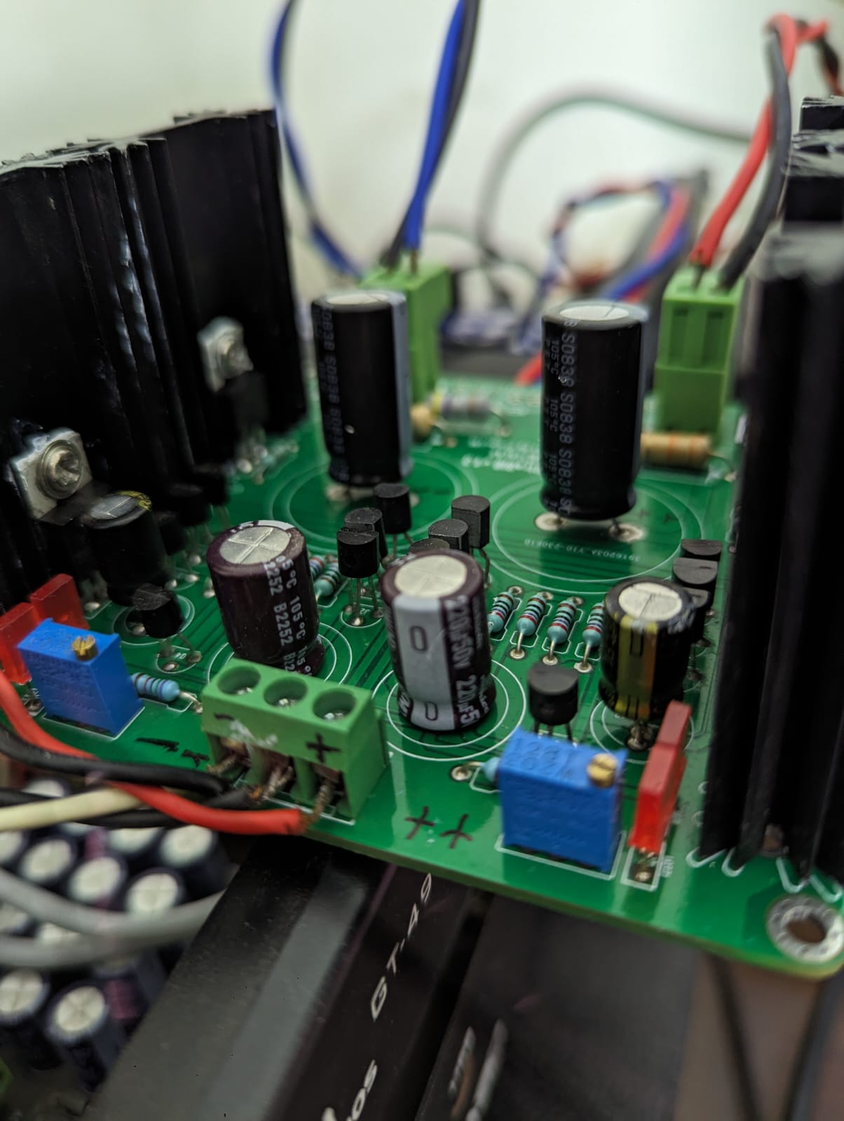

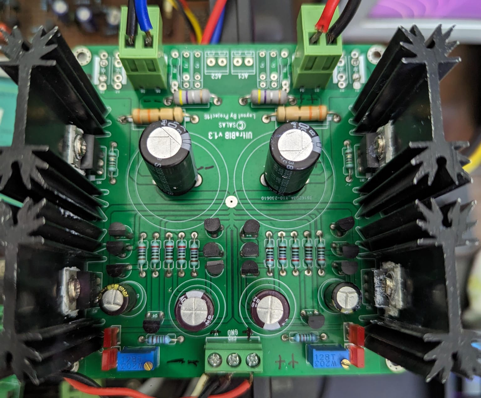

I wanted to first thank Salas for your great design. I have built the SSLV1.3 circuit and I am very happy with the results. I am using a DC supply and a mosfet cap-multiplier before the Ubib as in the pictures. I am using NICHICON UPW 220u/50v for C2 and PANASONIC FM 100u/50v for C2.
I am going to build another one for use in the second preamp and I have a question, could I use LM329 instead of the 2 LEDs for the voltage reference? what would be better?

Hello. So I have managed to get going both of ultra bib. It tirned out that I must have been excedding current with my resistors that is why I could not adjust voltage but I was adjusting led power . Atleast that is the conclusion I came to.

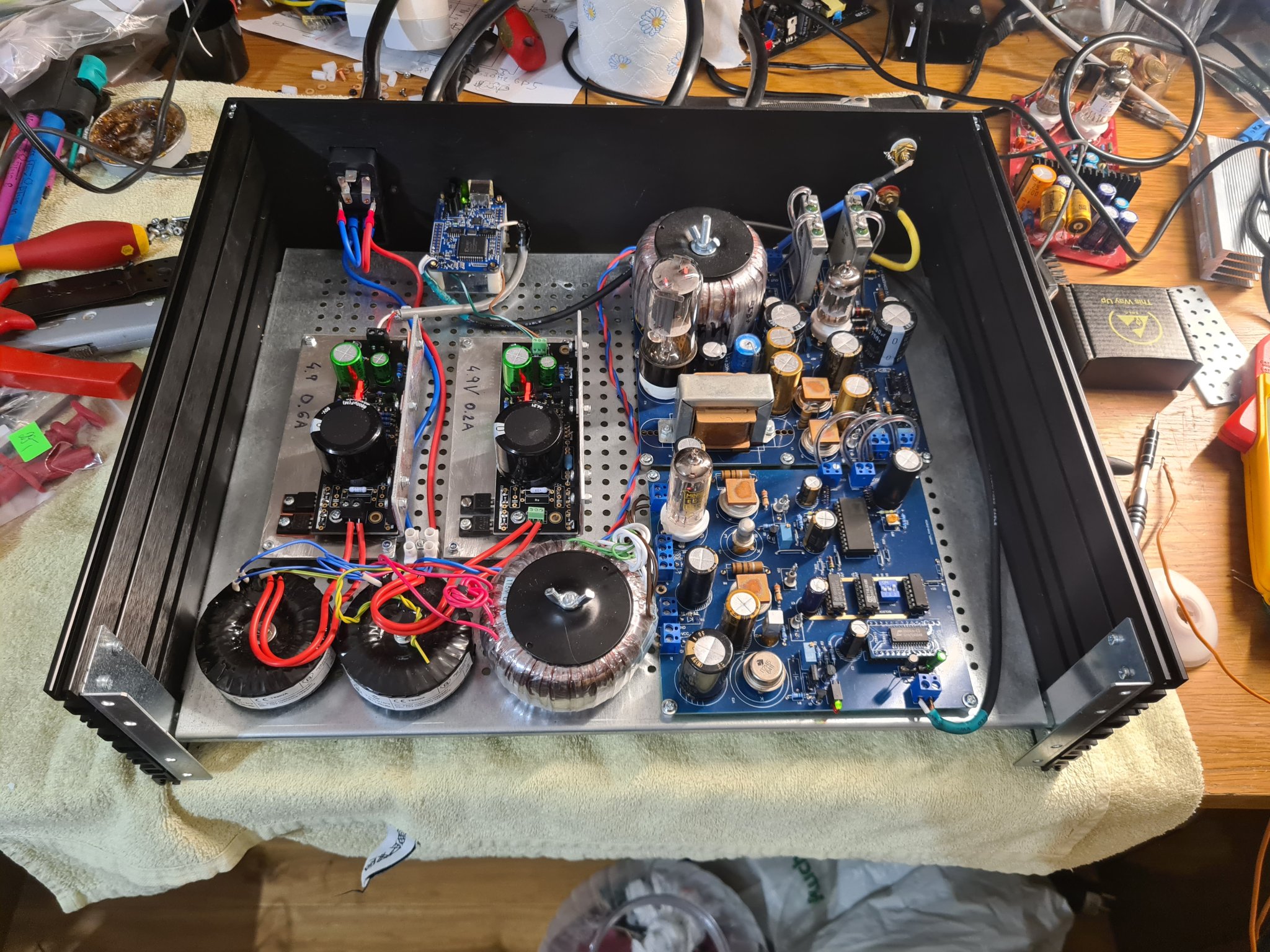

Anyhow it is built , it provides power , it works and it even plays music . Yet I have small problem . I can hear interference kind of like distortion that you can hear sometimes when you come close with your mobile phone to a radio however it is constant and gets louder with volume . It looks as if it is coming from source. So now I have general question . Should I connect ground from both ubib to ground usb device i2soverusb from jlsounds ? I mean via screws ?
And ground from dac board and tubed I/U board . It plays music and the quality from usb improved over old separate recklocker masively. However issue do not allow to fully enjoy. Would appreciate advice and if it is wrong to ask here I would happily start new thread.
The recievier IC is CS8414 and signal from usb board set to SPDIF.
Nice that it works. Congratulations.
Are you using the chassis as a reference for boards ground? Is the signal tube heater allowed to refer to chassis ground in that circuit for example?
Unfortunately i dont know about tube circuit as I have not got schematic . Its Abbas audio DAC 5.0 bought without enclosure as DIY. He informed that i can connect ground at the signal input to I/U board from ad1865 Digitall pcb and its best to connect in one point there only. Chassis is totally disconnected from anything currently well just the large ubib radiators made of aluminium. However those radiatory are fully isolated from ubib . So no connection to chassis at all.
I2soverusb is isolated from chassis too. No reference ground therfore as such. Not sure jow to proceed .https://youtube.com/shorts/Q7bvEwS4ATw?si=ppI59n5UF0Wmg182
Link to the video of the problem . You can hear mainly in left channel , right channel seems less affected for some reason.
Do you mean 0V DC output from both ubib to chassis ? Or one of the screw connections of each ubib to chassis ?
Thank you .
Thank you .
0VDC to chassis separately in turn and then from both Ubib to see if there are changes for noises.
