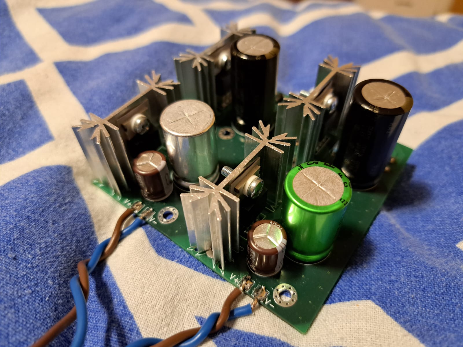

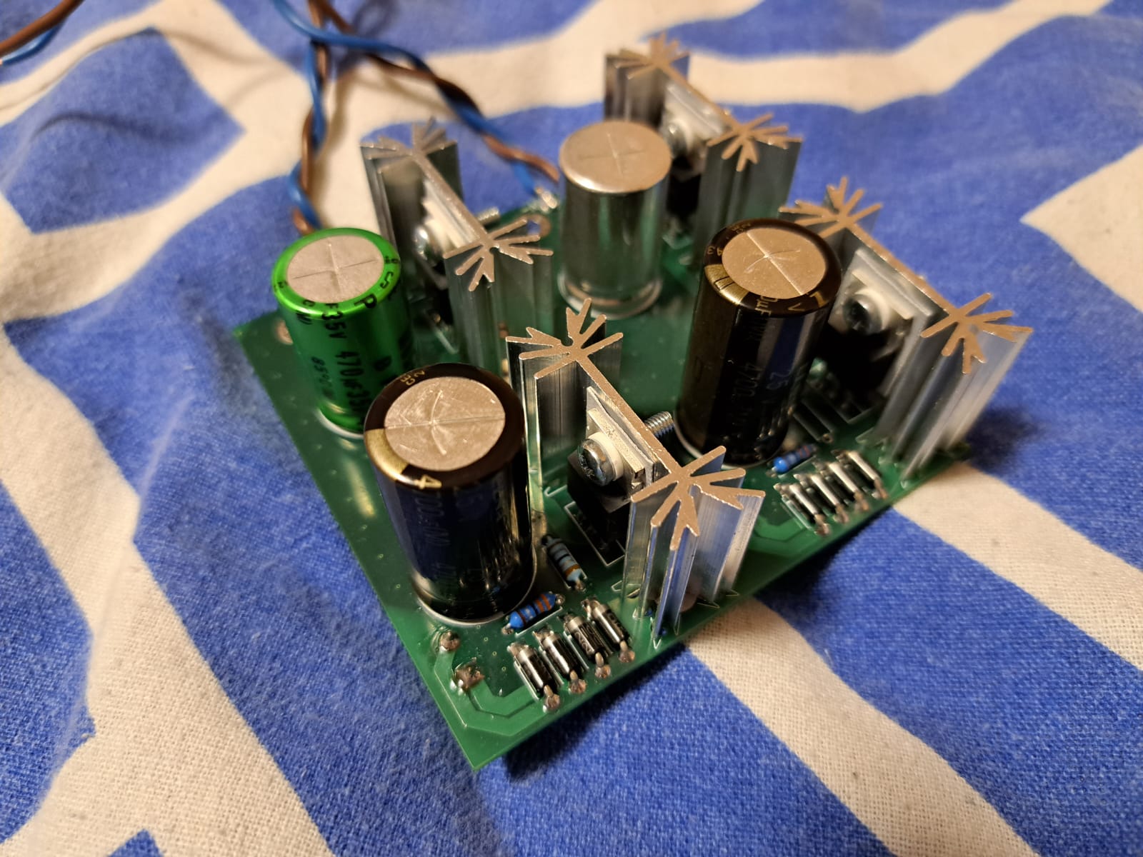

New double positive regulator with custom pcb is alive.
It will be used for DAC, one for digital and one for analog power supply.
This is 4 layer pcb with 2 internal ground planes.
Anyways, the supply is extraordinary thanks to the Salas!

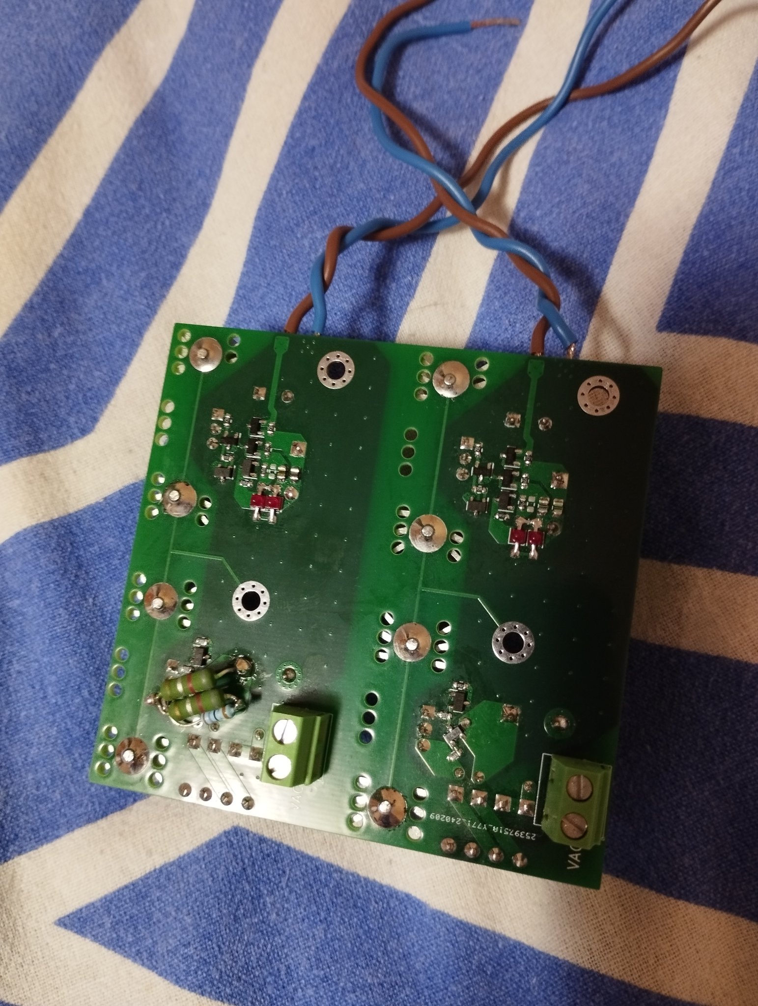

Why one side has three TH resistors underneath and the other does not?
This is a CCS resistor (3 in series), and I didn't have the vaule I needed. It will be replaced soon with single one.

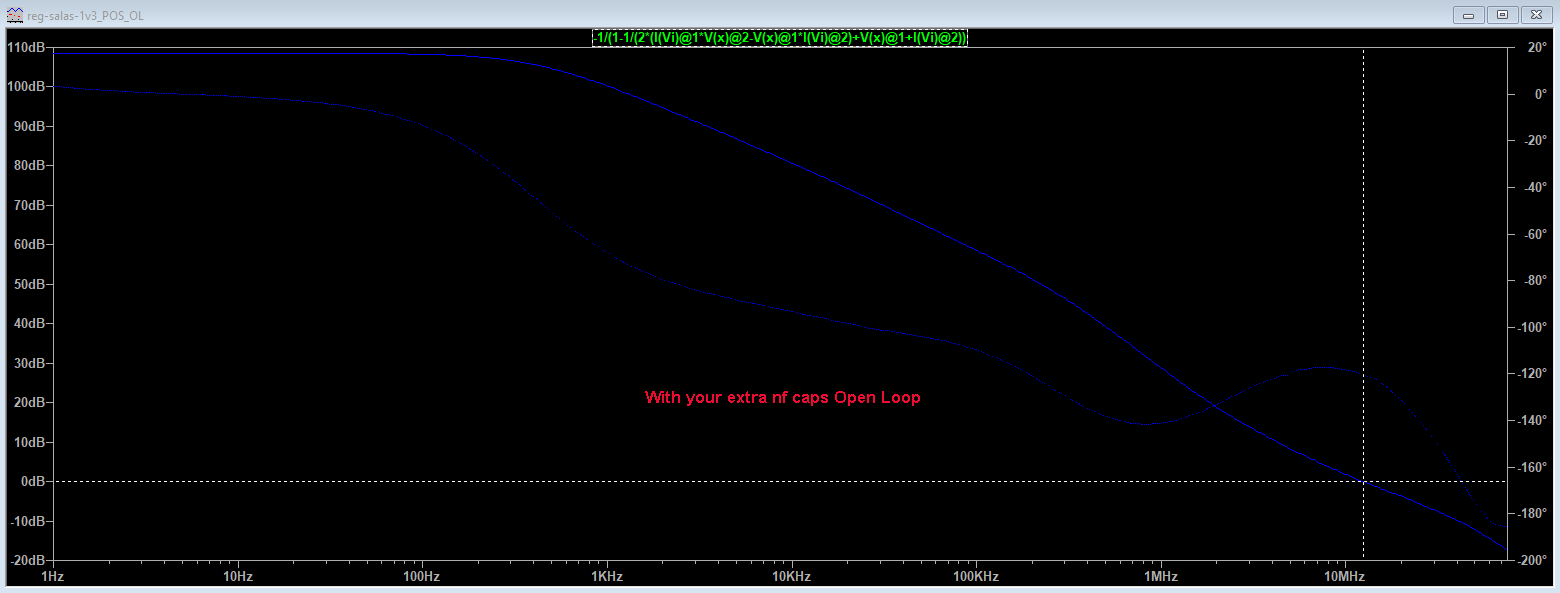

It is hard to see but i have PANASONIC 100nf PPS film capacitors between Q2 base and GND (parallel to C2), one is between Q3 base and GND, and there is a 0402 3.3nf C0G capacitor between two leds and GND.
The LEDs are HLMP-6000.
I got interesting results with this configuration. Somehow highs are more alive.
I don't have any preregulation on my DAC - it is supplied directly with this regulator.

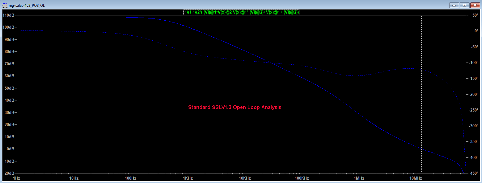

Here's the situation, generally more phase shift before zero gain.

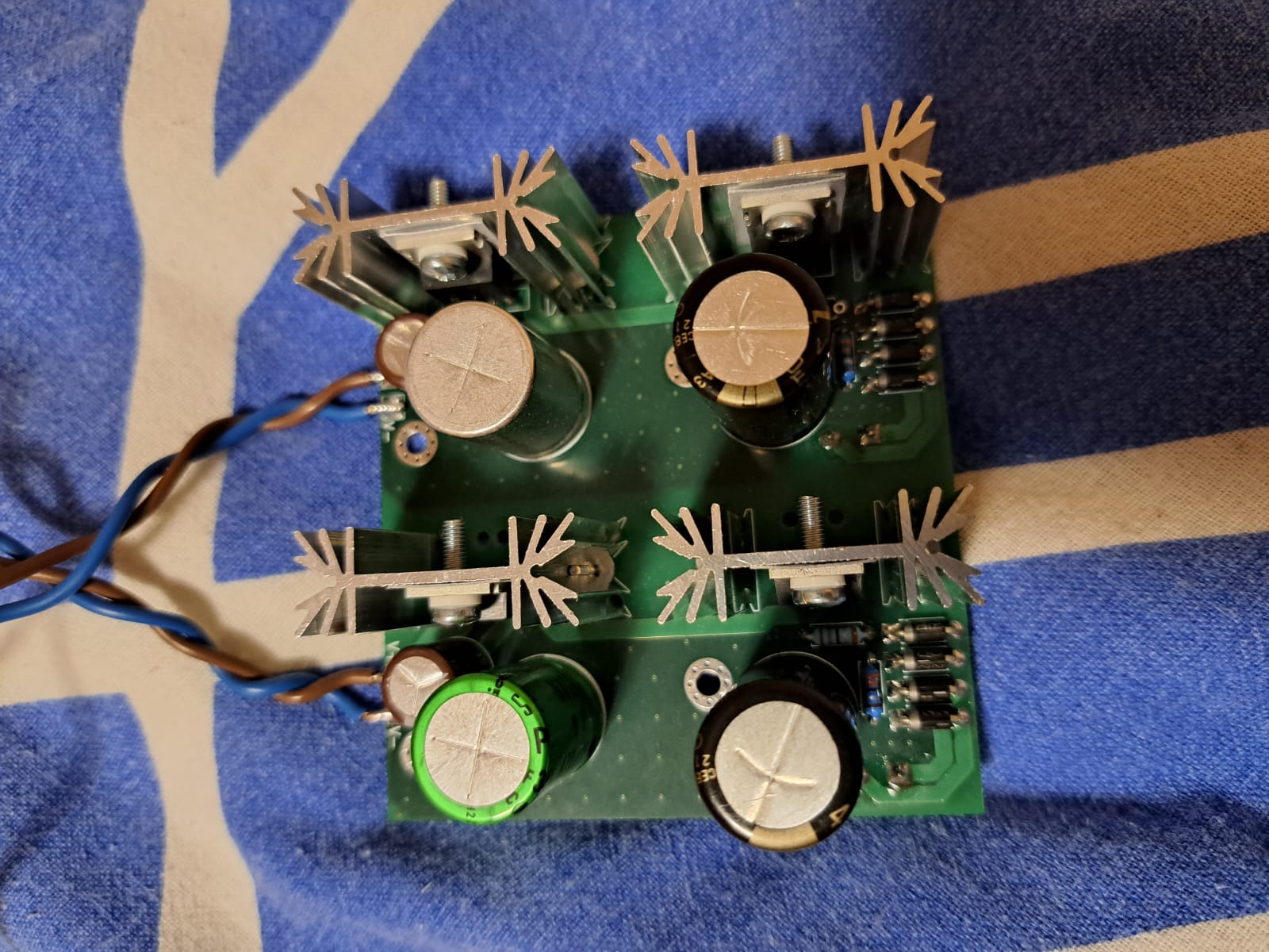

Is it OK to decrease C1 value to have less effective voltage across M1 for less heat dissipation?
For example I now have 320mA CCS setting, 12VAC 35VA transformer (outputting 13.8VAC), C1 is 4700uF and M1-Vds = 9V
I planned to make C1 2200uf or even lower.
Decreasing C1 increases ripple voltage. Which is AC. Thus you get less DC. I don't think its wise to exchange little heat benefit with more ripple. Ripple is detrimental.
You could alternatively add a few Ω power resistor between bridge and C1 making RC filter and eating some DC voltage. It will dissipate some power itself of course. Not a good looking botch on a finished pcb design also.
I thought about that. I might combine a bit bigger resistor (so it fits the PCB) and a lower voltage transformer. I need to buy new transformers anyway.
