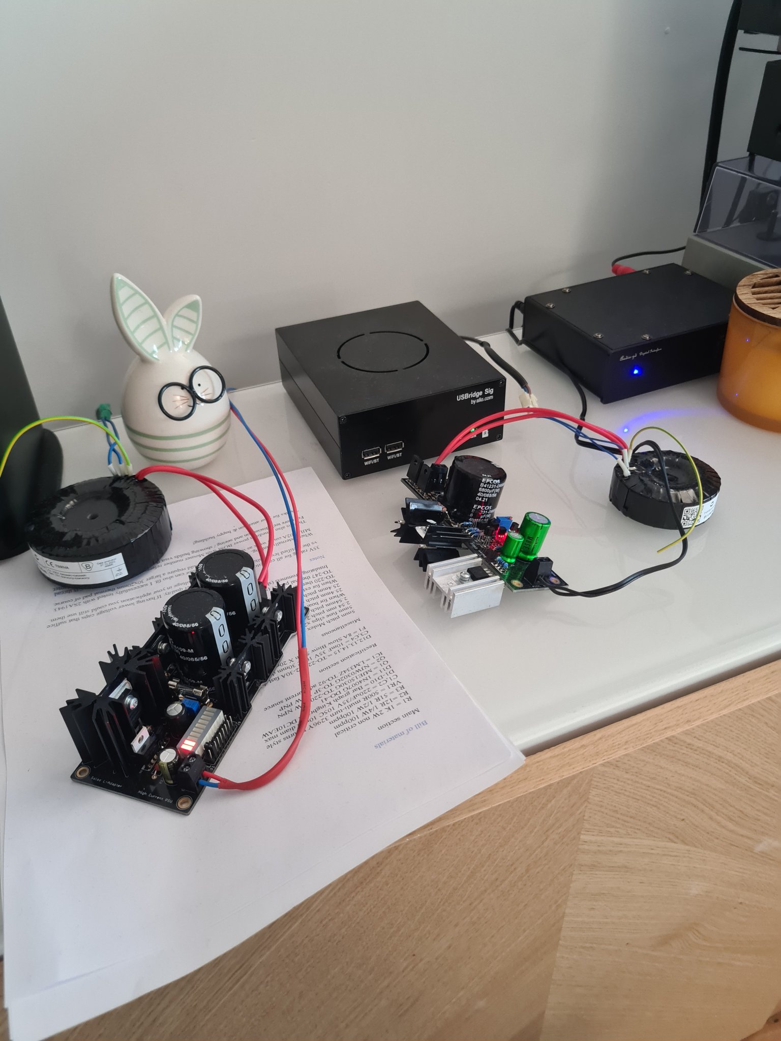

Hi . So I had some time finally after it burned in a bit and as expected there is no going back to wall supply . The sound was dirty and dark . Now is open and clear . Clearer vocals and Just clean signal . L-adapter definietly imroved base . To be honest since I changed both power supply for allo usbridge and recklocker audio gd its hard to tell which has made the biggest impact . Plus I constantly play with anode current on tube output in my diy dac so that is impacting sound too. I will get a different dac soon and once I get used to the sound then I will do a b testing so I can give better and more objective opinion. It certainly improved sound quality in my system . Still naked . Need to order some housing from china.Always nice to know impressions in system applications. About your L-Adapter build too.
Nice results. Congratulations. Just use as short as possible output cables when housed and placed. Happy new year to you and to all diyA members!

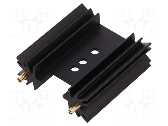

I am planning to use FISCHER SK104 pcb mountable heatsink.
CCS setting: 300mA
Max mosfet power dissipation: 2.5W
I am afraid that I would build an antenna with heatsink 🤣
Is it better in this low power scenario to connect heatsinks to chassis earth or non-isolated drains of the mosfets?
CCS setting: 300mA
