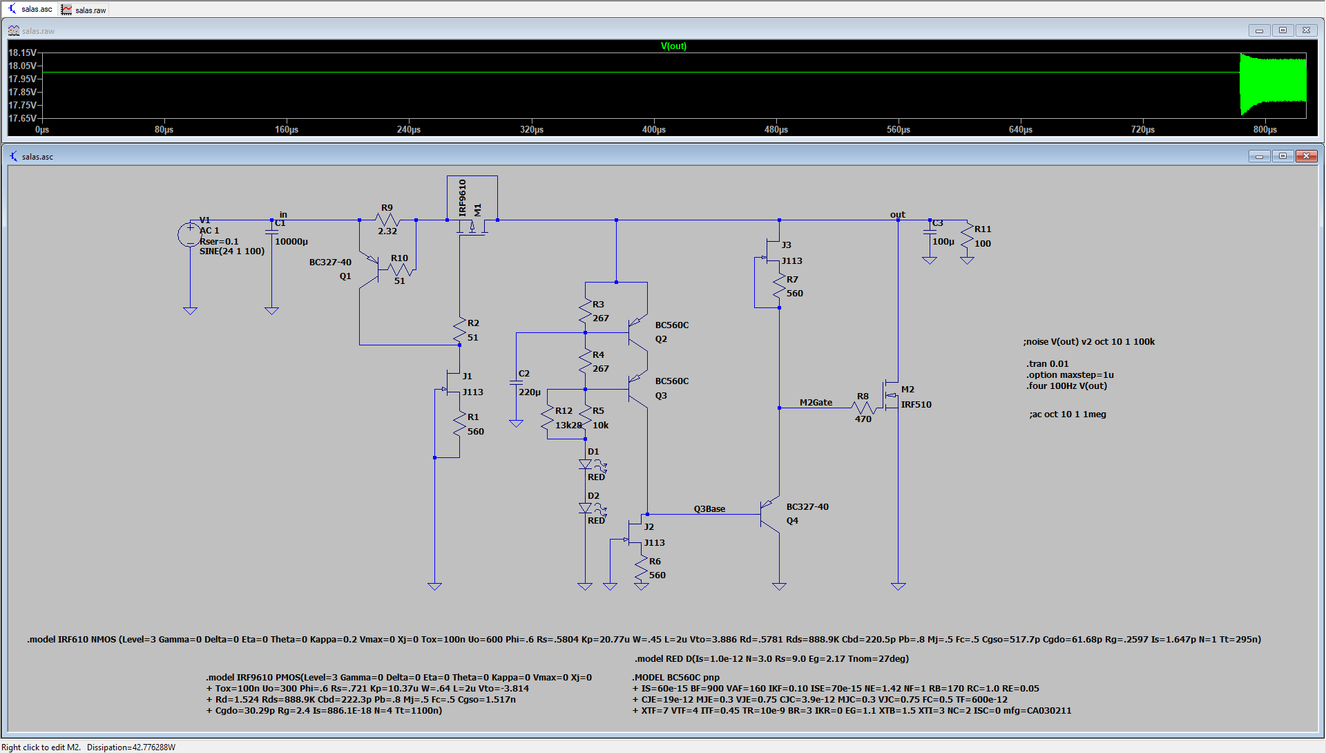

Salas SSLV1.3 UltraBiB shunt regulator
0.6V/2.32Ω=0.26Α thus 4.7W output power limit at 18V Vout
Metallic pad of M1 connected to drain internally.
So it seems I shorted R1 ouput to M1 drain.
Simulations shows different figures.
But anyway I am glad everything went okey in the end. :)

In this case the CCS doesn't work and max pass current is simply Vrectified-Vout/2.32Ω i.e. allows >> Ampere blowing a fuse and/or melting something down. Some medium size bridge diodes and R1 would basically break down quickly. Q1 over-currents also. Tx gets hot, its plastic wrap if toroid starts to shrink, M2 eventually bursts, etc. etc. If not fused.. disaster.
I felt heat like from an old oil heater and dry air smell.
All output transistors except Pos M2 was warm but M2 burned my finger throu heatsink.
I shut down power. Then got curios how hot it was, brought IR thermoreter and tested it the second time. (not a good idea)
After temp at M2 heatsink exceed 100 Celsius I shut power down again and start thinking what could go wrong.
Found it pretty quick.
It takes to skip the board's rectification section and make a different diodes external bridge arrangement for center tapped symmetrical.

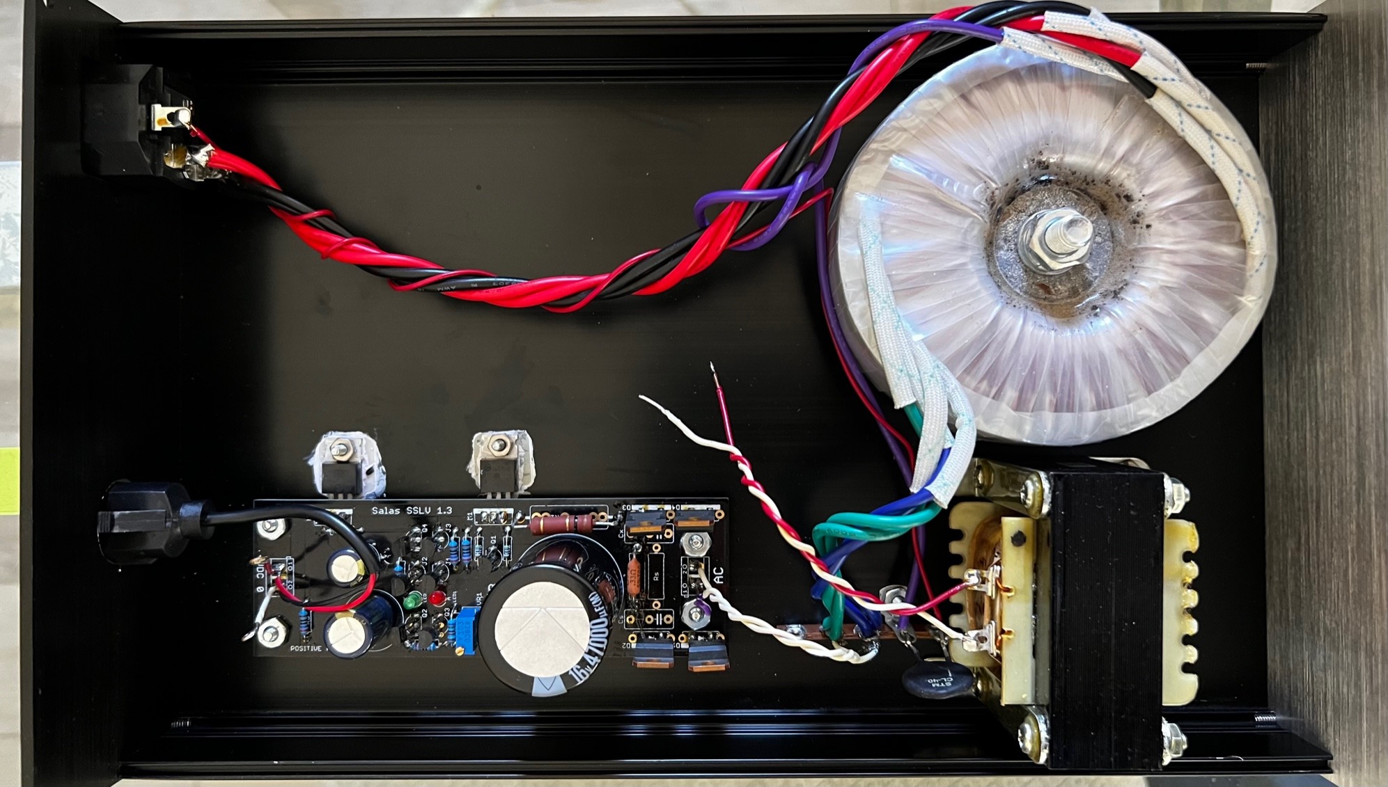

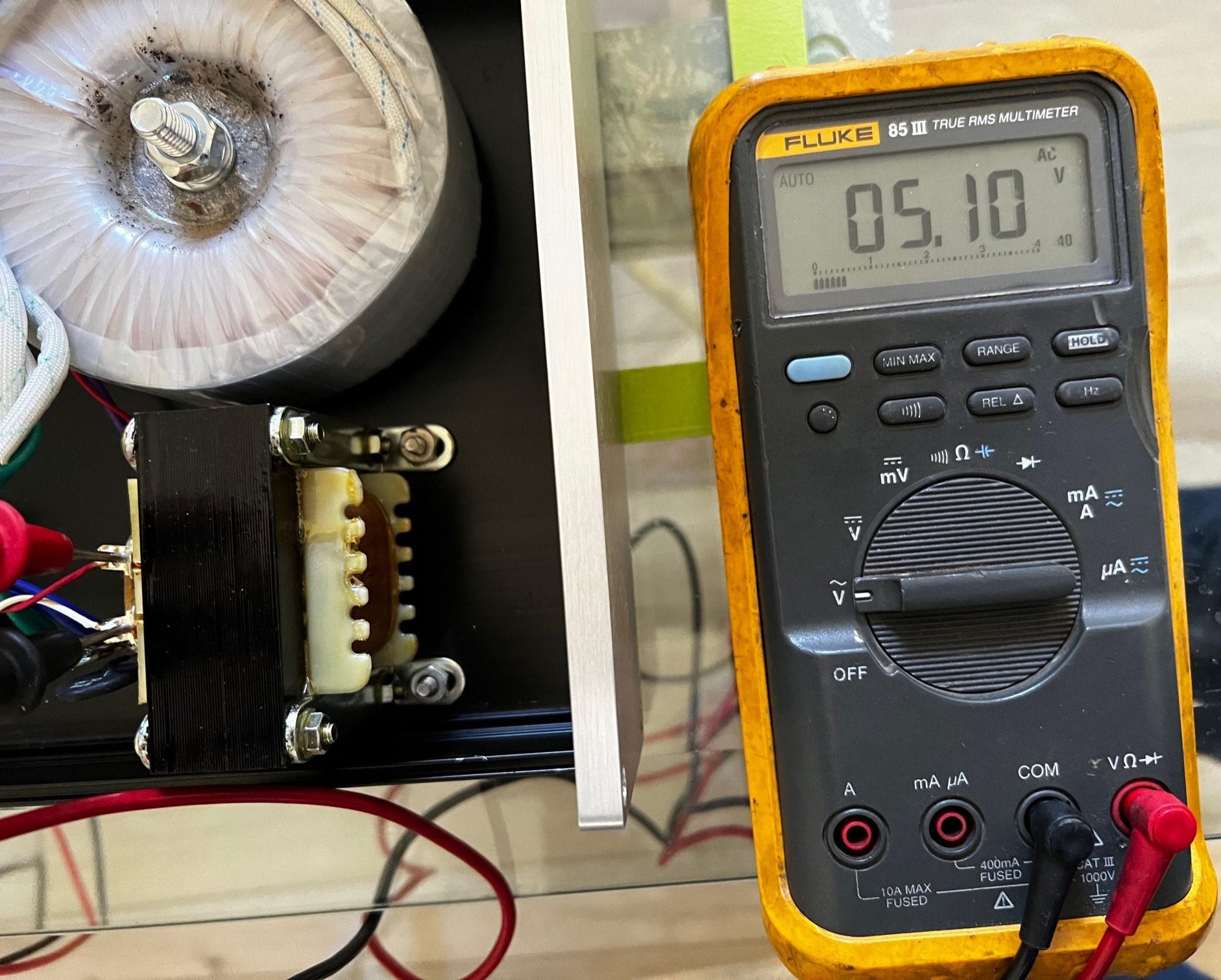

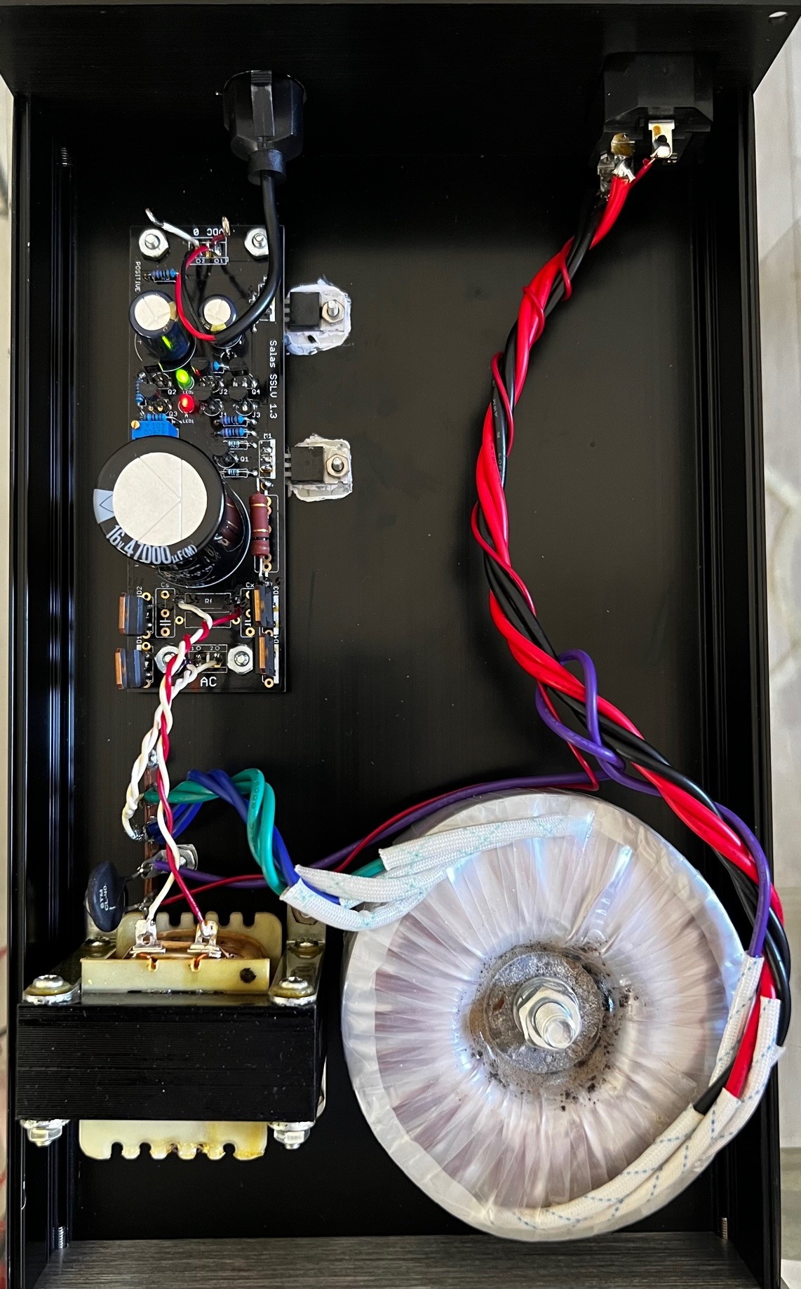

I built a pair of these as 5 volt USB connection power supplies using Salas' SSLV1.3 UltraBiB shunt regulator.
One for me and one for a friend that lives in Mexico who used to own a high-end audio store in Tampa, FL.
He came to visit and compare the two power supplies on a DAC-R.
The power supplies were built with the same setup as follows:
Antek AS-1212 - 100VA 12V Transformer (both secondary windings were paralleled): Antek $26
Triad Magnetics C-56U 35mH , 2A, .79 Ohms: Mouser $16.72
Salas SSLV 1.3 Power Supply board: Using 16V 47,000uF cap
The choke was used as a choke input filter on one supply, replacing the .33 ohm resister #rf. The other was built the usual way with rf in place.
Both supplies had the choke mounted, but only one was connected. I then installed the covers and could not tell which one was which from the outside as they weighed the same and had the same number of screws, etc. Months when by and I totally forgot which was which.
I have attached photos of the same supply connected both ways:

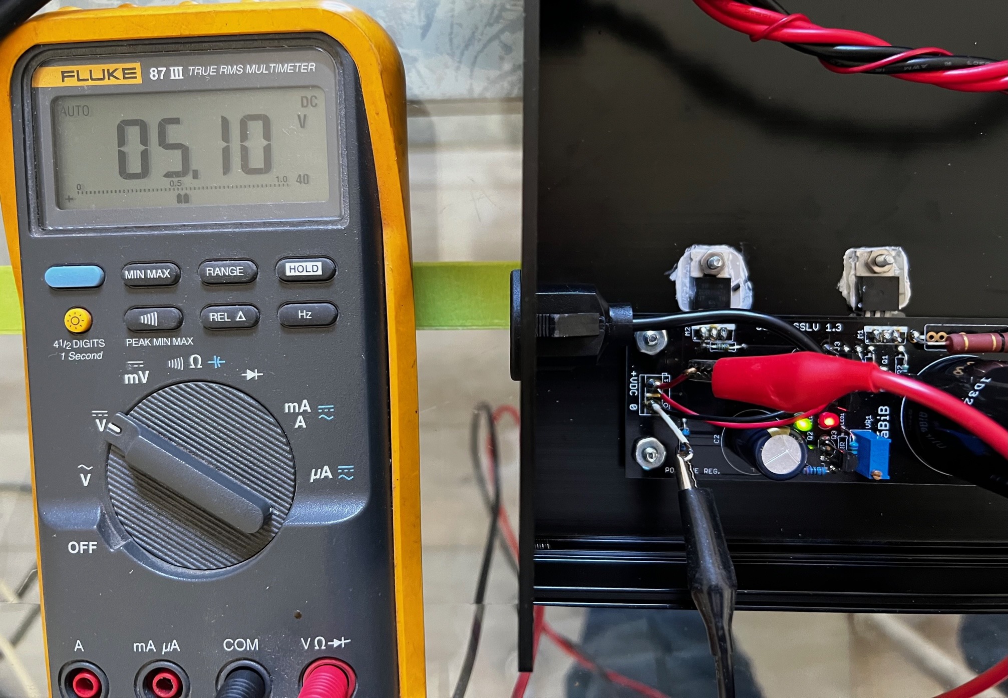

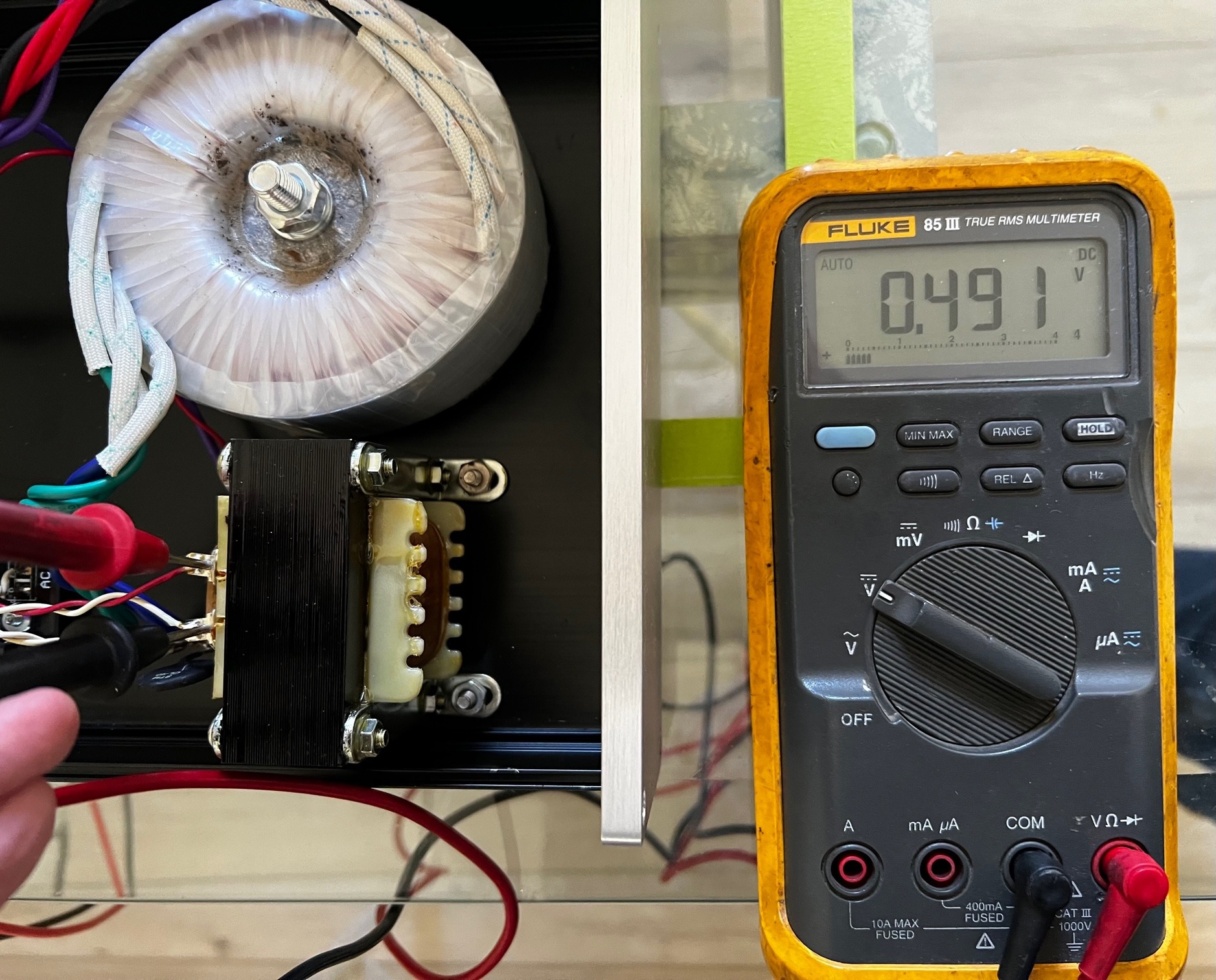

I took voltage measurements across the choke filtered supply
both AC (5.10 volts) and DC (.491 volts) and showed the out put voltage 5.10 volts DC. These were measured without a load.
After listening tests were conducted we decided the choke input supply had better depth and a darker back ground. By the end on the week, I connected the other supply as choke in put and took these pictures.

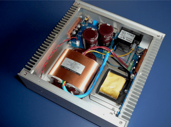

The idea came from a commercial product that touted the design. JS-2 linear power supply (picture attached at the end).

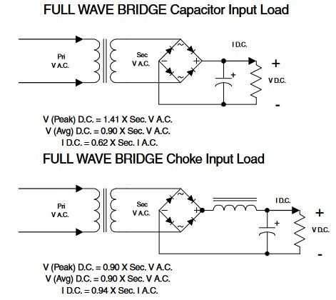

Hi, nice work and nice pictures.
Choke input will typically provide more regulation with more voltage loss on same secondary. See attachment (by Hammond).
*Regulation meant as less change in supply voltage for change in load current.
So we should make sure DC level on the reservoir capacitor is 10V or higher for Ubib at 5V output. Either for using Rf or Lin.
In general using Lin is considered subjectively smoother. Especially in the tubes world.

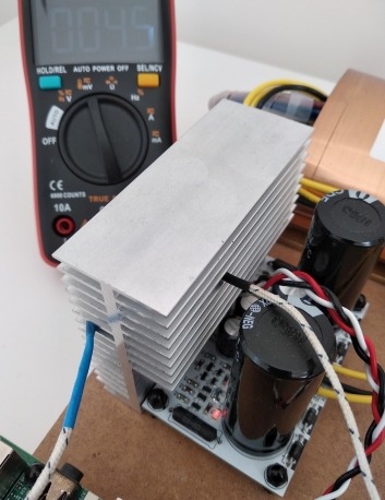

Finally got my UBiB powering the MUTEC MC3+usb. The result is far beyond what I would have thought possible.
I will go into a little detail in case there are others who want to do this.
I am using a 200 Ah 12 volts battery which also supplies an inverter for the computer and DACs. The UBiB is connected to the battery directly - I am using four 100uF nonpolar Black Gates as a reservoir. I have had them for years and figure this is a good place for them. The battery was there so why not use it? The drop is what UBib needs for a 6 volts regulator. I ended up with 6.1. The original smps supplied 6.3 volts per the manufacturers specifications. I did not measure it.
I removed the internal smps a couple of months ago and was using a Windsong regulator based on something slightly better than the ubiquitous LM317 - I cannot recall the model name.
I was kind of surprised that the difference was so small but we get used to this in audio when tiny steps are better than nothing. I knew I would eventually use something else and then it occurred to me - Ultra BiB.
After making about every mistake one could, which does have the side effect of learning, with the patient counsel of our renowned Chief Moderator along with being audio's Santa Claus except this Mr. Clause distributes his gifts year round, I got the thing attached after very careful testing with a resistor load and then to the MUTEC the change in sound was truly beyond belief. No small beer with this. This was an improvement on the level of placing the MUTEC in the chain initially. The terribly overused word, astonishing, can be said without hyperbole.
No expectation bias here; I expected it to be better but would not have expected this result.
So yet another with deeply felt gratitude for this regulator and its creator.
I used a large chunk of heat sink - a two inches thick by 6 x 5 inches of finned heat sink. R1 is 0.75R. I used DIYaudio store insulating pads. Another name I cannot recall.
I thought the heat sink would be warm at best - instead it is not HOT but well beyond warm. I must leave this on all of the time to keep the clock circuit at its best. After leaving it on overnight it is not as hot as my SIT heat sinks but not too far away. I do not leave the SIT amps on!
I am wondering if this means I am throwing away too much power and if I need to raise R1 a bit? I have not taken a reading of the voltage across R1. I will post that as soon as I do it. Could not wait to express by appreciation for what UltraBiB can do in this case.
