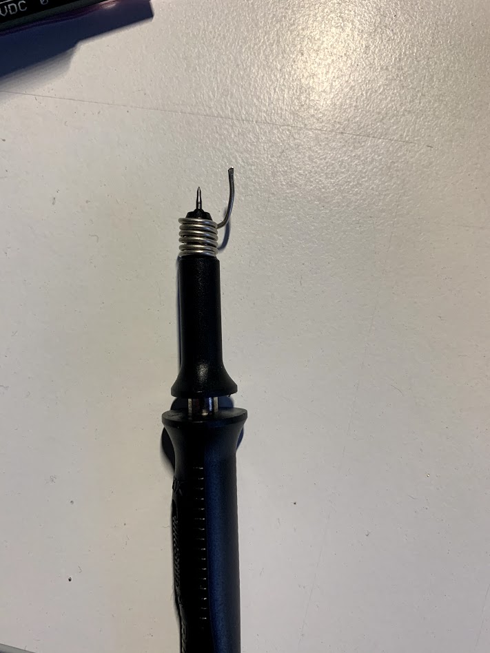

See with the continuity tester (DMM buzzer) if by any chance some connection or pad is broken in the first block of circuitry around M1. We need it to have few Volt Vgs. 11.5V is essentially 9VAC rectified. Passes right through to the output now.
Also has no ripple on output now? (Use the short ground probe nose spring).
