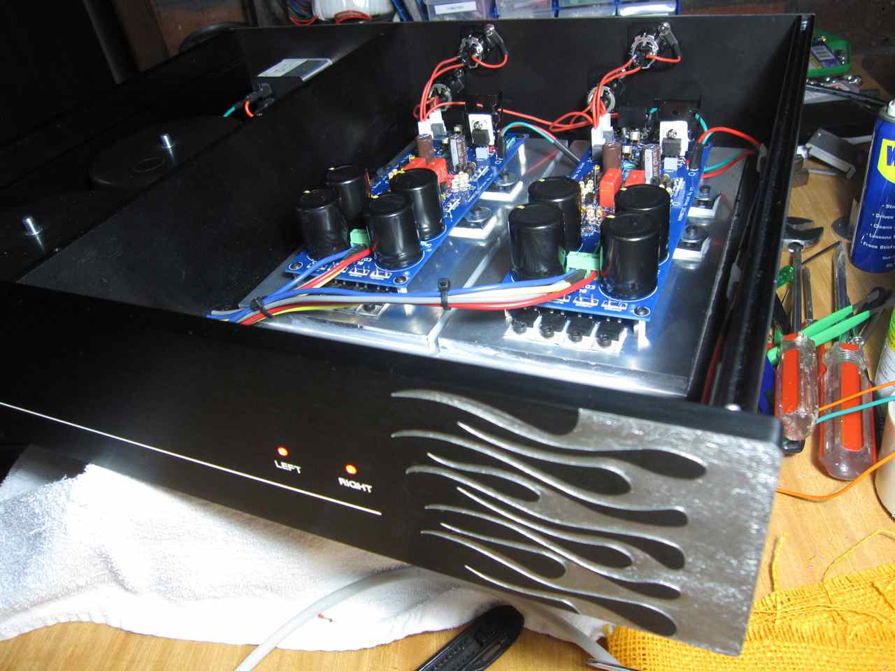

I’ve managed to do some listening to my balanced dcb1 I must say that I’m really impressed. I’ve only hooked it up between a Buffalo32 dac and a balanced headphone amp. No hum of noise problems to speak of. The fact I cannot tell that it’s in the signal is saying something 😀

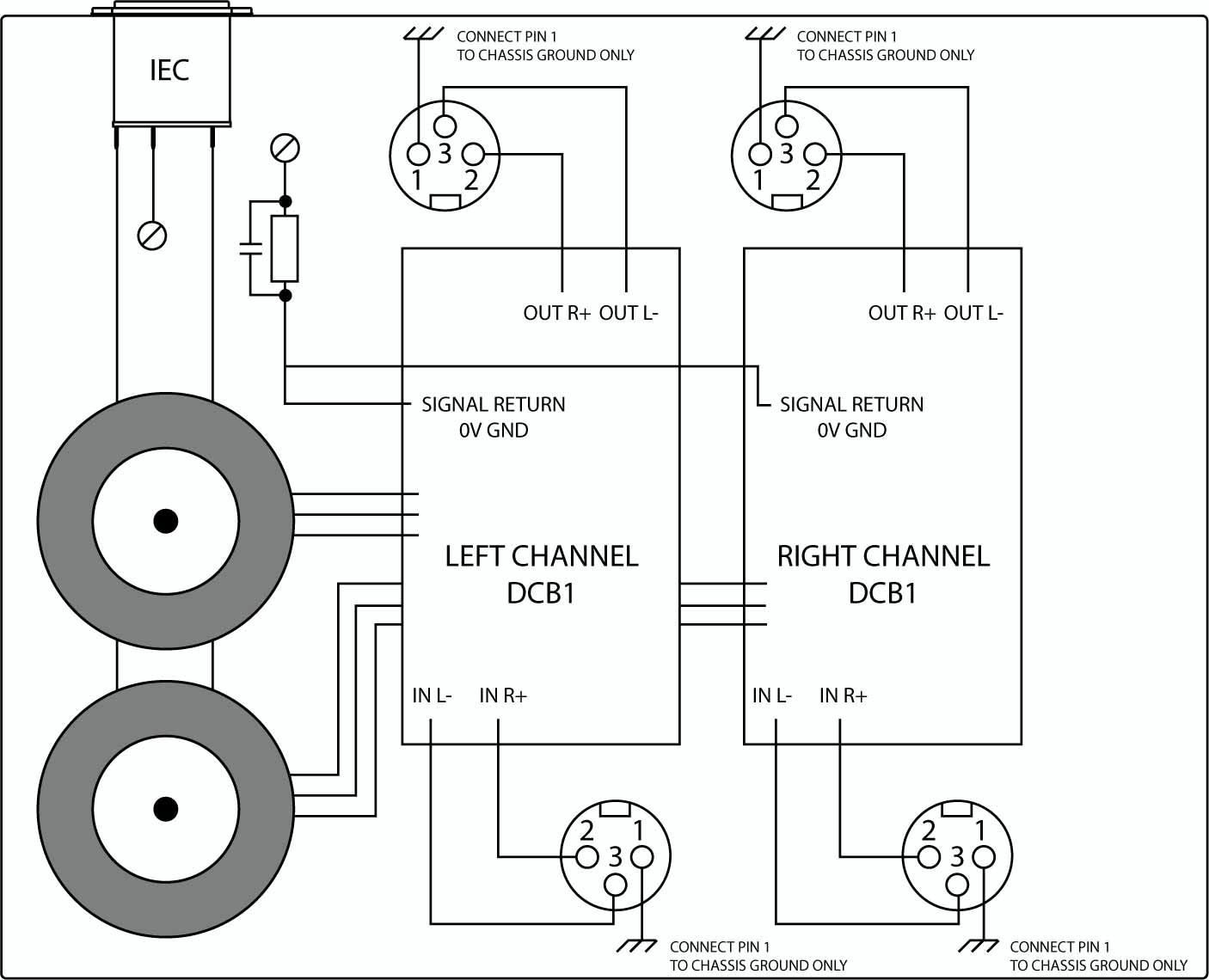

nycavsr2000 attached is an updated diagram that is working for me, well as least its sounding good so far.

Some final pics for entertainment :snare:
*Wiring diagram updated to match that of post 1333 as requested. :captain:

FYI the signal return on both boards are connected to ground chassis via a ground loop breaker as follows;
The ground loop breaker is a 10Ω 5W resistor in parallel with a 0.1µF capacitor rated at least 250VAC. For safety this capacitor should be rated for class X or Y (good for across-the-line use) with flame retardant casing.

Nice looking build John.
If I recall correctly, you were running a stage 2 at 600ma. Are the mosfets staying cool enough?
Thanks Mike, yes 600ma, after a couple of hours I measure 35°C, comfortably warm.
I recommend a pair of diode connected inverse parallel in parallel to your Disconnecting Network (loop breaker).
This limits the voltage difference between chassis and audio ground to <700mVpk during normal operations and ~<=2Vpk during fault to earth operation. A pair of 1n4002 would do nicely.

Can somebody validate the balanced wiring on Tea bag's blog. It appears to be different from the one posted in #1321. It seems to be missing a wire on the left channel input. Furthermore, it indicates both boards as being for the left channel.
regards.
necplusultra thank you!
This is now corrected see attached;
Tea-Bag please update the diagram to the attached.
