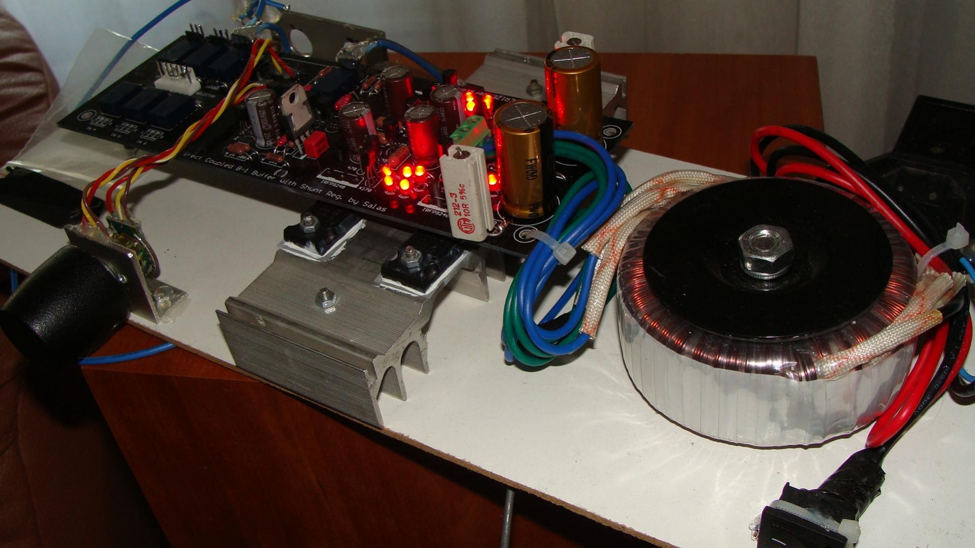

I realized the right channel of my DCB1 is dead. Not sure why. Both channels were working before, but after i unmounted the pcb from the chassis because i wanted to mount the mosfets to the bottom of the chassis, i connected everything back and voila, no sound on the right channel.
The offset on the right channel is suspiciously low (1 mv vs 3-4 mv on the left?), makes me wonder if it's even working. Voltage across both resistors are in range; voltage across the mains (?) is ~ +/- 9.50.
Not too sure what else to check. Possible that i fried the volume pot while dismantling everything? Is there any way to check? Pretty sure my solder joints are good.
Also, after mounting the mosfets to the bottom of the chassis, i realize the chassis doesn't seem to get that warm at all. I'm using the first level hot rod option. I used normal screws + nuts - is that not sufficient to maintain decent contact?
What parts should be changed to get offset as close to 0 as possible? Help is much appreciated!

Did you use pads for insulating the Mosfets from the chassis? Knock the relay with a screwdriver in case it got stuck.
Yes, mosfets are insulated with thermal pads. Okay i'll try knocking the relays. Anything else i should try? Thank you, Salas!
A dead fet or two in the audio couple of the silent channel maybe, connections, practical stuff.
Meaning to say the 2SK170s right? I took out the board, redid all the solder connections. Still the same result. But i realized if i turn up the volume loud enough, the 'silent' channel does have a *tiny* bit of sound. Really, really soft though, almost inaudible (hands can feel mild vibration of cabinet).
If it's the fet, it makes me wonder how they were spoilt in the first place.. since it was working fine before.. hmm. Could it be a potential relay problem? I'm not sure if i'm imagining things but the relay seems to take a longer time to click. Or is that related to a faulty fet, if any?
Since the voltage points measure properly, is it safe to say i didn't fry the mosfets and they're working fine? Or do i need to change them as well?
Will matching of the 2SK170s help with the offset? Since i'm going to change the FETs then i might as well shoot for as low offset as i possibly can...

Some discharge when you were handling the boards maybe, can't say. You need to feed signal and follow it, to see where it stops. If you don't have an oscope, DVM on ACV can detect. Feed 300Hz (test CD, or there are software generators free, google up) at about 1VRMS and see until where it makes it by probing the path, starting from input RCA, finishing at output RCA including interconnect cables. With DVM on Ohm you can check continuity, if relay engages, etc. 100% audio circuit jfet matching helps offset naturally.

You are asking for a guess. The right way is to test as I described. If its to guess and eliminate by probability start with changing the audio fets in the bad channel but don't be surprised if they aren't the problem in the end.
The jFETs are not easily damaged.
I rarely use the heat shunt (sitting on the shelf) when soldering any semiconductors.
I handle all my FETs except opamps.
So far I cannot blame my bad handling/soldering methods for any failures.
Plenty of failures due to mis-connecting.
I think you have a broken connection somewhere.
If one or other of the jFETs had gone bad, then I don't think the output offset would be near zero.

So this time i tried taking out the male 3 pin molex at the output, to see if that was the problem because i was fiddling with the pins before and bent it quite a bit. Measured the right channel output directly at the pcb and the offset is ~ 0.. so the right channel is probably close to dead (since there is *very* slight sound) i guess? Possible relay problem? Looks like i'll have to do proper testing as Salas rightly advised!
I think the relay would cause a problem with both channels.
Measure agross the pins of 4 2SK's. D-S.

I can't hold my hand on the sink for more than 5 sec. I have let the pre working for 30 min and it survived.
Thank you for your advice, Tea-Bag.I think the relay would cause a problem with both channels.
Is this the right way to test?

Am i supposed to test the 2sk while the dcb1 is on?
No,
the measuring/testing is done with the DUT in a jig.
You can check the accuracy/repeatability of your testing by measuring the output offset from the completed DCB1.
