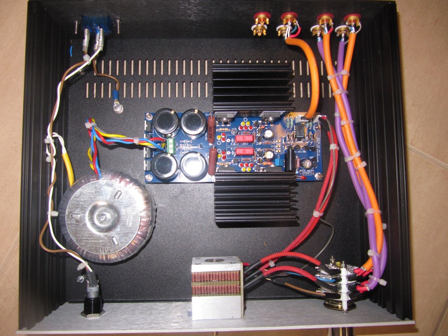

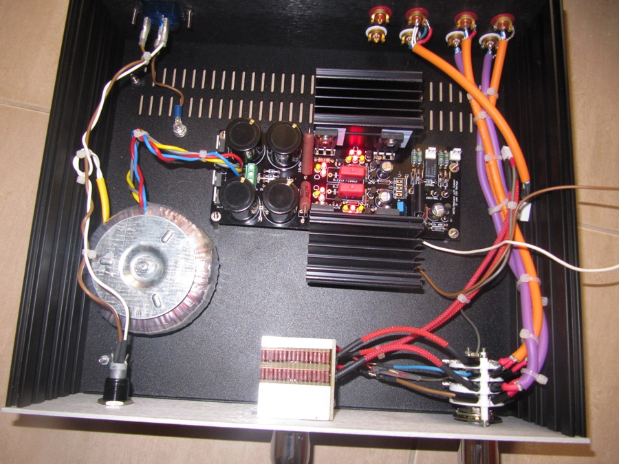

new board, a black one, populated
measures fine
1,83 - 2,01 across Mills
9,73 - 9,69
and 0,9 - 1,5 dc
measures fine
9,73 - 9,69
and 0,9 - 1,5 dc
Shall we be suspicious you sabotaged your previous just to go black? 😀😀
Nice volume control BTW.
lol ..
build 4 allready, never had any issues except this one ....
but I must admit , the black one is ...
this khozmo pot is very well build, I just hope it sounds as goog as it looks...
first listening test ....
dont know if its the khozmo or the naked foil 220R's (probably both), but it is certainly better than the 3 previous dcb1 I have build and heard (including a non hotrod version) ....
christmas came 2 months earlier this year
superb ..!!!!!!!!!!

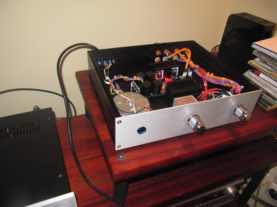

Nice build DimZ! And nice power switch..... where did you get it?
ty,
I got the switch from audiophonics
