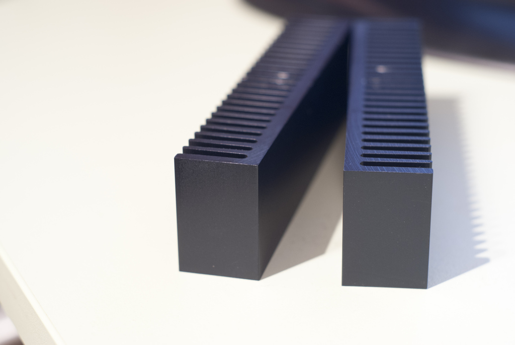

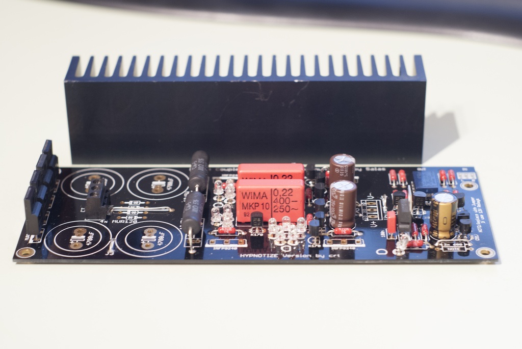

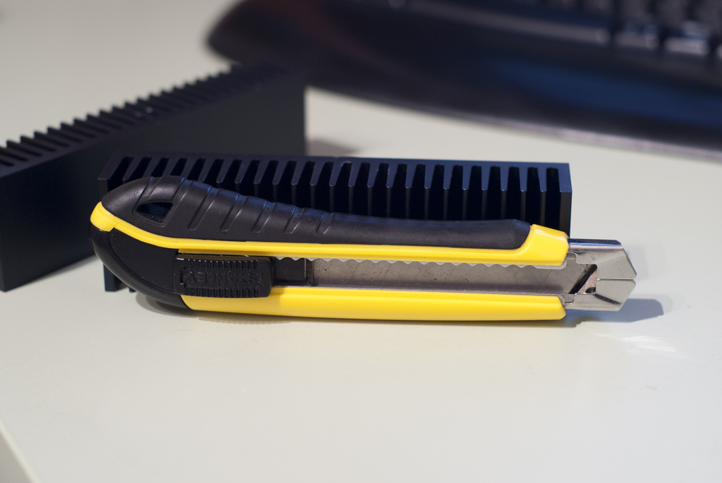

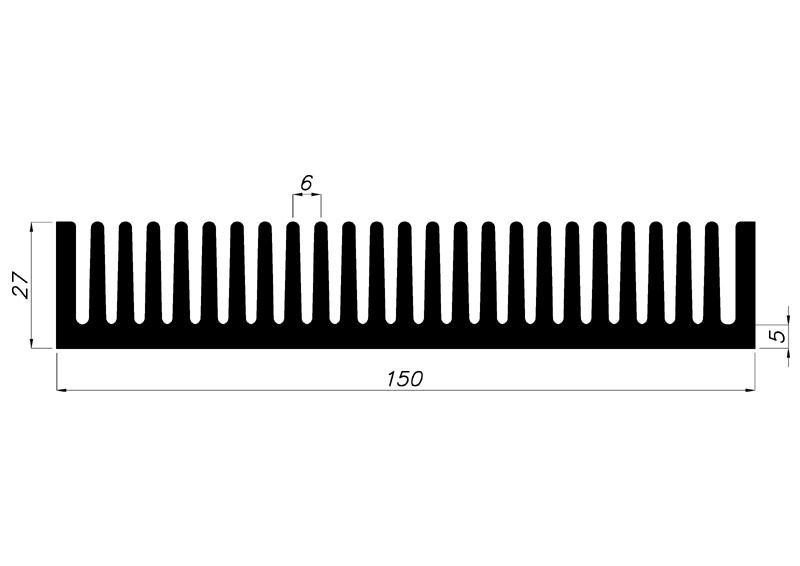

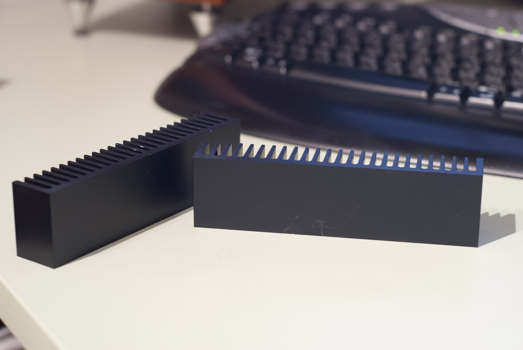

Dimension of heatsink are: 150x27x40mm [LxHxW]
Hmm, if it will be affixed to thick enough metal chassis with ventilation holes on top and bottom.
They will have to receive 12W each side constantly. If we assume they are 1.2C/W capable, that will mean +15C on ambient. In a box with 40C average inside after warm up, that will mean 55C on the fins. If the box is not ventilated well, soon its ambient will climb.
