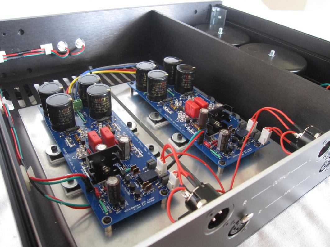

Those Mosfets are tough, I don't expect them to fail easily, but take care that the whole thing develops comfortable box ambient temp when packaged, so its capacitors will live long etc. All things in nature hotter deteriorate shorter.
Of course, in worst case scenario I will put whole board on 10mm thick aluminium block and bolt mosfets on this block and beside mosfets also bolt those heatsink.
Something like this just in my case I'll put those heatsink on this 10mm thick aluminium block.
Better yes. They can handle it in a moderate ambient at 0.6W per TO-220 even alone, but no good long term practice. Since you use the plastic coated ones, a common metal plate to help them, is no insulating hassle.
Hi Igor,
Salas has done a dissipation calculation for a 150mm tall heatsink.
Your heatsink is a lot smaller. maybe 1.9C/W @ deltaT=70Cdegrees.
Your transformer rated at 50VA 15Vac is effectively rated @ 3.3Aac.
This allows 600mAdc to use just 37% of full rating. It will run cool.
Expect about 22Vdc to 23Vdc at the input to the CCS when set to 600mAdc.
The worst case power dissipation (output shorted) is 0.6 * 22 * 1.06 = ~14W
DeltaT = ~14 * 1.9 * 1.3 = ~35Cdegrees.
Ts ~ 40+35 = ~75degC.
Tc ~ 75+ 1*14 = ~90degC.
De-rate a 120W 150degC device for Tc@90degC and you get [150-90] / [150-25] * 120 = ~58W.
Your worst case dissipation of 14W shows the device can survive due it's de-rated power capability being very much greater (@58W)
You will need to check the actual DC input voltage at the CCS to double check the actual dissipations. Sum the CCS and Shunt dissipations and apply that power @ nominal mains voltage to determine deltaT for the sink during normal operation. It will be very hot, so internal location is probably best. The rest of the circuit will be exposed to all this internal temperature.
Andrew, thank you for calculation.
I messed up things a little. I have 10R resistors and thought those are for 600mA but this morning I went through this thread and found out that 10R is for 200mA hot-rod.
In this case, those heatsinks would be suitable if I'm not mistaken?
Once again, thank you for calculation. 😉

I am glad someone is awake.
It never dawned on me that Igor could have dual secondary transformer but state 15Vac as the rated output.
If John is correct then the transformer will be run @ ~ double that 37% for the whole transformer. The one loaded winding will be run at ~74% of maximum continuous rating.
Solutions:
a.) reduce the CCS current
b.) parallel the 15Vac windings
c.) Accept that one secondary runs a bit warm and check the surface temperature of the transformer once up and running.
