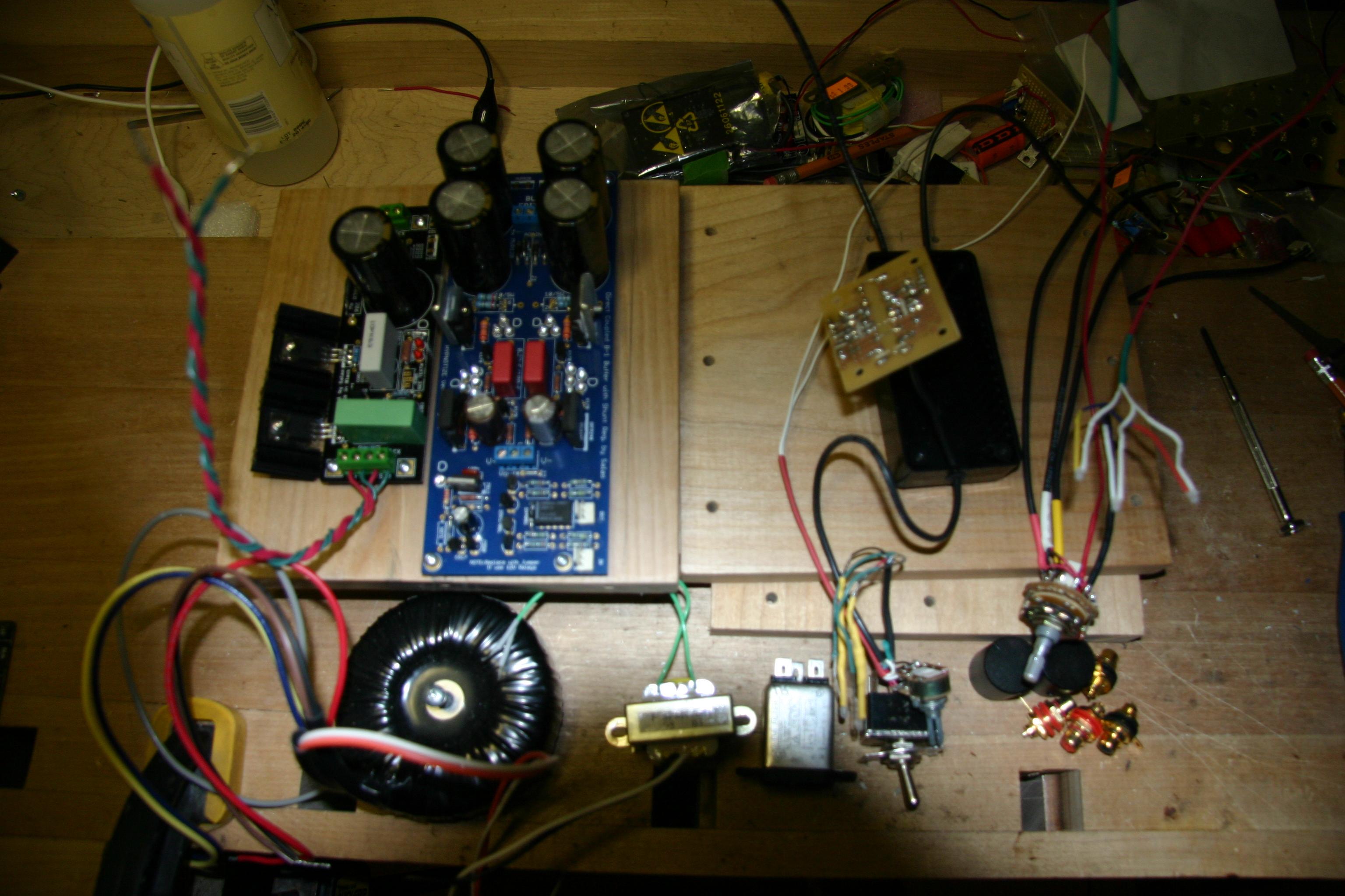

getting major hum on one channel, the other is good.
anyone can guide me to troubleshoot with this?

short both inputs, one at a time, see if that helps.
By short, I mean connect input positive and ground.
It kinda sounds like a ground loop.
How is the system connected. If your bi-amping, turn one amp off.
I removed the ldr and selector switch and have only R-G-B wires hooked up to the input.
I still get a hum but now, when I short the red input channel, the hum disappears, the black channel is still ok.
I reconnected all my wires and all is working now.
Zero hum!
bass is tight and very precise. Quite pleaesd with the setup
