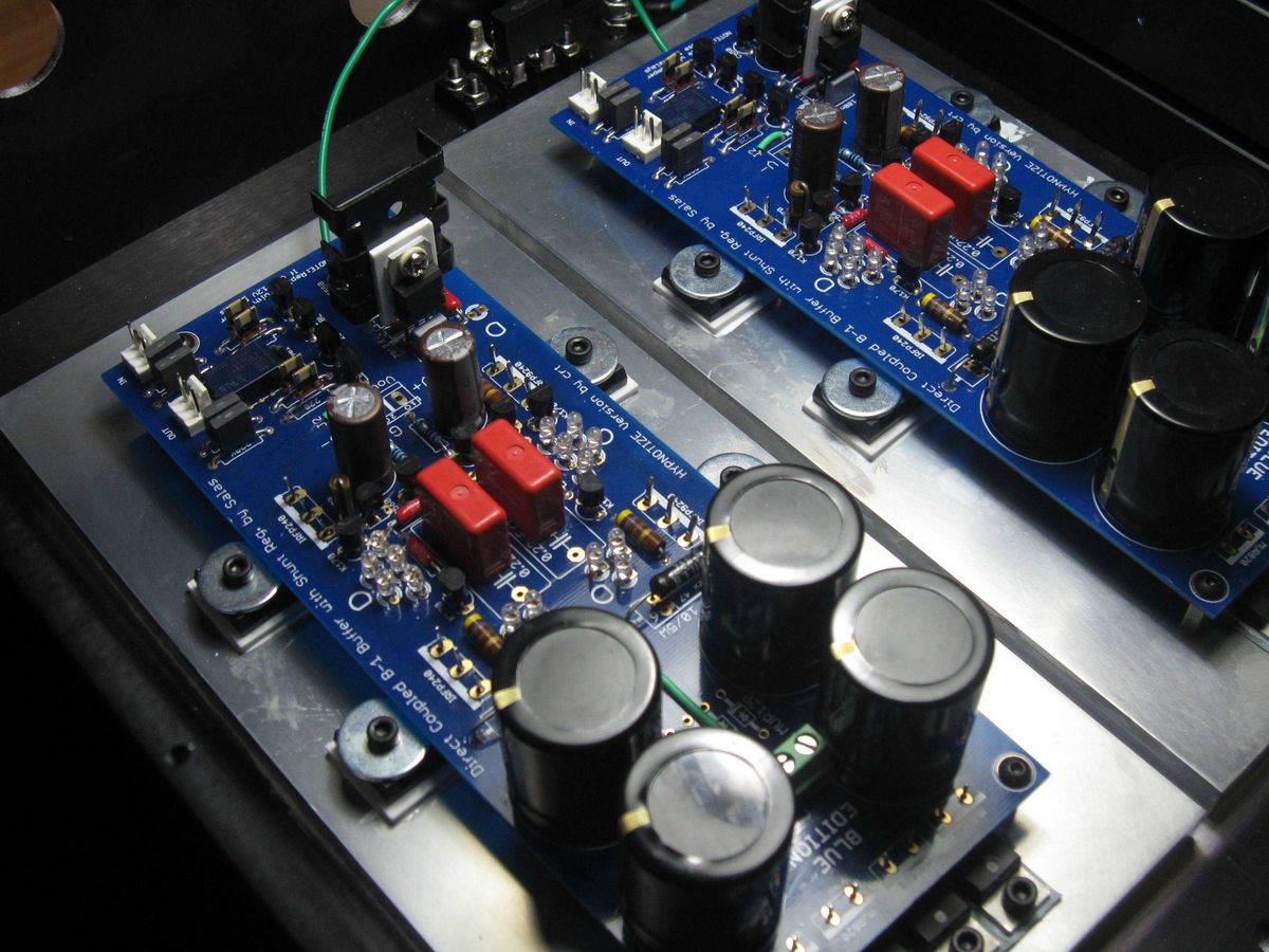

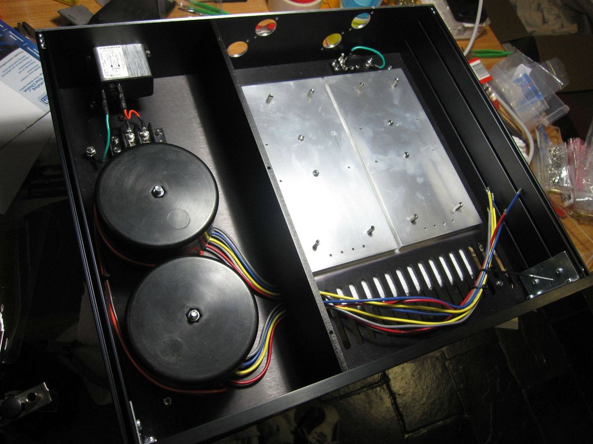

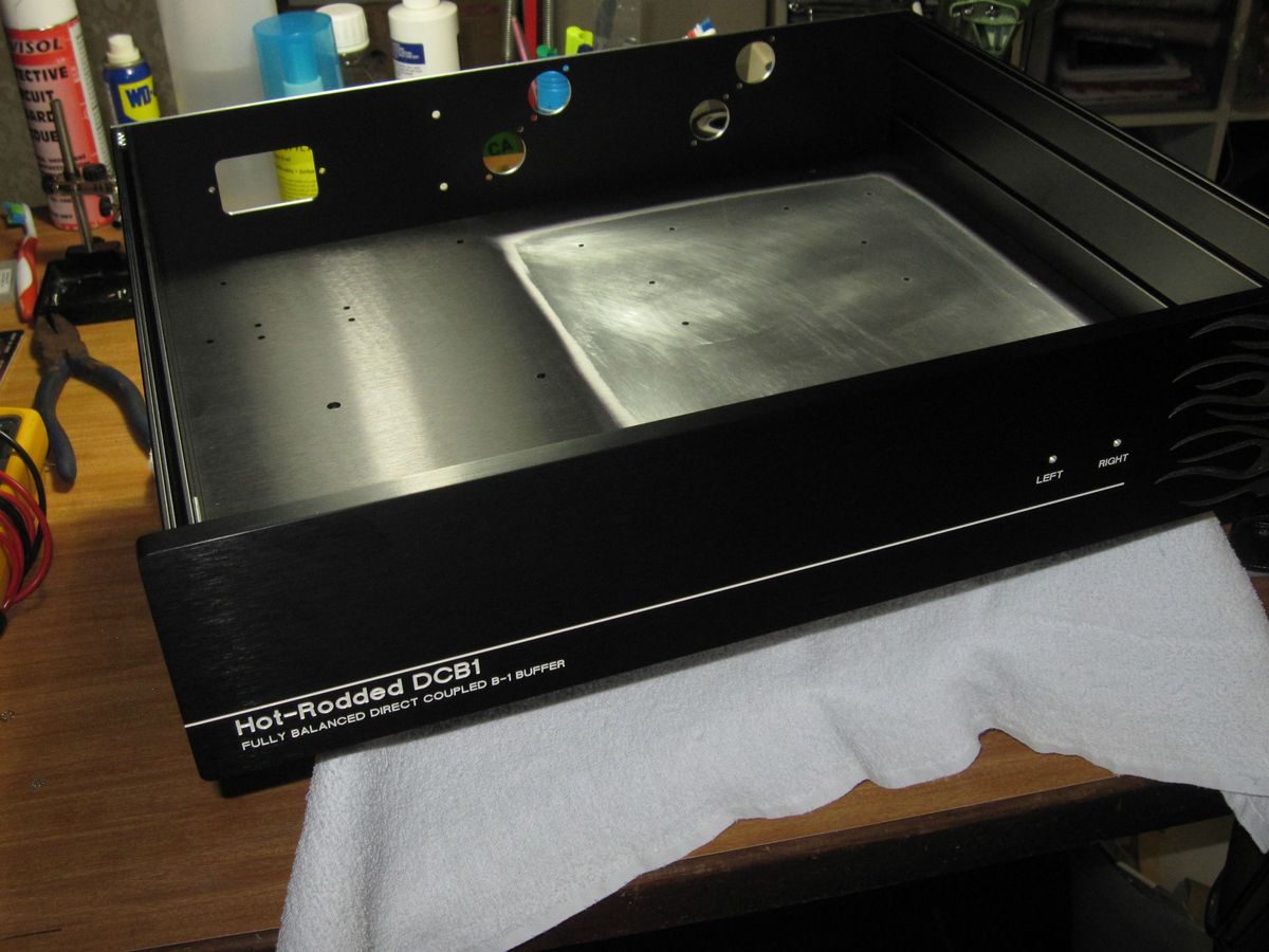

Before i mount my lvl 1 hot rodded dcb1 into the chassis, i was wondering if it would be better to use the bottom of my chassis (bottom alu sheet measures ~ 350mm x 430mm x 4mm thickness) as the heatsink instead of the heatsinks that i'm using right now. I realize with these heatsinks i can only rest my finger there for at most 5 seconds - it is really quite hot.

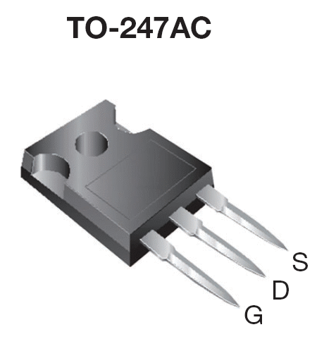

If the Mosfets are already insulated on their metal backs from each sink with thermal pads, no need to insulate again. The screw does not touch the metal part of the Mosfets, they are TO-247 package with a plastic covered mounting ''eye''. Simplest way is to use pads.

Will take enough, but he will know how much is comfortable only in the end. I would not let the plates go more than 45C, because they can be slowly ''frying'' the goods like a pan in the long term. Must spot check plates area under the PCBs with a temp measurement thingy.

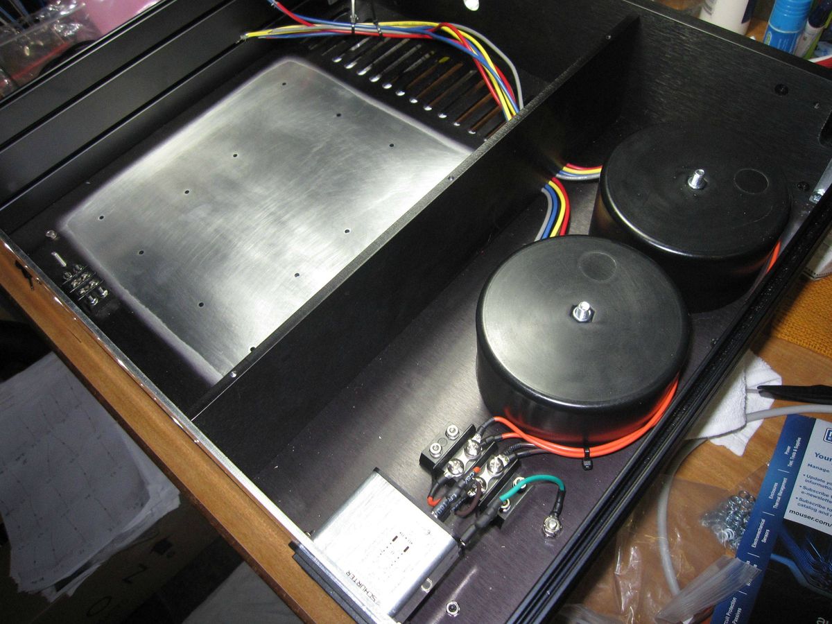

Are those aluminium plates enough for Hot rod?
I’m using 3.3 ohm resistors, aiming for 600mA. :hot:
I was fairly diligent sanding back the base and al plates adding thermal grease between etc, I’m hoping for a good transfer of heat to the large 350 x 435mm base panel.
