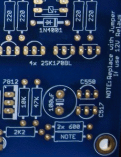

hi all I have a problem with my dc-b1 in that the relay isn't clicking in. I am using a 12v g6h2 relay and measure 12v at the wire jumper. Reg voltages are a stable +11.5 -11v. Are there any other checks I can do?

Then the relay has no trigger signal.
That could be the transistor switch that is not working or some other faulty component.
You need to now measure back through the relay drive circuit to find where the error starts.

Hi, It is 0V
Surely the ''note'' jumper for a 12V relay is installed?
You are referring to the relay circuit ground return link, located elsewhere on the PCB.
The jumper at ''note'' resistor position Is linking the 12V line to the relay.
Thanks for the help guys, turns out it was the BC550. All working fine now thanks. David

both those resistors are in parallel. Only one is needed to supply the relay coil.
I have split those resistors in a MEZ build, one feeds the mute/unmute relay with 15Vdc from a 7815 using 2k as the dropping resistor.
The other feeds the selector relays. I use 1k here, but without the current boost at start up sometimes the relay does not fire. All I do is turn the selector and then the (or any) relay always triggers on re-selection.
In my Hyp build I used one resistor to feed the relays and the other resistor to feed the current boost. Again that was 15Vdc into a resistor fed 12V relay.
