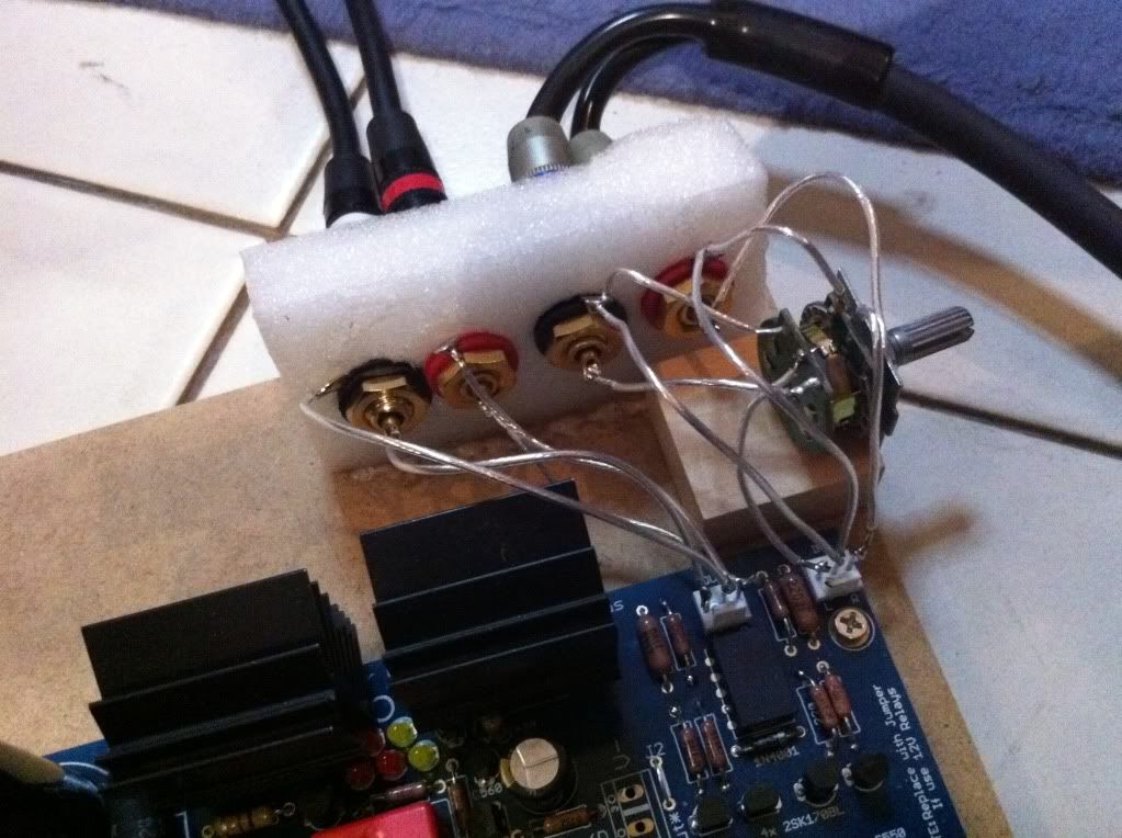

Alright, i got down to checking all the cable joints. They are all fine.I would have been worried if you had said something like 5m to the actives about it may had needed higher value interfacing resistors than 220R not to oscillate on cabling capacitance, but 1.5m is very near to what all people use with DCB1 in home systems.
Both 1 & 2 on the graph ground pin 3 fully. So you had it grounded as your speaker's manual usually expects.
I am suspicious of possible bad joints, the computer's output as a source and what it may give out erratically through a DC preamp as the operating system does stuff, possible peculiarities in the unknown Dynaudio active plate amp, its preamp, filters, on board protection and limiters. As for what it may had happened to it and is lower but still has voice...don't know, from a tripped and stack limiter to burned stuff in a Class D power circuit. Check it with a balanced source with XLR output and XLR ready made cables first.
I changed the source to a CD player. When i tried it yesterday, there was some slight buzz/hiss but nothing major. Today, i shifted the speakers a little and when i turned on the left speaker, there was a huge, huge buzz. Right speaker is silent. I suspect it is because i shifted the left side closer to the TV.
But after some rewiring and shifting of cables, that was settled. Speakers are completely silent only when there is no source hooked up to the dcb1. Once i plug in the source, the noise comes back.
Is it really not possible to run it open case for now without getting *any* hum/buzz at all?
Is anything wrong with my internal wiring? And what should be done about it?

I'm thinking of trying out this alternative rca->xlr cabling arrangement. Any idea how well it'll work? According to the diagram, my cable is wired 'wrongly' although most literature elsewhere states otherwise.. so im not sure who to believe

Thank you, Andrew. As always, your posts are very helpful. Is there any improvement i can make to the internal wiring?
Twisted pairs are missing.
Remember for every flow there must be a return route.
Electrical/electronic circuits are approximately what it says. The electricity flows around in a loop (circular route = circuit) all the way back to the start (the source of the emf).
I've got my heatsinks bent over the sides of my board. I wanted to attached them to the bottom of the chassis, but I guess I'll need to insulate them?
Oh, okay. For the output, i understand the wiring. But i'm a little confused how to do a twisted pair at the vol pot <=> input section and the proper GND-ing scheme at the volume pot.Twisted pairs are missing.
Because i need to connect the GND to two sides (RCA GND and DCB1 IN GND), how should it be done?
1) Each RCA IN's GND connects separately to individual (L and R) attenuator GND, then attenuator GND -> dcb1 GND?
2) Or attenuator GND does not -> DCB1 GND; instead, each RCA GND -> DCB1 GND (so there's two GND wires connected at the DCB1 GND)?
How should the twisted pair be implemented here?
Twisted pair for (RCA IN -> DCB1 IN) + (RCA GND -> attenuator GND)

I tried these two methods and now i don't have the 60hz hum anymore when the source is plugged in without any volume level. But now there's some sort of funny high frequency noise and when i turn the volume up a little, the hum comes back. The higher the volume, the louder the noise
Is it like a whistle? Could be oscillations. Change your 220R series input/output resistors to 470R ones if the symptoms persist. Your now ones are they 220R for sure?
Sounds like a whistle. Yea they are 220R. Will order some 470R to try out and see if it's the problem.Is it like a whistle? Could be oscillations. Change your 220R series input/output resistors to 470R ones if the symptoms persist. Your now ones are they 220R for sure?
When the source is not plugged into the input, the speakers are quite quiet - very very slight high frequency hash. The moment the source is plugged in, that whistle thing starts.
Can i say with certainty that it's not a ground loop problem anymore?
There's also this strange phenomenon: when the left speaker is ON and right speaker is OFF, unplugging the power cord from the right speaker causes a hum in the LEFT, even though the right side is OFF
And sometimes when both speakers are on, and i turn off one side, the other side will make some crackle/pop noise. I'm quite lost as to what to do now. Any help is really appreciated!
Ground loops sound like hum and buzz. Zzzzz with some roar underneath. Whistle can be sign of oscillation between components. About your speakers power chord plugging/unplugging it certainly changes the mains ground route relationship to the common channels ground on the pre. Nothing is certain without expert data, but we try guess so you will not walk alone.

Ah, i was looking around every part of the PCB to make sure i didn't miss out anything. Turns out one of the transformer wire wasn't secured properly to the terminal and it was loose.
The whistle/high frequency hash is gone - but the hum's back.
I've tried every conceivable way of wiring up the GND but i can't just get rid of the hum; the hum gets louder as i turn up the attenuator volume. This is even without any source plugged in.
Is it possible that i overheated any of the parts during soldering? Are the FETs particularly susceptible to overheating? But if that were the case, then wouldn't my measured values of the voltage, offset etc be weird/wrong?
