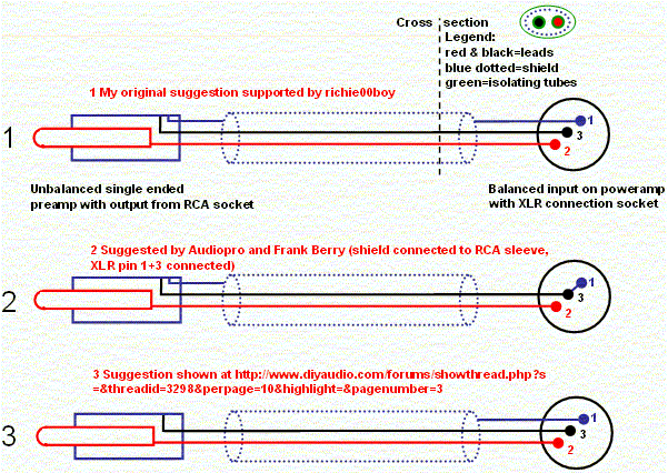

P.S. I read in your speakers manual that pin 3 of its XLR input is normally expected grounded when unbalanced to balanced is used. Is it? Did you use the same wring when checked with your other pre and the sound was still low? Says it has several limiting circuits for overload. Are their power plate sinks just warm when its low volume with the other pre now?

Hmm i guess the pin 3 works that way? I have the rca->xlr wired in http://www.diyaudio.com/forums/atta...able-where-connect-sleeve-rca-xlr_cablex3.gifthis way (#2):

Both 1 & 2 on the graph ground pin 3 fully. So you had it grounded as your speaker's manual usually expects.
