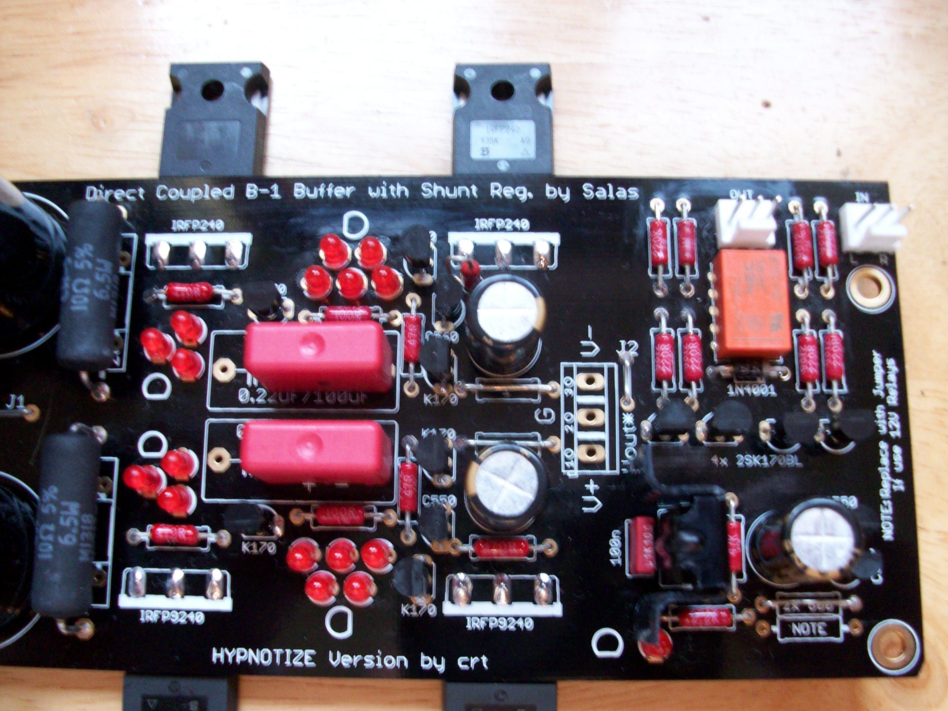

Thanks ghiglie. I am thinking of not having any heatsink at all. The position of the IRFP fets on the boards looks like it weren't design with heatsink in mind. Thanks.

Even not hodrodding, I think a little heatsink is needed - even if it's just a sheet of metal like this (from this thread):

Insert the mosfets from underneath the pcb with bent legs and use the chassis base as a heatsink. I did this with my build and the base gets slightly warm.
Hello, for led orientation do I need to follow the silkscreen (flat side) or the rectangular pad for anode ?
There are different for the group of 5 leds.
