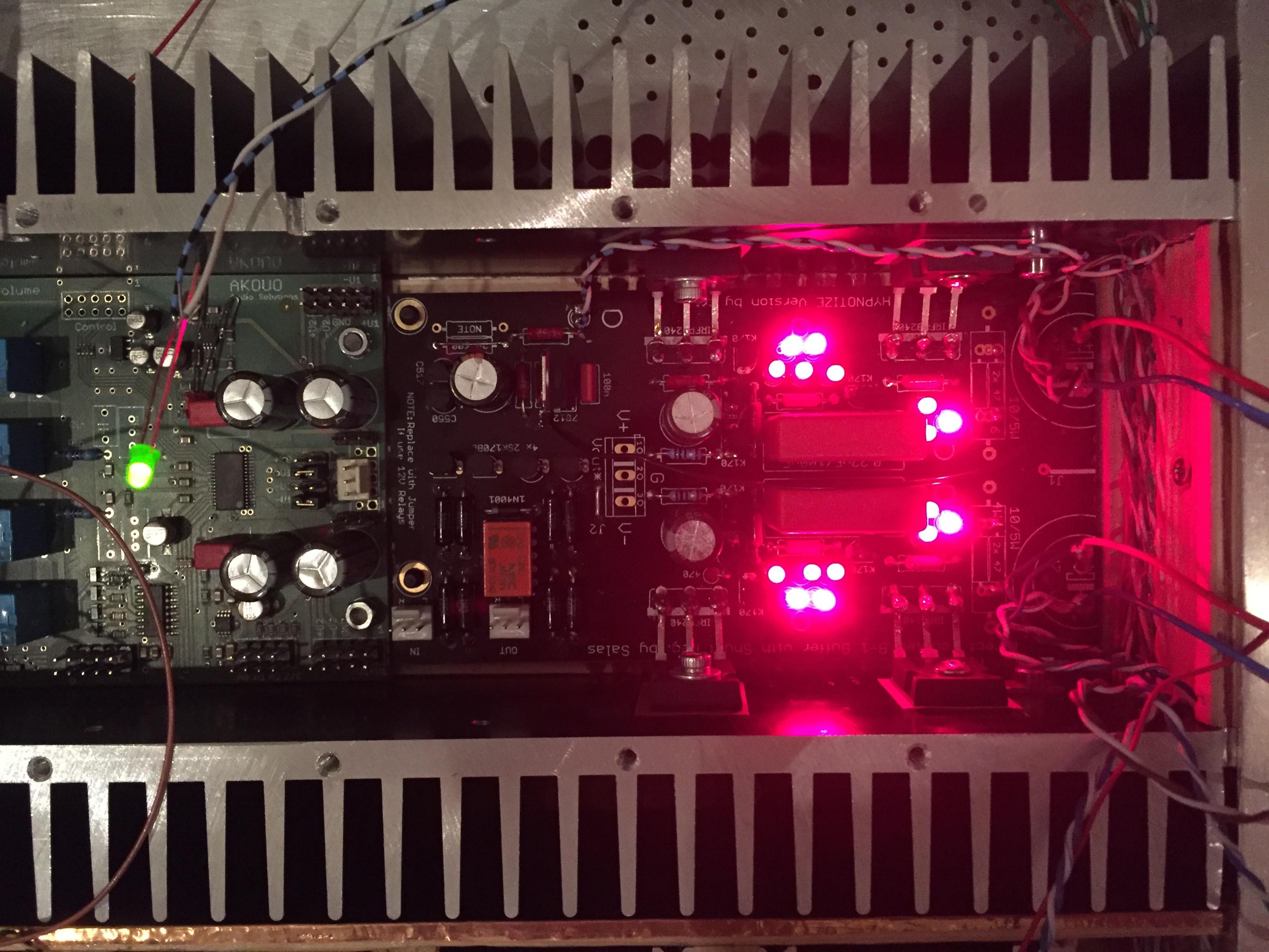

I know now. A lot of backbreaking fiddleling. 228 mA negative and 278 mA positive with 5R6 resistors. Dancing on around half a mV negative offset on both left and right under warmup.
I also had to throw in a wire between PSU cap zero and delay section since I noticed I had sawed off its return feed to get room for the board.
Yes. 9,5ish plus and minus with +/- 21 V in and above currents, thats ok? Temp rise on sinks is 10 degrees after a couple of hours. Top lid is going to help cooling to. I guess I can step up the current further, what do you think?
Just match the negative current to the higher positive with some parallelism to the neg 5R6 and you are dude

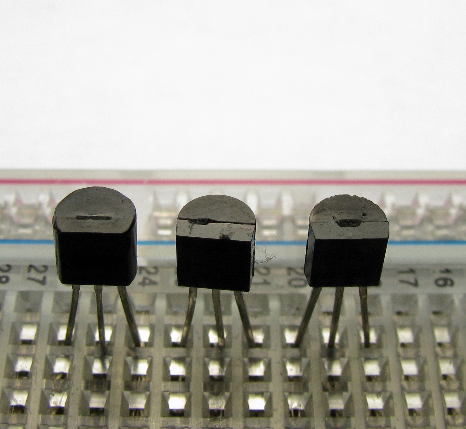

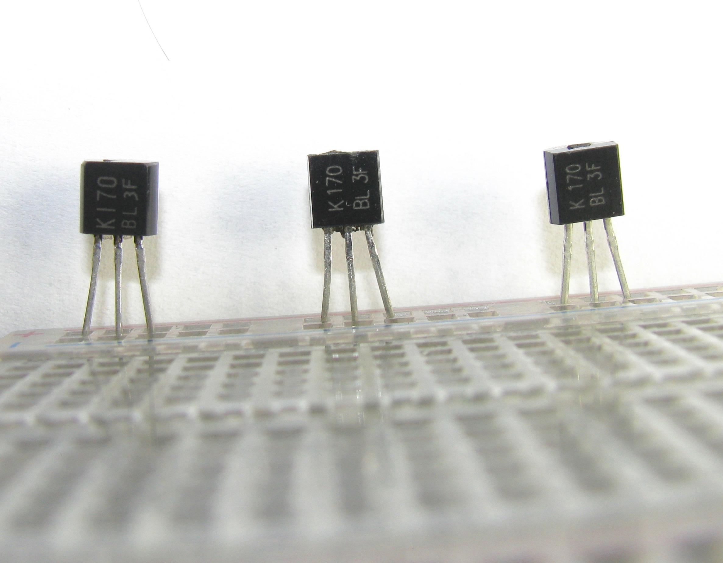

May I have some confirmation if the K170 on the right is genuine, or not? The one on the left is genuine (from tea-bag), the middle is confirmed fake by Salas. IDss is within a reasonable range 8-11ma out of 10 tested. Vgs is usually around -.8 out of the 10 i tested.
The font, crease at the top, and measurements make me question it. Im not sure if the package was ever altered during its lifetime of the product. cant hurt to ask, right?

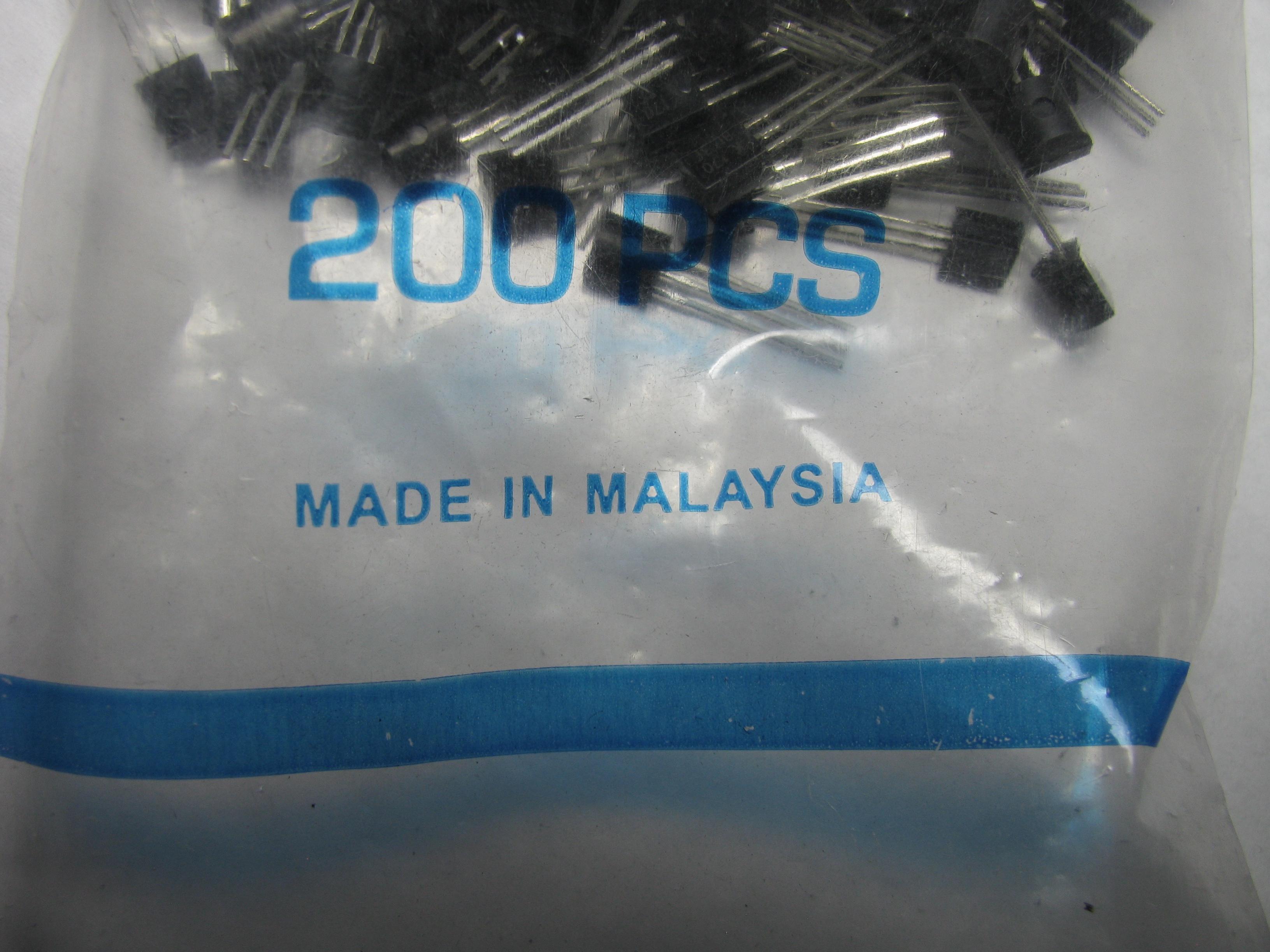

I also have a pic of the bulk packaging.

The one on the right looks suspicious to me. Notice how the "3" doesn't look the same as the original.
Did you get them from some seller in China?
I learned a while back to only buy these from reliable sources.
Jim's Audio was the only Asian seller I found that sold authentic K170/J74s.

I did buy from a reliable seller. I put two small orders of 20 in, those two orders came back with genuine fets. That's when I tried for the bigger order. The company has been responsive, I just want to be 100% sure.
I tested 10 of the ones on the right. Idss is between 8-11ma, Vgs is around -.8mv. I have tested the pinch off voltage, I'll do that tonight.

Visually the right hand one in the pictures does not instill confidence. Print, legs, molding, unfamiliar.
