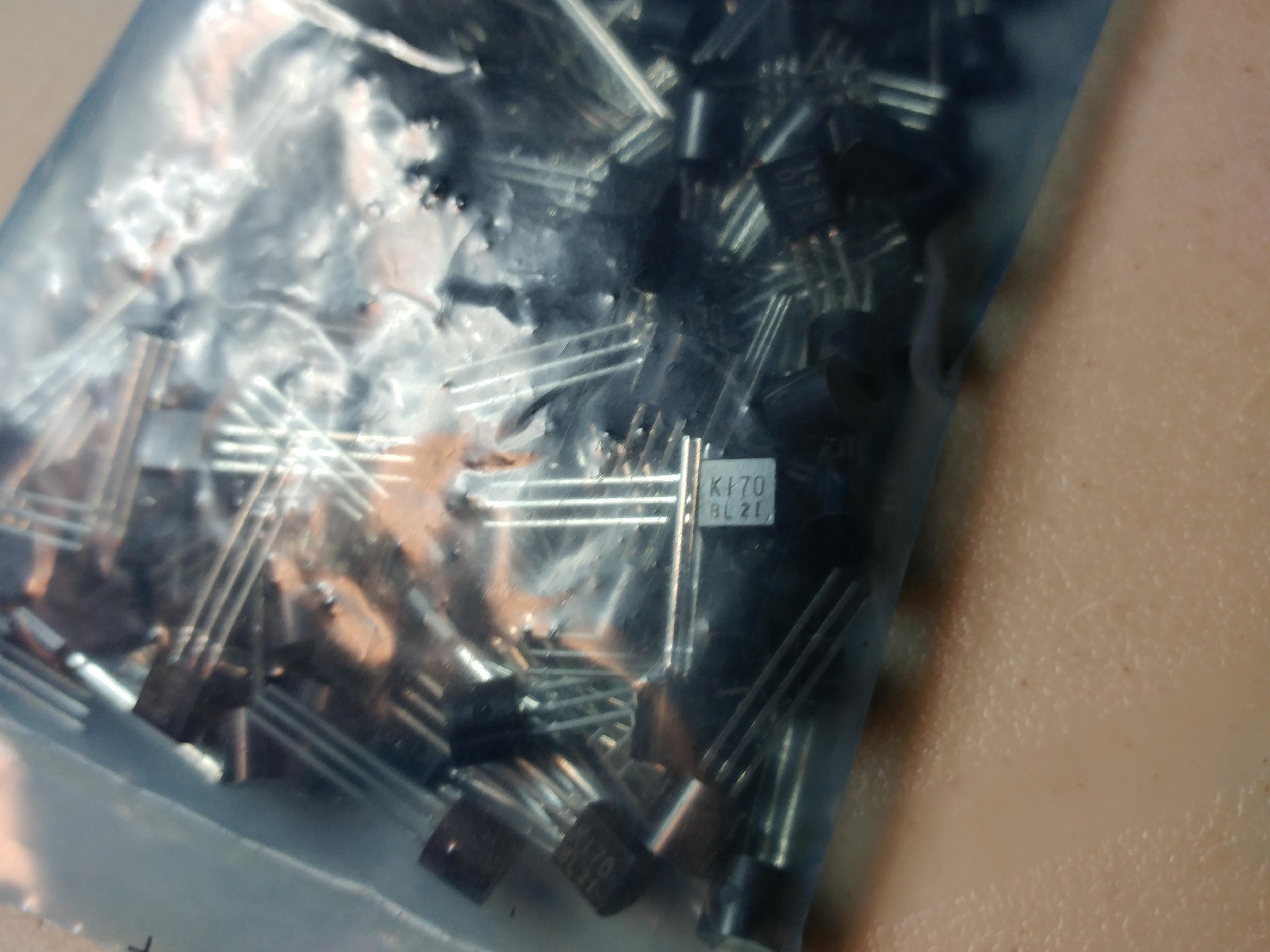

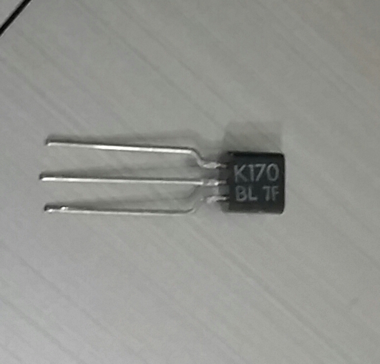

This is my last offer by the supplier before I get a refund. They sent me this photo, has anyone seen this batch number before? It's not a great photo, but it's worth a shot. They look legit. I see the 'BL' have some space between the the two letters. All of my legit 170s have the space. All of my fakes that I came across the two letters are touching, on every single one.

Those last ones look rather much better. But its only looks and there is some plastic bag fog for seeing well their backs, tops, and legs details.
