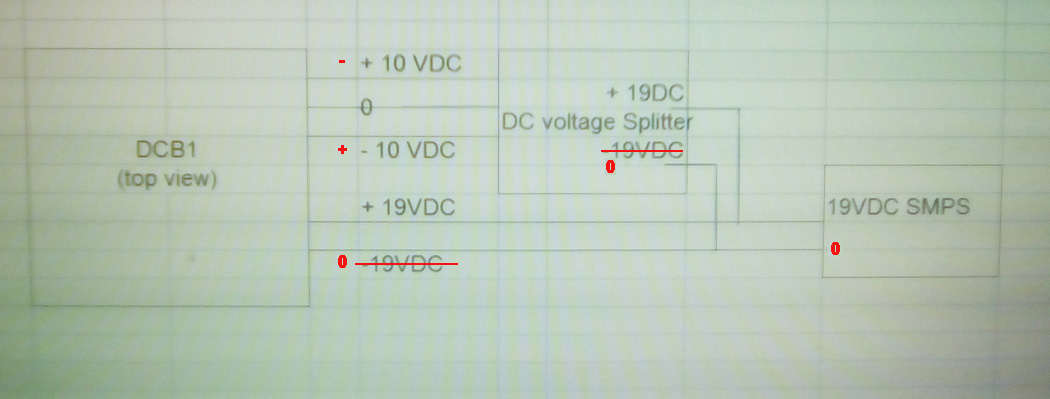

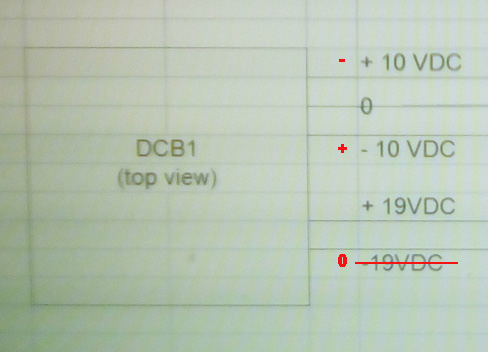

Keeping with the orientation in your photo the rail voltages pins to the right should be connected like in the annotated attachment. Someone obviously hacked off the shunt PSU section either to use it standalone for powering a Soekris etc. or could not fit the full board with sinks in an integrated build and split it or had another supply fitted already or had some other practical reason like that.
It can't be a DCB1.Hi I just managed to pick a finished DCB1 blue board nicely soldered up with 4 relay inputs. however the normally supplied power supply board has been removed (don't know why & didn't realize until after the purchase) Can I connect this little unit up to a Split rail voltage splitter (with adjustable voltages so I can achieve +/- 10 VDC) and feed the voltage splitter and second 18VDC requirement from a 19 VDC Laptop SMPS.
As per the attached photo as there is no indication of polarity on the board is my voltage assumptions on the attached sketch correct.😕 Cheers 😀

Hi Salas, Thanks for the correction info. Will the buffer work with this type of power configuration Cheers😀
It will rather work like this but not sure of quality or hum
