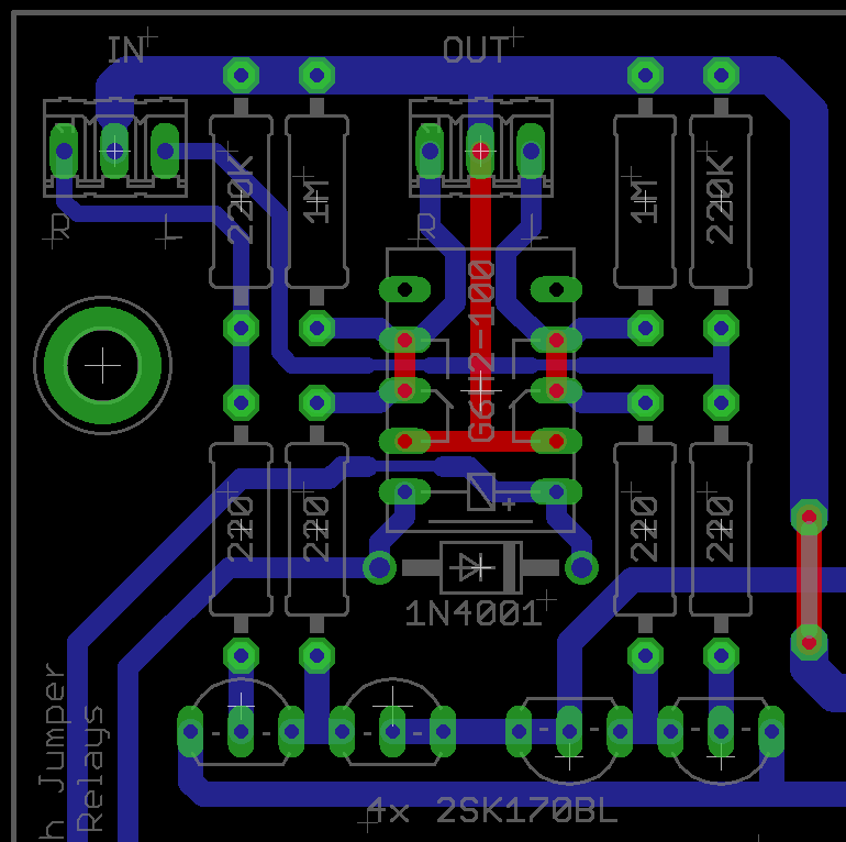

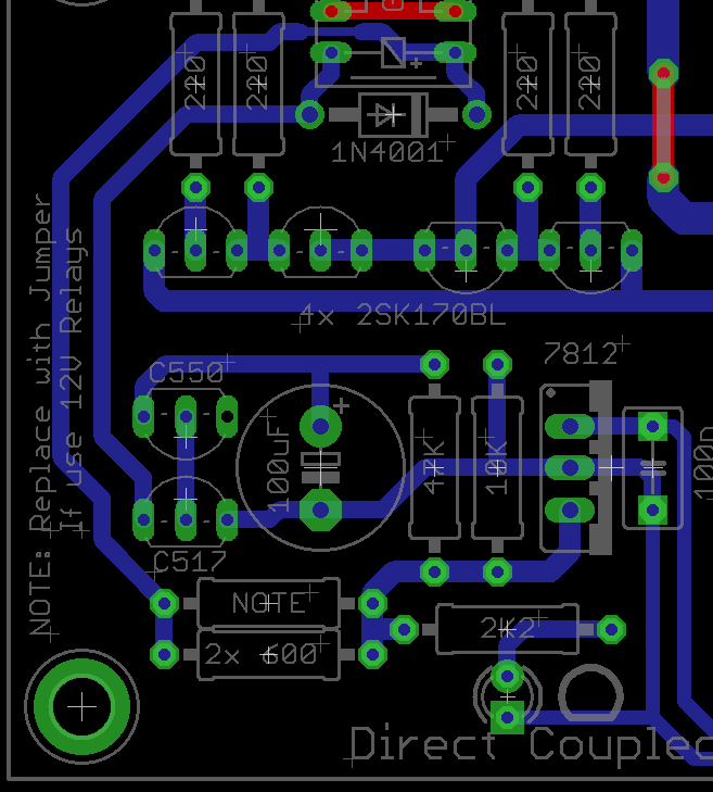

I have changed to BC517/BC550 but i dont have good news. First time didn't worked even the voltage acress relay coil increased from 0.8v to 1.4v. I shorted the 2x600R position and the relay clicked and it clicks on and of as i'm powering or disconneting power of DCB1 but there is no delay. I have installed anyway a 10R resistor in position of 2x600R and i have 4.4V acress relay coil. This circuit is really strange for me.

Good news, now is working and the problem was the orientation of the transistors wich in the first page of this thread is in the oposite way.
Thank you very much Salas for your support.
In this last picture i see also the GND is connected to the relay wich was not in the other pictures seen on the thread.
There is always some explanation. Nice you got it in order. That one with the double sided pcb with upper side red vias is the long time now standard one with shorting to ground relay outputs at rest position.

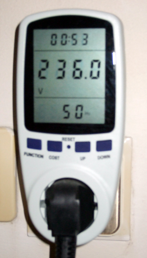

If there is big mains play indeed in his grid, what you say Andrew can give significant dissipation differences no doubt. He must use his DMM on his mains also then and keep notes. Which I don't generally recommend if with cheap non trusted for input protection DMM. I have this thingy on my a/v rig by the way. I see only about 1-2V differences in my mains over the week. Also shows Hz, power consumption, so I can see each item's Watt draw and all together, I can give it kWh price and it can tell me the rig's energy cost over a period etc. And its always 50Hz spot on, good for my ac TT motor.
There is a power hub building within 500m and a step-down/distribution transformer at the end of my road.

Salas, you must have a miracle worker controlling your mains electricity supply.
Worker must have gone to watch football, I saw +/-2.5VAC tolerance this weekend.🙂

Man! Here's in Montreal we have extremely stable power. Always have ~120Vac... Pretty good!
