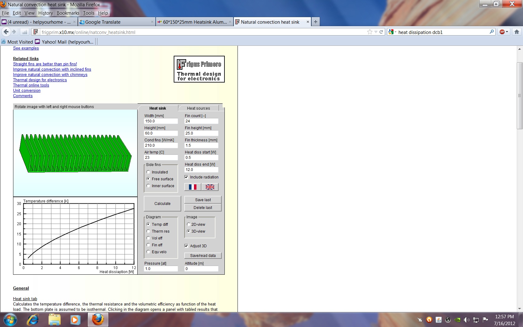

I found a wonderful heatsink calculator for us laypersons. I don't speak engineerese.
Natural convection heat sink
I graphed the HS i referred to earlier for both 600mA (12W) and 200mA (4W)
You're going to need some BIG sinks for 600mA!
I guess I'll be running the VW Golf turbo (200mA) 10 Ohm version with my ordered HeatSinks.
This is without forced air circulation just convection cooling.
Ron
🙂That calculator is smarter than me. I could not get it to reproduce the values for the farnell heatsink, so I'm not using it. It did show a 25 degree rise over ambient for the farnell sink though. Which is fine.

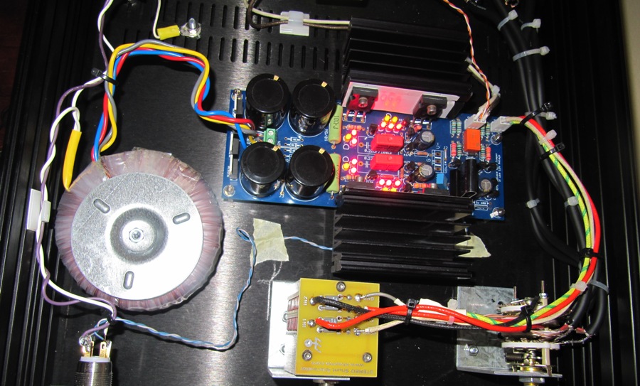

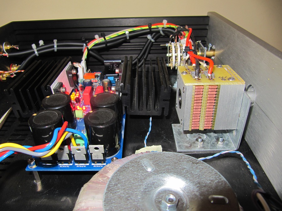

another dcb1 is ready 🙂 ... (this one is for my brother) ...
measured :
1,82/1,98
9,68/9,71
0,3/0,6
once again .....
Salas
🙂 How many did you score by now?
How much worse is orienting the fins horizontally instead of vertically? I'm not talking about the above photos, just a different way to do it.
can't tell, but they are enough for this hotrod version..
I have mine with the same orientation almost a year now with no problems ...
model is : fischer sk68 sa 75

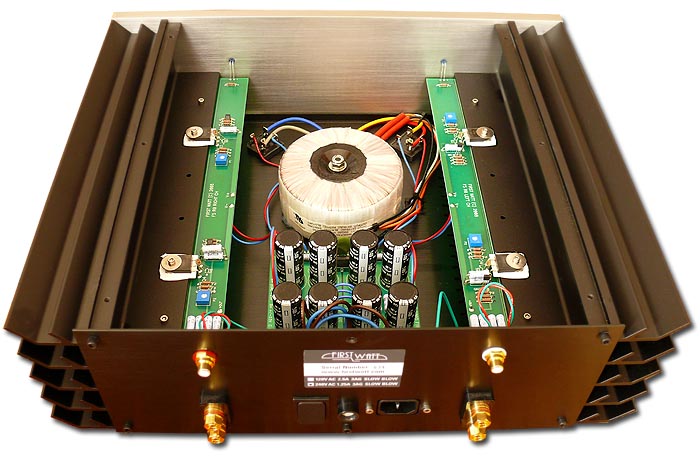

Now take Papa's F5 with the angled fins and that's a different story altogether.
