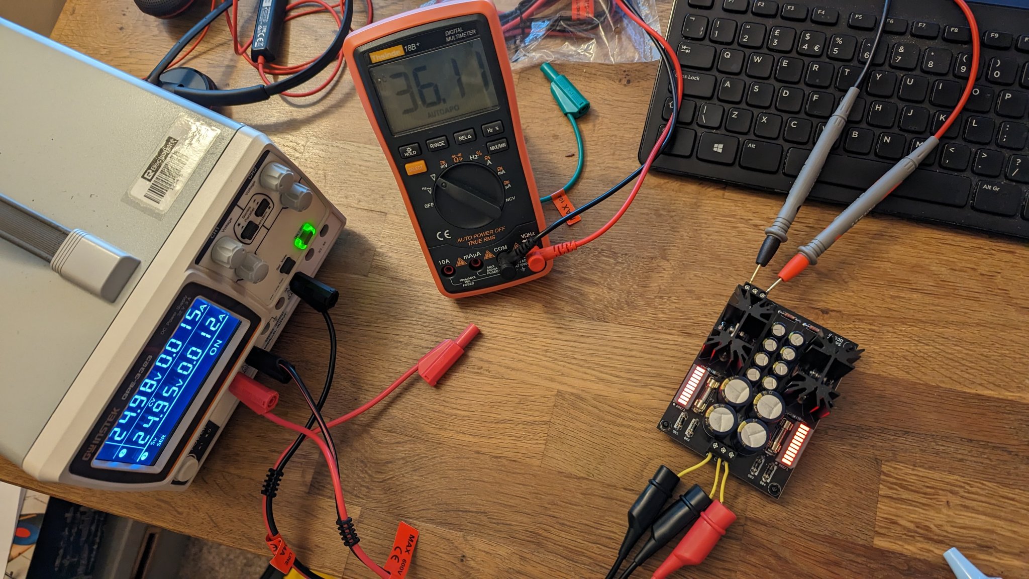

I have dual rail bench power supply. Would like to test each psu in isolation. Can you please advise how to connect it?
Thanks, and sorry for asking such a noob question🙂

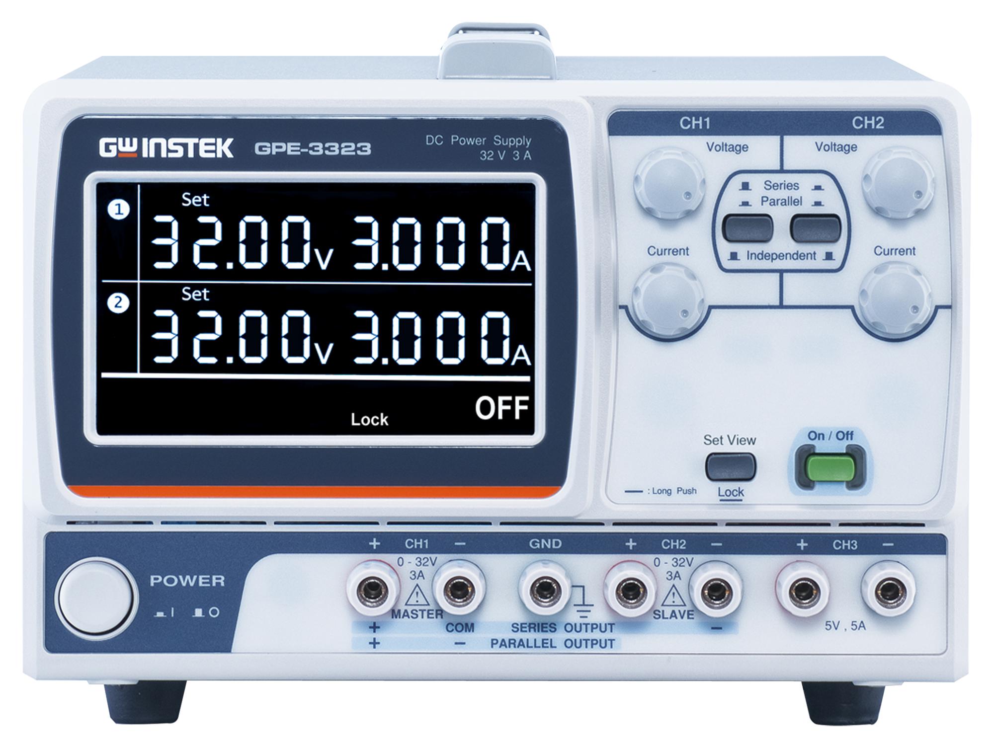

To create symmetrical voltage from bench PSU you select series mode. The master channel settings are mirrored. The user's manual explains which output posts to connect as +/- and midpoint.
I am not sure on what exactly you want to test though. Please elaborate.
Thanks. Just power up power supplies first, then connect everything but use the current limiting bench psu instead of transformers.
Alright. That's a valid way to test PSUs when without transformers. AC rectification section is being skipped. You should connect the incoming DC at suitable points after the bridge diodes.
When having transformers the simplest current limiting device is a good old dim bulb tester between them and the mains.
Thanks Salas. I am aware about the dim bulb option. Happened to have a bench psu to safely power up my amp build as well as dcg3. Still need to learn how to use it properly 🤪
No. You should skip the left and right AC connector points directly to the fuses which are located after the bridge diodes because its DC you feed.
Hi Salas, sorry to interrupt, so its ok to feed DC to the fuse without first taking out the bridge diode?
Yes that is a right way. 35.25V/2=17.6V per rail which is more likely. Check symmetry between + common and - common at the output. It should be near but not dead on symmetrical.
By symmetry you mean comparison between V output of two psu's? One is 36 dead on, another is 35.2
Will watch each board until voltage settles. So far I have approx .86 v discrepancy with 4.3 mA across rY. This translates into 200 R ?
