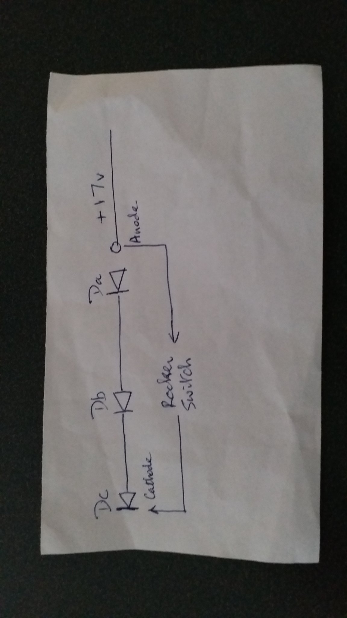

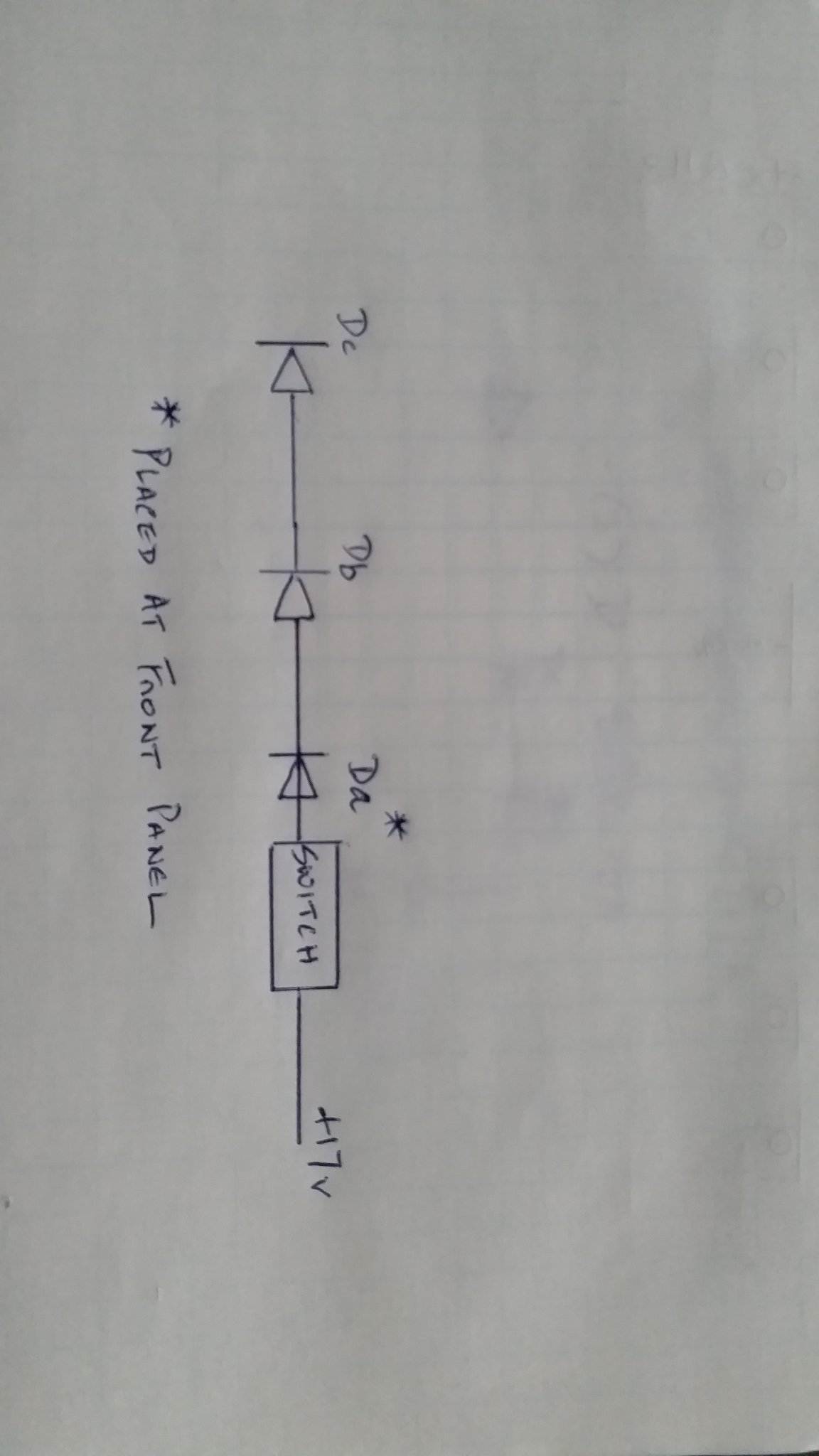

Based on BOM & previous posting :Dc Db Da LEDS drop the rail voltage to 12V relay safe working range territory. One of them can be actually brought to the front panel as "ready" sign because they light up only when the relay clicks. You could introduce a switch in the three LEDs chain cutting power to the relay using it as a mute function control. Post #5654/Page283.
Can you confirm the attached drawing. By doing this, I am cutting power to the Mosfet, yes? Thanks.
No don't do that. Solder two wires in the board pads instead of populating one of those LEDs. Bring the anode pad wire to a single pole mini toggle switch installed at the panel. In series to it connect a panel LED's anode. Solder the other wire to its cathode.
In that way when the switch is on the delay circuit is online and the panel LED lights up after a few seconds delay at power on. Indicating when signal output is ready.
When the switch is off the delay circuit goes offline and the signal output disengages. Its essentially a mute position. Signal output means both line and headphones.

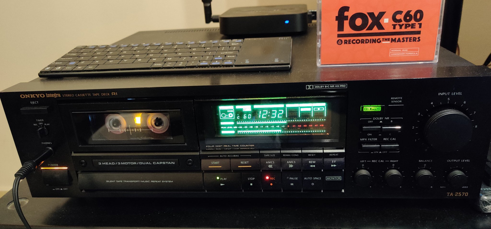

I would like to have a tape loop on my DCG3, what’s the most straightforward way to do this -
To add tape loop you need a monitor input switch. That avoids signal loopback chaos when monitoring with a three head machine.
Meaning a further input to a switch choosing between the I-Select's output and that input. From that switch you route to the volume pot. Also needing a REC out tap from the I-select's output before that monitor switch. You set the I-Select to what input you want to record from. You use the monitor input for listening to the real time tape recording or for listening to tapes replay in general.

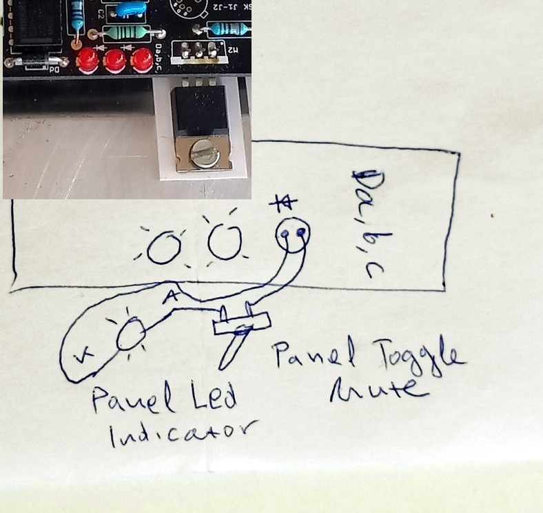

Hi Salas
apologize in advance, I need more/precise instructions as I am new to this.
"Solder two wires in the board pads" where on the DCG3 board?
"Bring the anode pad wire to a single pole mini rocker switch installed at the panel. In series to it connect a panel LED's anode. Solder the other wire to its cathode." You mean like the attached drawing. I am sure that my interpretation is wrong.
Reactions: Siberia
Got it Salas. Based on your drawing, you remove Da LED & placed it on the front panel. The 2 wires are from the Da holes on the board. Ok, thanks for clearing that up. Do all red LED have the same voltage drop as I might need to buy a new one. BTW I just received the pf5102 from Tea and I shall work on my bad DCSTB later this week. Will keep you posted.
Hmm, might be simpler to buy a pre amp with a tape loop and swap it in place of DCG3 when I want to record something. Has anyone installed a tape look in their DCG3?
