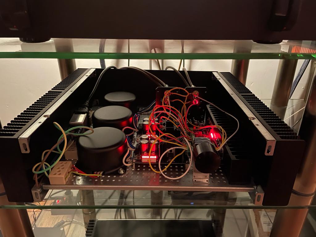

Headphones output is essentially the same output point with line output except a buffer resistor is between them. Both points located after the output signal relay.Even though for whatever reason the Headphone is still muted, but I just need a break and barely ever use HP, so that’s for another time!
In case the HP output was shorted there would be no line output too.
The HP output in your photos looks recessed enough. Maybe the jack doesn't go in properly deep.

I took a deep breath today and looked into my DCG3 again.
This was (yet another) my DOH!-moment.
I used a shorting HP-Jack (as it did fit better than the classic one laying around), and yes, you guessed right. No wonder there was no music... Connected it with traumwandlerischer Sicherheit on the wrong side even though, when I decided to use this part, I really took care not to do that.
After a little solder-session, I got it all!

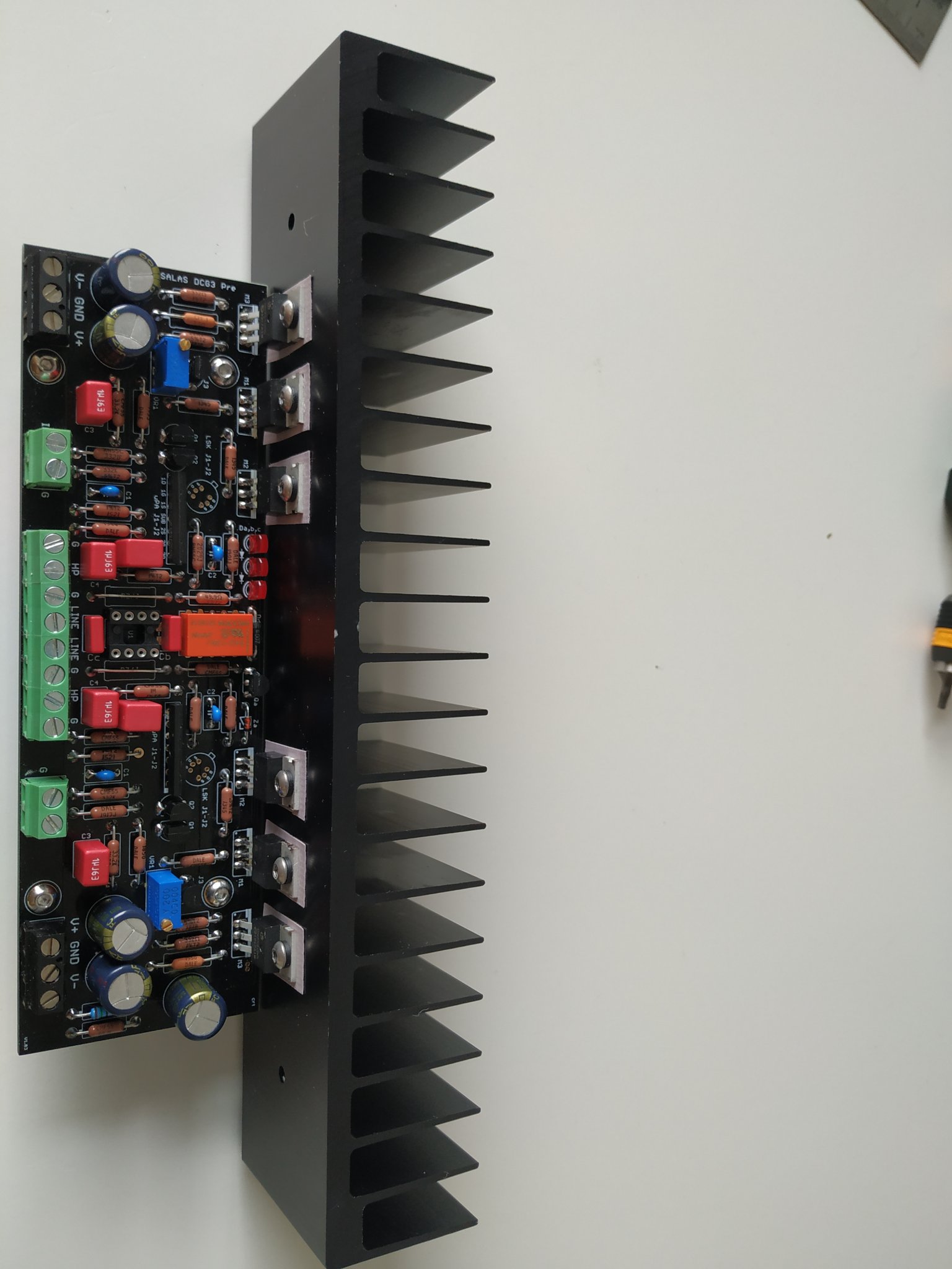

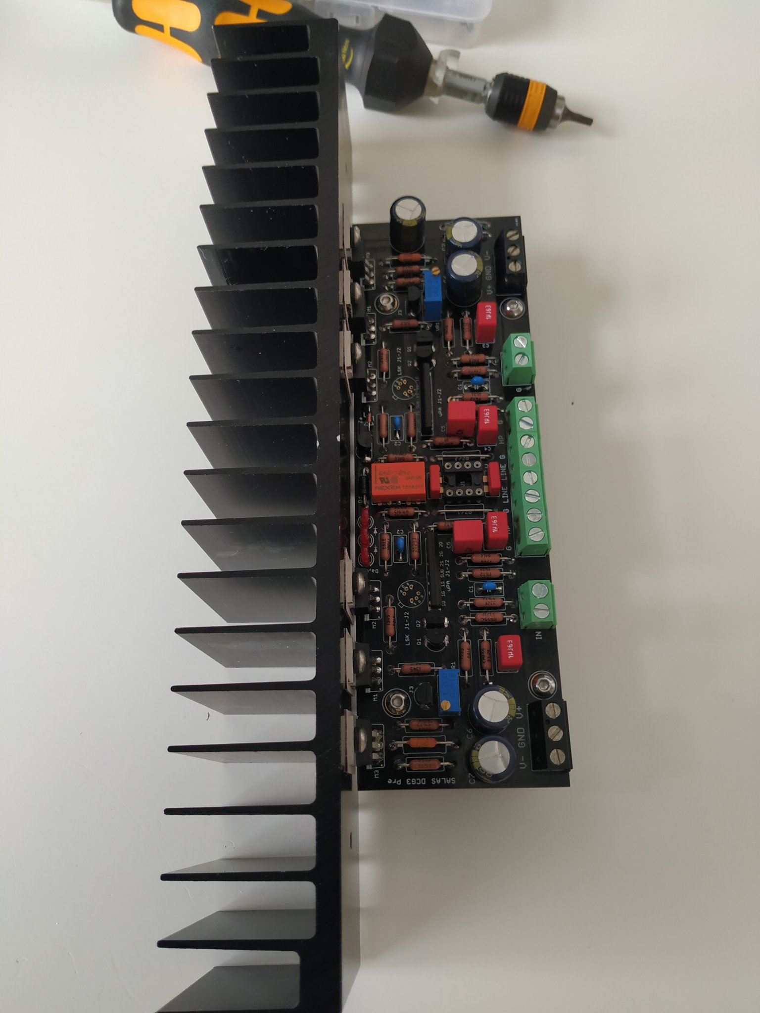

Given enough ventilation, I'd say you're good.
I first had a smaller but fatter heatsink, and replaced it with a just as fat aluminium angle (60/60 x10), ventilation is here although not ideal.
The Mosfets warm up below 30° above room-temperature... (with "standard" gain as in the build-guide)
Should be enough by the looks of itI've got a heatsink I don't know the specs of. Looking at the pictures, should the heat dissipation be okay? Or do I need a larger one?

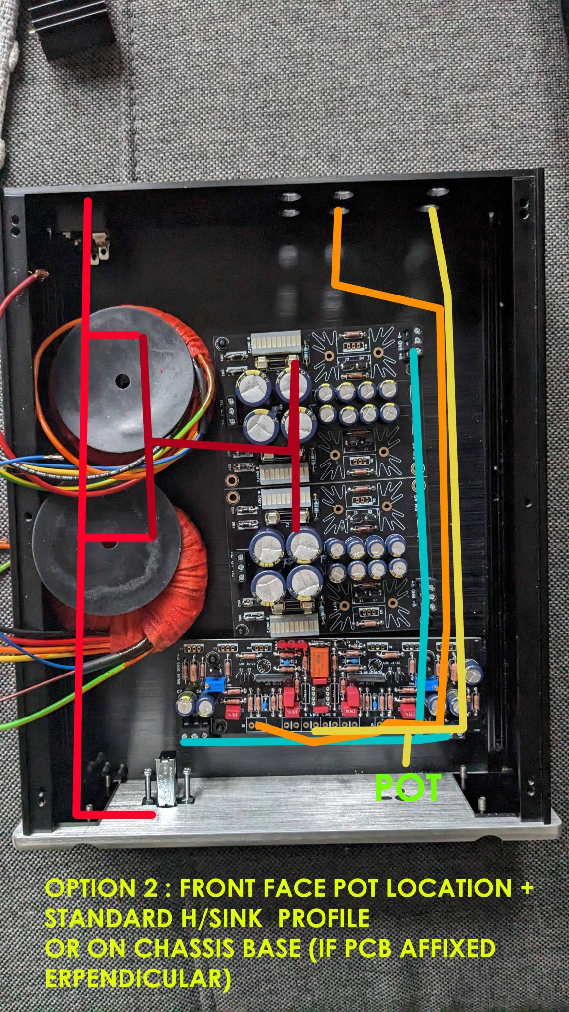

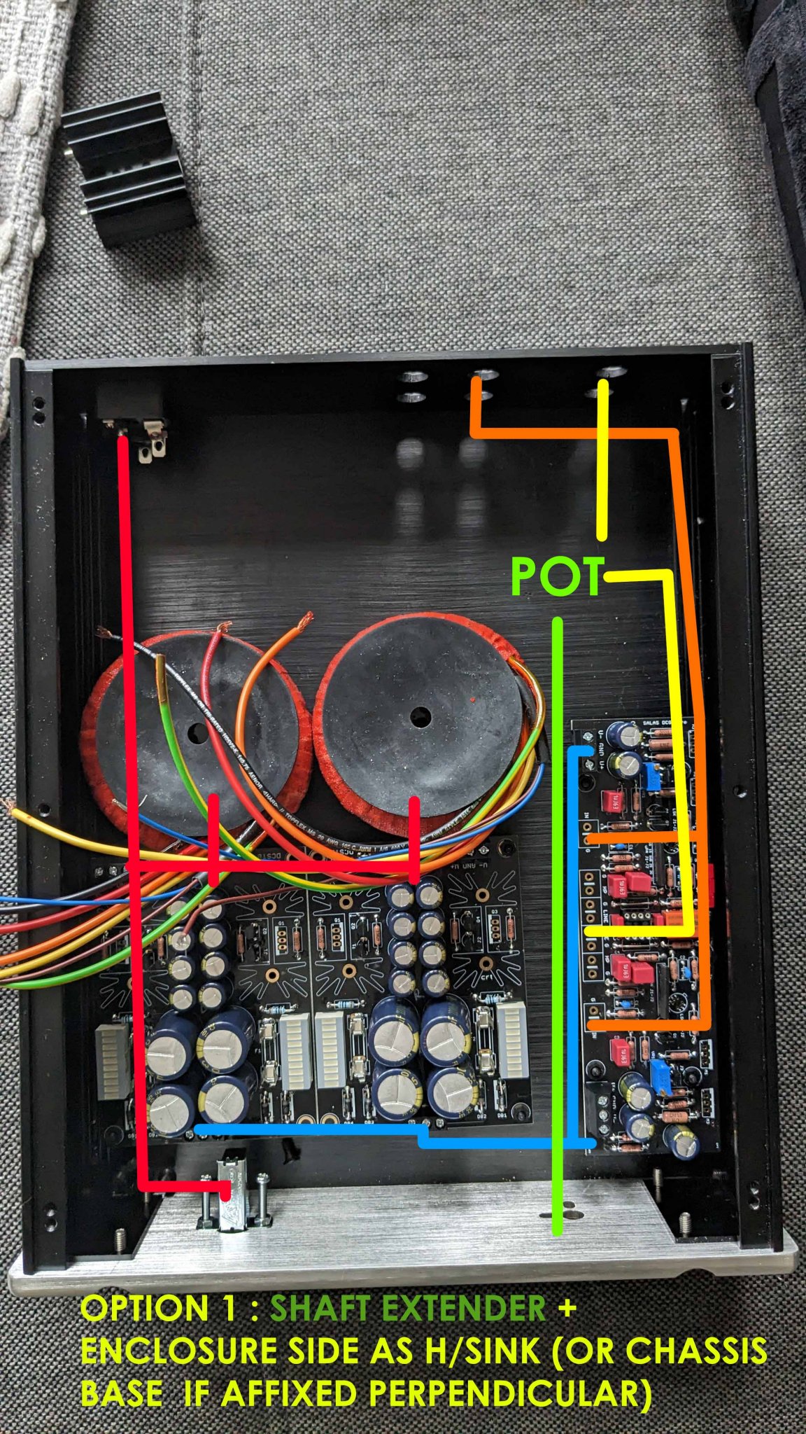

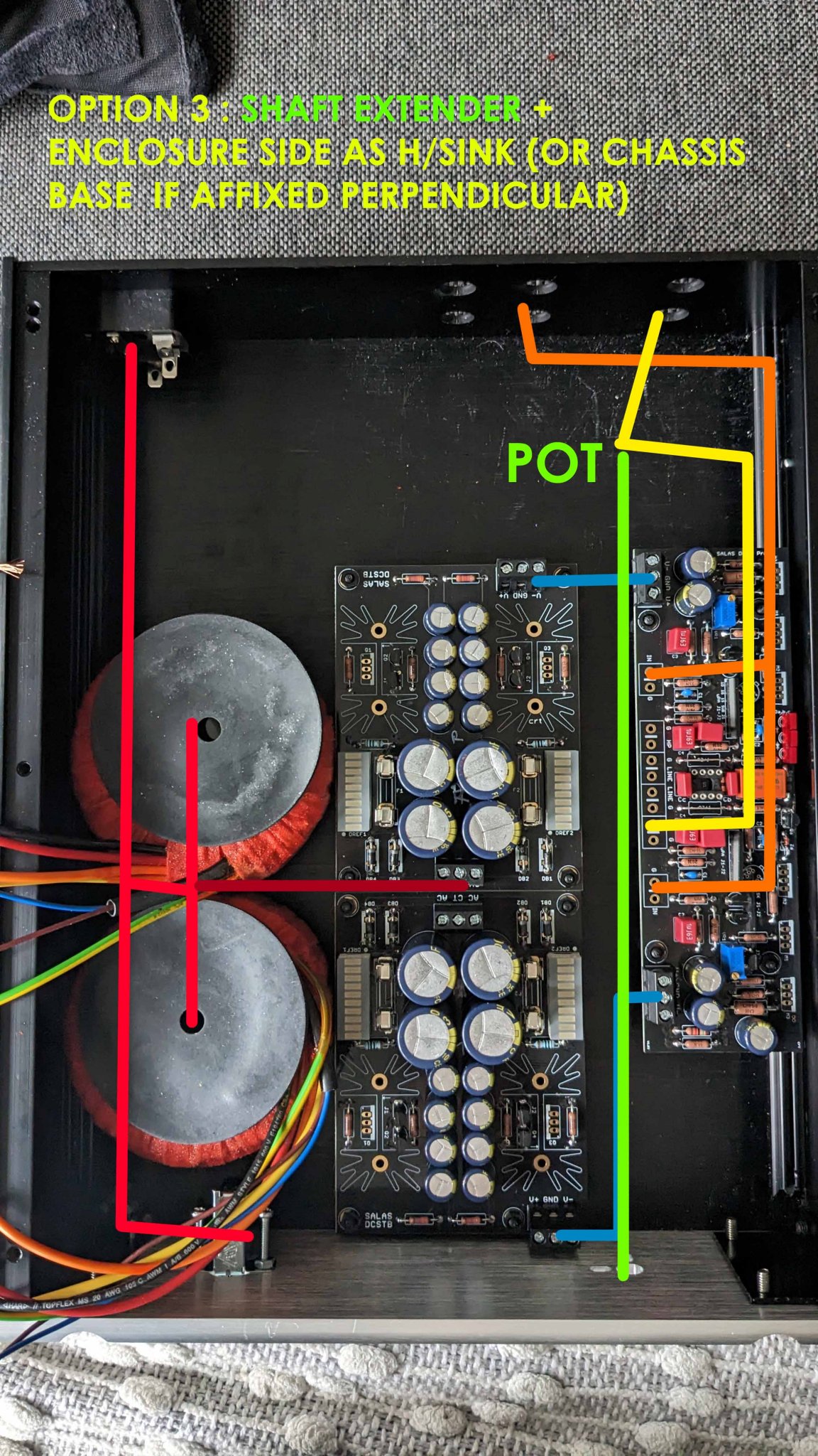

I have a question. I have an enclosure which I d like to reuse. Several arrangement options are possible (mages attached). I haven't optimised the loop area yet, just preliminary thinking.
I use 50va 2x15v secondaries transformers.
Can I use the enclosure as a heatsink if it is made of 3mm sheeted aluminium?
And of 3 options which one is better?
In theory, I can order a separate enclosure for the power supply or just a larger one to keep all in one.
TIA

Personally, I would go for option 3 as the transformers are further away from the preamp section.
I will second Freebee's suggestion for option 3. While playing with layout options I found the DCG3 board is susceptable to hum pickup from the toroids if they are in close proximity. Is that a 1U chassis? My experience with the 1U x 280mm Galaxy chassis was that the side rail was an adequate heatsink for 100mA bias. Warm to the touch, but within acceptable temperature rise for the FETs.
It is an enclosure from Ali, 3mm aluminium throughout except the front face. 60mm headroom.
I think I will use an aluminium angle as a heatsink, bonded to the floor or side + thermal grease and screws.
