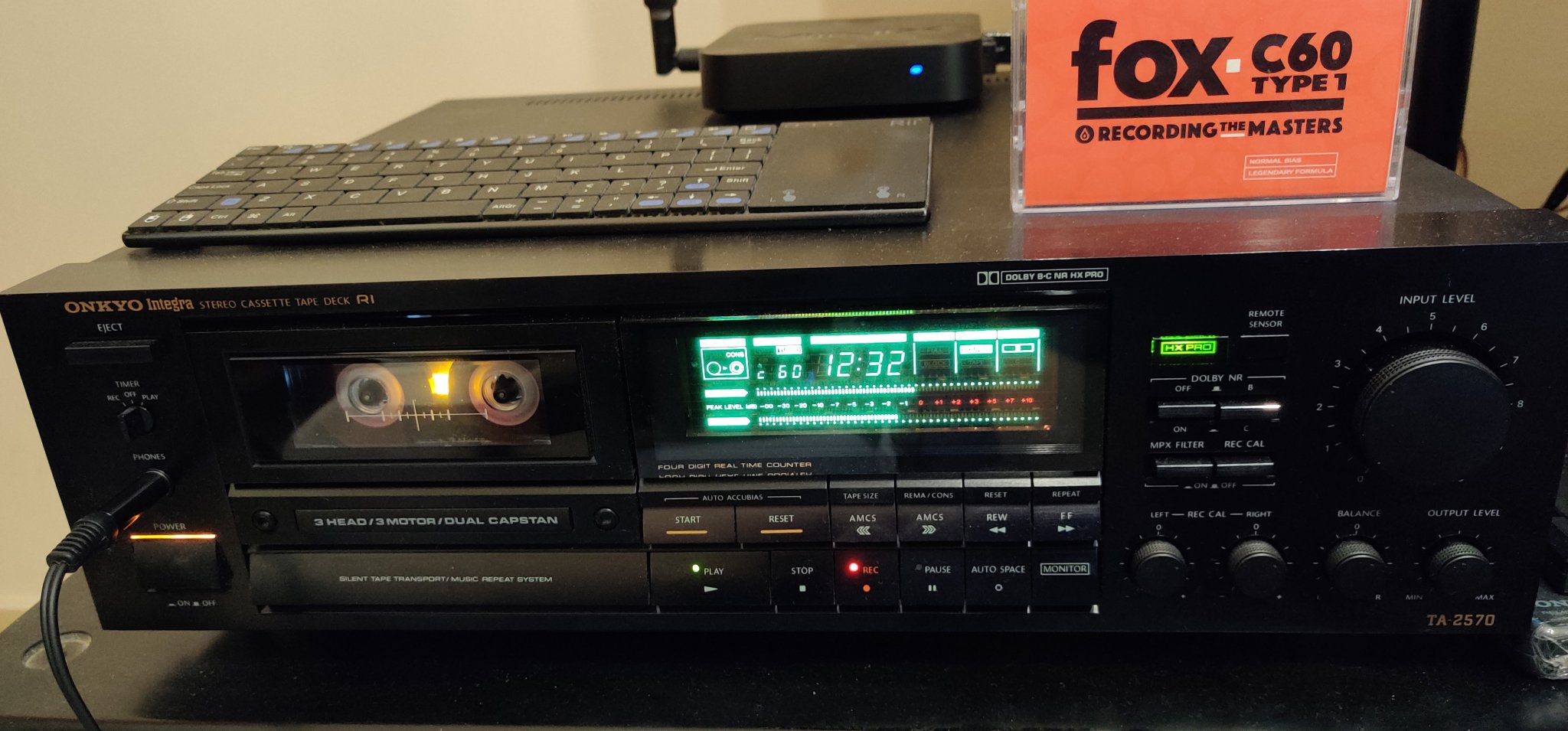

Hi Salas,where you buying the belts?I like decks. I fully serviced and use a three head ONKYO myself. I connected the DAC's extra outputs as REC to the deck.

I used a PRB FRW9.7 main belt in the ONKYO. From few NOS left in a small USA store. For back-tension square section small belt I used one from Thakker Germany. I had the set from them but I replaced their main belt and kept it as a spare because the PRB worked smoother measuring better wow & flutter.
