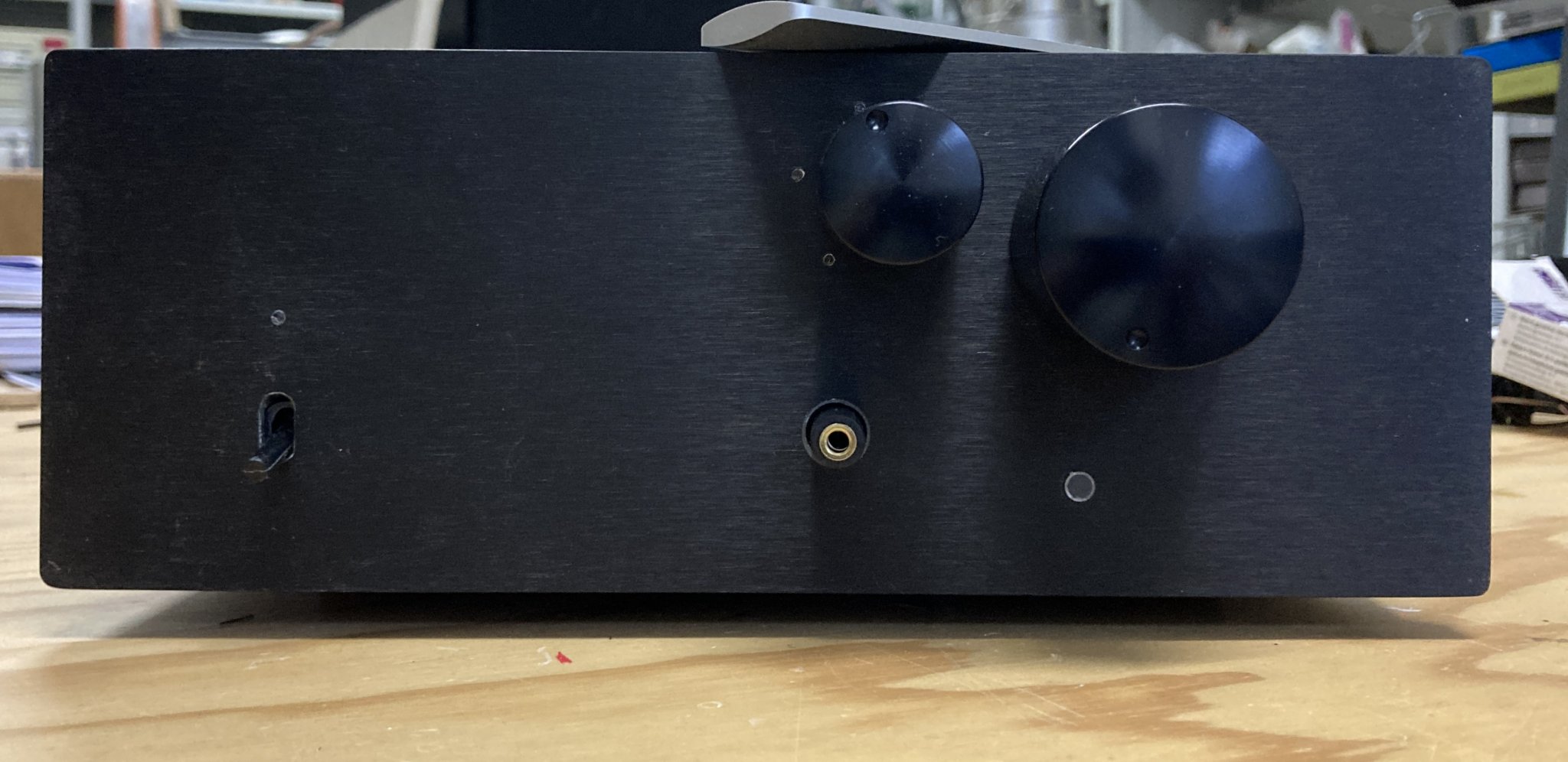

The other bug really asking for a remedy is the volume-pot's shaft being just that liiittle too short. The knob can't be properly mounted, it is about something like 2 mm. Argh.

Per the building guide the offset values appear to be within limits.
As for the rod a (second) shaft coupler or otherwise a new rod will solve this issue, but I guess you have thought about this already.
These moments I also try to remind myself of the proverb "Perfection is the enemy of the good!".
Yes indeed (to both "perfection" and "shaft coupler") 🙂.
The problem is that I can't easily add a coupler as there's no space for it—I'd have to make any extension sit flush on the shaft's head. As it is a knurled, "slitted" shaft, I can use the slit and insert a little piece of aluminum/brass.
Or open up the knob's hole (make space for a plugged-over tubular extension)—probably the easiest way?
Or file down 2 mm on the knob's underside
Or make the knobs recessed (requires a workshop and €)
Thanks! it must be something able to withstand the torsion-forces (turning the knob, careless handling)
Until it's solved, I can use the remote, tadaa!
Not sure I understand, do you mean the pots shaft is too short to go through faceplate, which I assume is the 10mm thick one, or no?Yes indeed (to both "perfection" and "shaft coupler") 🙂.
If yes, I solved the problem with a shaft extension kit from Partsconnexion, about 20 bucks. They give the length of the bearing as 10mm, but it is long enough to go through and get the nut tightened on other side on the 10mm chassis faceplate.
Russellc
JB weld maybe?Blu tack probably will be too soft or maybe a fast hardening resin to fill the gap?
You got me right, and not quite right 🙂
Yes, the shaft is too short. I mounted the pot onto an aluminium-plate, and this plate onto the front's back, the shaft going through the 10mm faceplate, and now the available length that is left is ~5 mm (I unfortunately only got a pot with a 15 mm shaft!)
I can't move the pot backwards (to put a shaft-extension inbetween), either, because space is scarce and everything is just snugly (or even a bit overstuffed) in its place.
I went the easyer route and widened the knob's hole, thus I can plop an extension directly onto the shaft and ZANG it is done (after finetuning this for a tight fit.

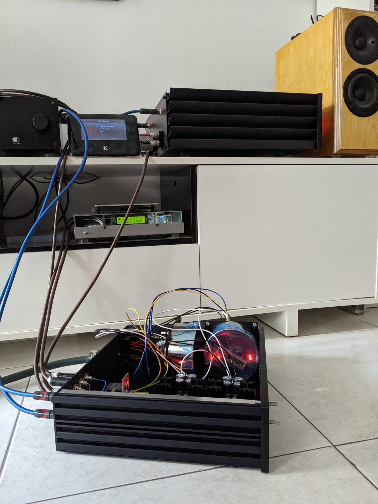

Still a bit of a test bench situation, but I could not wait any longer.You are welcome. System picture awaited.
I thought I had it...

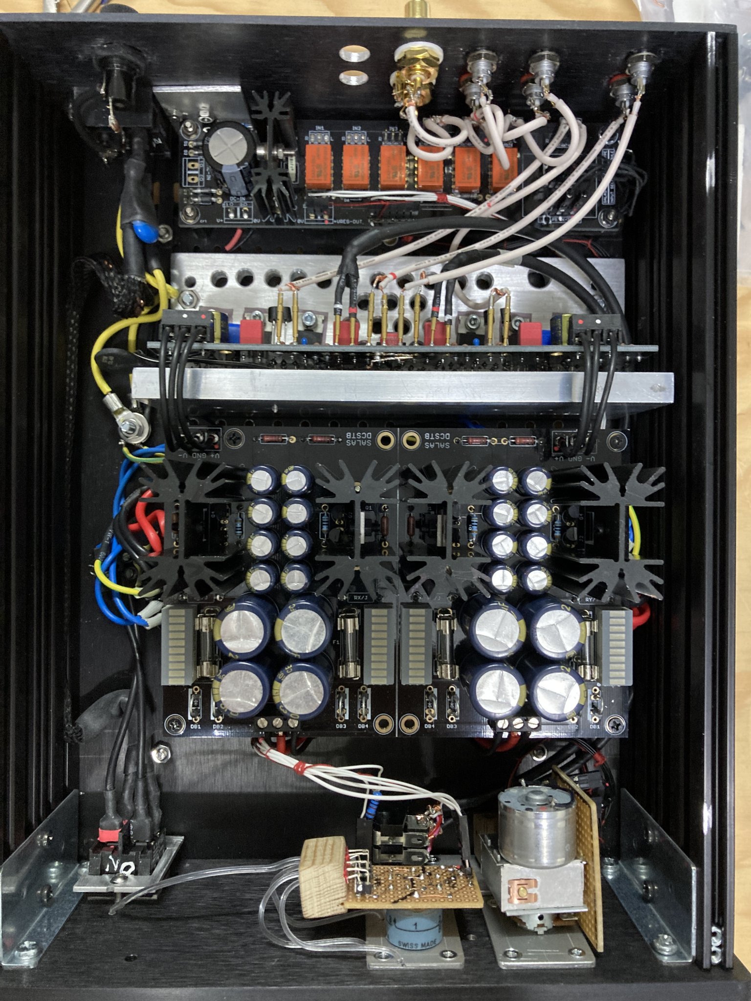

After my first layout with a quite fat heatsink and the board mounted horizontally, the build was, well, overstuffed. Not that it's airy as it is becoming right now, but still way better than before.
But of course a new issue occurred: The volume-relay is not working anymore.
On for a third round. 🎢
(It seems like this is my karma: The things I make aren't good before the third time!)
@pfarrell don't wan't to make you wait any longer to see something, so here's a glimpse of what will be my DCG3 ( it is the one with the "always been good channel" 😀 <- I just love that)

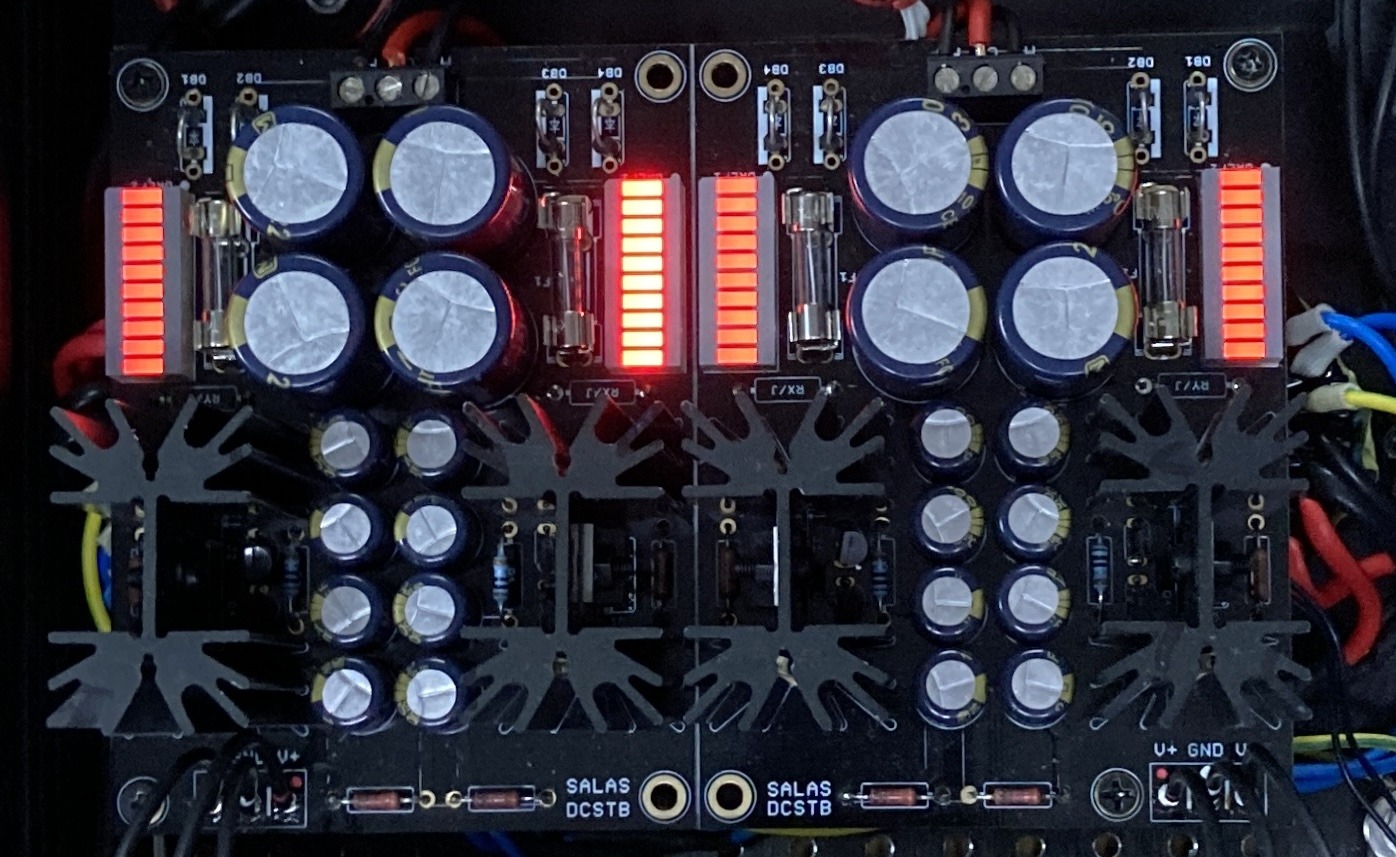

Am I really to be called "Mr. Bungle"?
It seems so:
Transformer output is good, 18.6VAV + 18.6VAC
After de- and reconnecting the DCSRB, I first measured a weird number, like +34 / -17 VDC (or something like that)
Then I accidentally shorted the V+ (spark, fuse blown)
replaced fuse, turned on: V+'s LED-bank comes up immediately and much brighter than the 3 others.
It now measures +42VDC / +24VDC. (black probe on GND both times)
I conclude that I've blown something up? (there was no smoke ar anything but that spark)
The other channel measures good. This other channel feeds I-select, which turns on and outputs 12.1VDC.
LEDs (Channel indicators) are lit.
Relay (fed by I-select) not responsive but haven't checked connections. It was good before disassembly.
When I fed the relay, which feeds the Pot-motor, it first didn't do anything, with twisted wires didn't stop running.
All this stuff is disconnected for now, want to check connections first, then see how to proceed.
It seems so:
You could have blown Q2 and/or J1. But how to make 42V DC from just one 18.6V AC secondary connected in a section is weird. Next time use a dim bulb tester on start up.
that's the answer I was afraid to get...
Makes me feel sorry.
I was obviously overconfident—everything was working, and everything was marked (like, this wire there and that wire here...), and boof.
It seems the J2 PF5102 are becoming hard to get. Does somebody know of a good reliable source? Or, would tea-bag send me replacements? (After I was able to confirm it's blown at all)
I should also add that fuses are generally intended to "stop the fire". That no magic smoke was released means the fuse did its job. True current limit circuits are intended to allow equipment to shut down gracefully from an overload and recover when the fault is removed. In this sense, a fuse is not a current limit circuit. The response time of a fuse is too long to reliably save components.
