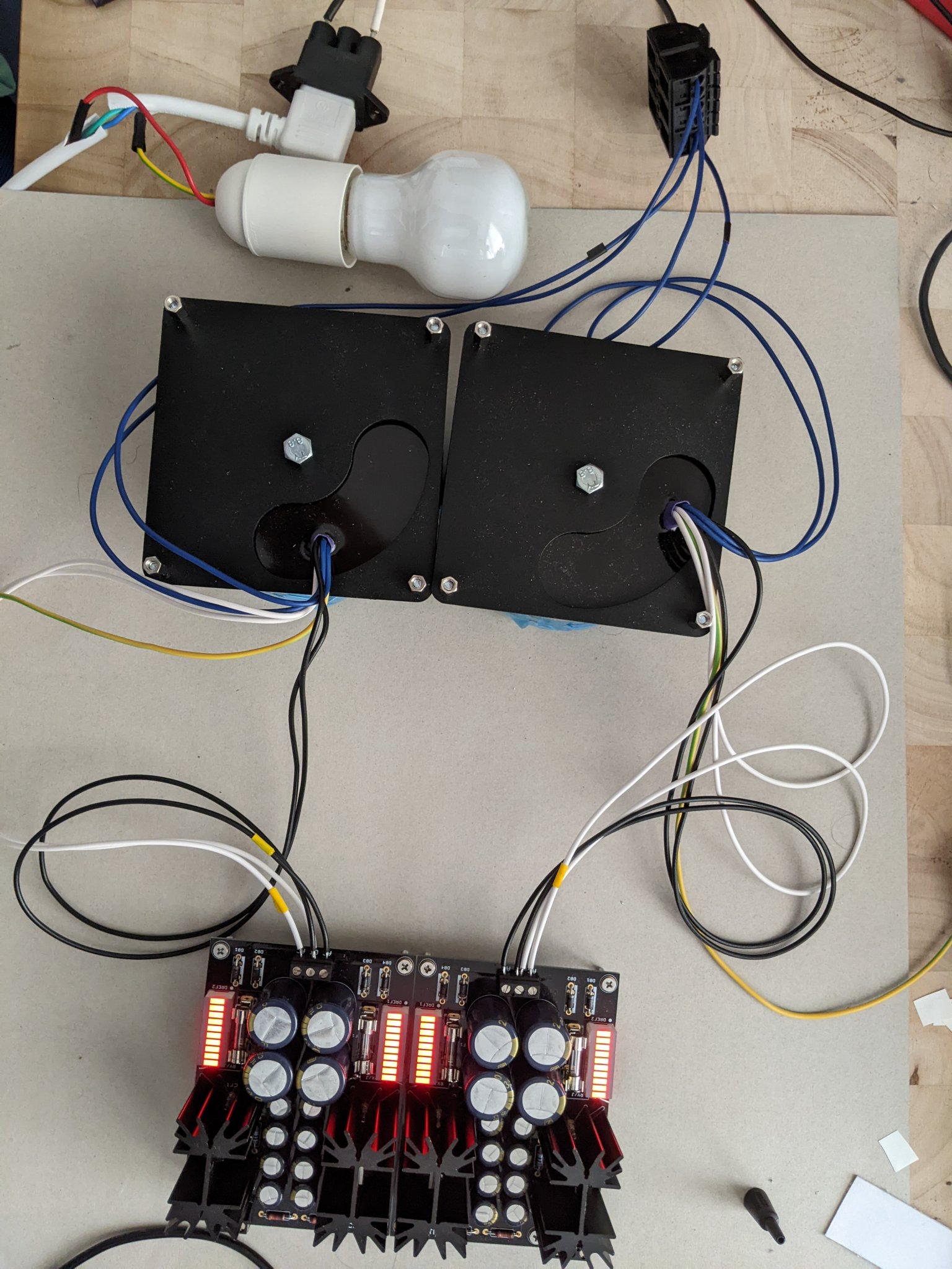

DC values are on both sides are 17.09 and 17.11.Its ok they are just good transformers with tight regulation (they don't lose much ac with moderate loading). Anyway you will see their final output when loaded with the DCG3's bias.
And the 100 Watt dim bulb tester did appears still intact.DC values are on both sides are 17.09 and 17.11.
Now the values are 17.04 on one side and 17.04/17.05 on the other side. Sorry, I am not good in taking pictures while measuring.Picture? When DCSTB will be loaded with DCG3 there will be some current in the transformers and you will check their AC level again.
Thank you Salas!Its a clear picture. I see DCSTB sections perfectly lit and dim bulb perfectly dim. All well up to now and congratulations.

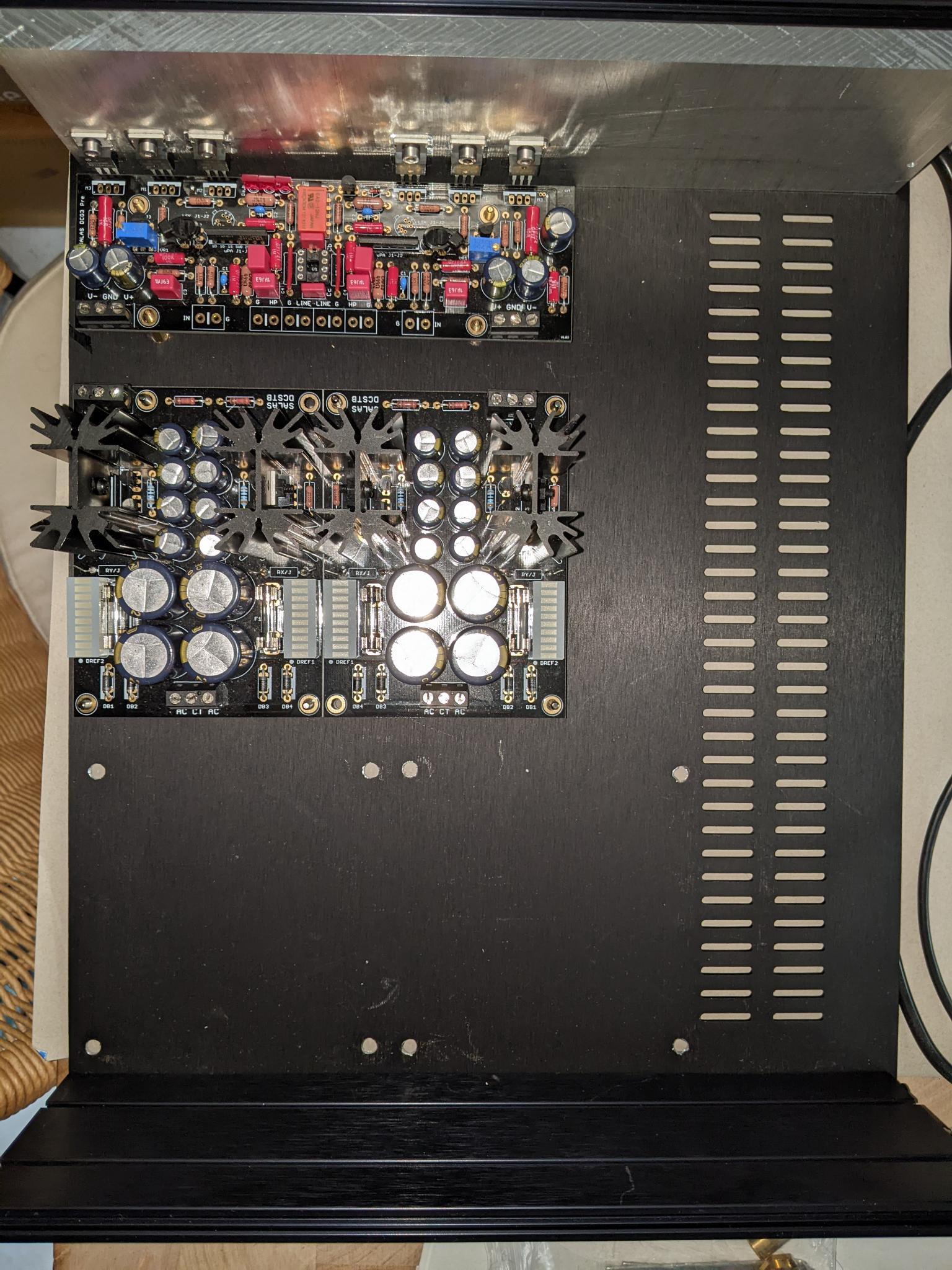

Hello all
some incremental progress, some more questions:
- The build guide states in the section 6: “Fuse the transformer(s) primary as rated by its manufacturer.“ Does this mean that the IEC also needs a fuse or just that the primaries need to be connected to a terminal block?
- In section 7 it says: “short the signal inputs and measure the DC offset across each line output.“ Not sure what this means/what I have to do.
- Grounding is still confusing to me: what I understand so far is that all the RCA inputs and output, selector switch/pot (no i selector board), headphone socket and signal board (v.1.03, any one input/output ground point) need to be connected to one common point of the chassis. I found some more information in post #3,684, but not sure I completely understand. Still have some CL60 thermistors from another project.
- Earth wire of the transformer just needs to be trimmed (ends wrapped in isolation tape) and does not need to be connected to chassis ground?
- Soldering the heat sinks of the PSU to the board is crucial?
- Would there be an advantage in using heat dissipation foil (still have some KERAFOL 86/82) in adddition to or instead of the silpads for mounting the MOSFETs to the heatsink?
As these are recently done things by me, Ihope I can ease things a bit (and make Master Salas a bit relieved/relaxed 😇)

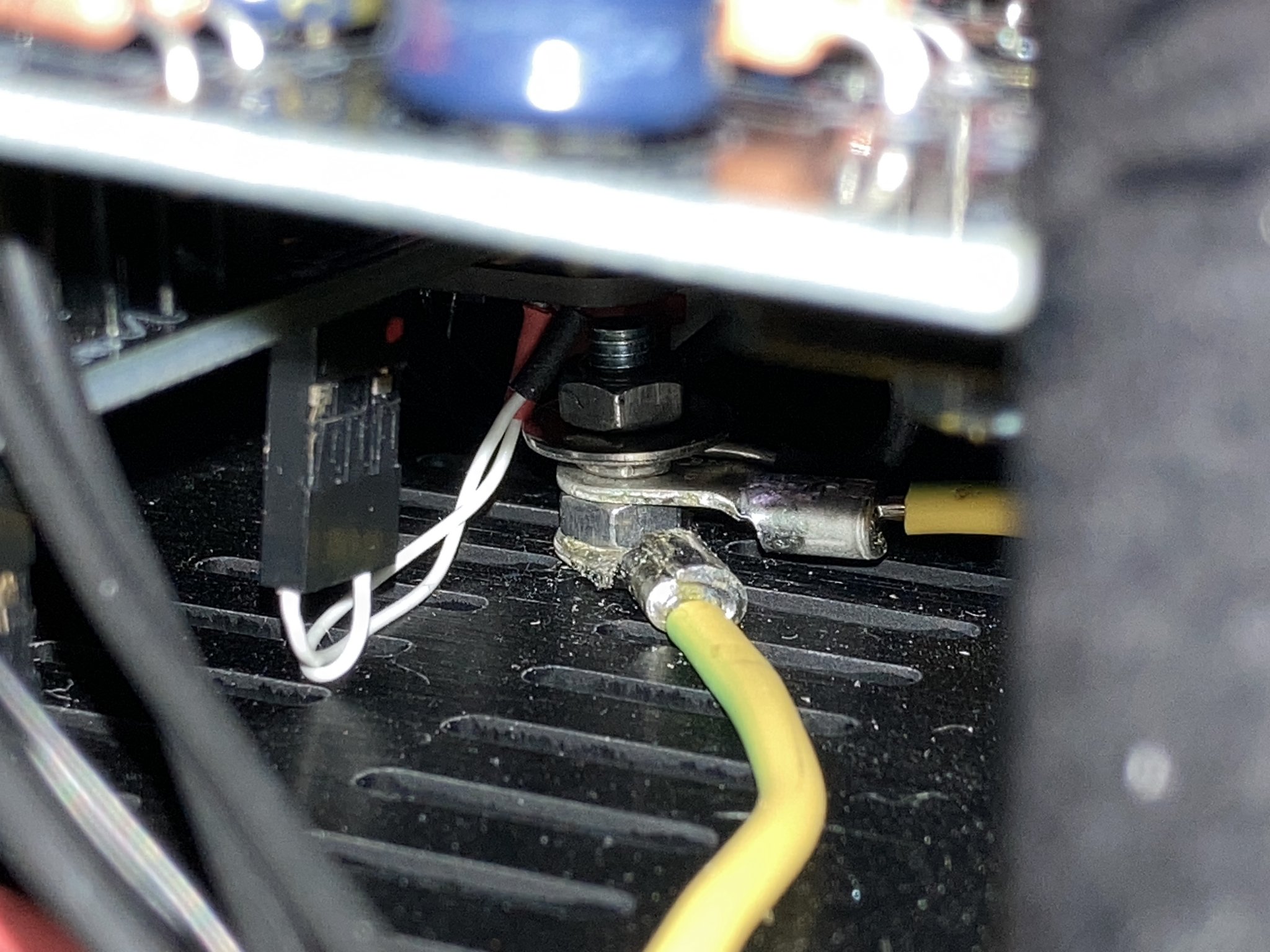

My star-ground is like this:
-Chassis
-IEC-ground
-transformer shields
-CL60s (1 per channel)
Its all on 1 screw, the IEC-gnd is secured with its own bolt.

Okay, a fused IEC is crucial and I will need 2 separate ground/earth posts.
Now I understand how measurement is done: your post #6,485 depicts how measurement is done.
Do you also have photo showing the grounding?
Thanks again!
For dual 50VA transformers put 1.25A slow blow fuse in the IEC if in 230V mains countries or 2.5A if in 115V mains countries. To withstand the inrush current at power on. That's safe enough, no further individual primary side fuses will be needed.1) install a fused IEC
Here ya go, although there’s not much discernible 🙃photo showing the grounding
The CL60s aren visible because they‘re wrapped in black shrinktube and without a spade. They‘re above the yellow wires (which doesn‘t matter as long as the trannies aren’t („electronically“) behind the CL60.

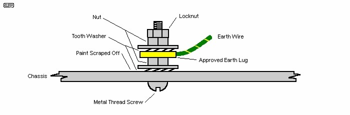

If still in doubt, look after sound-au safety-ground or similar, I believe he has a very clear drawing of how it should be done. (Maybe Salas or some other good soul has a link/pic at hand…)
look at salas' answer, above.
(Although these double-fused IEC have been hotly discussed here, so hot that I decided not to use them...)
BTW, here's that image and its long article...
