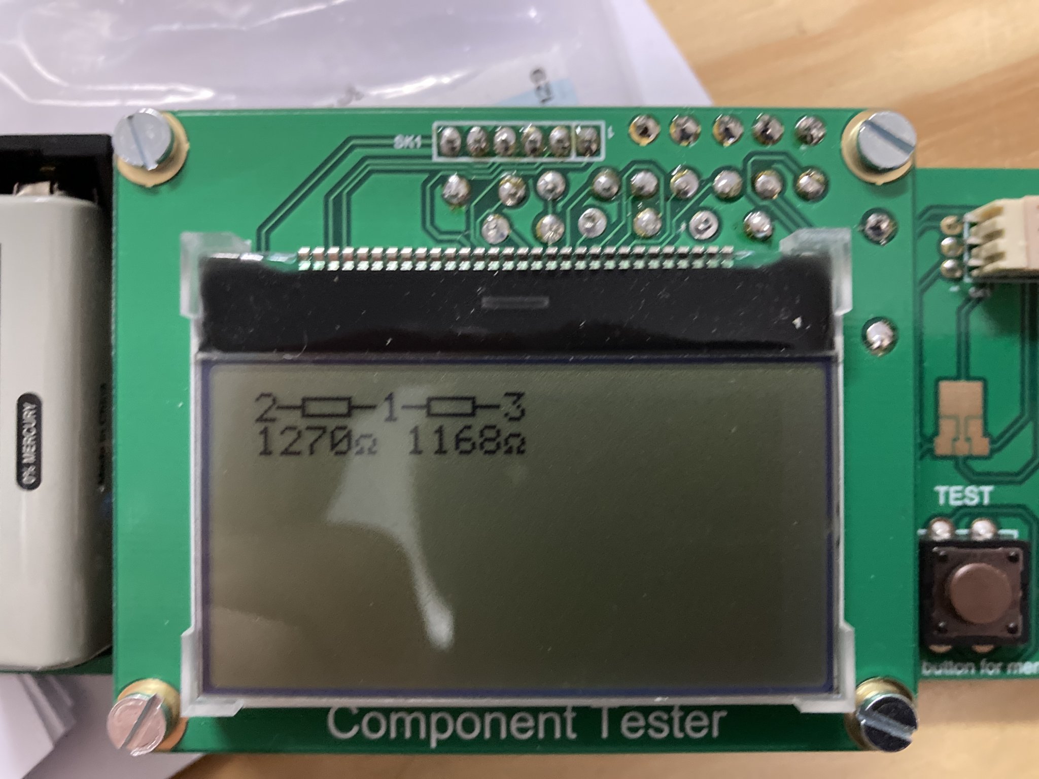

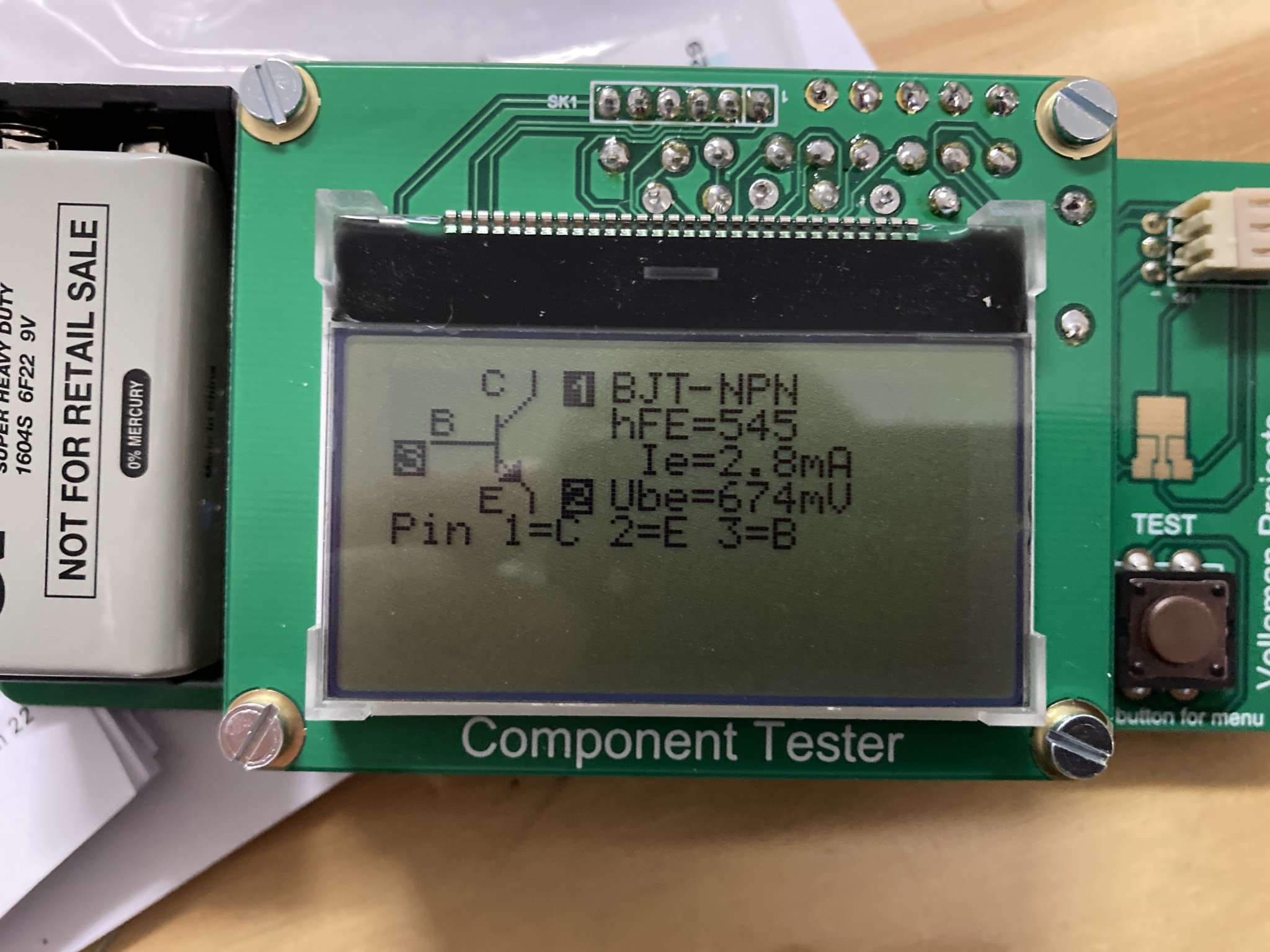

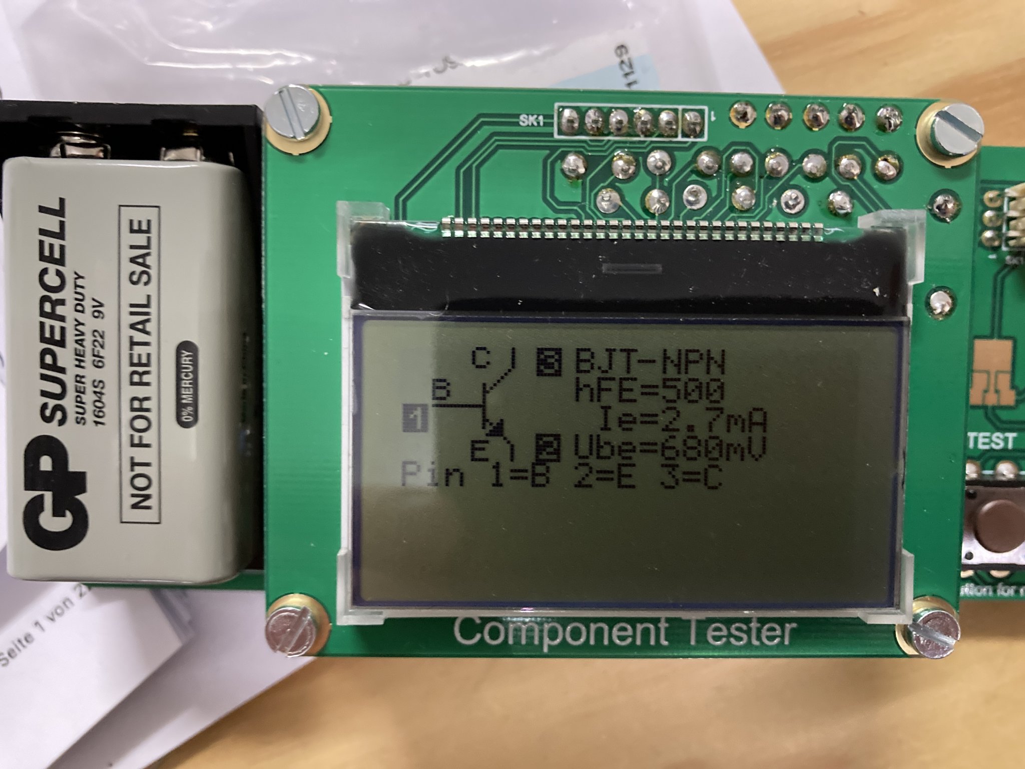

Received a little batch of Q2 (bc550n).
According to the component tester, the removed Q2 seems to be gone...
Measured 2 new ones, they are in the range
hfE=500
Ie=2.7mA
Vbe=680mV
hfE=545
Ie=2.8mA
Vbe=674mV
What's to be searched for? (Couldn't find your description anymore, sorry!)

I set no specific hfe goal for the BC 5xxC transistors in the DCSTB psu. Your samples are fine high hfe examples.

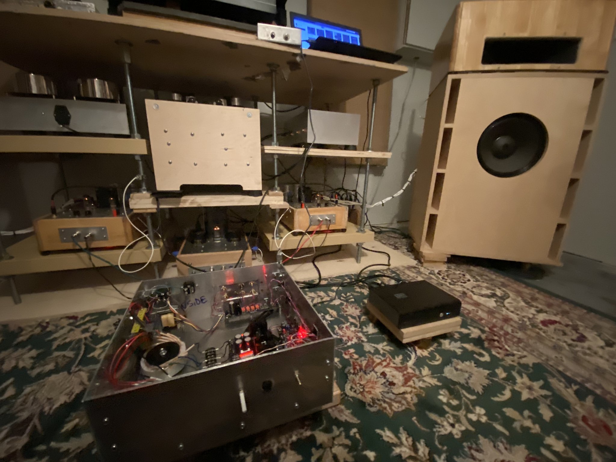

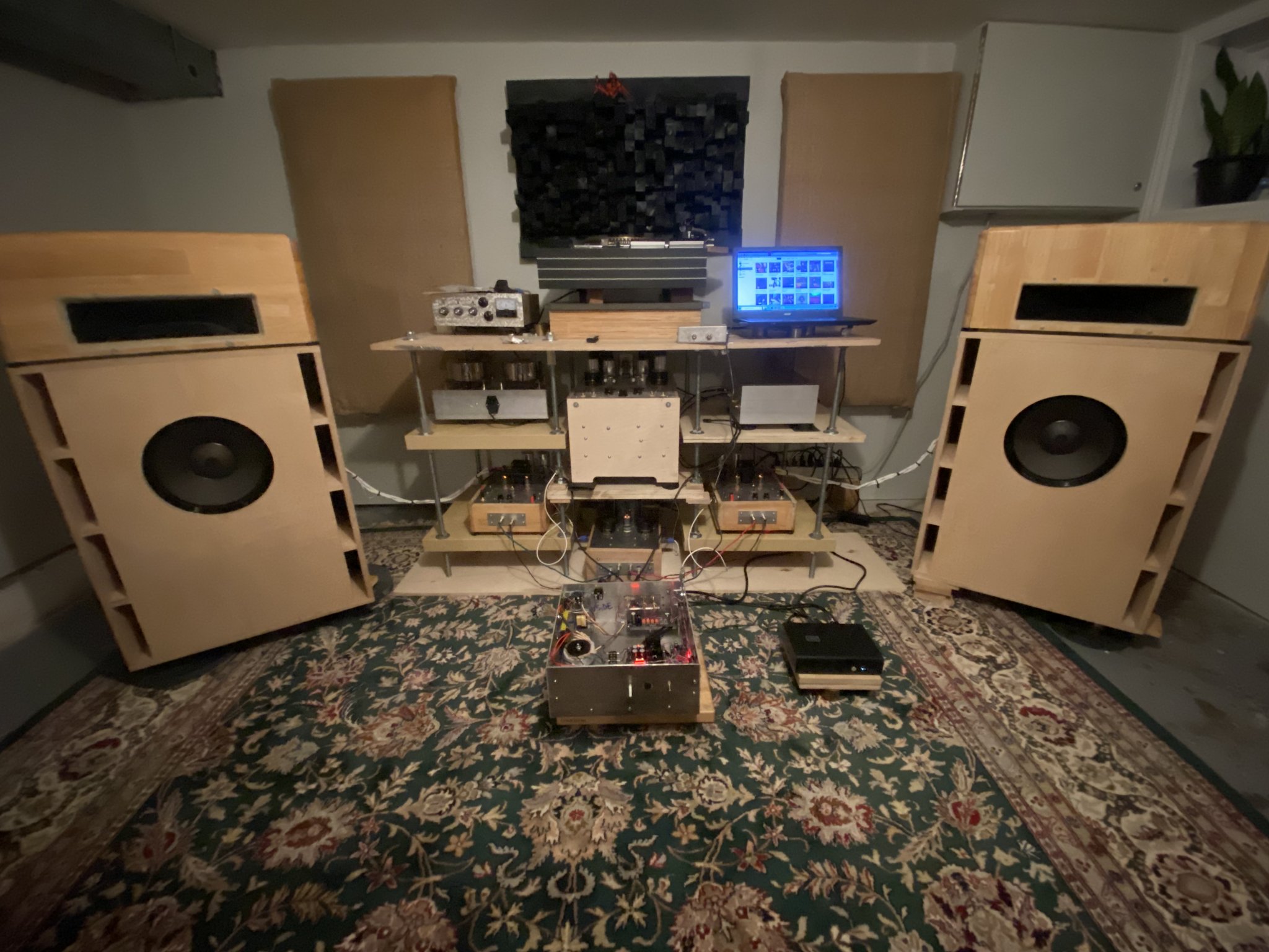

Another datapoint , finished the dcg3 and it is now playing in the system. Previous pre is Salas 6V6 with sshv2.
Had to ground headphone jack and vol pot (goldpoint 25k v24 steps) to get rid of hum. Took me forever to figure that out after I ripped the whole system apart. Dcg3 has dstb power supply .
Power amps are Baby Huey el84 push pull and speaks are altec 414’s in onken box with altec 802 on top.
Early listening impressions are this thing is dead quiet!! Using bc550 so far. Can hear difference with recordings in regards to how good or bad they were recorded. Very smooth presentation, very relaxed, good separation of instruments and good sound at lower volumes.
6V6 preamp has more flesh and visceral presentation if that means anything but l’ve only had the dcg3 on for a few hours and it is opening up and bass is getting better. Have yet to put a cover on the dcg3
preamp but I couldn’t wait to see what it sounded like and I am happy.

Very nice! Congratulations! You are welcome. An Impressive full diy system.

Very impressive and dedicated system! Can I ask what that small black box on the floor next to the DCG3 is?
Interfering here to say that I'm back in business.
just replaced the bc550n with an arbitrary one of the batch I received, PSU seems to be back in the nominals:
-17.35VDC / +17.4VDC, led bars engage with that little delay and shine parallel (equally bright as seen to my eyes)
so, on with the build, improve what can be done easily (HP-wiring for one, the cable I used first was much too stiff) and into the test-system for a very first listening impression!
