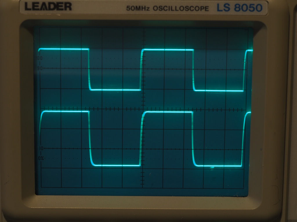

Cold, hard facts
100KHz into 33R load
Top trace = in
Bottom trace = out
Horiz scale = 2us/div
Vert scale(in) 1V/div
Vert scale(out) = 2V/div
Top trace = in
Bottom trace = out
By the way if you feed 1Vpk-pk sinewave to your build (which has fixed gain of 3) and you up the generator's frequency until DCG3's output goes from 3Vpk-pk down to 2Vpk-pk you find its F3 upper limit. How many hundred kHz is that? Because passing such a good looking 100kHz squarewave surely takes a very high F3.

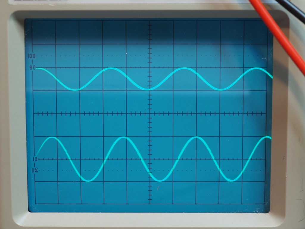

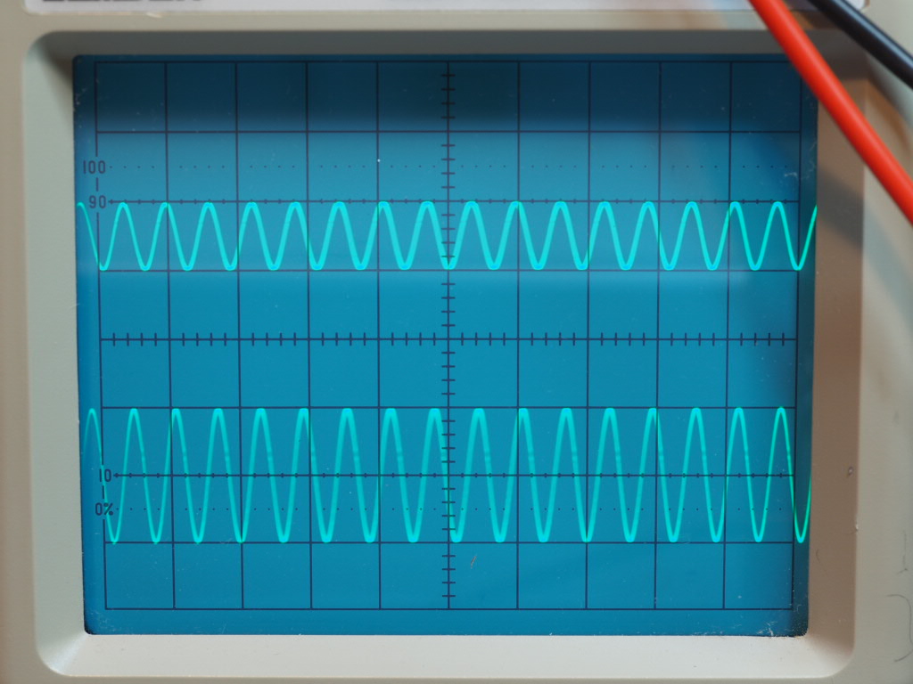

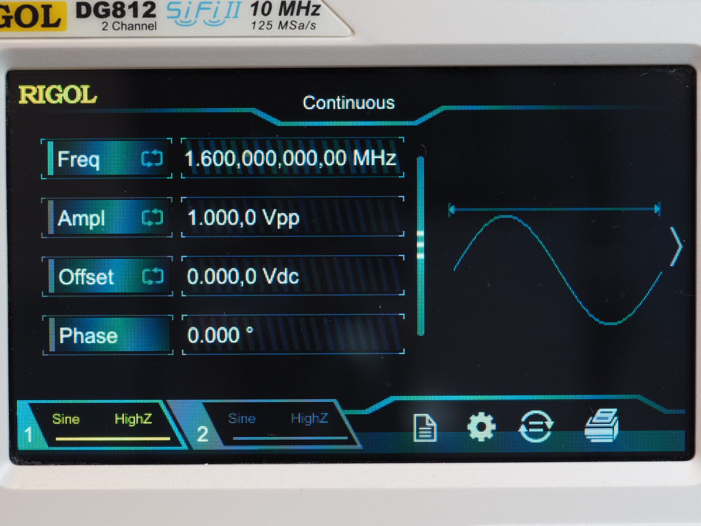

All measurements into 33R resistive load. Output (sine) very clean at this frequency.

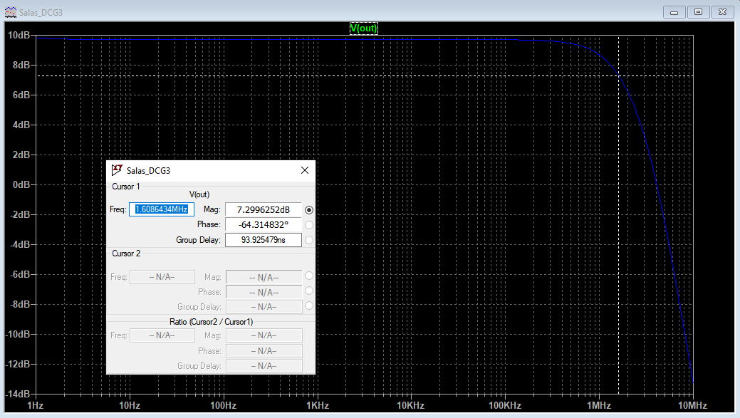

The 1.6 MHz -3dB frequency response you got is good enough even for AM radio 😀
Interestingly my original simulation plot's indication and your fresh build's F3 response measurement result are close within experimental error. Therefore from prototype and theory to current parts batches and boards, all stick to spec very well after five years. Satisfactory consistency.
*J1,J2=LSK389C Cordell Spice model, signal source Z=50R, output load=33R (parallel to 100pF for 1 meter coax)
