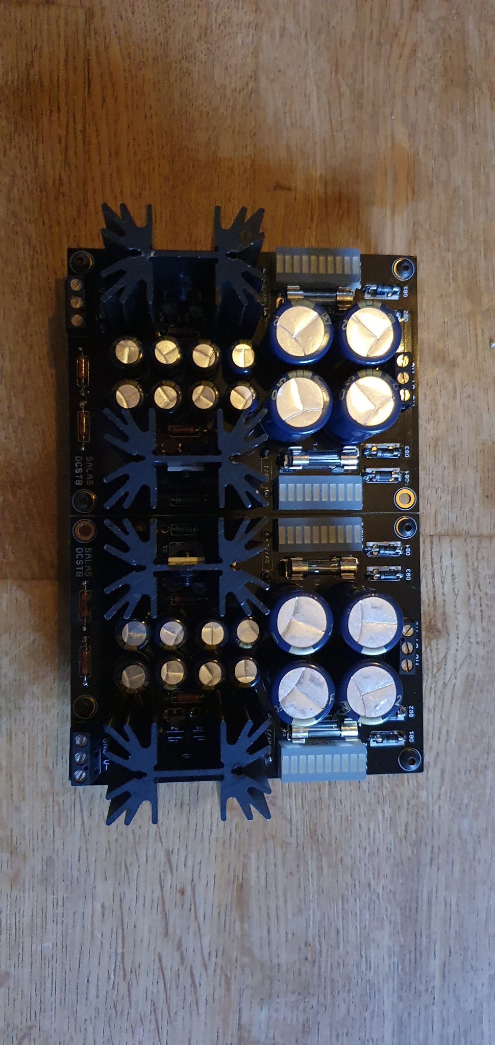

I think I've caused confusion with my terminology, I've built the DCSTB (see image which is 1 large board with 2 mirror image rails on it) and was going to order 2 transformers to power it (other image).

Each DCSTB independent section has an AC CT AC input connector. As seen at the right side on your photograph. You need one transformer per channel/section. Two in total. Ending up with a true dual mono PSU.
For a 2X18 named Tx with four wire outputs, you connect its outer secondary wires to each AC point and their middle wires together to the CT point (center tap). That creates the zero return mid point.

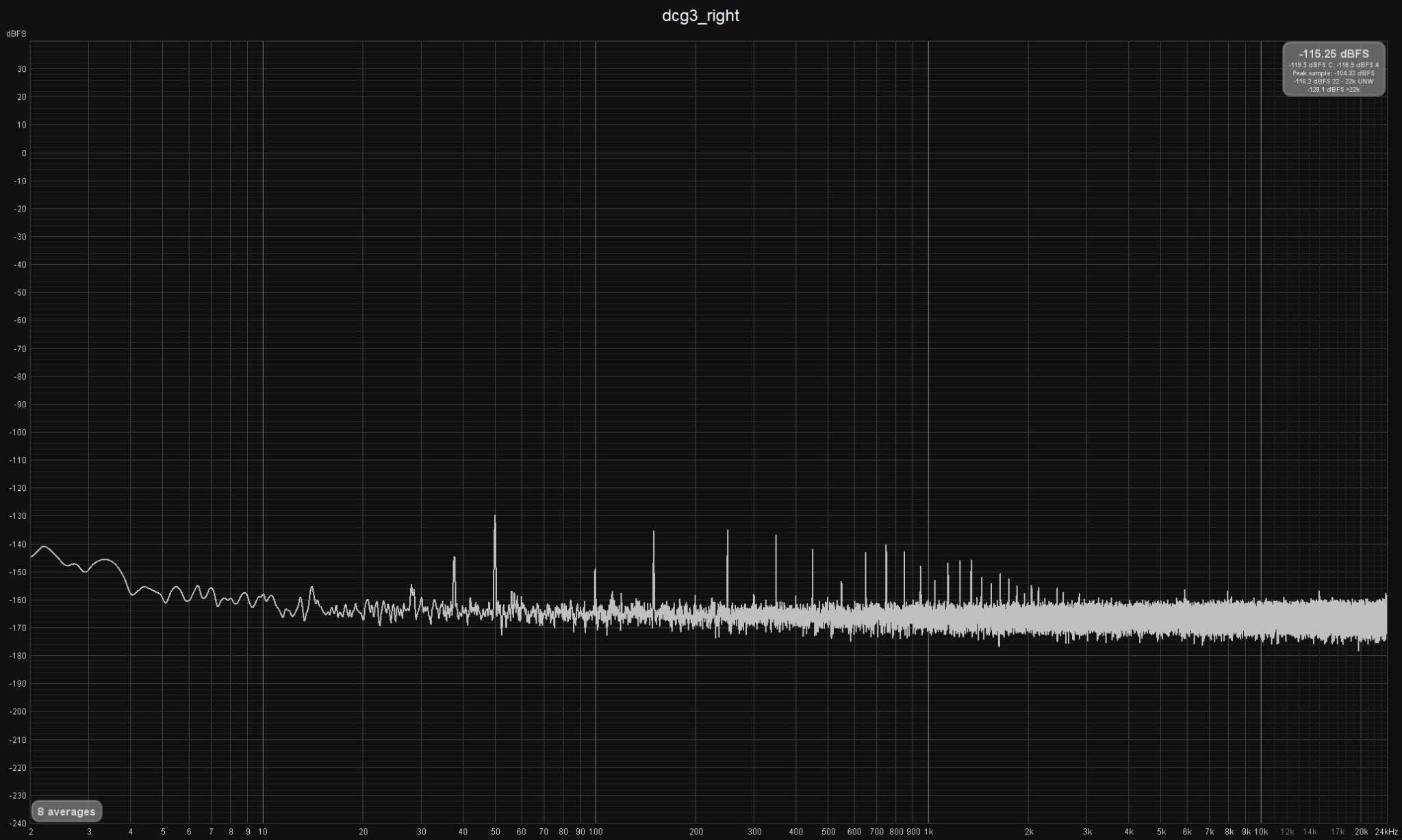

Just a quick measurement before I go to bed. (self noise)
I got about 0.0003%THD now.
So I am where it supposed to be.
Now I am using screened (coax) cables from the I-select board to the dcg3..
Cables here picks up everything. Even the coaxes needs to be bundled tight together.
Just touching, moving a bit gets quite big results on scope.

That's really silent grass no doubt. 0.0003% THD and -119 dBFSA SNR are very cool for your DCG3 build. What audio analyzer is this you're using?
The spikes at -130 dBFS and below are so low they could be interference from just looking at it the wrong way.
A tiny Tx field tail reaching, a mains chord's magnetic field, a powered fixture in the room. Whatever. Are they also there in the analyzer's self loop if you will use the same test leads layed out at the same place?
