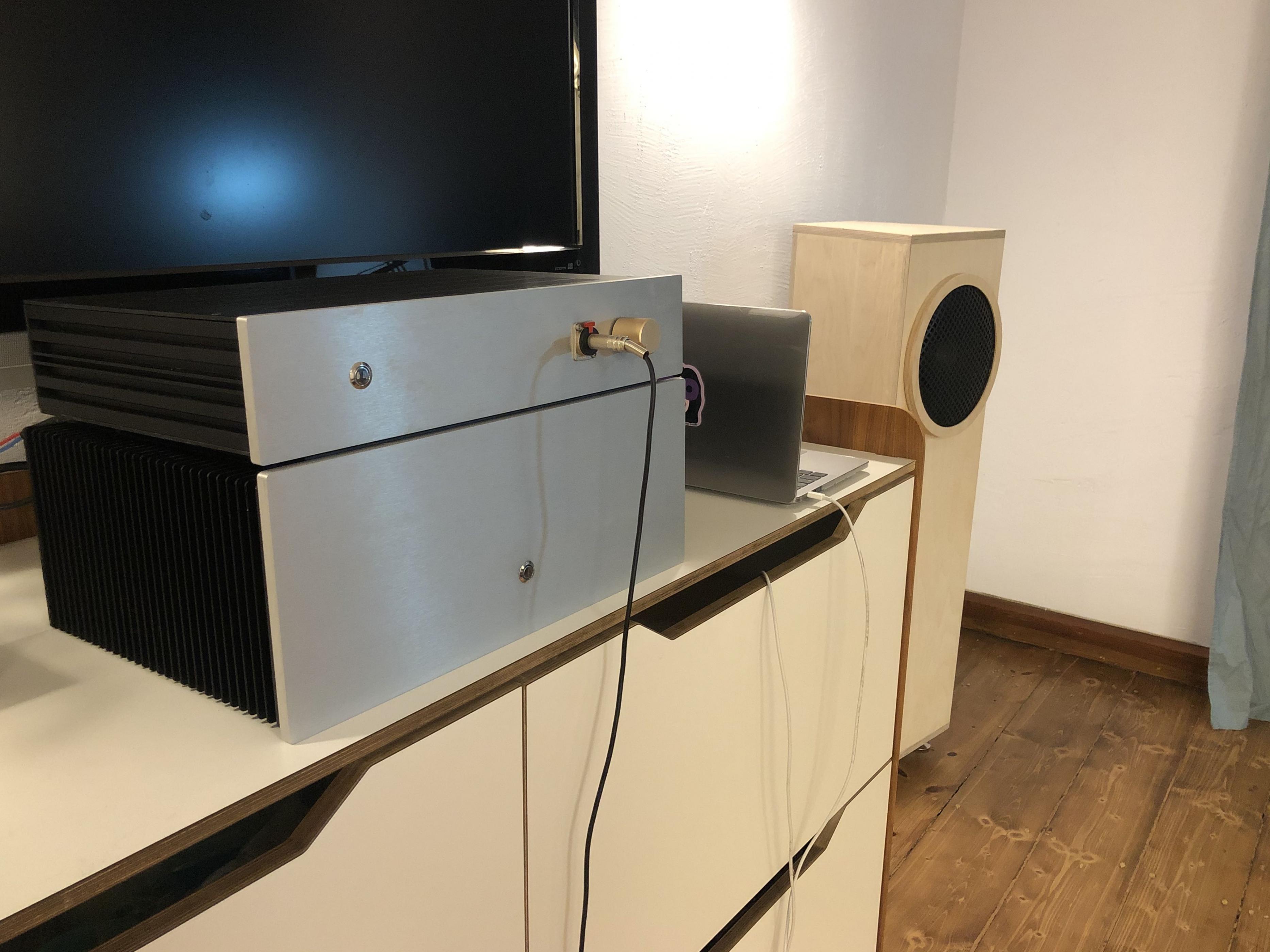

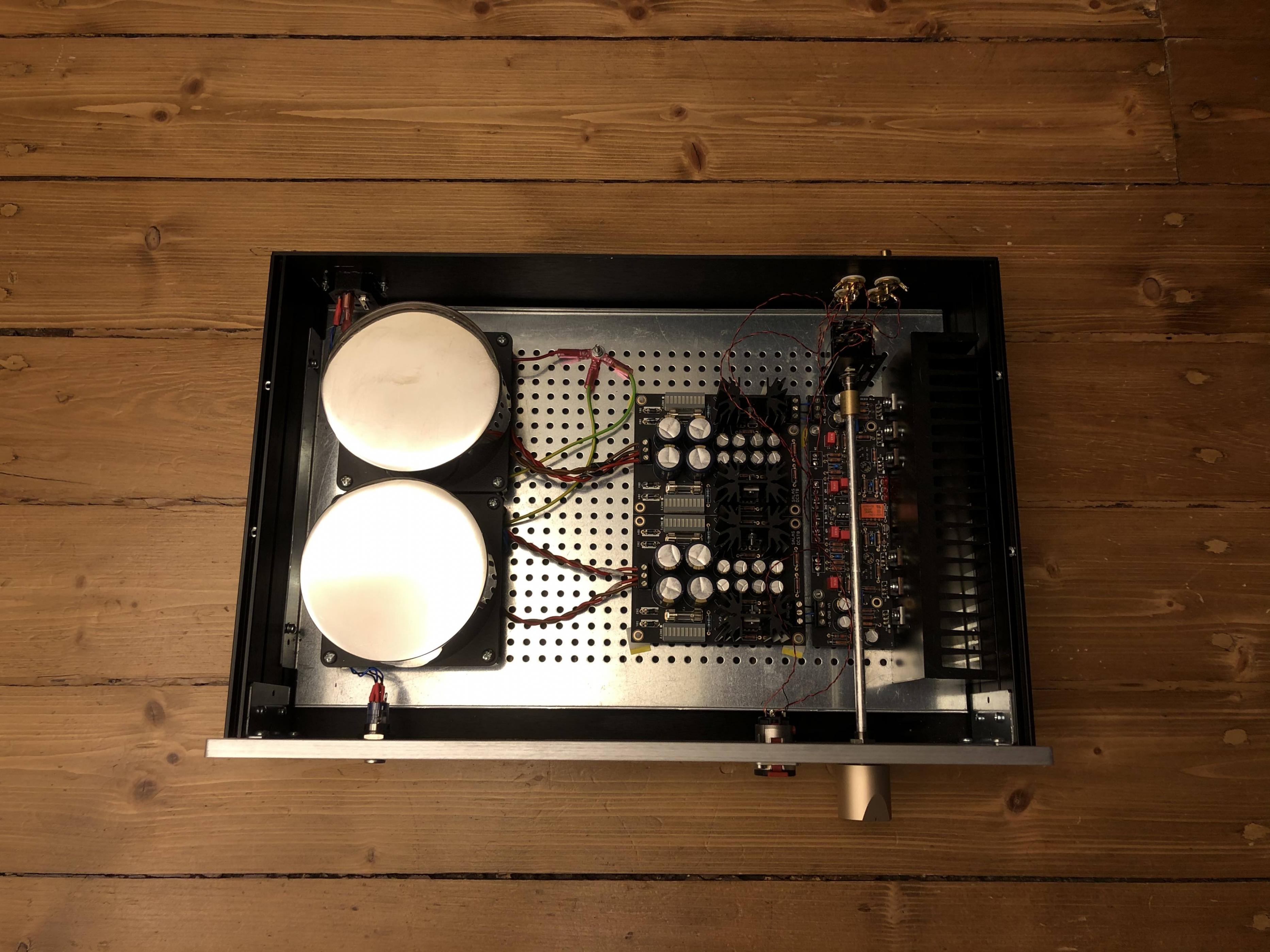

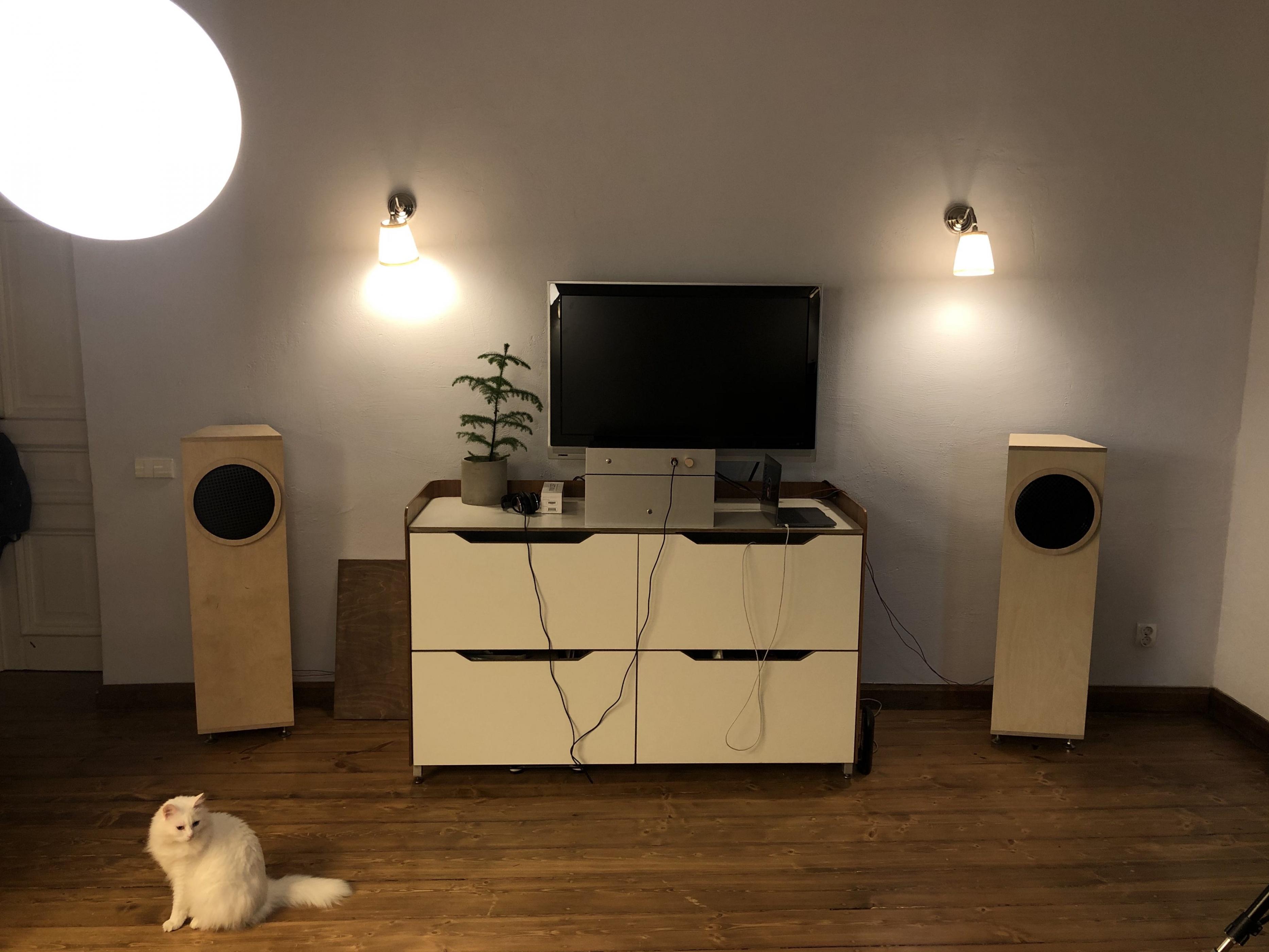

I encased mine today, as I've been listening to it over 3 weeks already and I absolutely loved it. Precise, in control, very reavealing. Japanese knife type when with SMD 20K stepped pot and monitorish headphones. When with my fresh DIY FL speakers and a current feedback AB/A type amp it made me experience almost spooky presence moments during some musical passages. Now it is test running a TKD pot together with the speakers. And it makes me appreciate a tone correctness of some live instruments with a smile. The speakers need some tuning, so I can't tell the final word which pot is here to stay. More discoveries are waiting :xfingers:
The build was sans glitch. The documentation was clear and top notch. I'm very grateful to Salas, Tea-bag and the community.
Can't be streesed enough, Diyaudio is a truly special place on the net. The internet was built for the Diyaudio, not the other way around. The knowledge that is shared here is overwhelming and priceless. I've been to many online communities, but for me this place is a reference in terms of many things.
And of course, Salas is one of and also THE gem of this kingdom. Thank you, Nick, for everything. :worship:
All this to say, if you're on the fence of building this, go for it!
Some DCG3 pics with my audio family.
