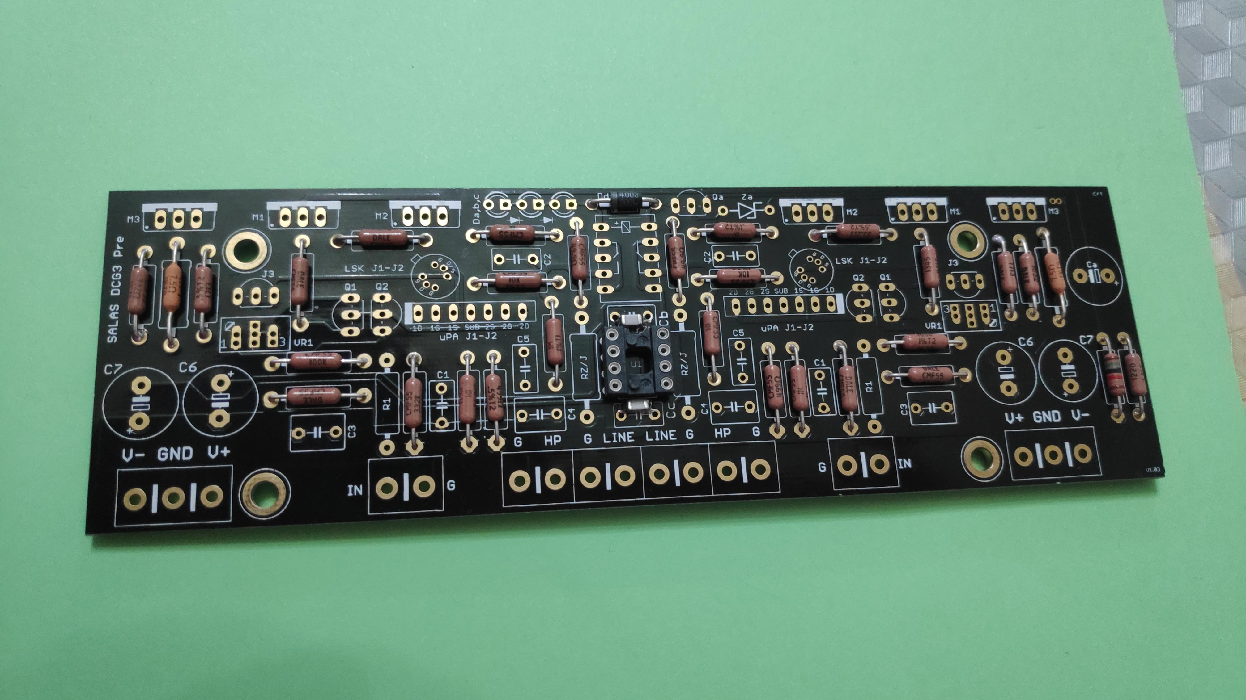

I have noticed that depletion mode FETs are frequently used as constant current sources. How critical are these Fets? What parameters, besides IDSS make a 2sk170, 2sk117, J113, BF256 or a PF5102 the FET of choice ? With most JFETs being discontinued, its slim pickings and more freedom in choice would be nice.
They are critical in how good a constant current source they can create under what Vds for what Idrain in various places. Self noise, thermal drift, parasitic capacitance, dissipation, must be judged accordingly. Sometimes using two to make cascode between different Vgs(off) types helps.
Say you have DN2540 DMOS and a BF256 JFET in hand. How is best to use them in DCG3? The 2540 has generally good parameters but it does not mean that its performance, especially when for below 20mA, is as good as the BF256 JFET's for few mA CCS in a long tail source. But its noise is low enough and its dissipation high enough for use in the DCG3's output stage CCS. Or you want to constant current load a tube's plate. The 2540 is also high voltage suitable and you can't use the little JFET there regarding max voltage and dissipation needs.

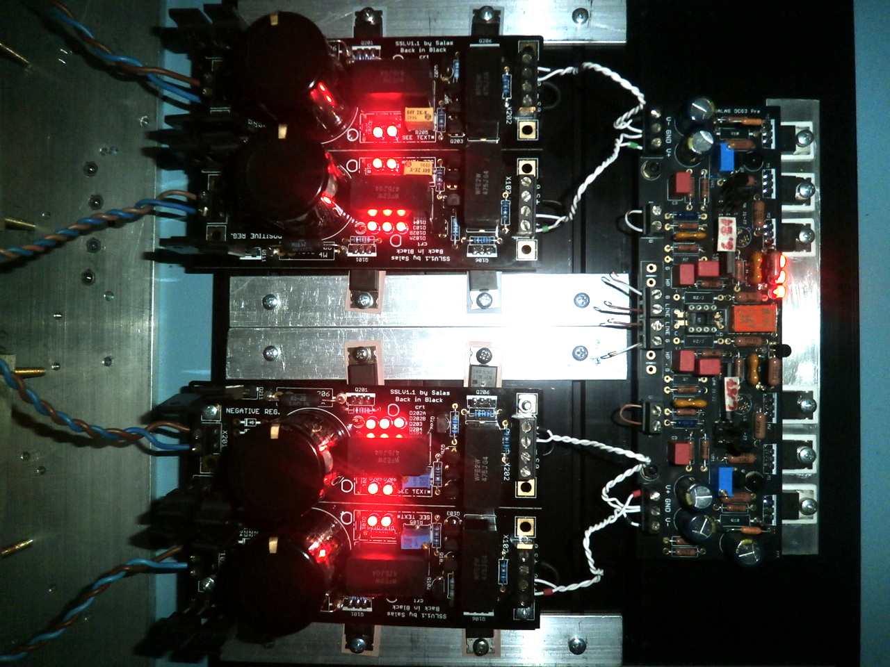

Just finished the second of mine. This one is almost dedicated for testing so most of the critical parts are placed in sockets.
Everything is perfect so far:
Bias : 111mA / 115mA
J3 bias: 4.6mA / 4.6mA
DC offset (without AD823) : 73mV / 66mV
Tried heatshrink in one of the pairs but had opposite effect in DC offset (rise +10mV). Funny but not of big importance I think.
Before tweaking the offset trimmers or after?
