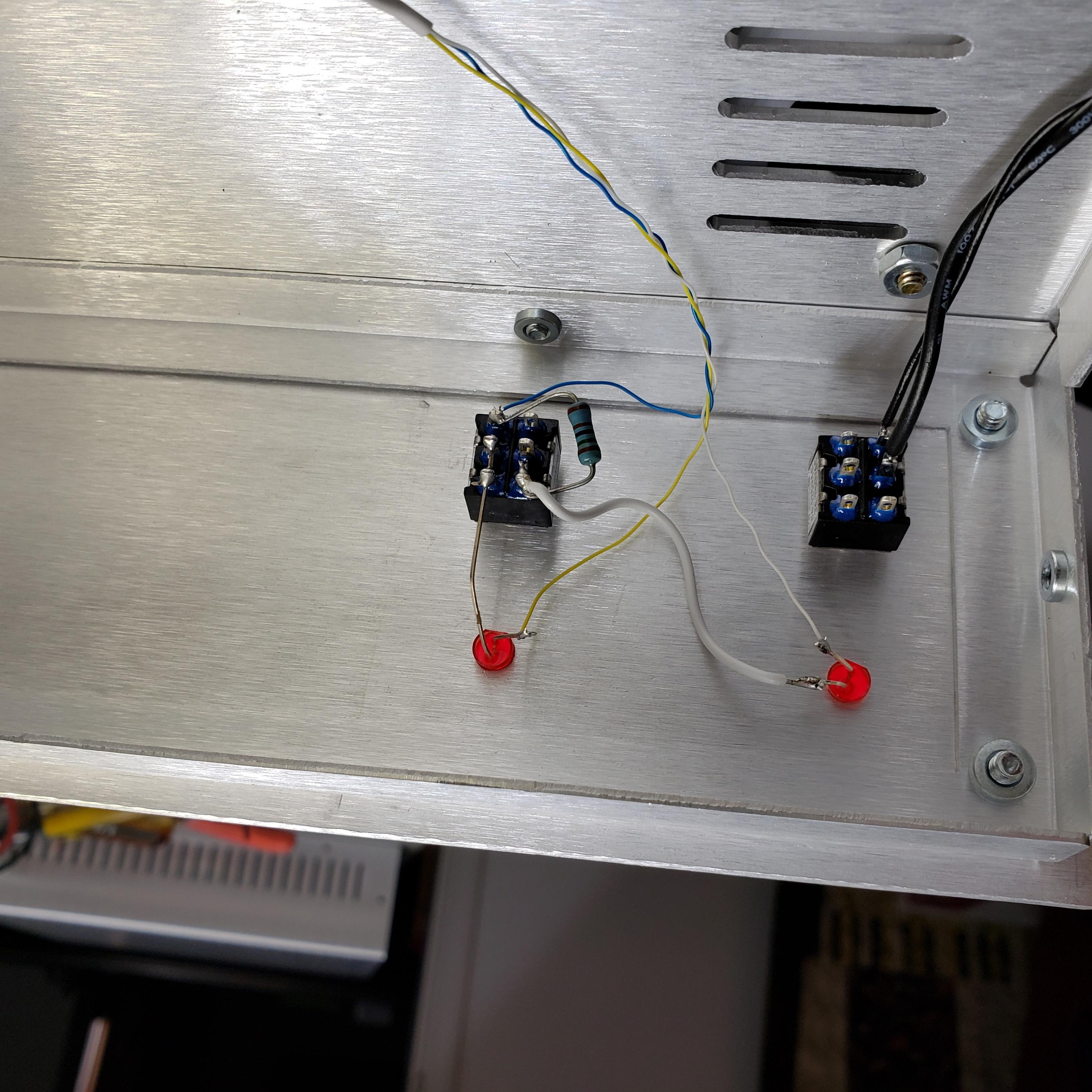

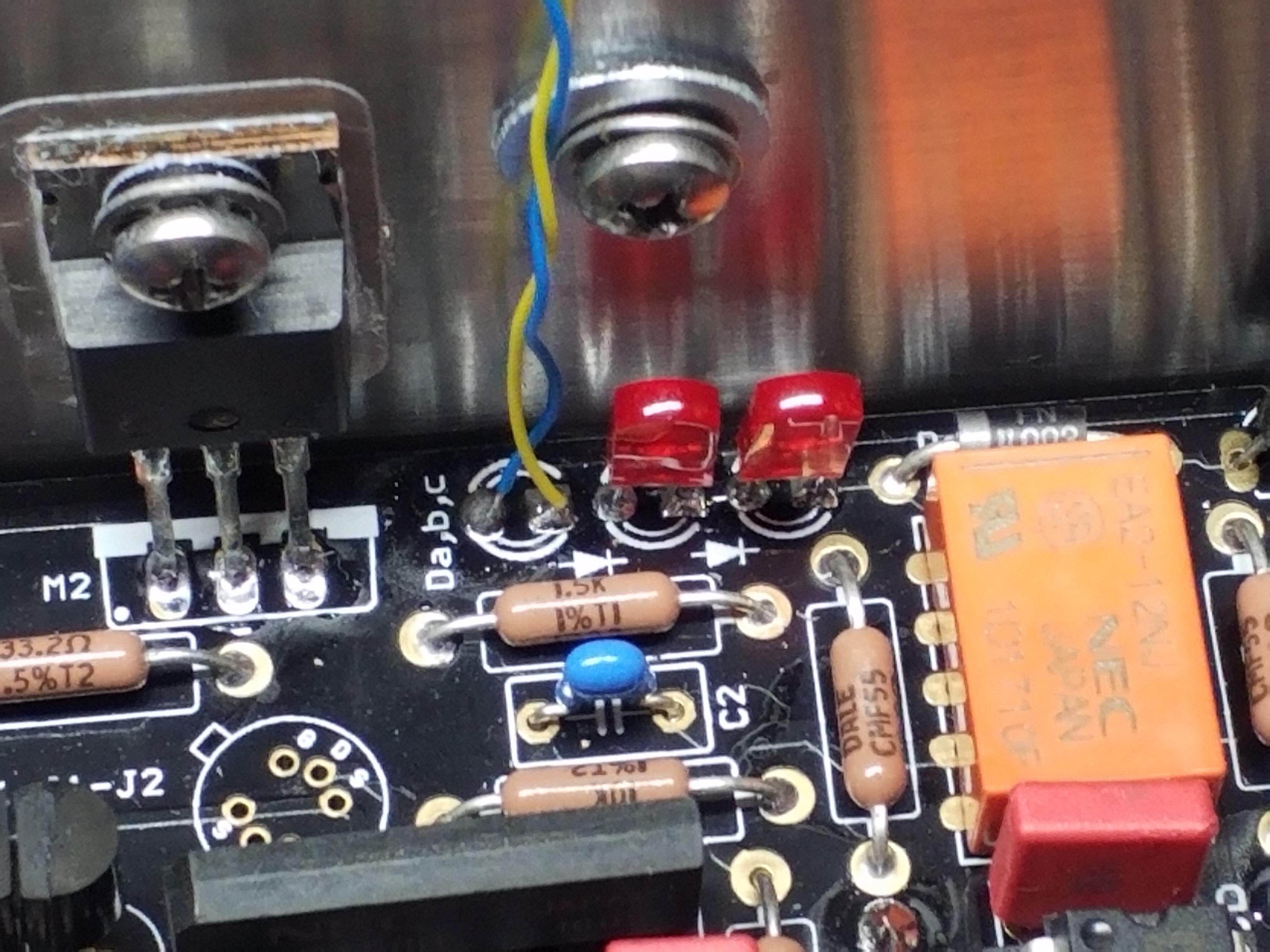

Your bringing one of the muting circuit's Leds to the front is a valid move. I actually had also mentioned that option in the past. Shows ready status beyond the relay click's aural clue if valuable. With the additional switch in its way you control the muting manually of course. Because it breaks the relay's power line. Another additional feature.
*I explained not for you, you know why you added those features, but for all to know their meaning with the opportunity of your build's example.

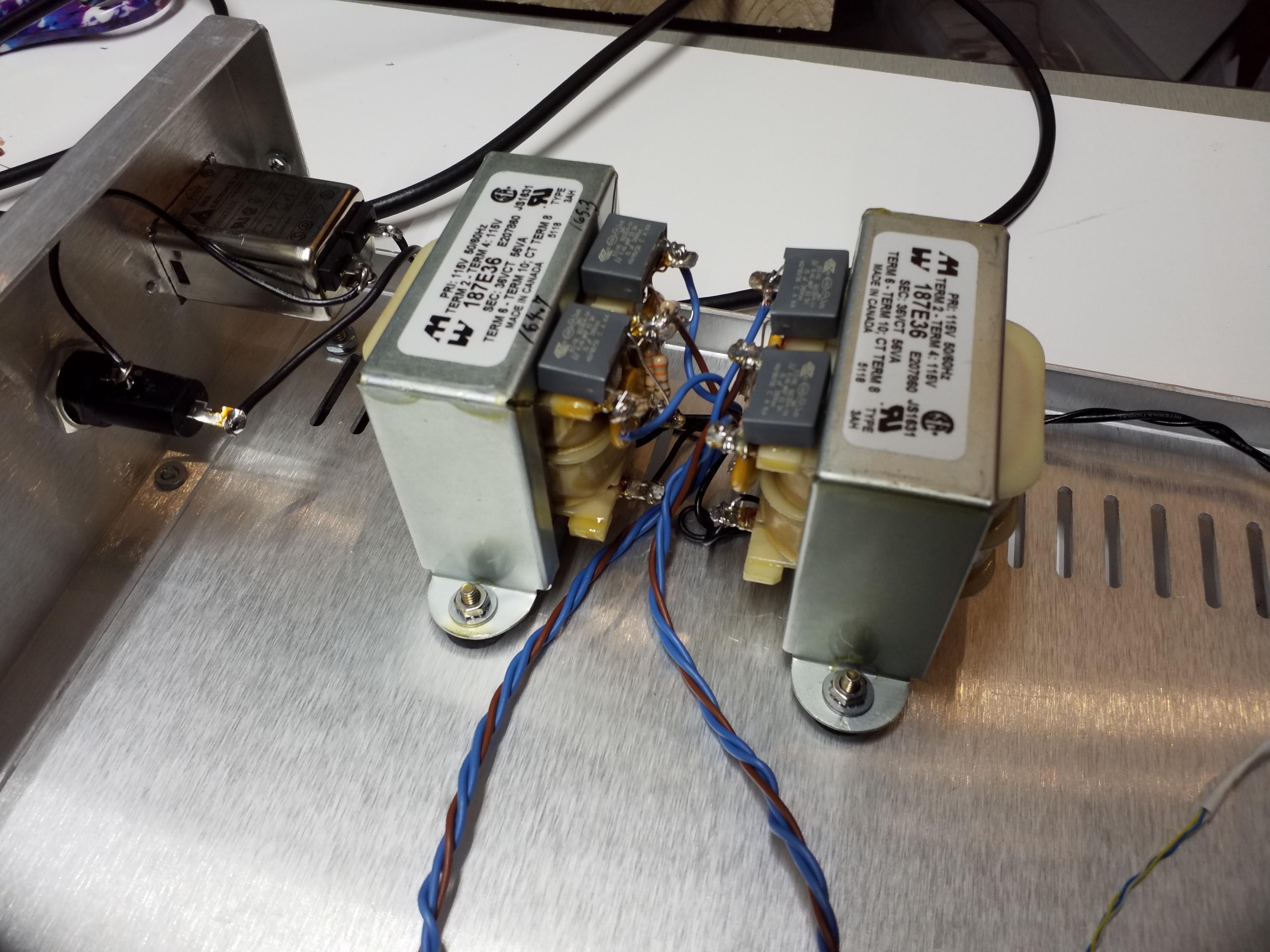

The case is a Par-metal 20-16123 . I am very happy with this case and cannot believe how much case I got for $80 USD. The stepped attenuator is a Allo Ladder type 10K, and for $29 is a bargain. The down side of a 10K attenuator is the load it presents to the source. The input selector came from Tubecad and is a Select2 model which mated to the coax cable well. I have a few things to do today and the I will give it a listen.
I used wire wrap wire to connect the front panel LED Da on the board , I also tied a wire to the ground side of Rb. This allows me to get power to a LED for a power indicator.
